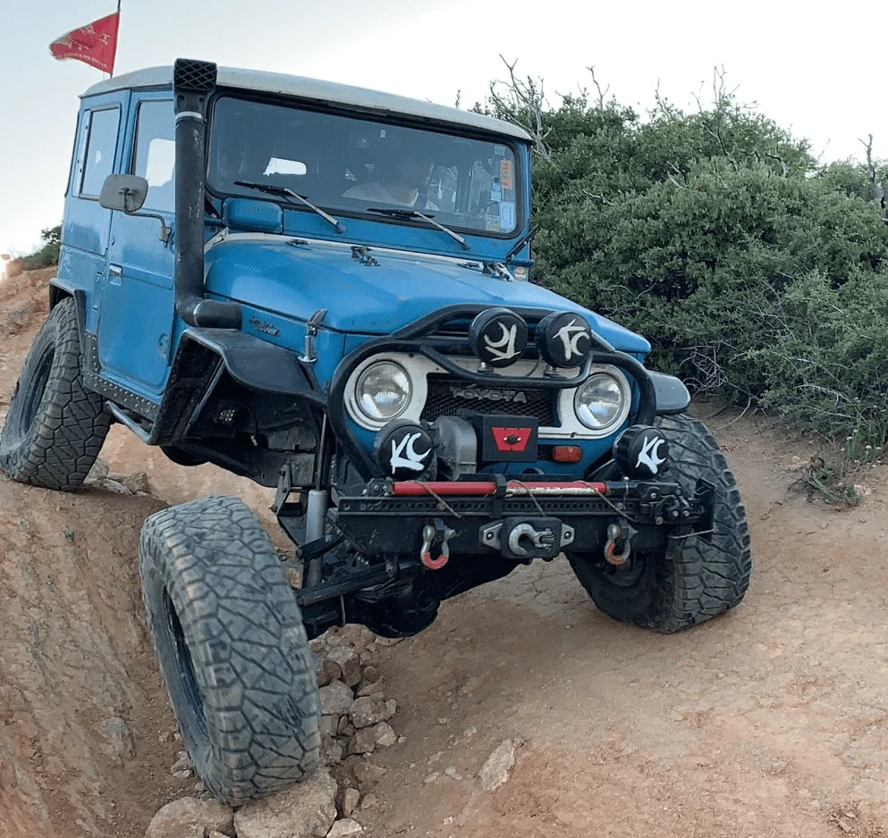

The truck got to earn its keep this weekend. Both my buddy Dillon and I have Dad's out of state so we decided to celebrate together.
We got him loaded up in the truck and his Mom got to come along for her first west coast 4WD experience:
He cant walk or nothing like that so this is his first time getting out of the house since before this quarantine thing went down. We used to do some 4-wheeling together back when we met before his accident:
It was great fun. We started the day off wearing masks but eventually we just couldn't anymore.

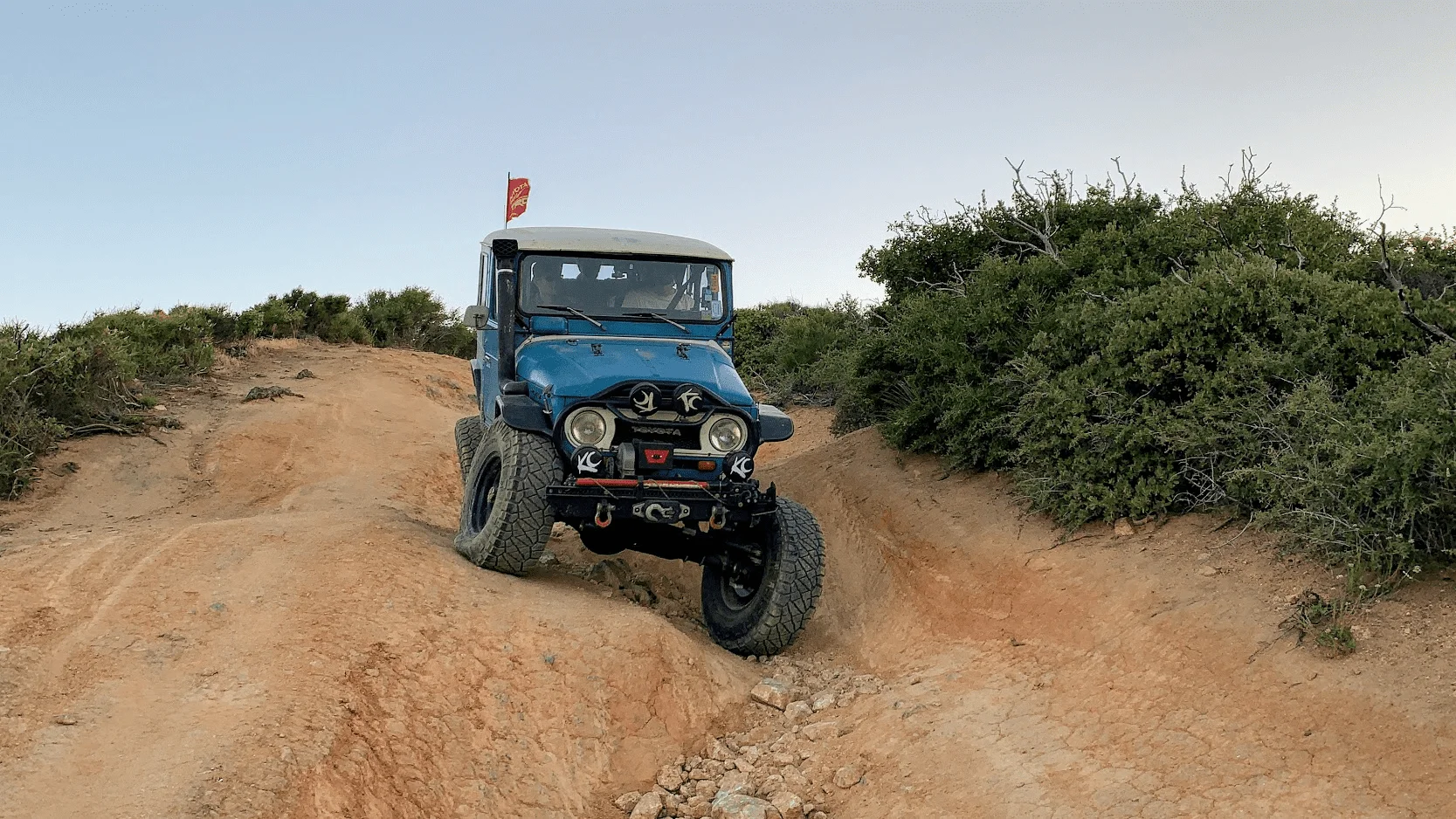

We had it at a hair under 45* once:
I little push kept it off the wall in a few spots:
She did well,
I'll post up a video soon.

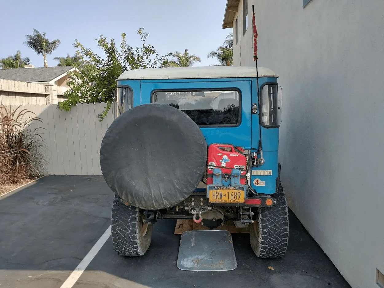

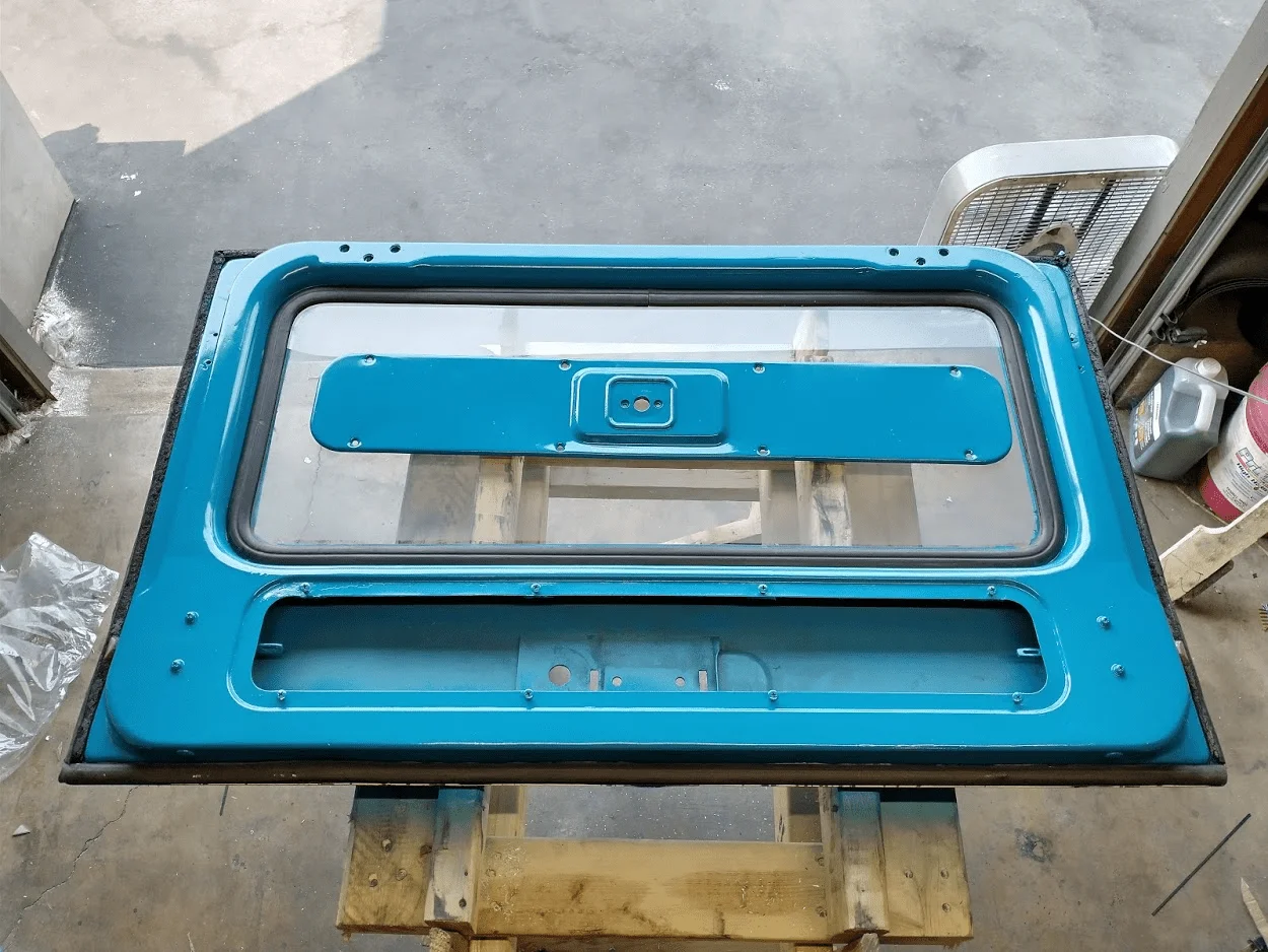

Another quickie update:

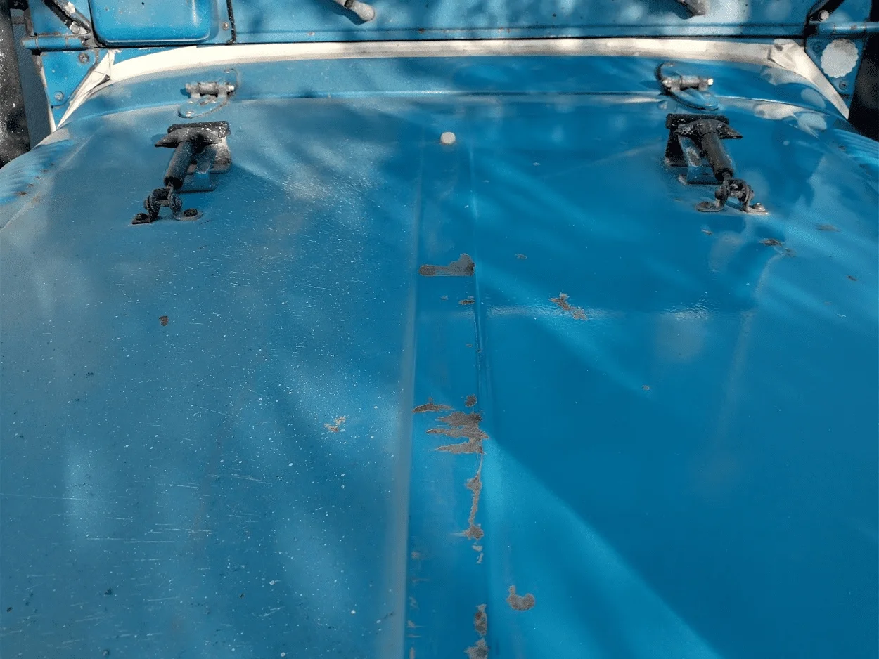

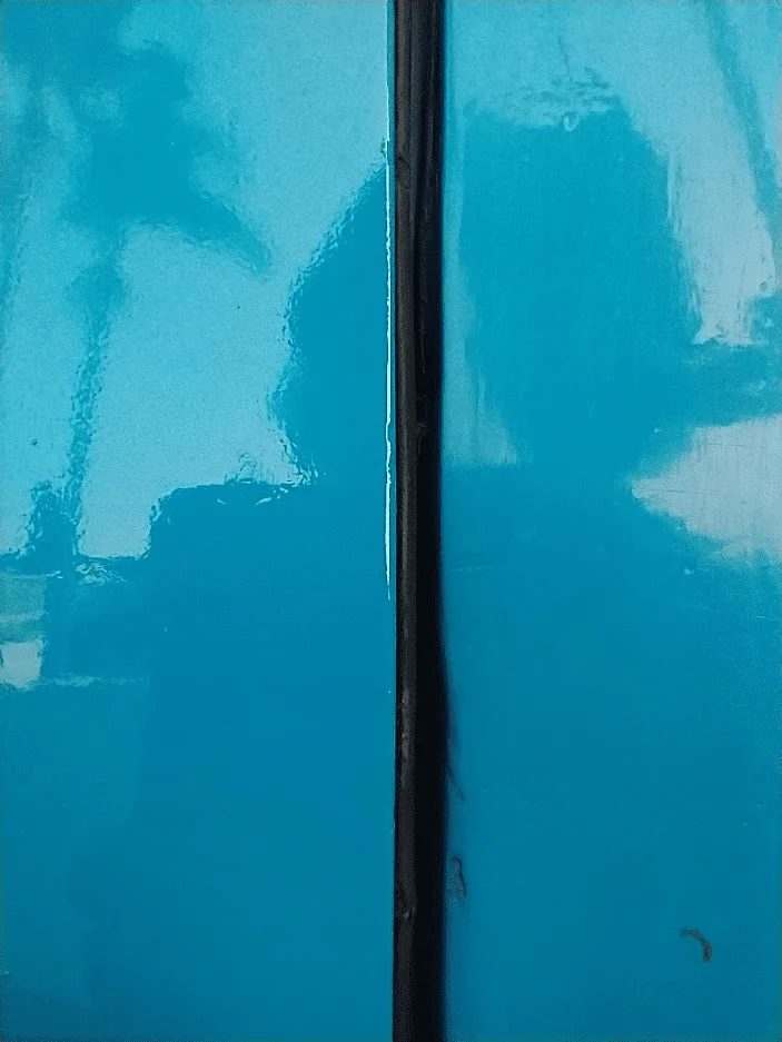

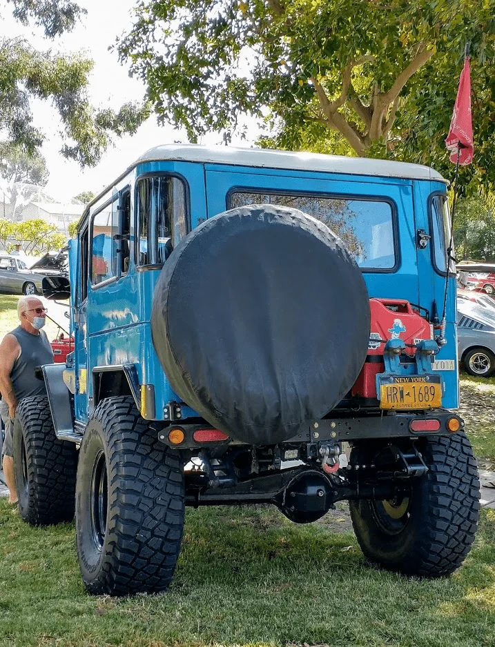

Painted the back hatch from white to the body color. Surprisingly the dealer had the tumbler, key set, and gasket in stock so I installed that stuff after this pic:

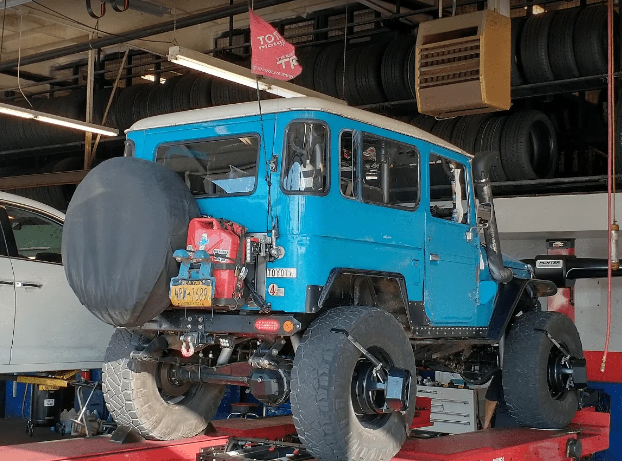

It turned out way too shiny so I buffed the truck out for the first time to get it to match better and it instantly got super shiny which was cool. So I went and got an alignment:

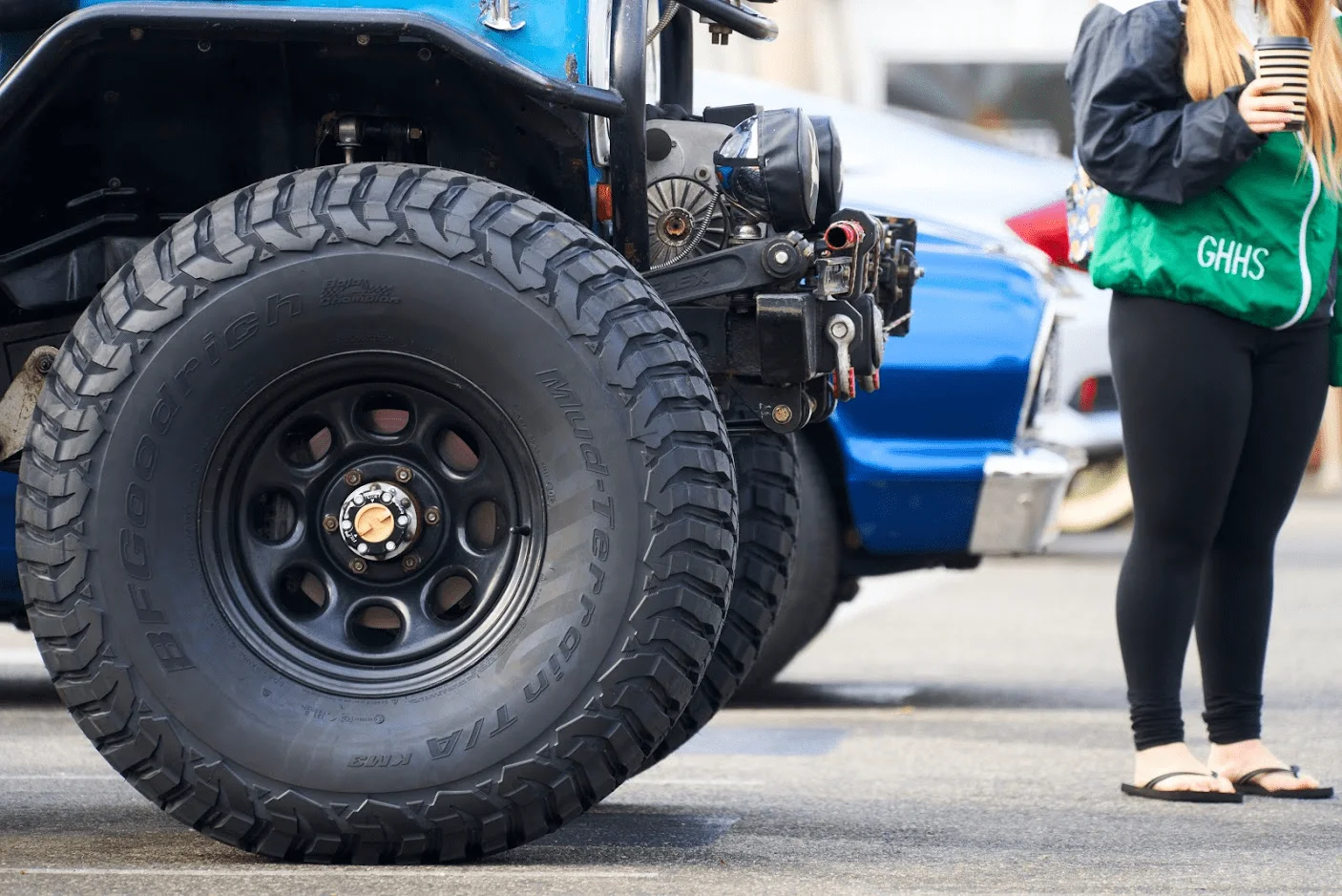

I was then motivated to replace the old tires because they didn't really fit the look of the tuck:
39-13.5 R17 BFG KM3
I think it looks a lot better! And its the first time I've ever been able to lock the back of the truck so that's a good feeling.
Mike

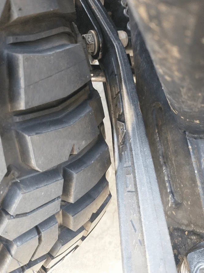

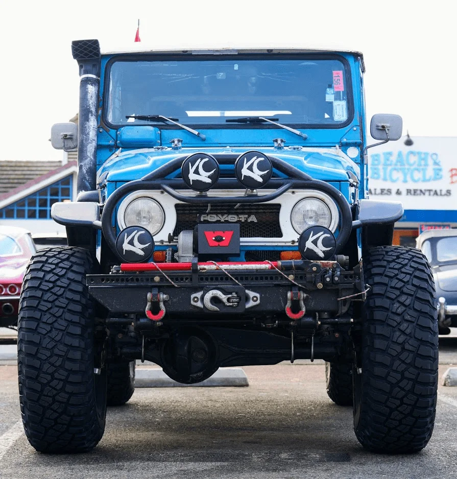

Just a few notes on the 39_13.5_R17 BFG KM3.

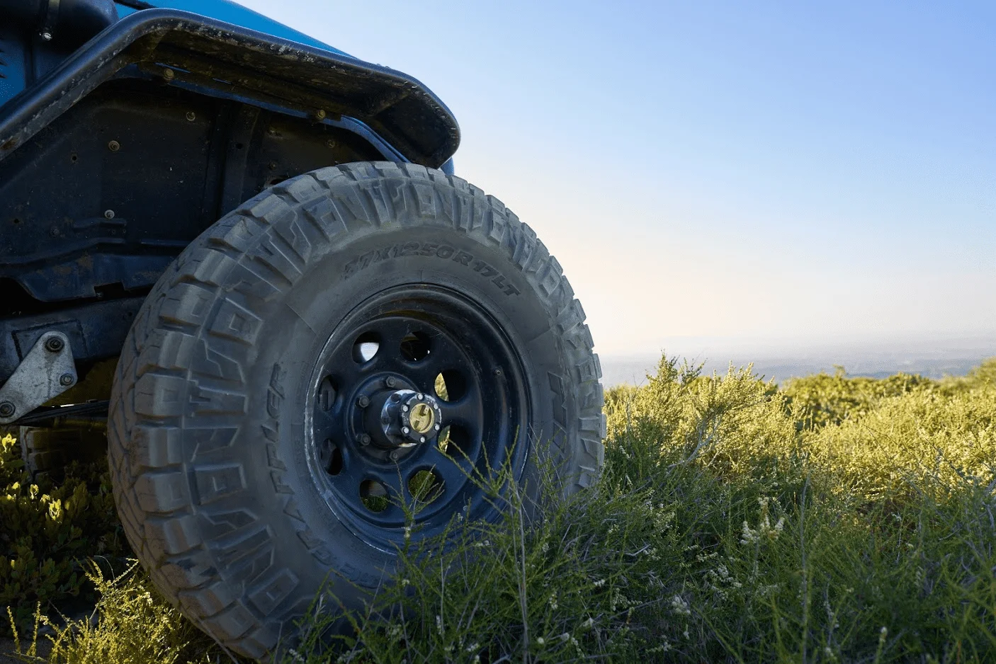

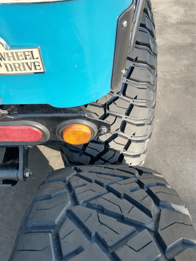

I mounted these up on the same wheels I had the 37_12.5_R17 Nitto Ridge Grapplers expecting there to be a little rubbing up front. Mush to my surprise when I did a couple turns lock to lock where the old tires would typically (albeit just barely) rub the sway bar arms there was ni signs of rubbing. How could that be I thought.. Surely a 2" taller and 1" wider tire should rub!
We here's what I find:
So I busted out the tape measure. The KM3's tread width is 1" narrower than the Nitto. Not only that but the cross section is much less "Square" than the Nitto tires were. This makes them act much narrower and fit the truck must better. Its a win win! They might be the ultimate tall skinny!
The narrower contact patch definitely helps me feel that 6* of castor on the front end. It returns to center with a bit more authority at freeway speeds which feels good. They roll nice and easy so far. The TDI doesn't care at all. I had to recalibrate my speedometer with a 6% change which makes sense with the diameter increase.
They aren't very noisy yet. I can barely hear them, but they are definitely there, unlike the Nitto's which were silent. I hope it stays that way. I measured the tread depth on the Nitto's before dismounting them and they had ~14/32 all around. They came with 18/32" so considering that I drove cross country twice and raked up ~25,000 miles on them that's impressive. I would be happier with them actually if they came with a softer compound. The way I use my truck the tread would be all chunked out long before wearing at the rate these were. The BFG's definitely have a softer tread so maybe they are perfect.
Pretty happy so far!
Mike

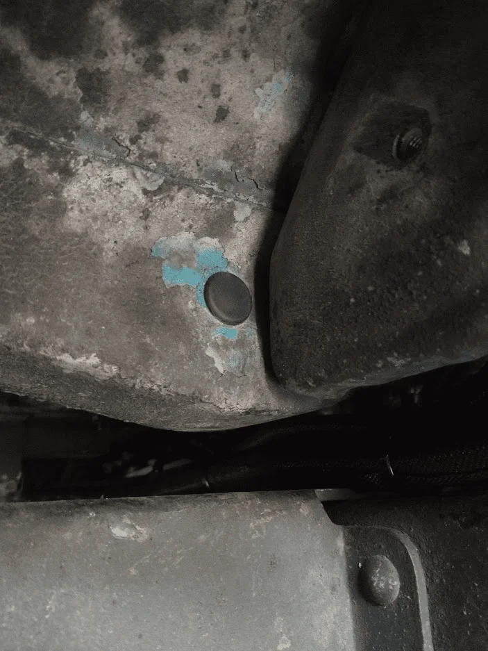

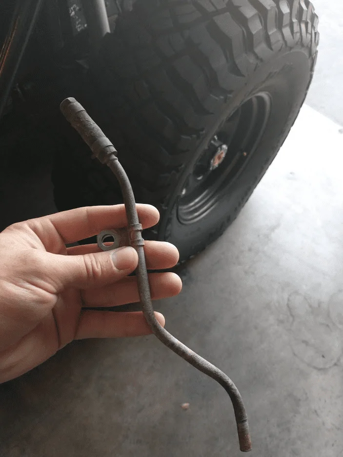

I have a quick question I've been wondering about..
What was the original purpose of this hardline/hose:

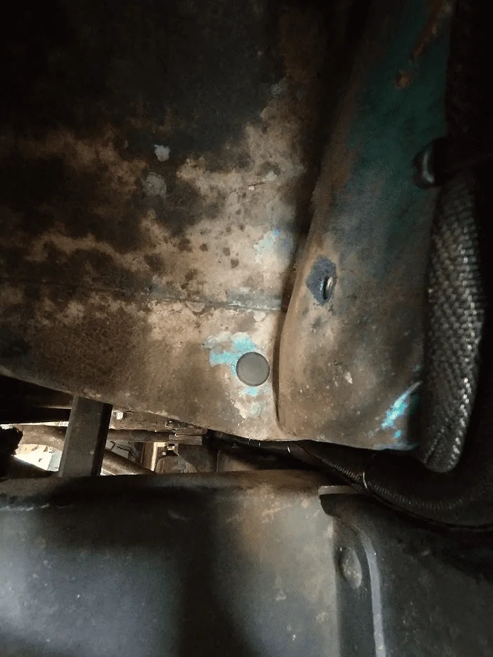

It originally went below the floor on the passenger side footwell:
I plugged the hole, but there was a grommet there. It didn't seem to go anywhere??
Thanks,
Mike
