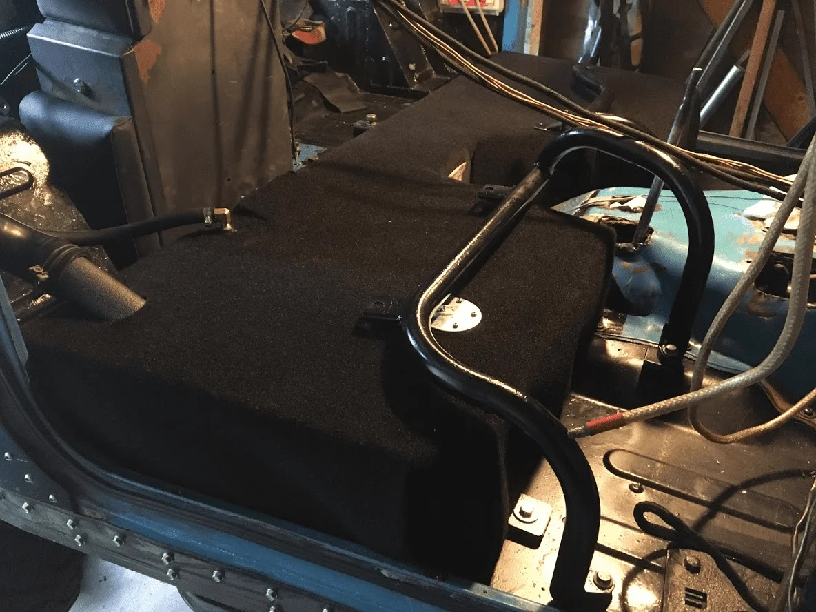

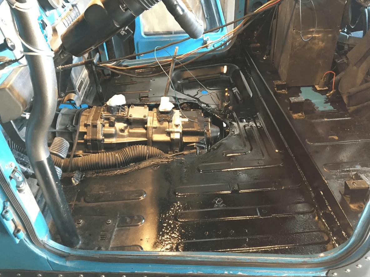

You can see how cozy its all getting under the tunnel:
Installed everything and threw a half a jerry can in the tank to check plumping:
All good so assembled it all:

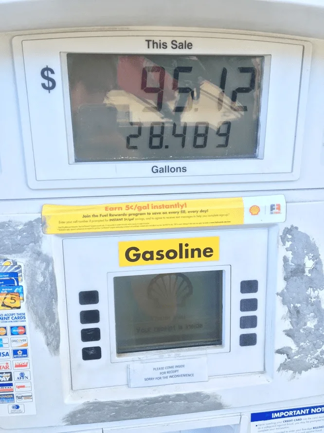

off the fuel station:
My tank must hold a hair over 30 gallons if you include the fuel i dumped in it before taking of to the filling station. Plenty for this truck considering it gets 27-29mpg :)
A few more little details to take care of:

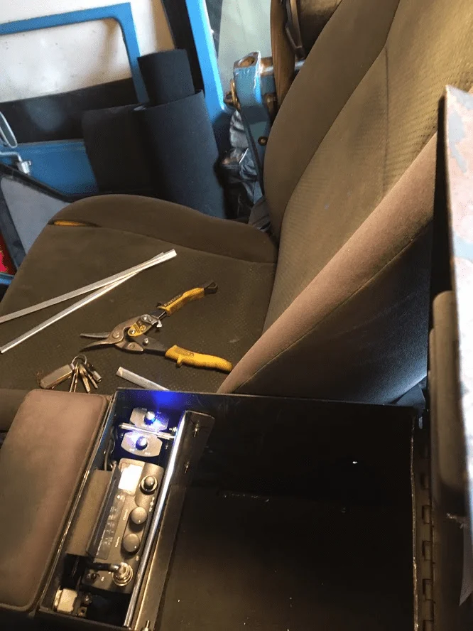

I didn't like how the stuff in the console would get stuck under the CB radio to here's a divider:
Angled forward and tight to the radio to maximize space:
Gasket on the bottom to keep things from sliding under it.

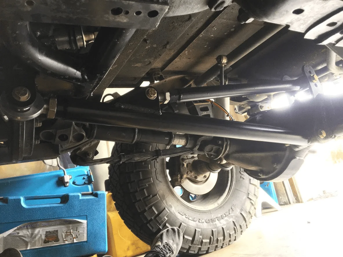

Painted the traction bar:

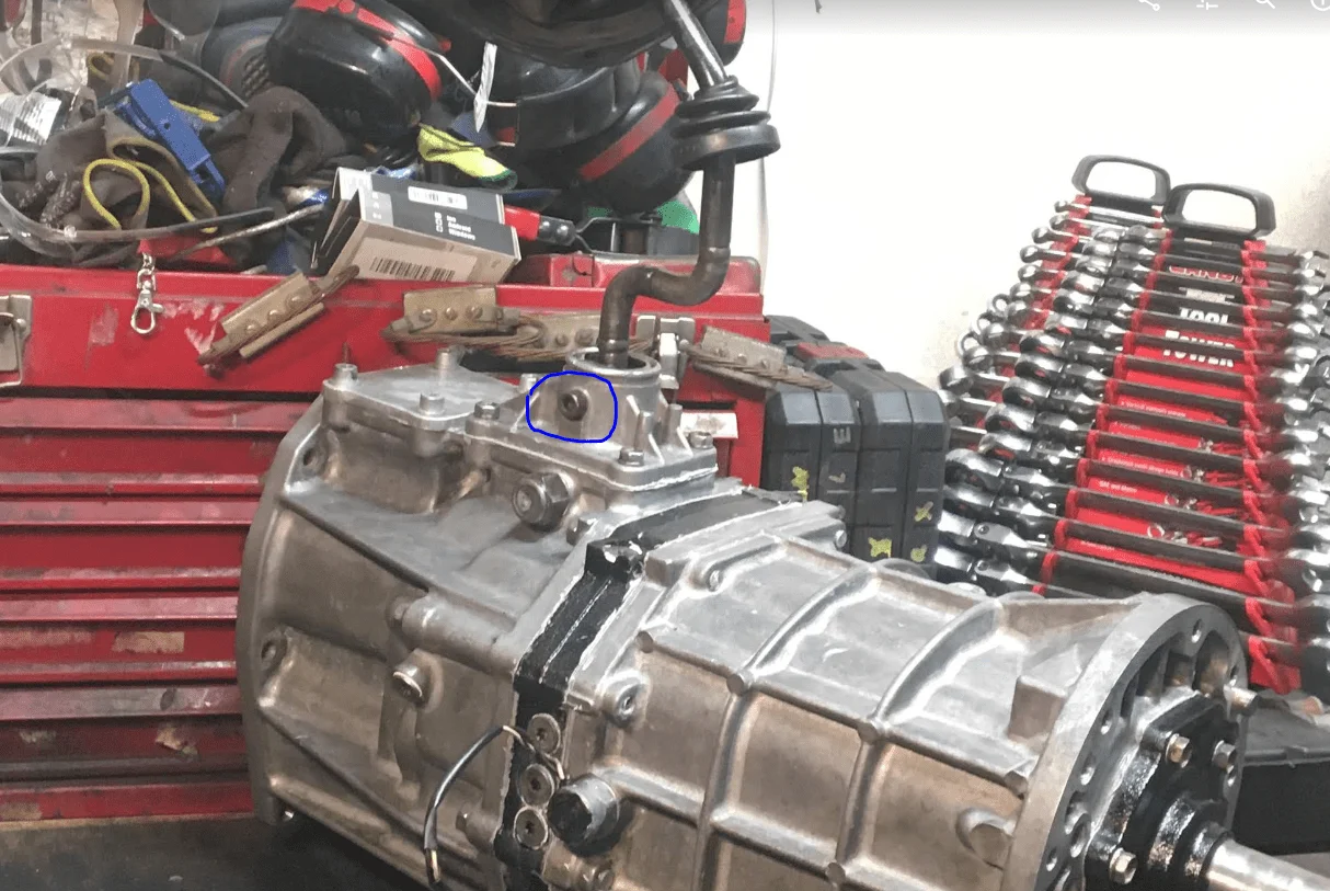

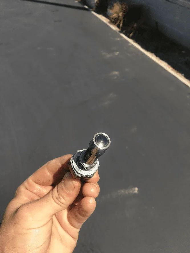

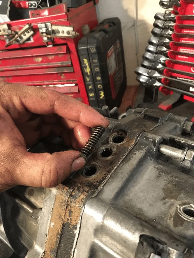

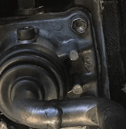

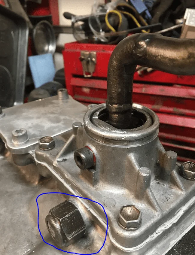

When I rebuilt the transmission I changed all the detent springs to heavier ones to stiffen up the shifter with the long stalk:
Unfortunately I don't have any pictures with the new springs. This is just a picture before disassembly to show what i'm talking about. If someone is interested I can help them out.
On the same token as the springs I machined some M8 12.9 cap head machine screws to fit snugly in the shifter slots. I tapped the shift tower to accept the screws and it tightened up the shifter a ton compared to the old peened over rivets they replaced:
Another touch was I replaced the tower centering springs with ones that I had laying around from a different gearbox that had much stiffer springs:
I had ordered a short shifter from marlin crawler but they repeatedly messed the order up and finally they just told me they didn't know when they would have my parts and mailed me a refund check (to my parents address in NY for some reason?) I love marlin, but its always something with those guys.
However in retrospect- these changes made a world of difference in my shifting feel, and I much prefer this to the shift shifter anyways.

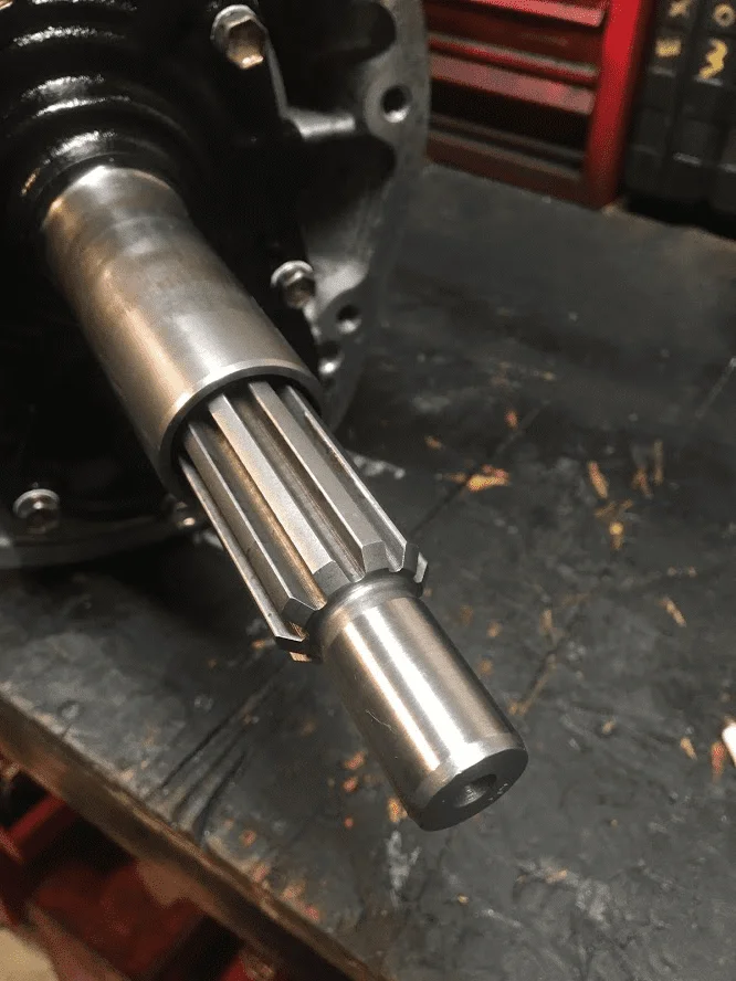

I also did an inspection of the pilot bearing and tip and they are in excellent condition. I replaced the pilot bearing and throw out just because it was apart.
This is good news because it means the adapter plate I made has proper alignment finally.

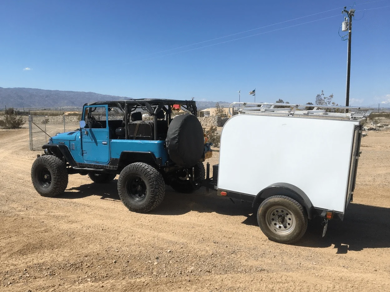

So we had to abandon the car. Here's my replacement:
2.4L 5 speed manual 4wd. It has 4.56 final drive, 3.85 first gear and 29" tires. The week I bought it I left for a trip to Seattle and back and averaged 30.5 MPG over the next few weeks :)

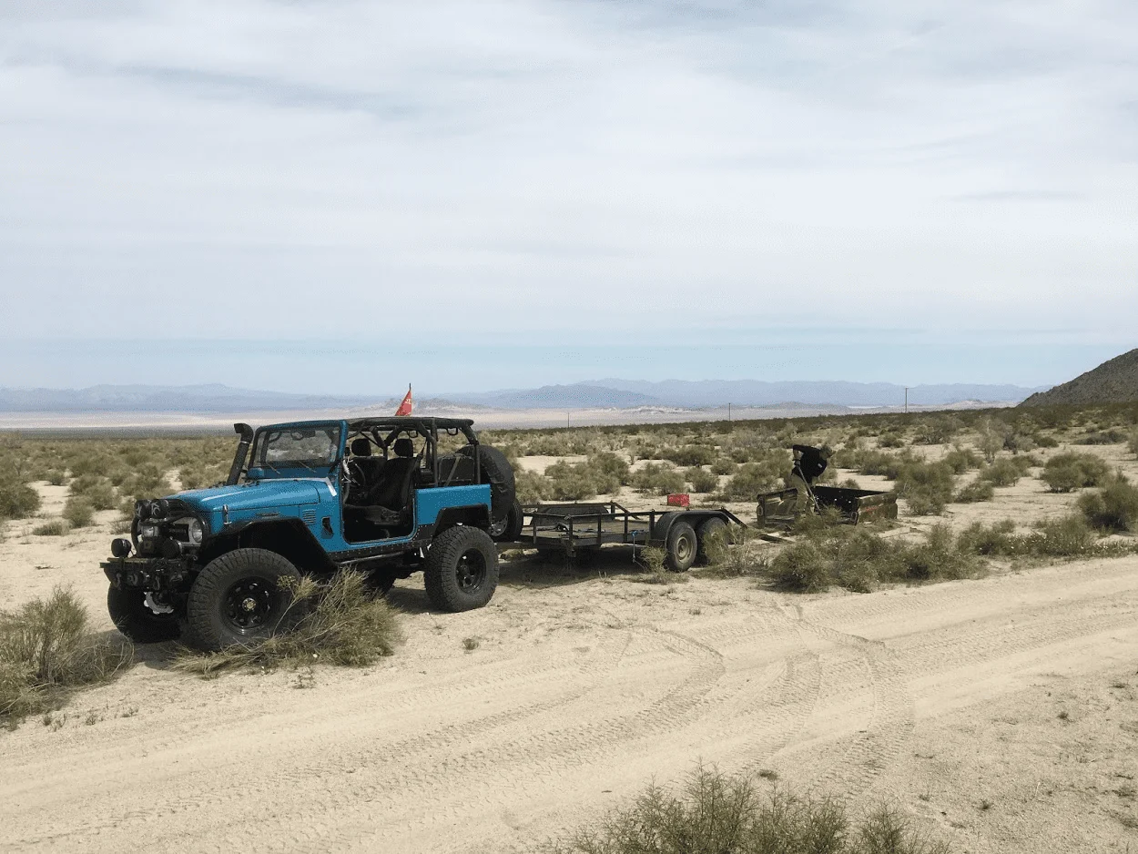

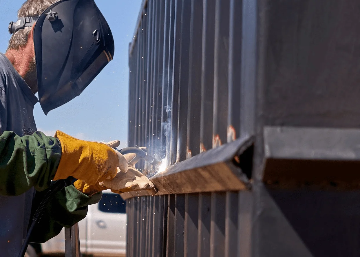

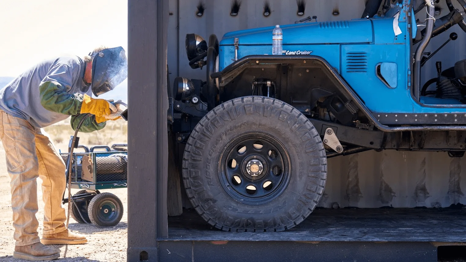

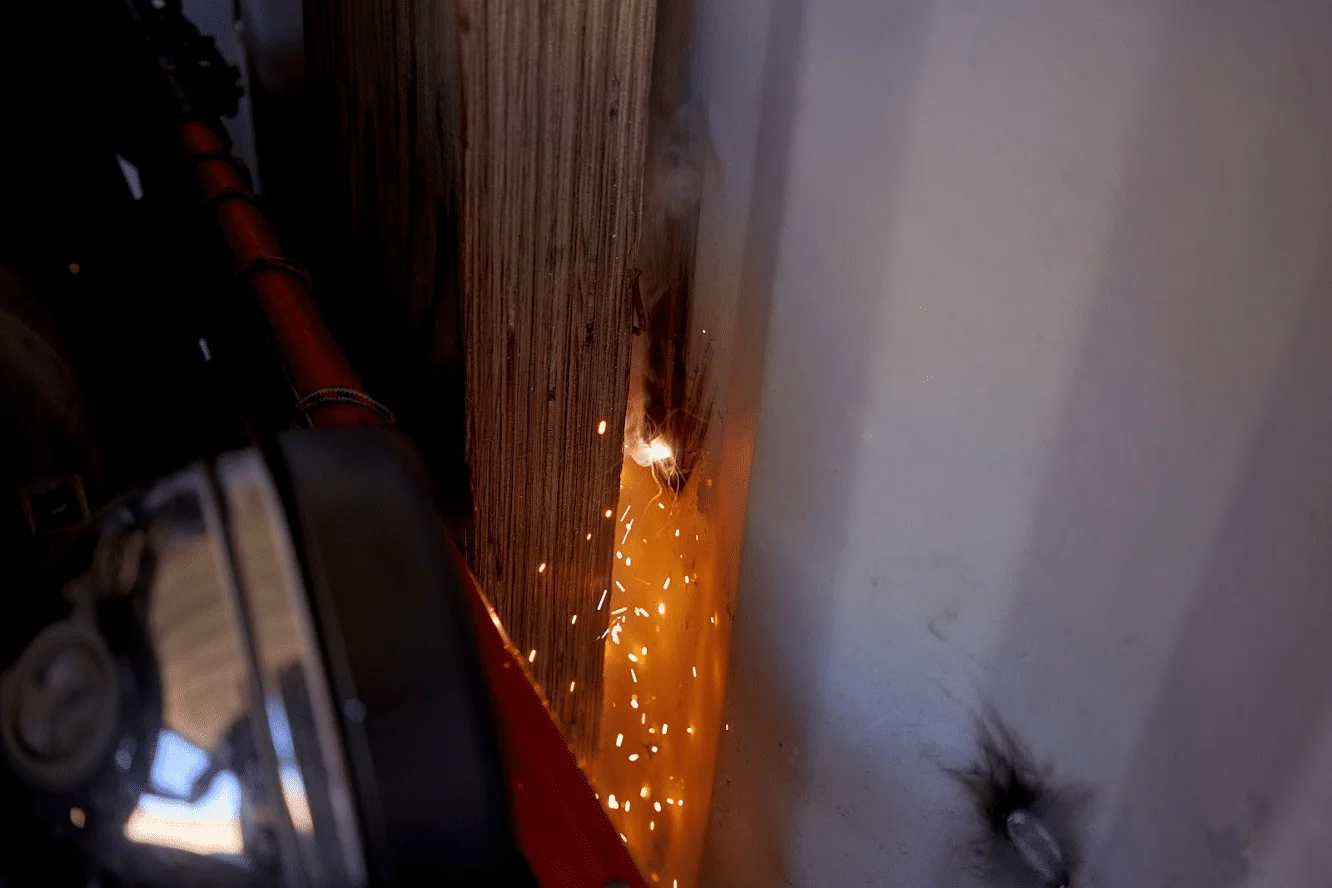

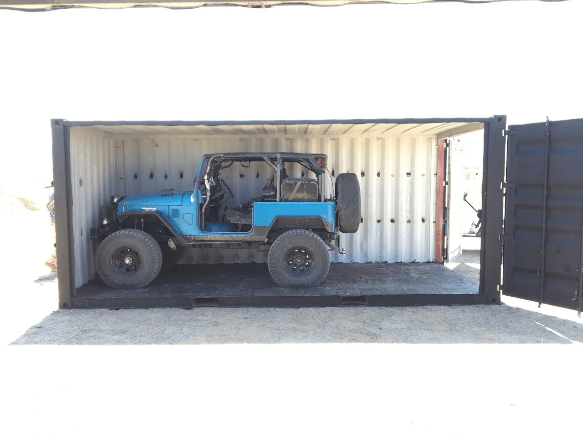

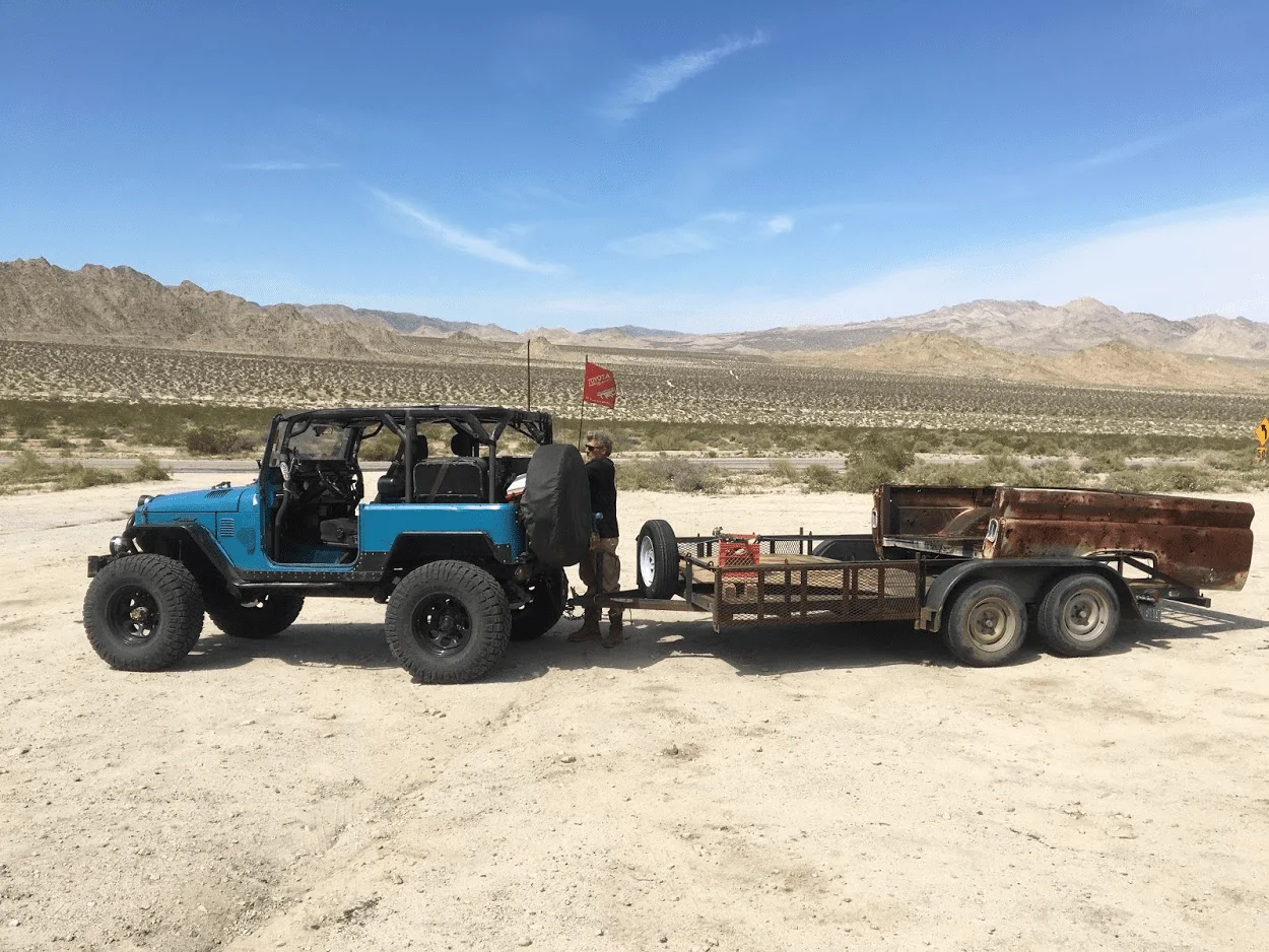

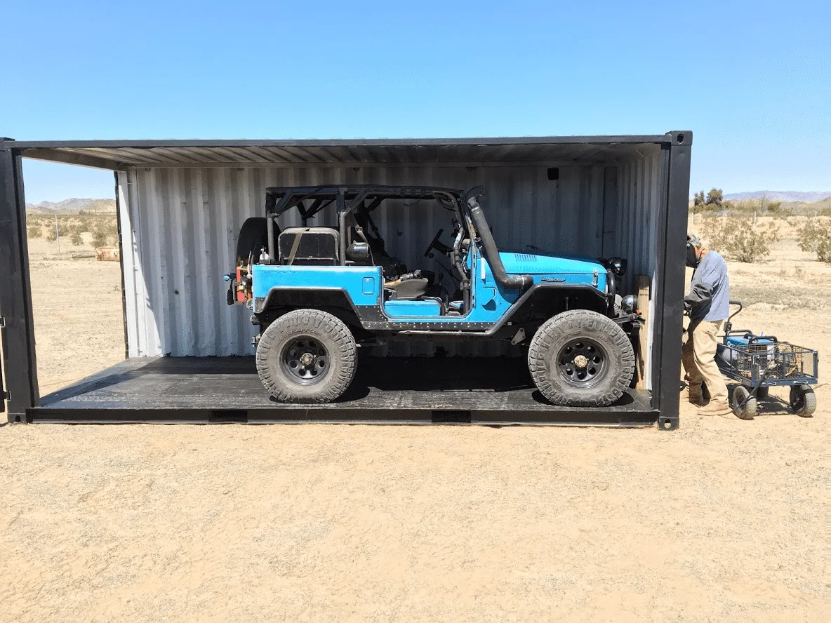

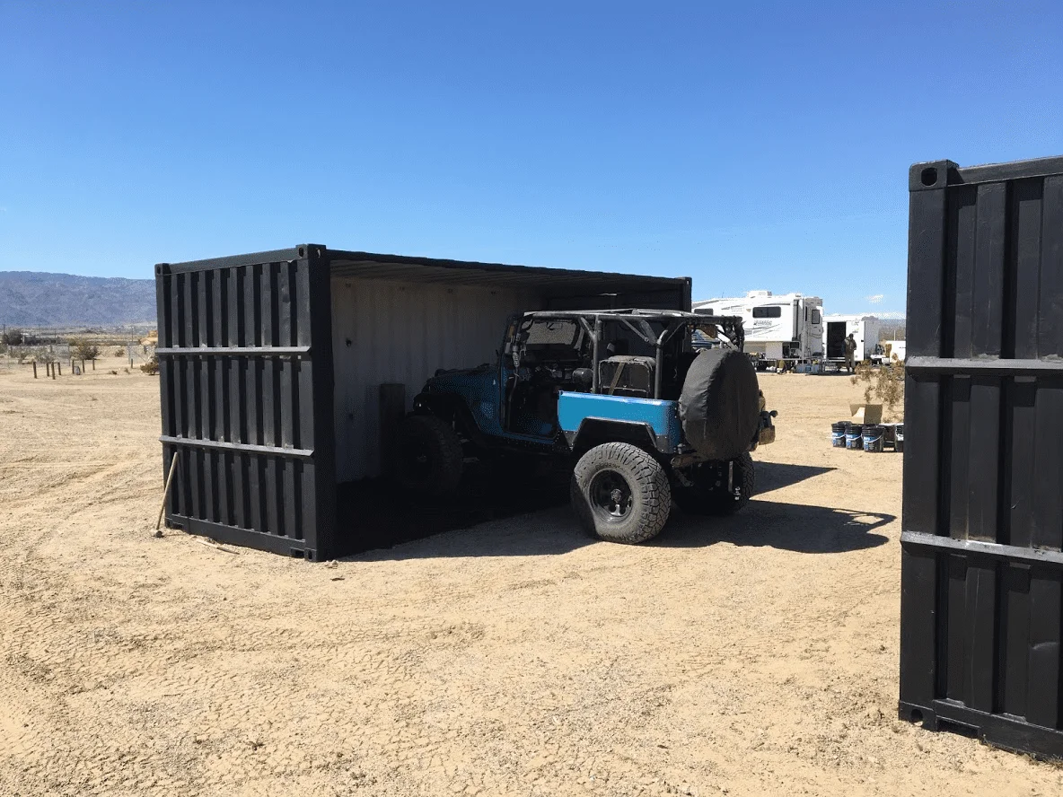

My buddy has a little project going on out in the desert.
I volunteered the cruisers services:
He had some bent up shipping containers we needed to straighten and add bracing to:
And we dropped them into a big hole:

Installing the fuel tank below the drivers seat is likely going to dampen a lot of sound as well.
