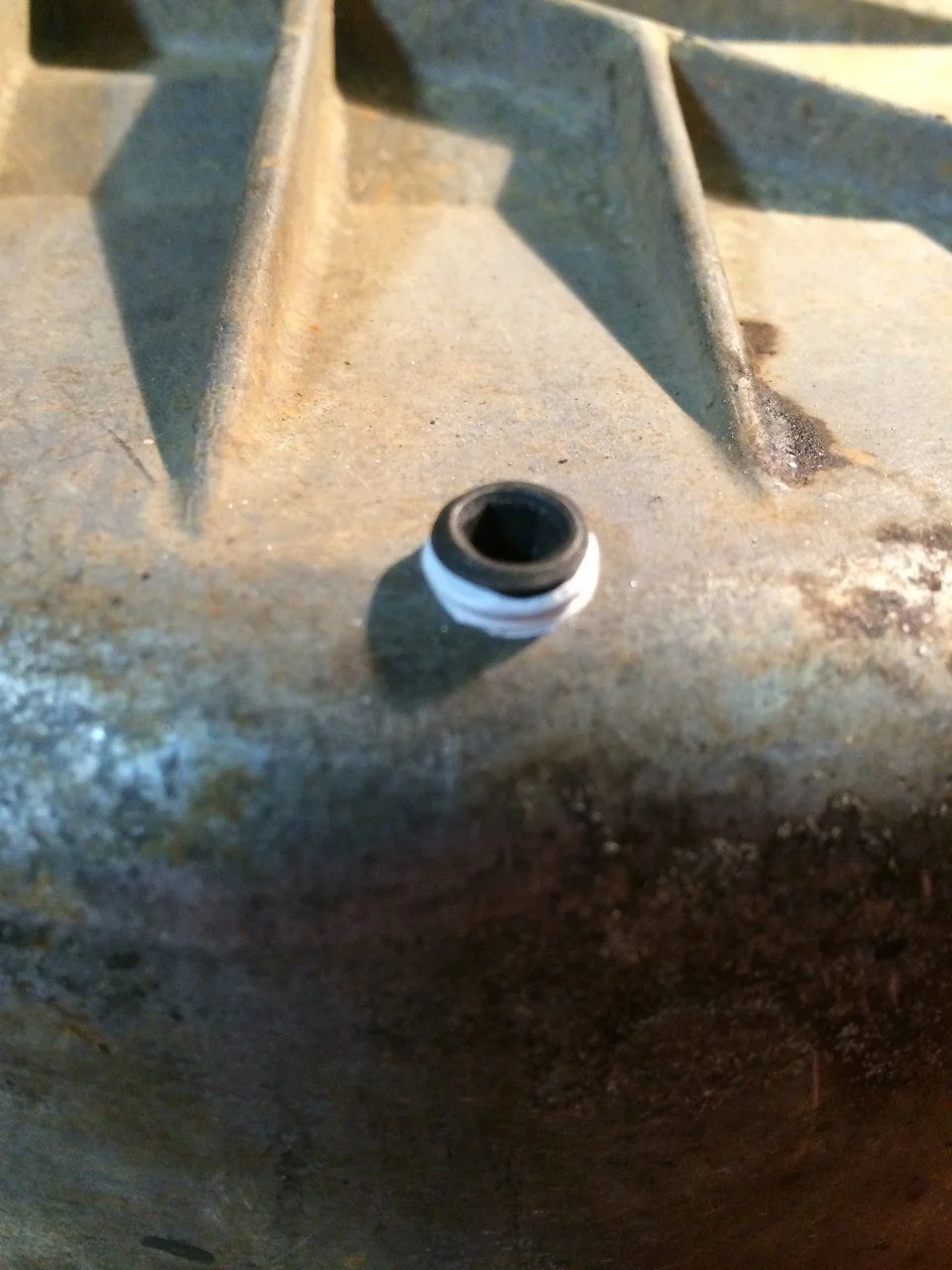

I just drilled and tapped the housing for small set screws that are my drain and fill plugs. No welding required.
Draining and filling through a 3/8" hole is not a speedy process but it works fine for me just filling with an extra small funnel. There isn't much oil in there. Less than a quart of 30 weight.

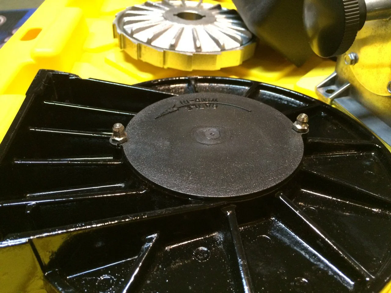

On my 8274 rebuild I also drilled two 1/16" holes in the the drum end plate that connect to the existing threaded holes and added zerks so I could grease the friction end as part of my maintenance procedure.
Oh yeah, and as you can see I overtightened the zerk and cracked the plastic drum end cover. You might not want to do that!

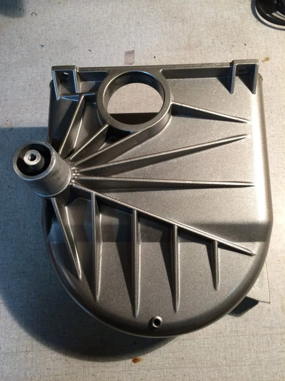

Yes it can be done I have added drain plugs to both my 8274's one has a fill plug added in the same manner and the other a filler plug frrom gigglepin for the reasons you have stated above. Mine done for jungle remediation of this problem.
Tig welded bungs into mine. The castings were a bit difficult due to oil impregnation but nothing more than usual for this type of used cast part. Biggest contributor after having it clean I find is to have a torch and power source large enough. You need amps to weld aluminum.
