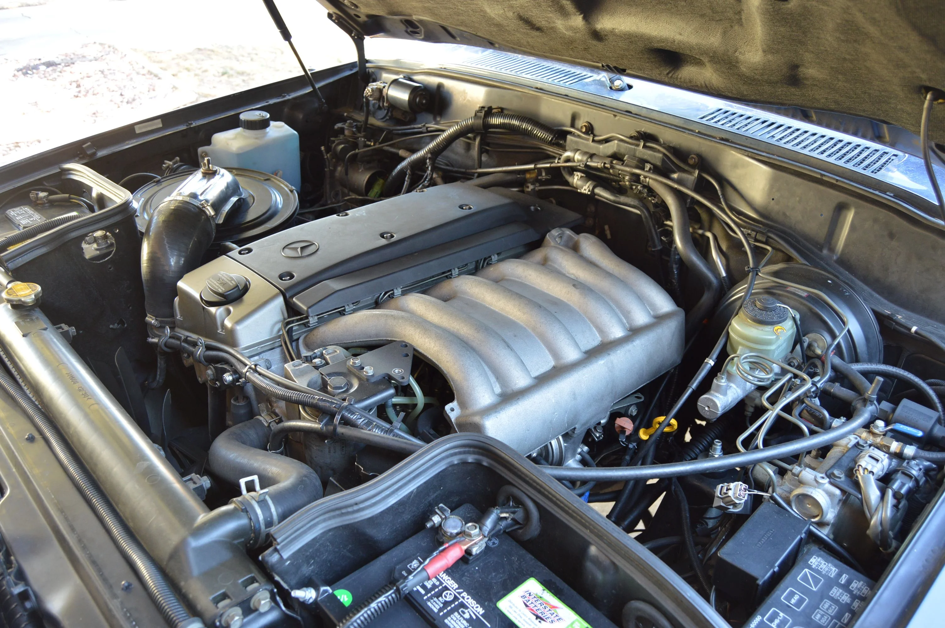

Build Mercedes OM606 Turbodiesel into FZJ80 - engine refresh and more turbo fun

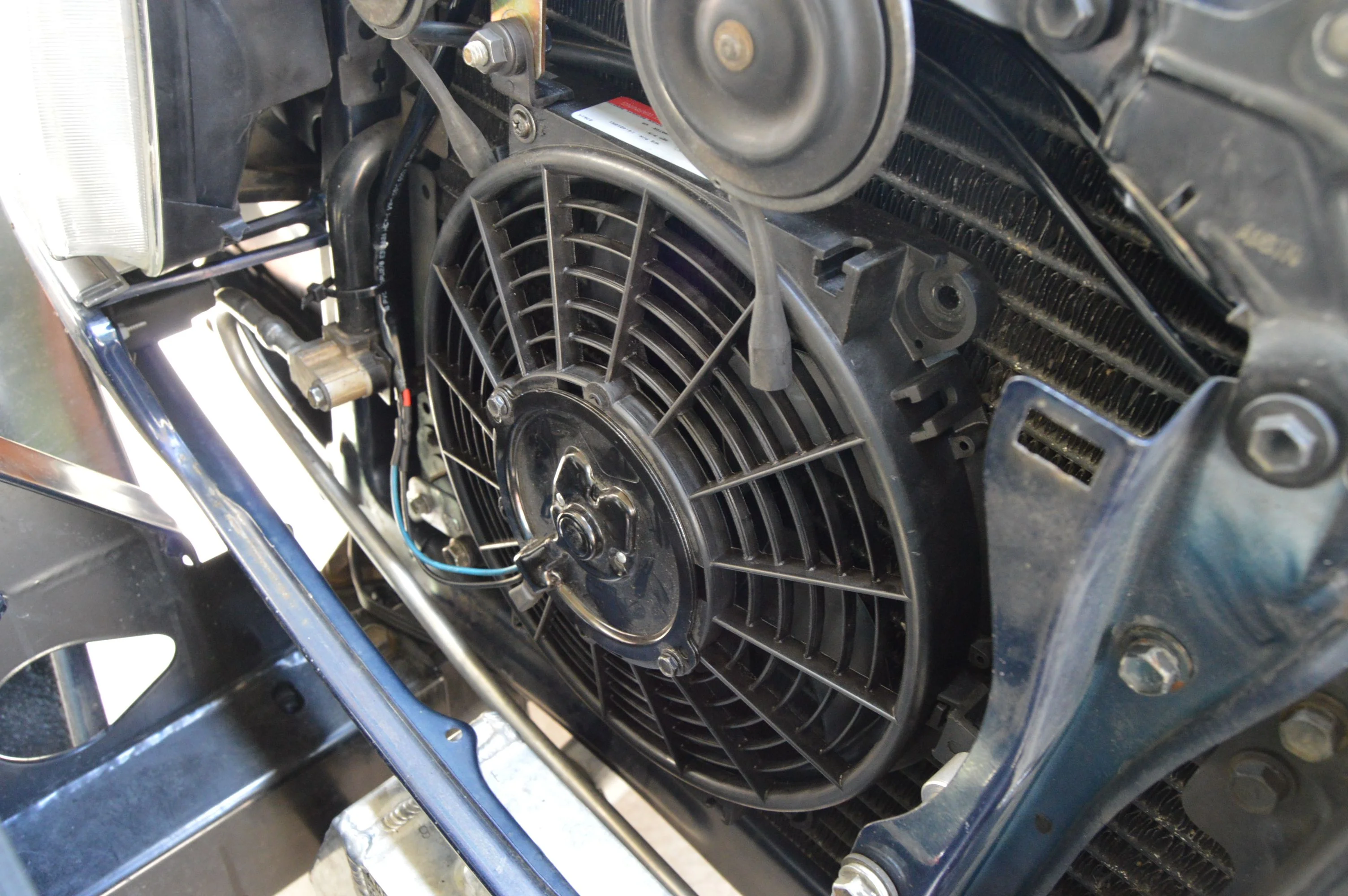

Have you thought about a fan on the intercooler? Might help with towing or hill climbing or both!
Spal makes some quality stuff. I only say that cus your in Colorado which sets the bar just about as high as it gets when it comes to hills and altitude and stuff.

Because the intercooler is totally outside the engine bay, I'm not too concerned about heat soak, but a small fan covering part of the core may be beneficial. At low flow rates, the intercooler may just have enough thermal mass and external surface area to dissipate the heat via radiation.

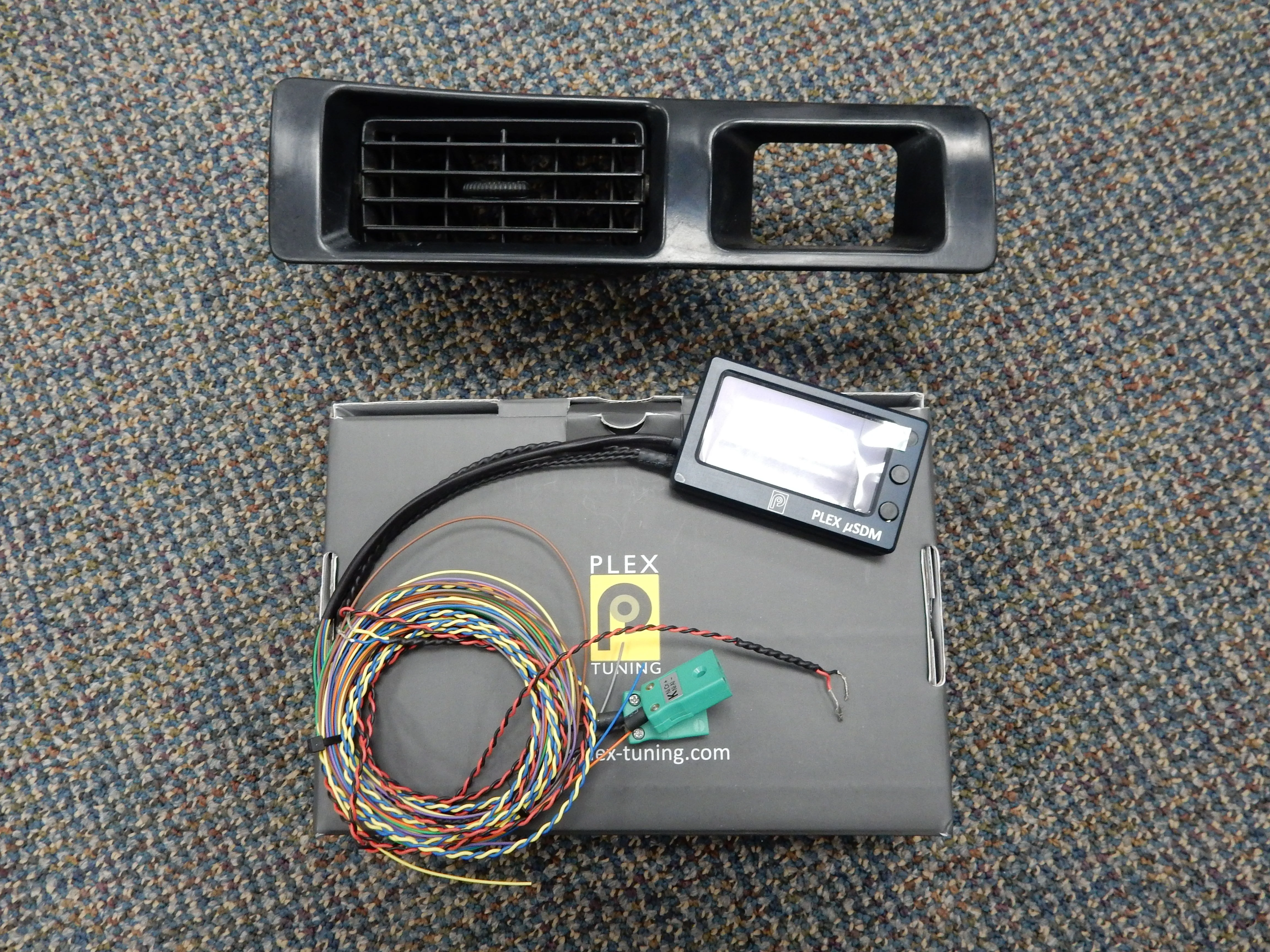

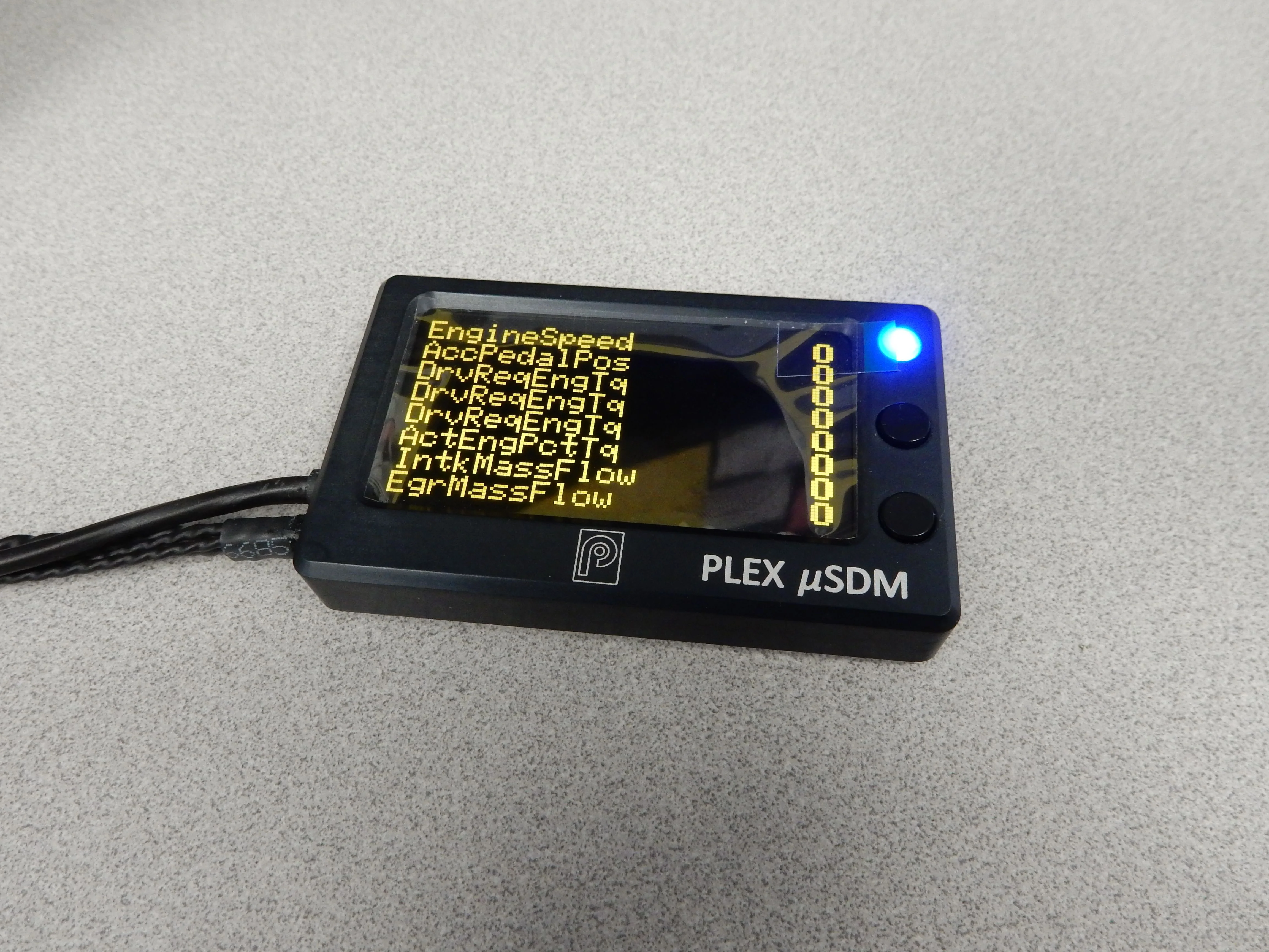

Instead of having a whole bunch of round gauges to measure all the engine things, I opted to use this sweet piece of hardware to read all the DSL1's sensor data over CAN bus. It's a Plex Tuning µSDM pro and it should fit nicely in place of the clock with some trimming.

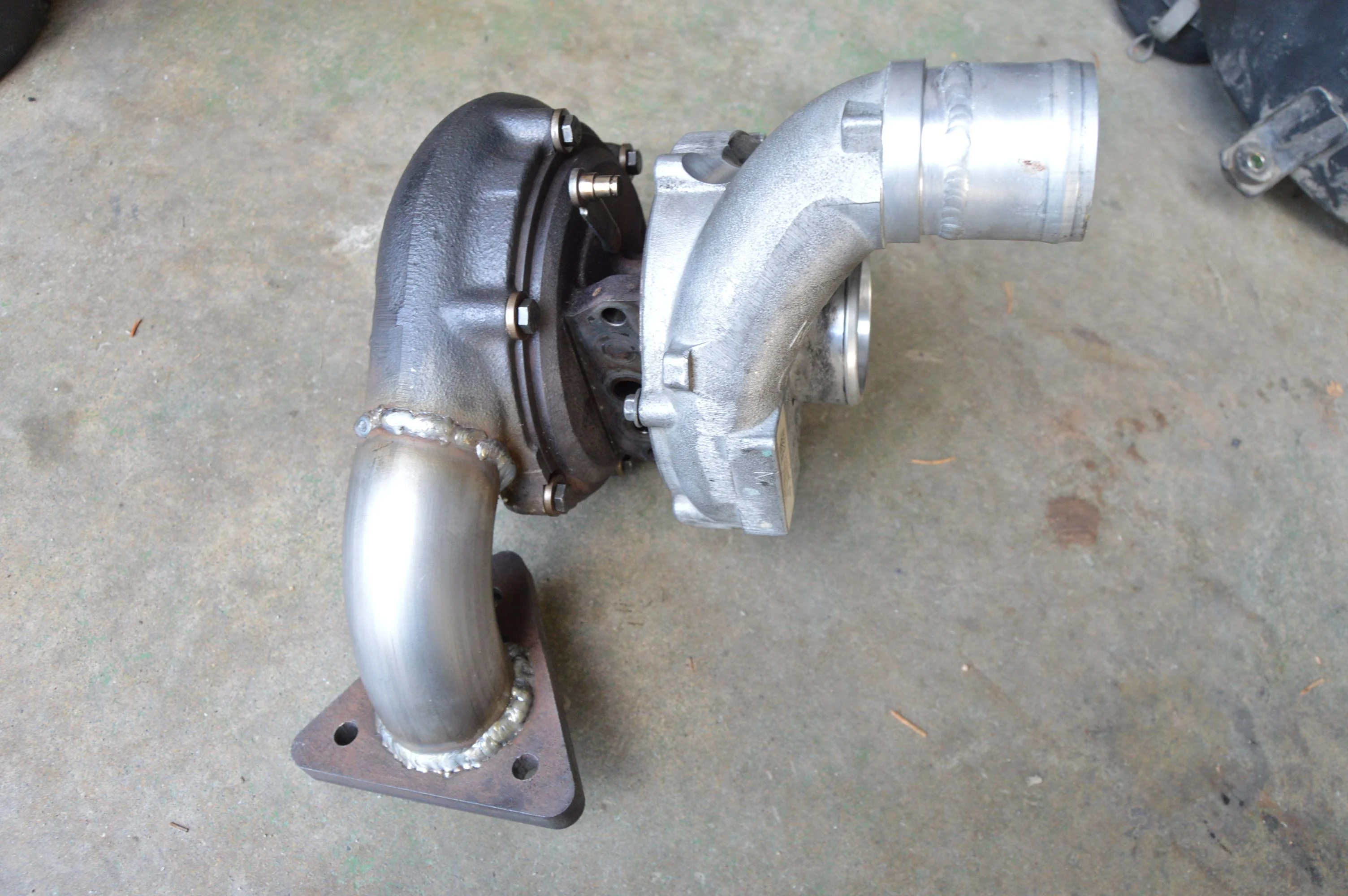

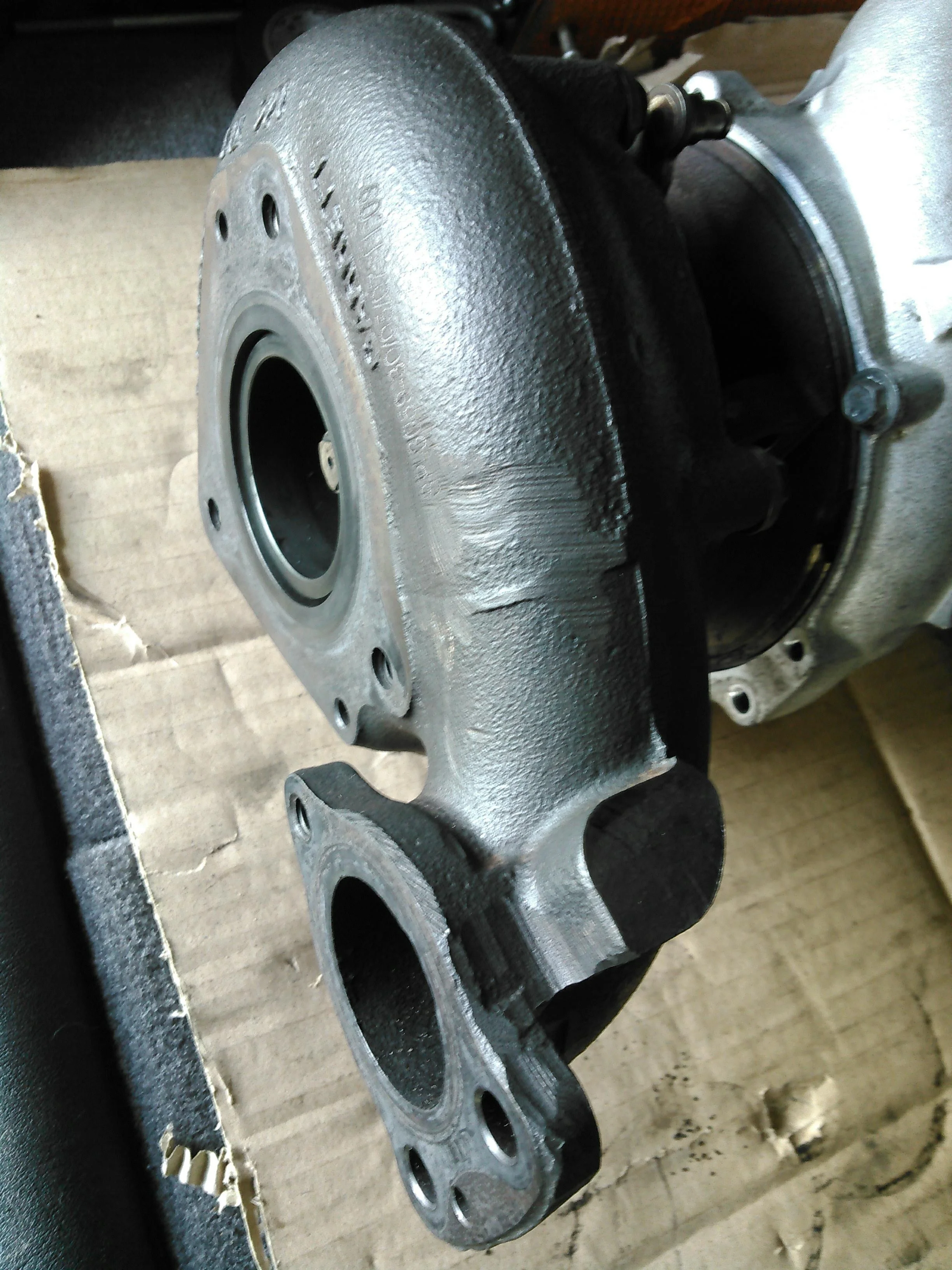

After trying to fit a Cummins/Holset M2 from the new Nissan Titan, I found that it may be too big of an assembly to fit.
So for now, I'm going with a variable geometry GT2056V from a 07-08 OM642. It should allow for 250hp/450 ft-lb and excellent off-idle torque. I may try the Holset in the future. I hate to hack up a brand new turbo system though.
The turbine inlet flange faces back on this turbo, so I just cut it off and welded a pipe to a water-jet flange. It fits pretty well and looks stock once installed.

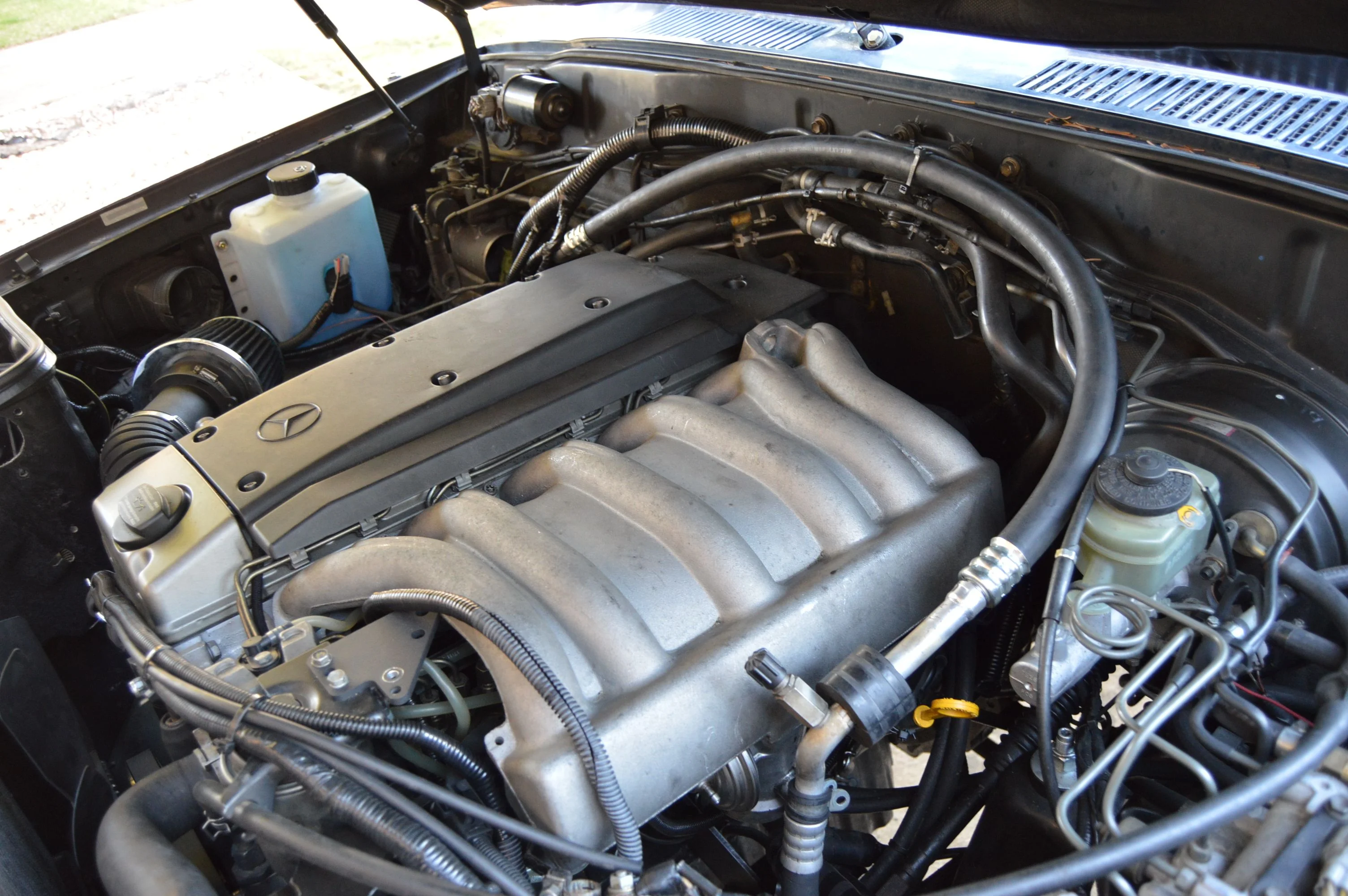

I finally got the A/C system installed and charged up.

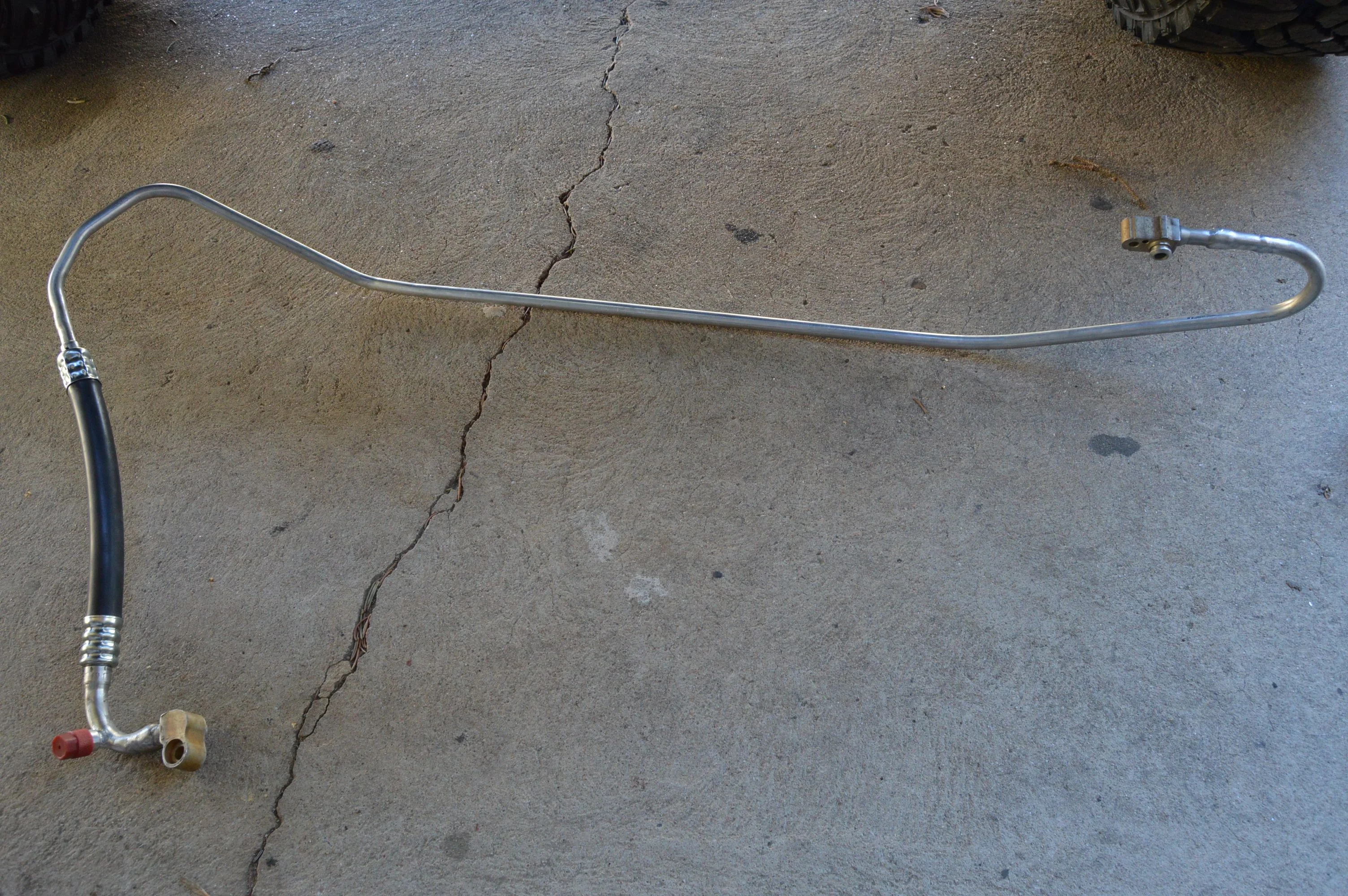

I took all the parts to the local hose supply shop and had them braze hose ends on the Toyota/Mercedes fittings. I also had them stick a 5' piece of straight tube on that I would later bend to shape.
I also added an auxiliary fan wired to a switch so it can be controlled either automatically, fully manual, or just off.
