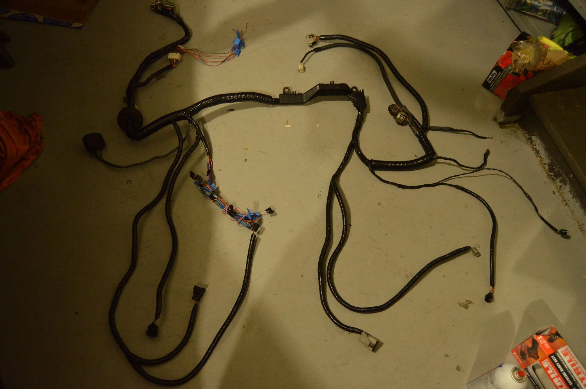

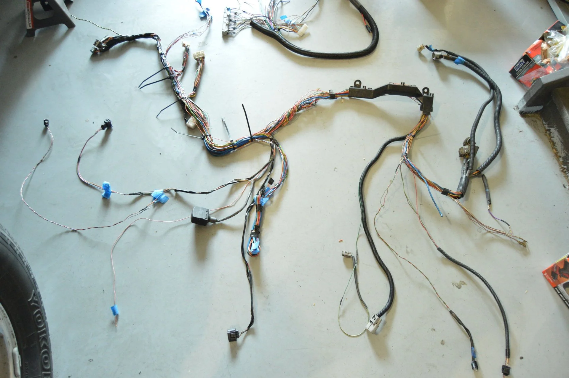

The harness doesn't need to be completely hacked apart for this swap. The stock loom is well-protected and routed nicely along the firewall, so I decided just to cut un-needed plugs off the main harness (making sure to properly insulate, and depin and 12v lines to reduce electrical noise).
Harness before
Harness after (can you spot the differences?)

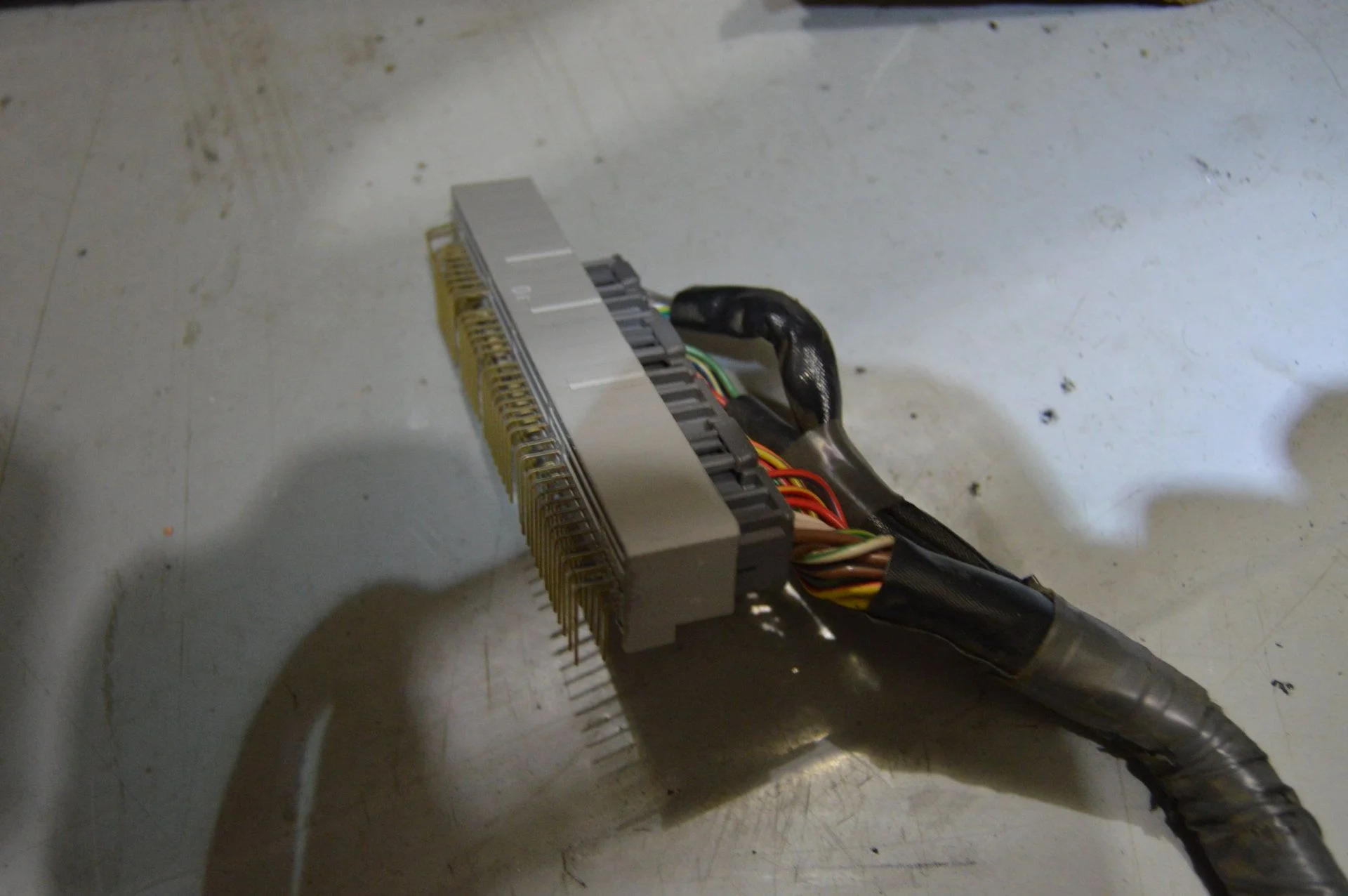

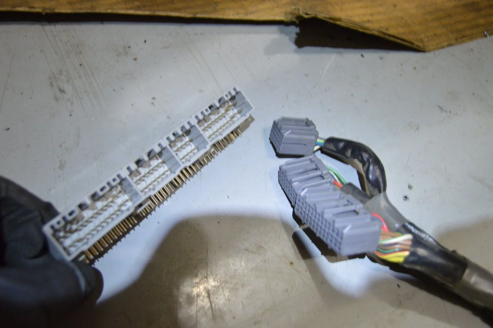

My goal was to make the electronics be plug-and-play, so I sourced the OEM ECU plug for the 1FZ (I have these available for purchase if anyone wants one)

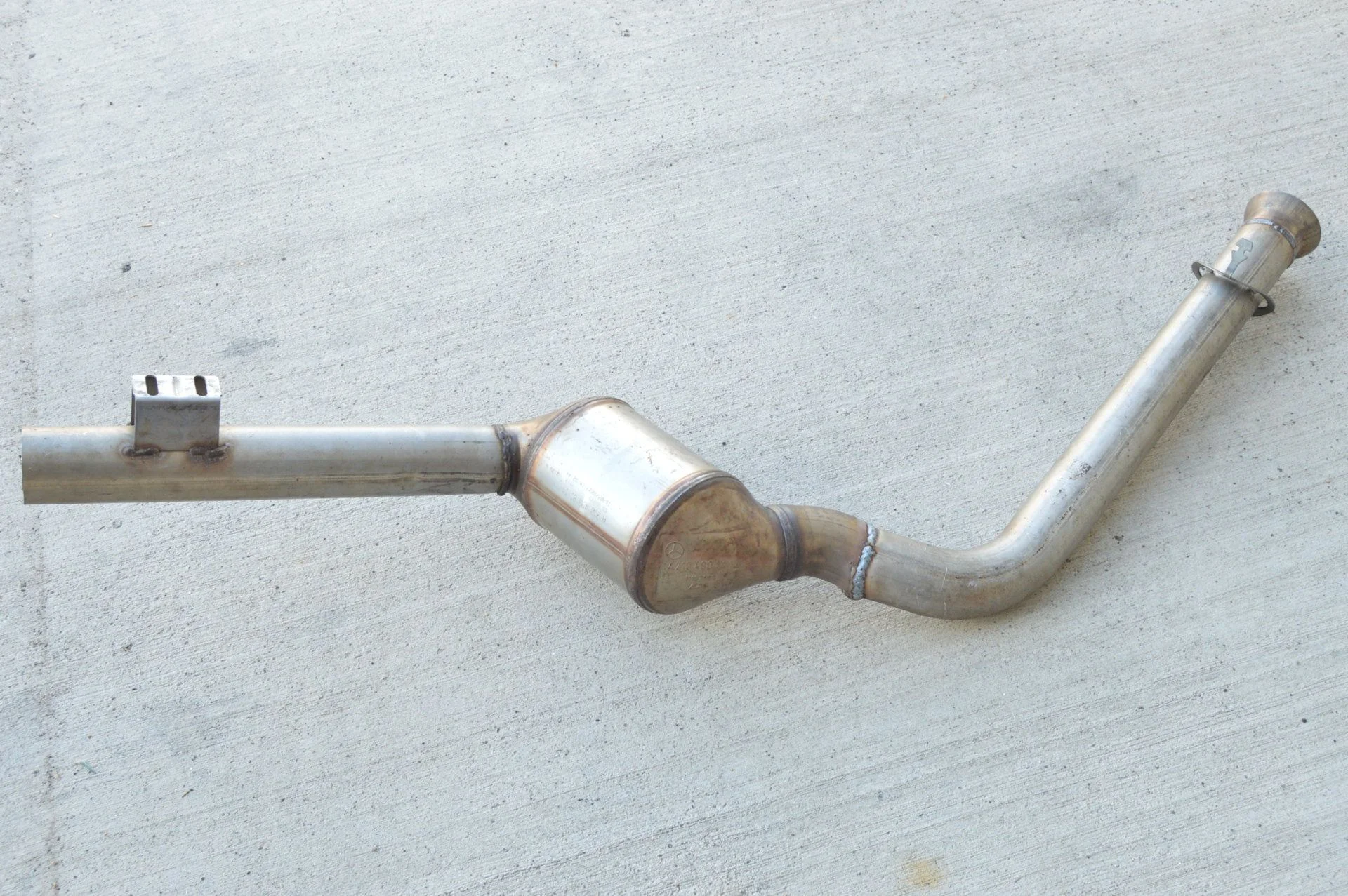

The exhaust is fabbed to the point where I'm comfortable driving it. Getting closer!
I made 2 cuts in the stock downpipe, and re-welded to fit perfectly where the OEM exhaust routes. The cat is tucked neatly above the lower pinch welds and doesn't affect clearance like the original setup.

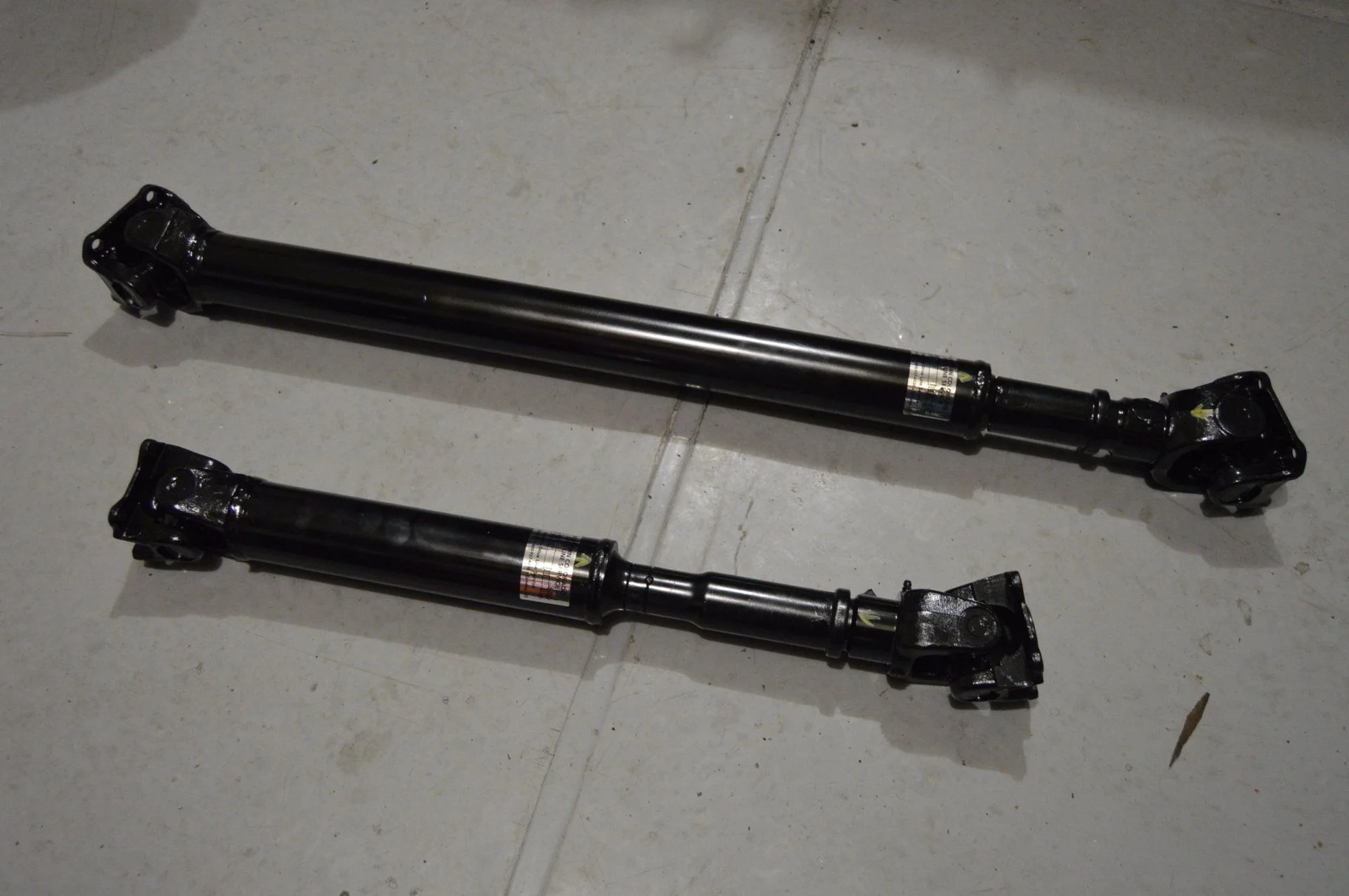

Here's the shortened/lengthened driveshafts.

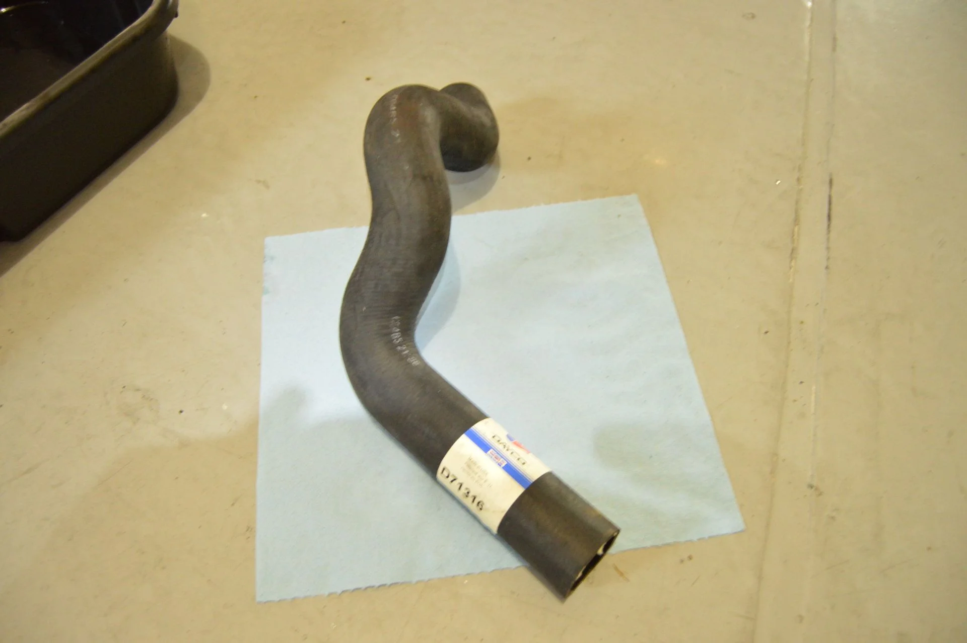

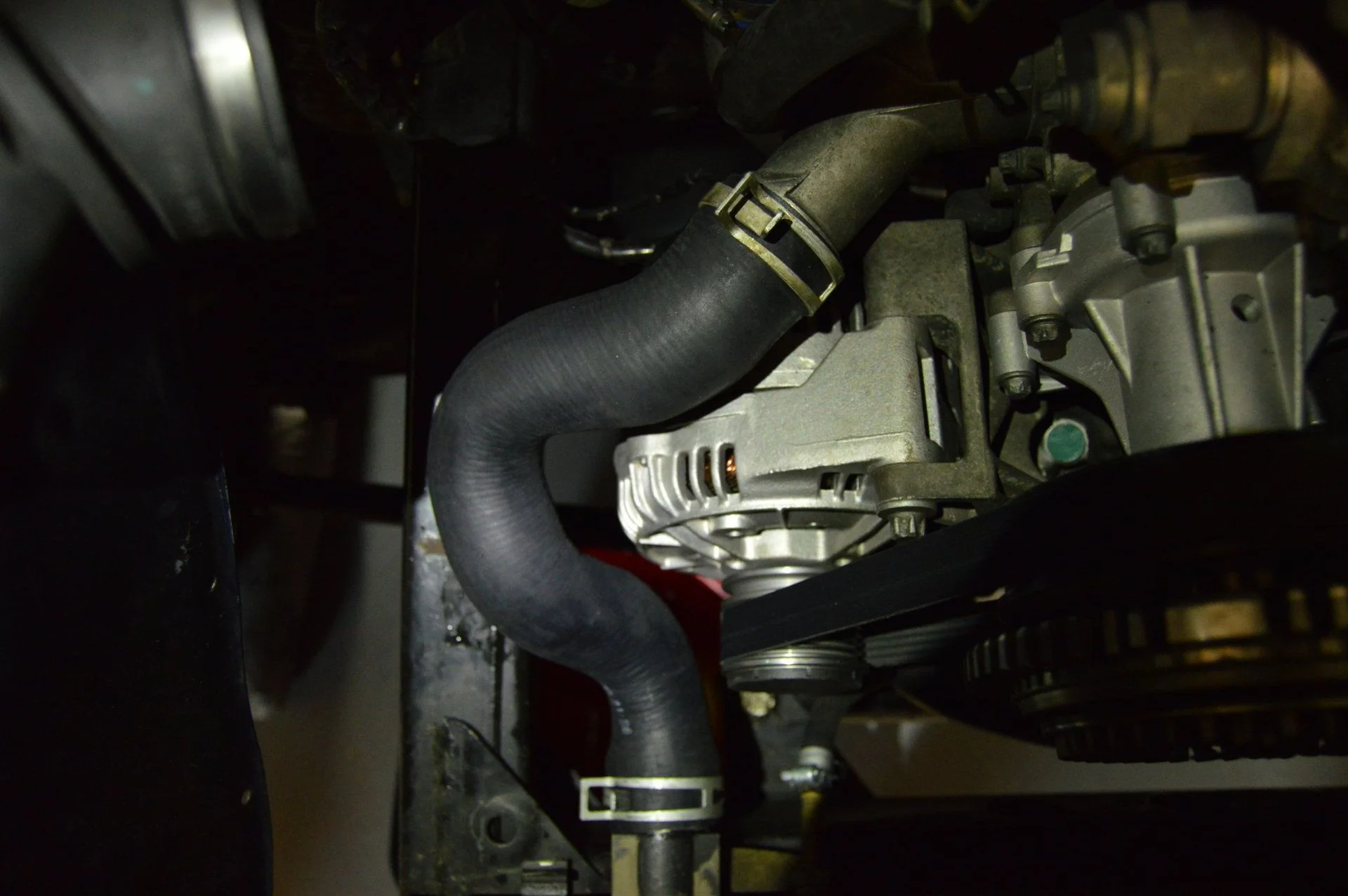

I wandered around the local NAPA until I found the perfect lower radiator hose. It fits great with a bit of trimming.

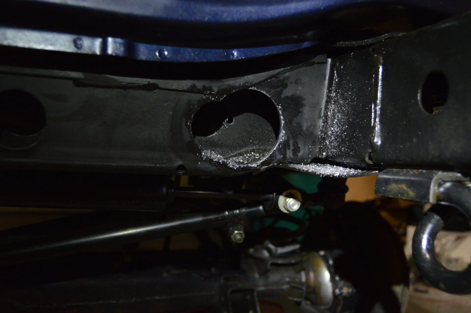

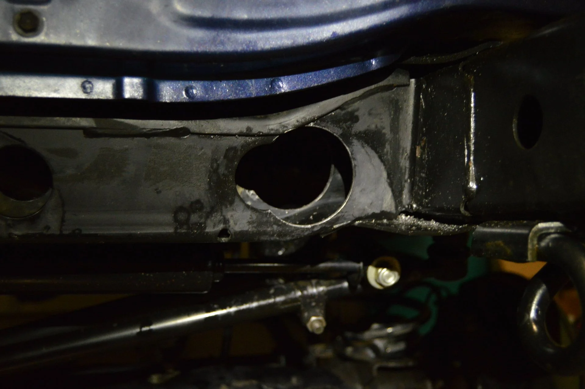

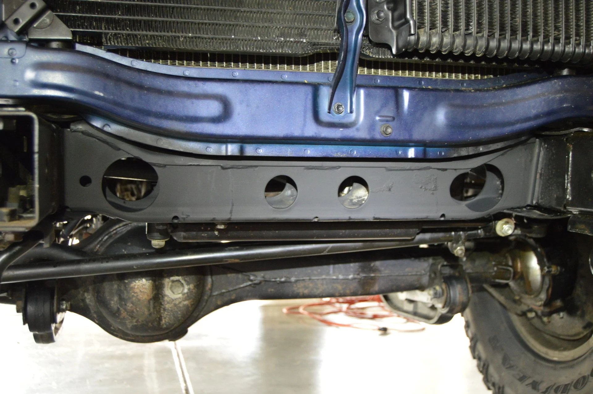

I went around and around trying to find out the best way to route intercooler pipes. I finally came to the conclusion that the only good way involves going straight through the front frame crossmember. I'll add re-enforcement later but I think there's a good amount of strength for a non-critical part of the frame.

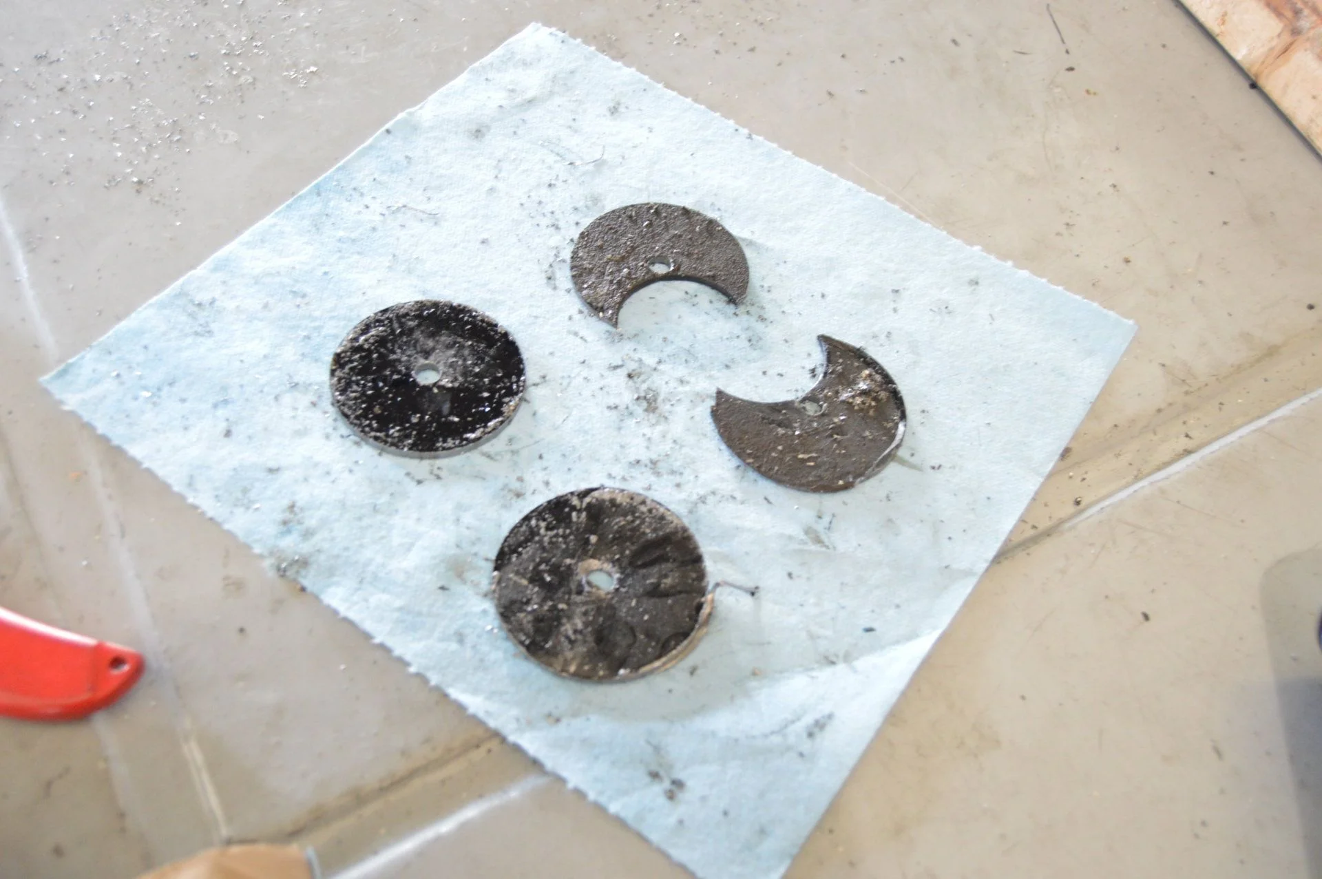

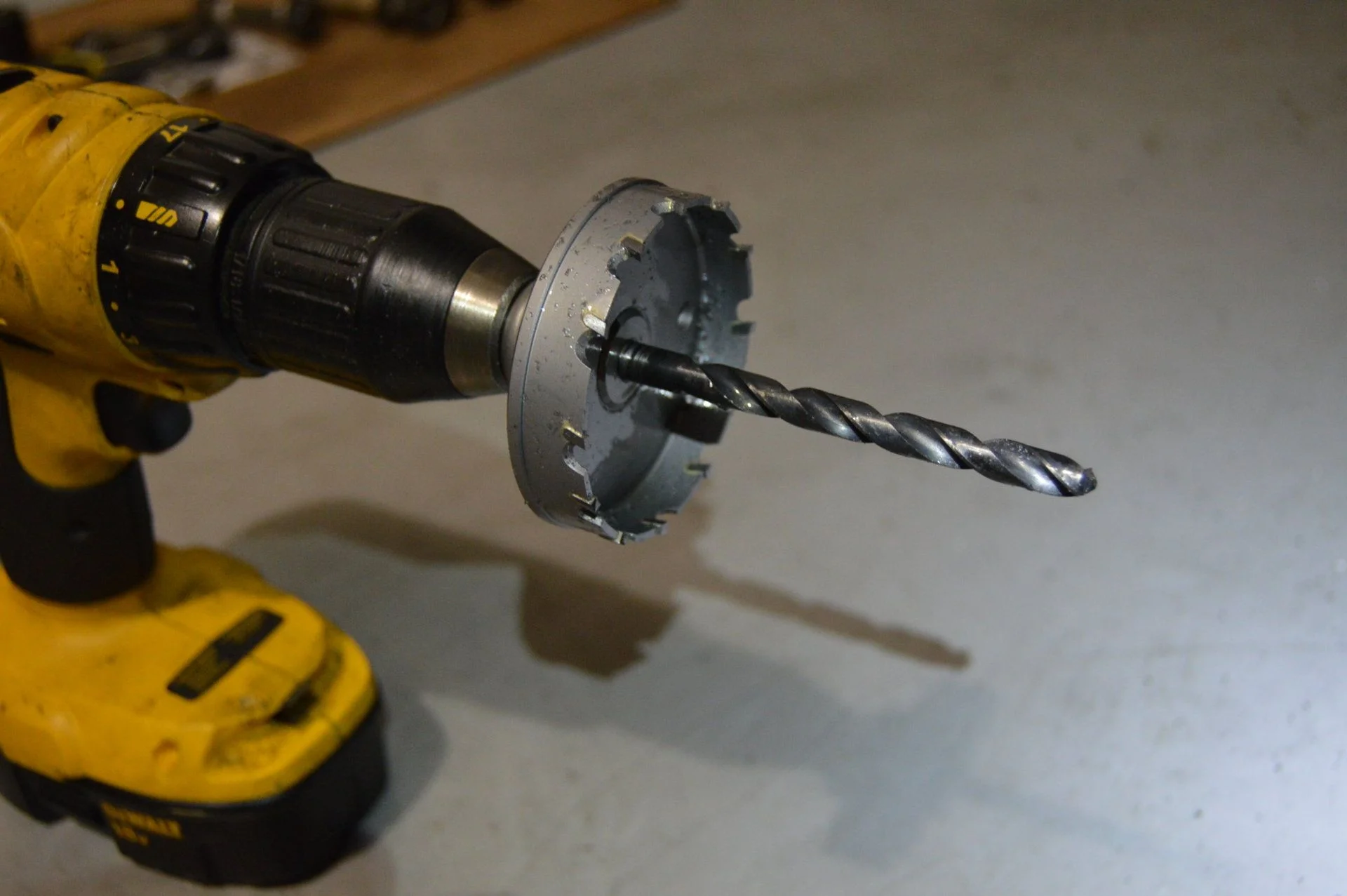

Here's the $75 hole cutter. Hole saws (even bi-metal) will not work at all for this type of cut. This tool made the job pretty easy. Just some time and lots of WD40
What I actually cut out:

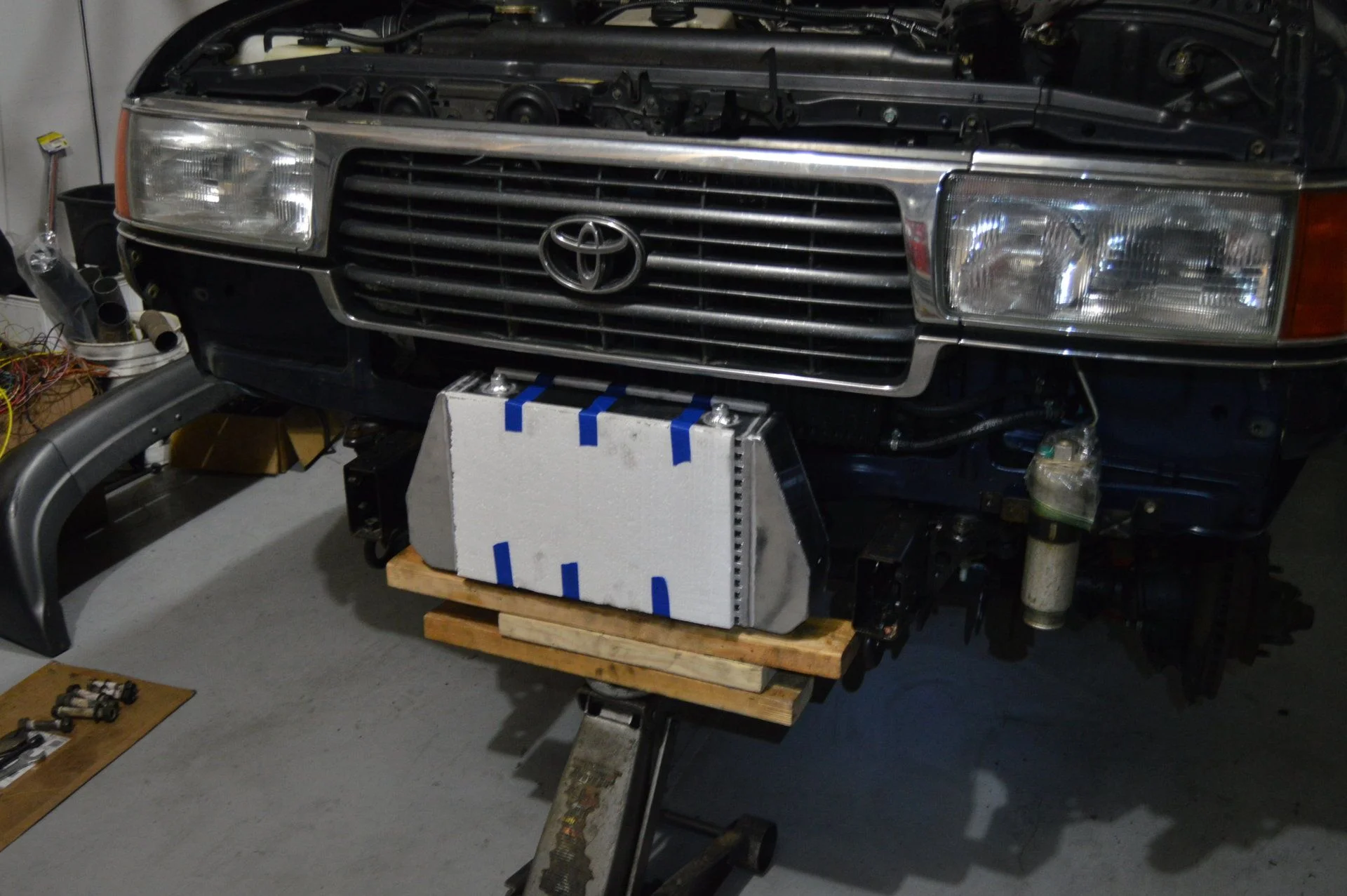

Next up, actually mounting and plumbing the intercooler. Right now, I just have a pipe that bypasses the intercooler so I can drive it.

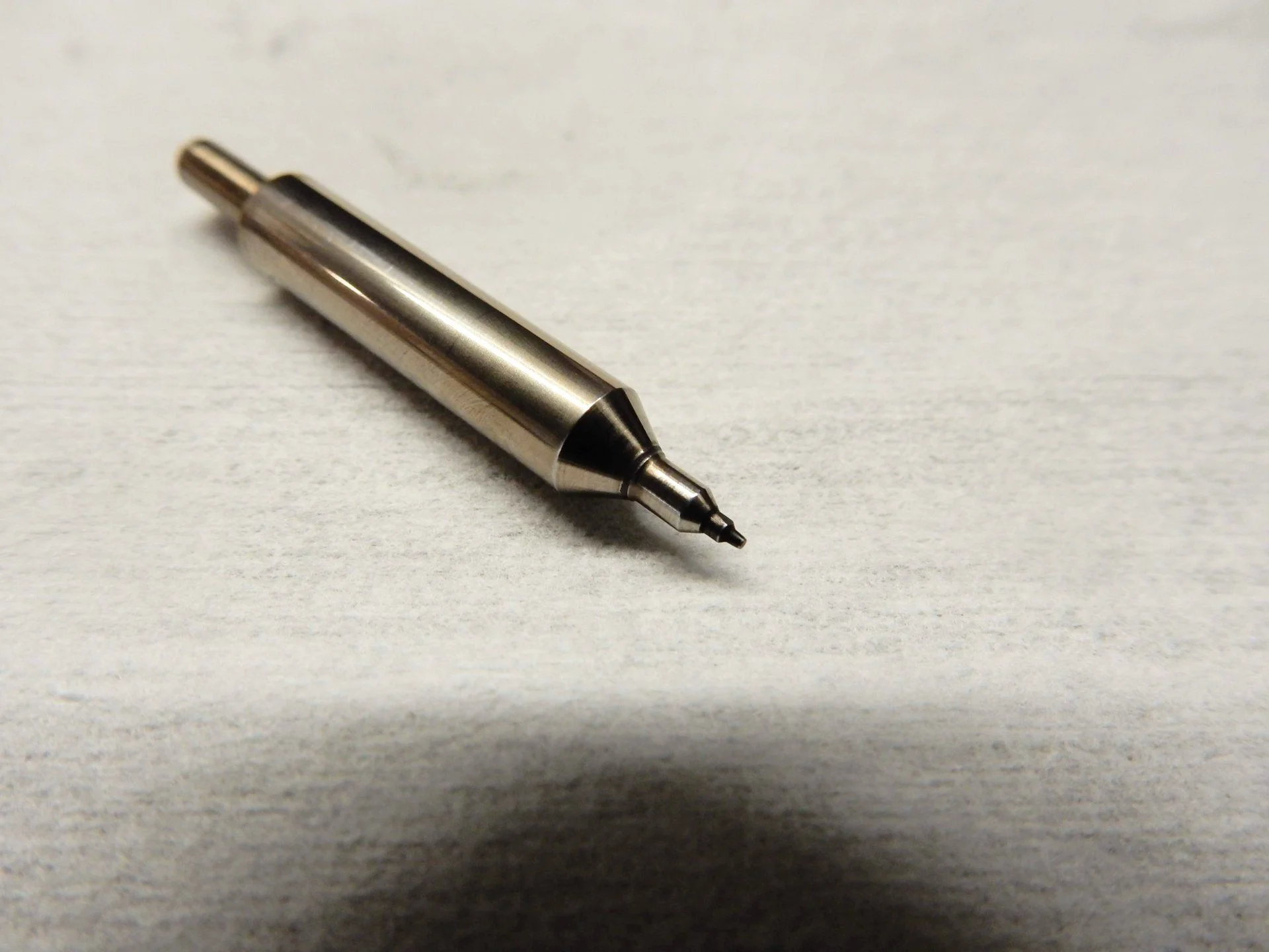

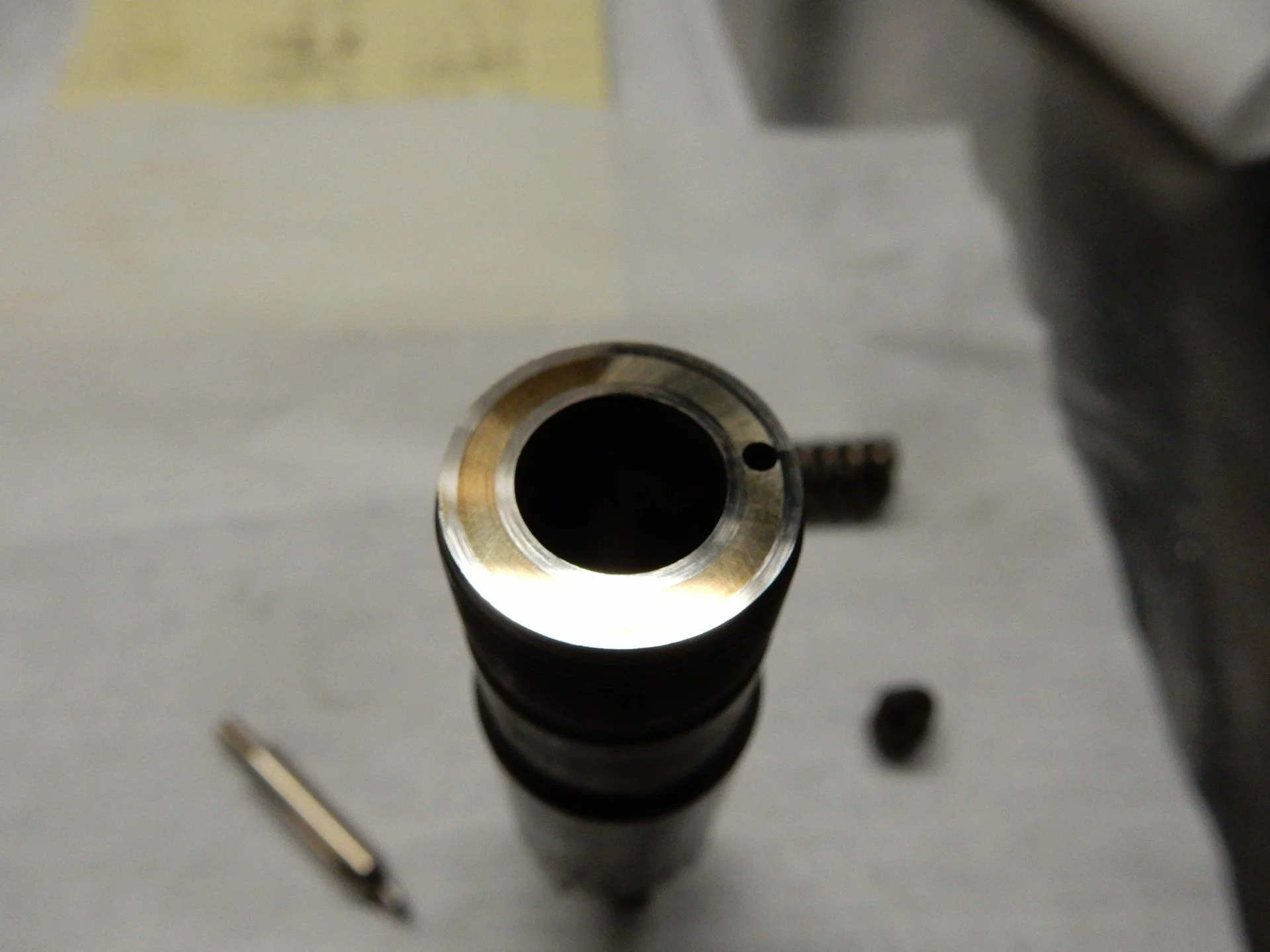

I decided to disassemble and clean the injectors...
Here's all the parts after going through the ultrasonic cleaner:
After they were all clean, I lapped the surfaces with 30 micron sandpaper:
Before:
After:
For the pintle, I used 5 micro sandpaper to remove the minor varnish.
It should be back together with the intercooler this week.

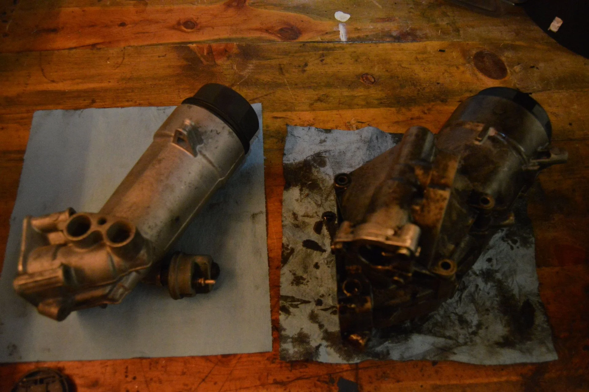

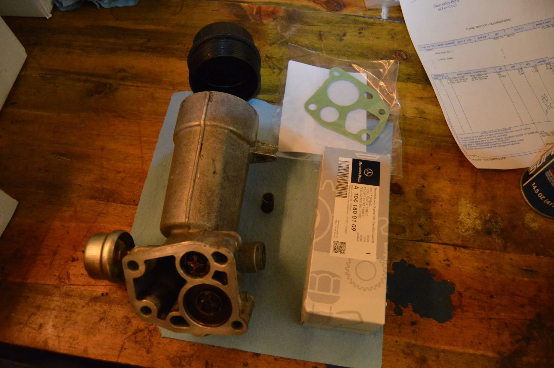

The 606 has an oil filter housing with integrated oil cooler thermostat and lots of leaking gaskets. I decided to simplify things and get rid of the semi-janky top mount oil cooler, and eliminate some possible failure points by switching to the M104 style oil filter housing. Yes, I'm getting rid of the oil cooler, but I'll just run synthetic oil to combat oil degradation due to heat.
M104 left, OM606 right

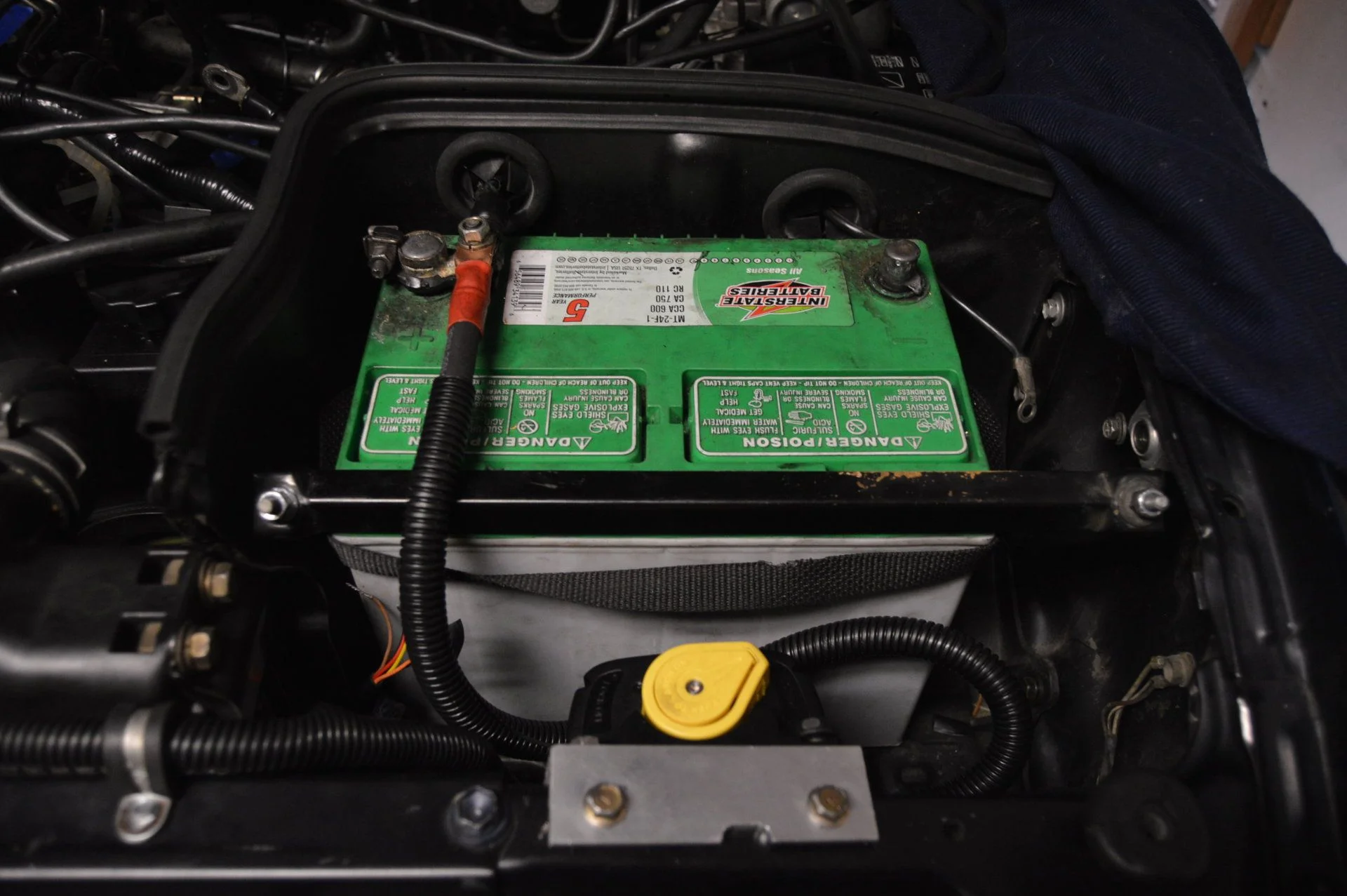

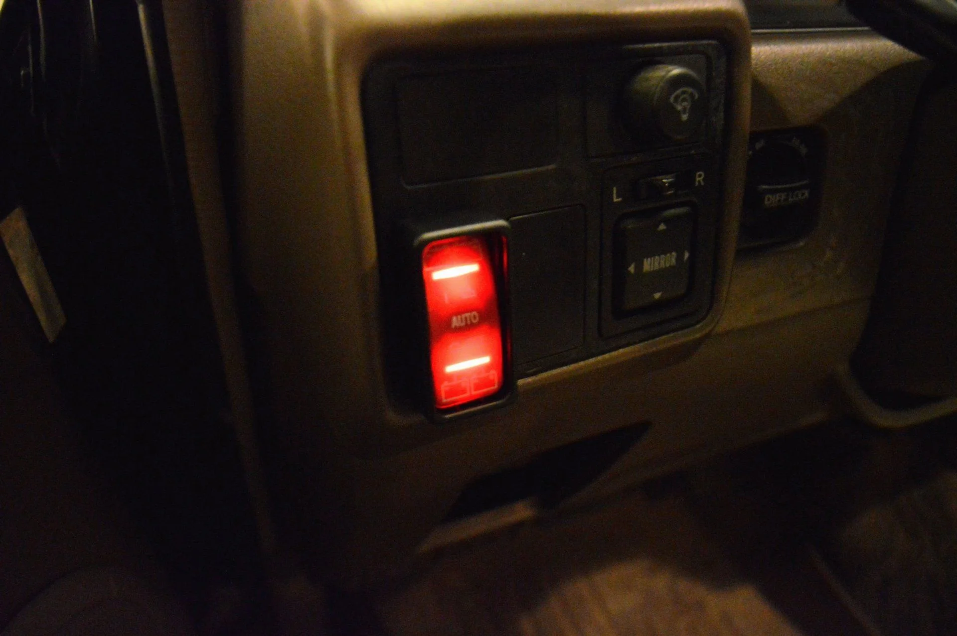

I've never had a dual battery setup that I felt good about until now: the Blue Sea 7622 ACR. It's got tons of cool features including a nice dash switch to combine and separate the batteries.

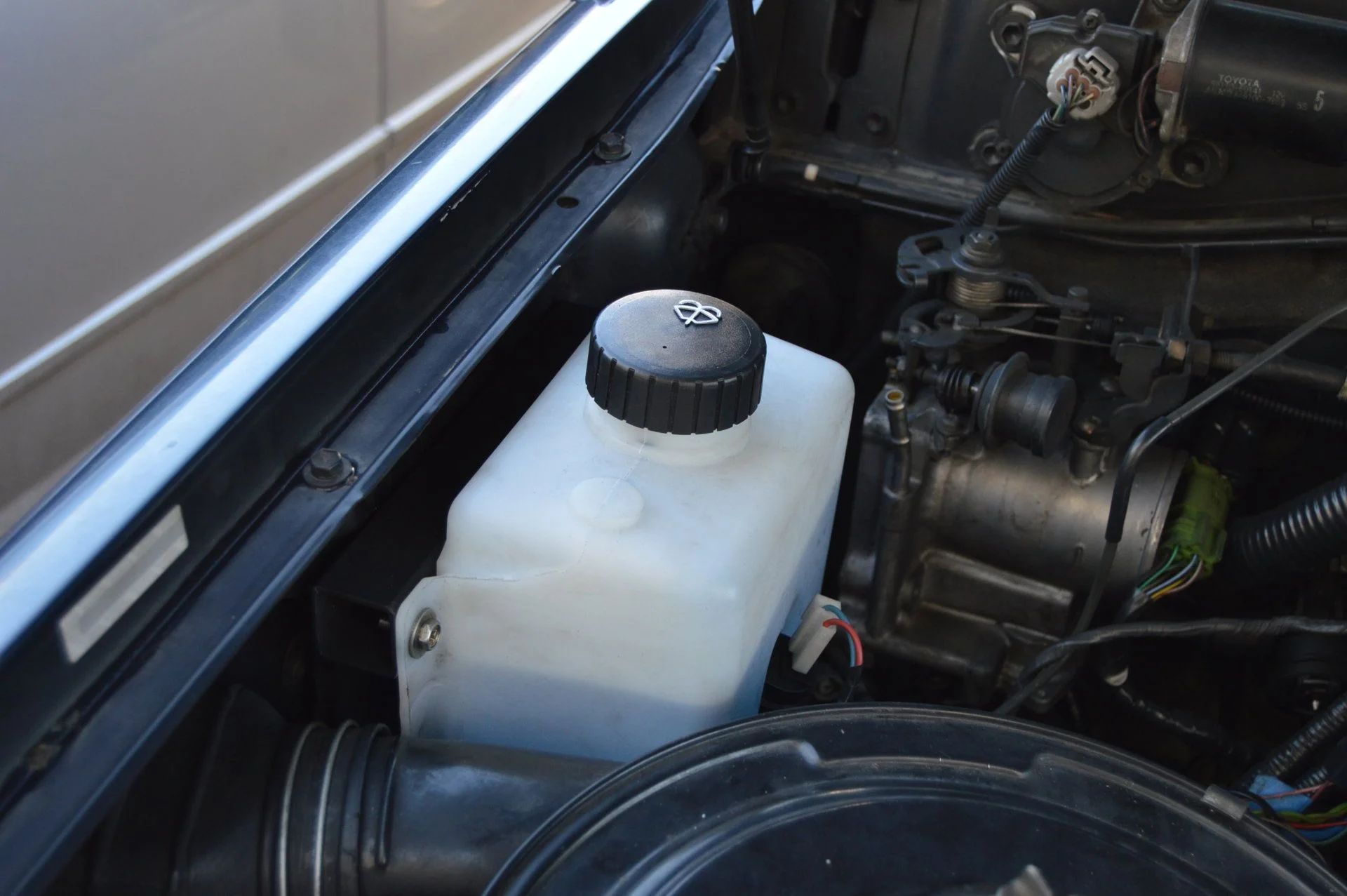

I couldn't do the usual washer bottle relocate due to my vestigal throttle body, so I bought an aftermarket tank made from US Plastics (P/N 14140), then made a bracket using a piece of 1 1/4" square tubing in place of the cruise control actuator (which I've deleted)

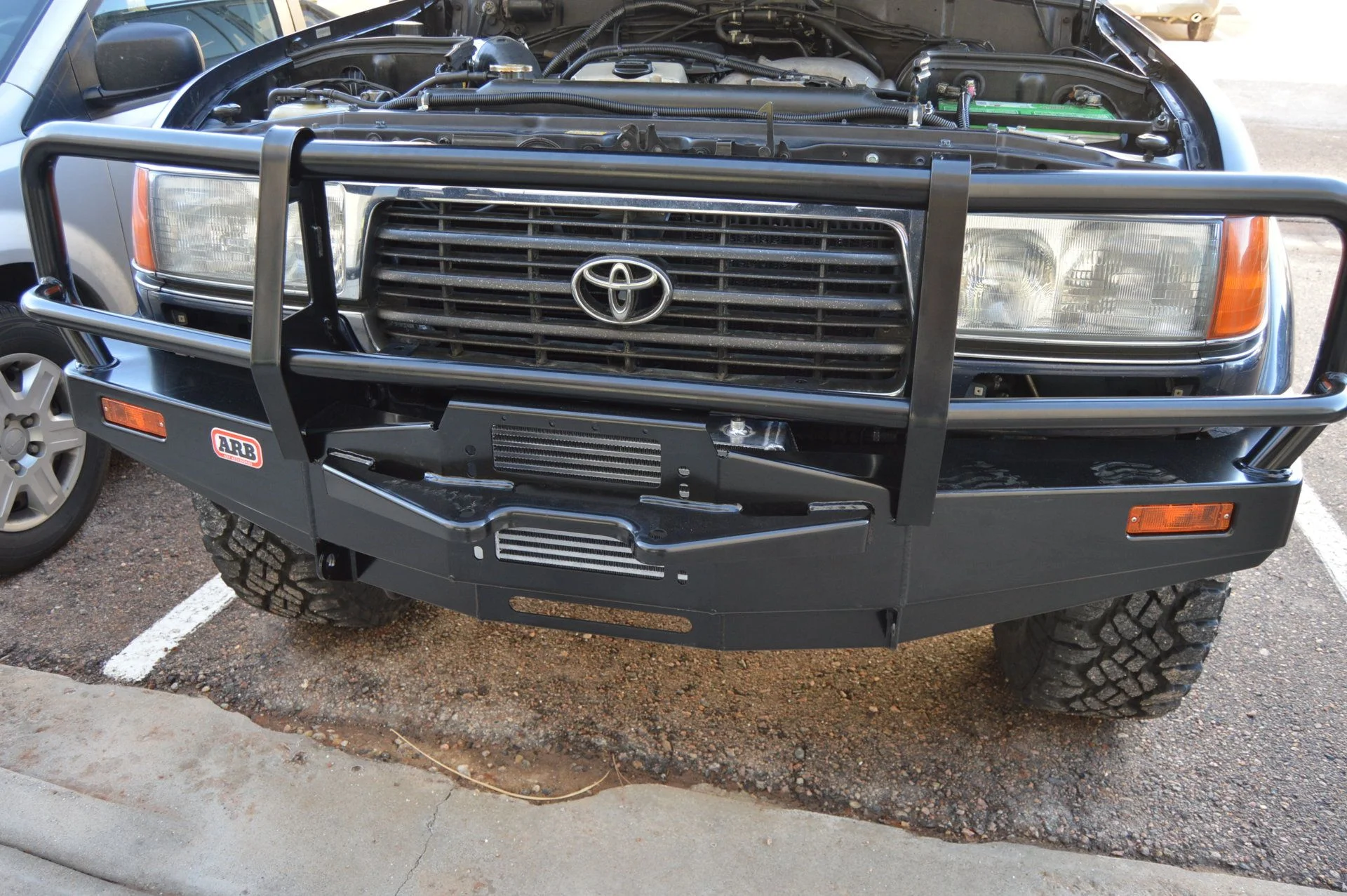

New ARB bumper with FMIC hiding behind:
