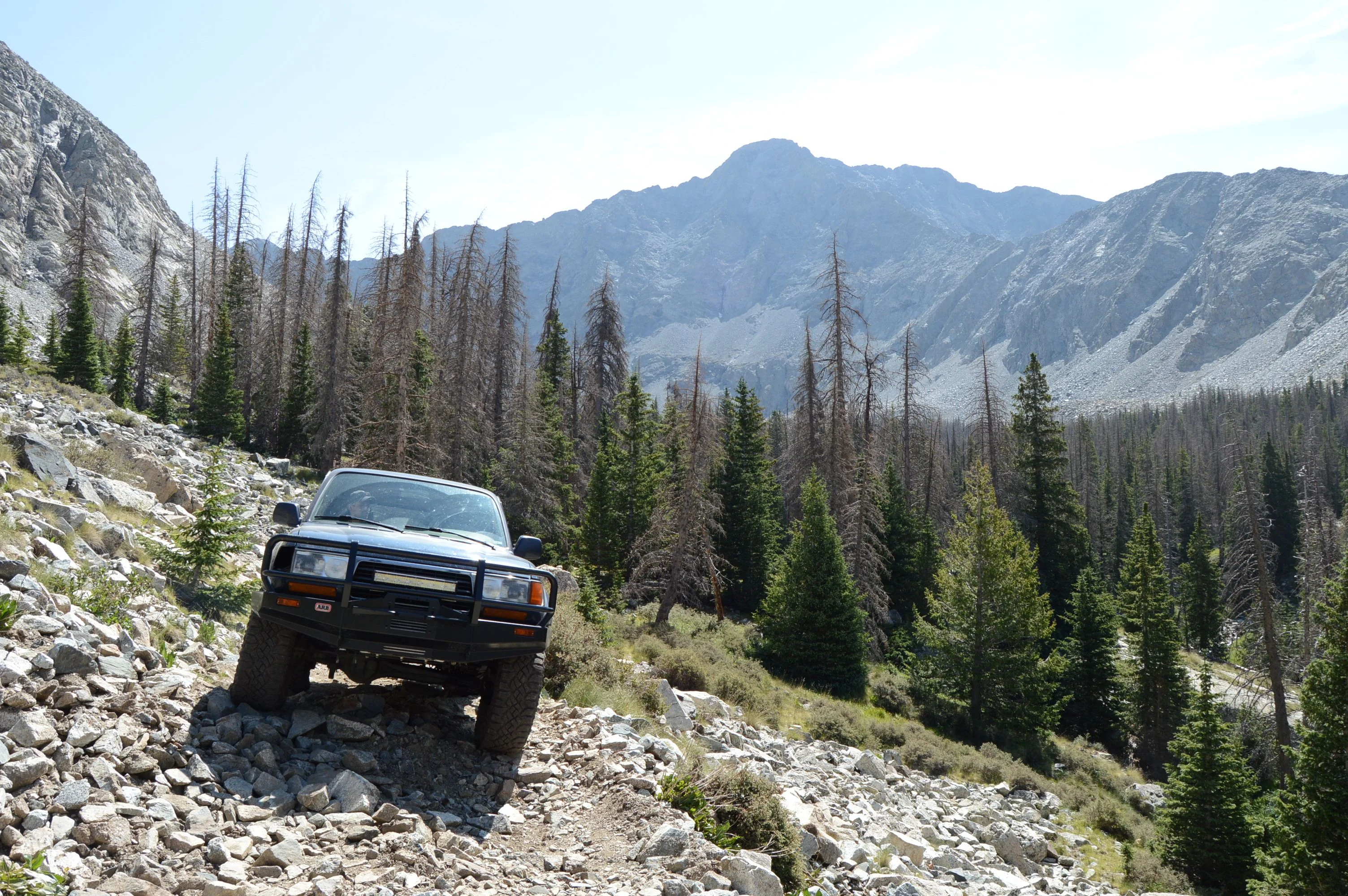

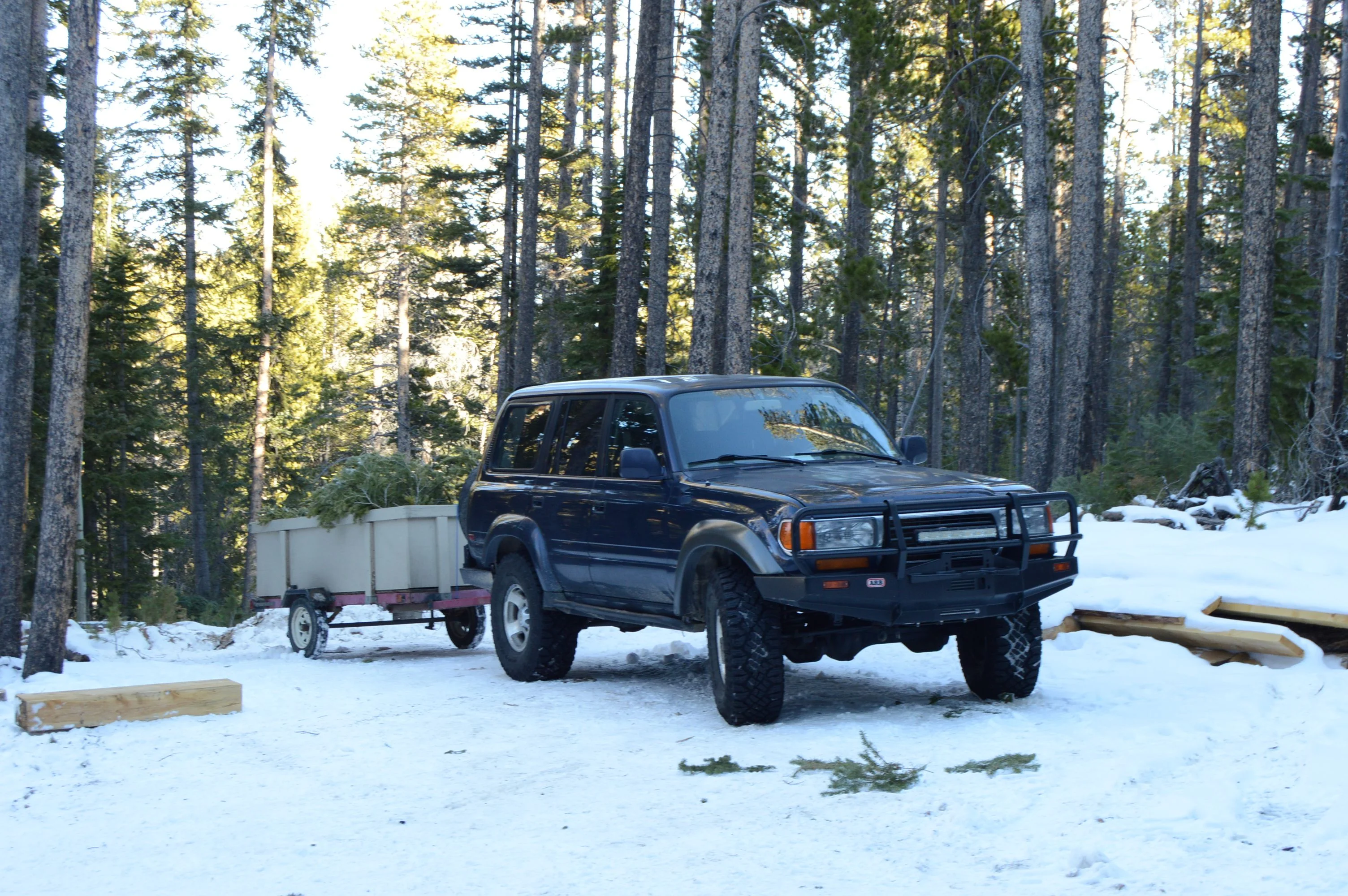

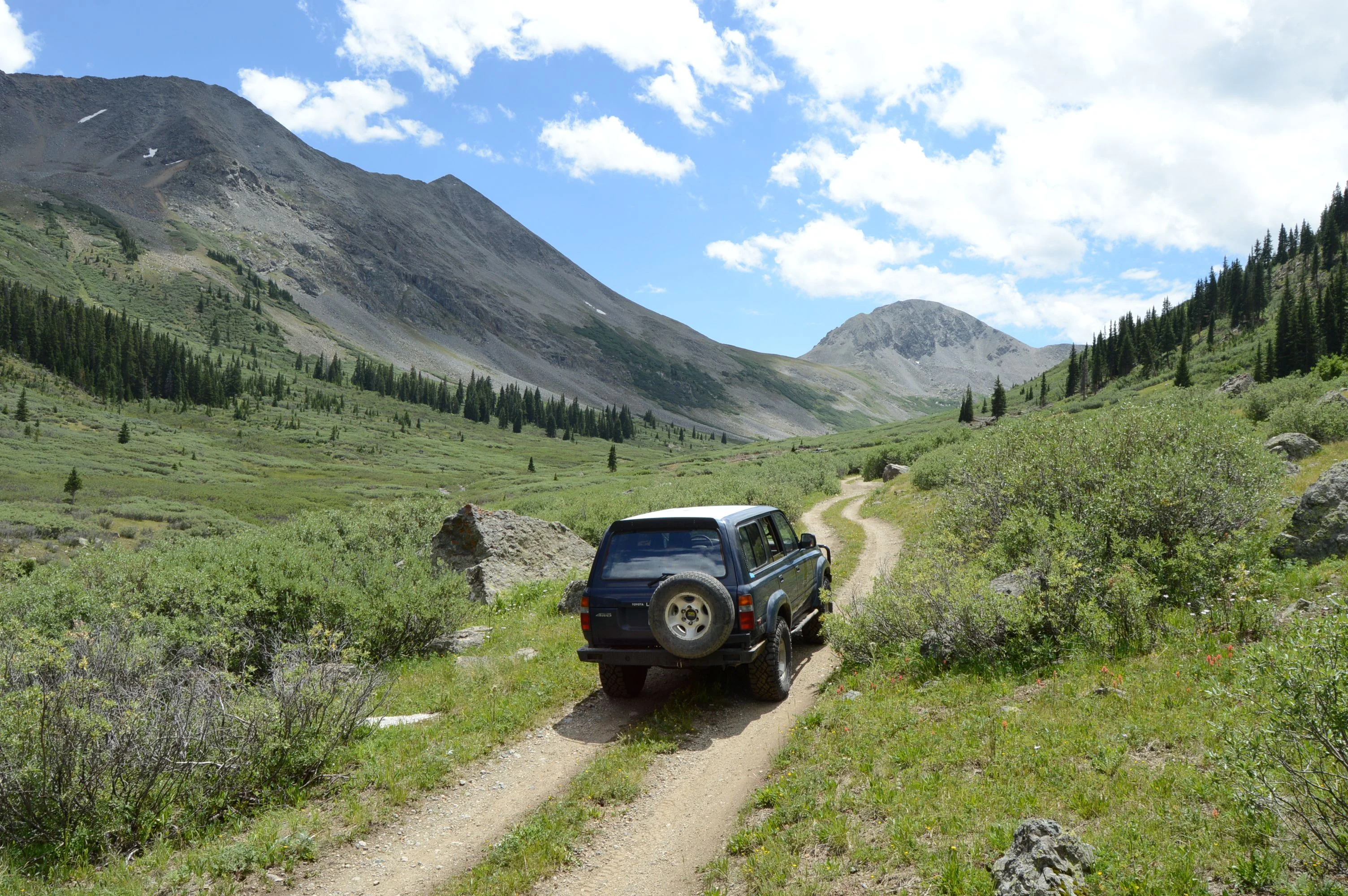

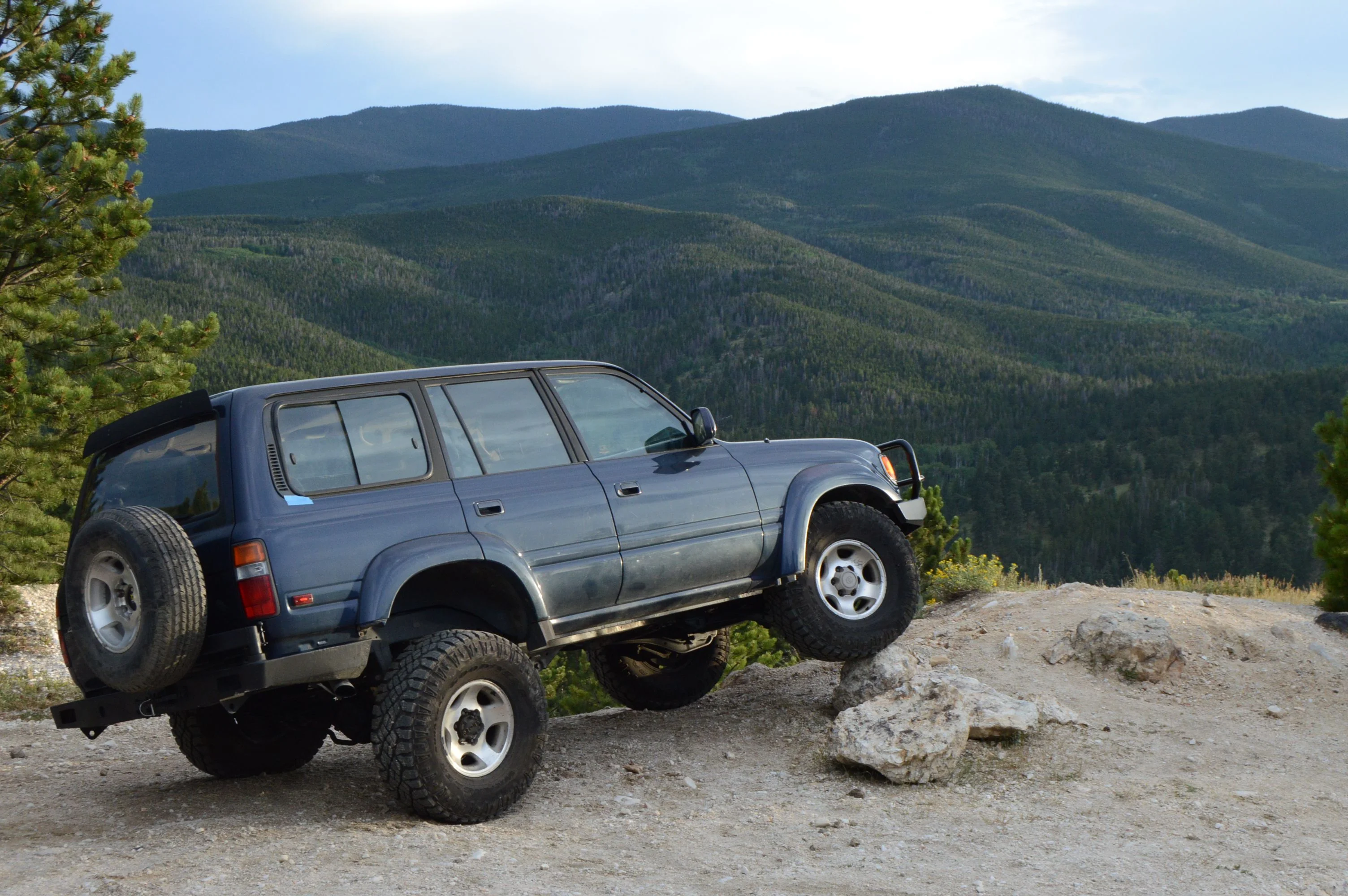

The 606 is a really fun swap, but with 5.29's, it really needed a taller overdrive on the highway so that pushed me toward the 6L80, which meant a different adapter plate and so I figured I'd go to the newer motor at the same time. I was sometimes pushing the limits of cooling on the 606 here in CO where we have 12,000' passes at a 6% grade and 65 mph speed limits in the summer. For basically any other area of the country the 606/A343F is a great combo, just not the best fit for the really demanding needs that I have. I'm an engineer so I'm fairly picky when it comes to this stuff.
It always did awesome on the trail and I did a ton of wheelin' with this setup. Total I've put about 18k miles on the setup.
Here's a few shots of some of this past year's trips with the setup:
