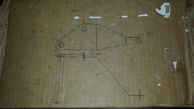

I made my cartoon box cuz the real one wants to smash my face or hands.

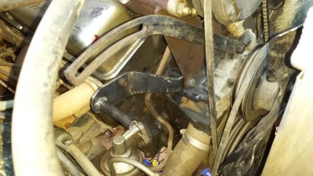

I have the mount for my box mostly welded on. I took a break and decided to tackle the moving of the alternator to the pass side. I found a good spot and fab'd a braket. Dont laugh, I used a cutting wheel, mapp gas and some brawn.

I decided to add a little strength to the alt bracket and relocated the wiring from the driver side. I also finished the final resting place for the steering box. The box is in temporary in this photo so I can look at steering column ideas. Im about 75% done with the ps pump bracket too (photos soon).
Falling, falling further down the rabbit hole. The pump and alt are in and brackets came out good. Need a new pulley for the pump no biggie. Got a high pressure hose for 16 bucks that will work with minor tinkering. Located a samurai steering ujoint for 14 bucks that will make my column almost complete. Thats all the good/goodish. My issuses are as follows:
