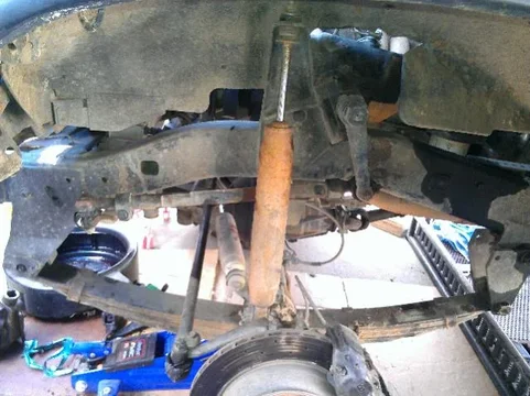

I have looked but I am sua in the front ATM. If I do any change I will go radius arm. I'm just looking for as little invasion as possible. I may just take em off and see if they bolt back on. I just think the PO put too wide of rims with not enough back space. 15x10 and 3.75. I like the look but if I could find a cheep set of 8 inch wide. This is a pick of the control arm.

I started the easy part, dismantling.
BEFORE
AFTER...1.5 BEERS
