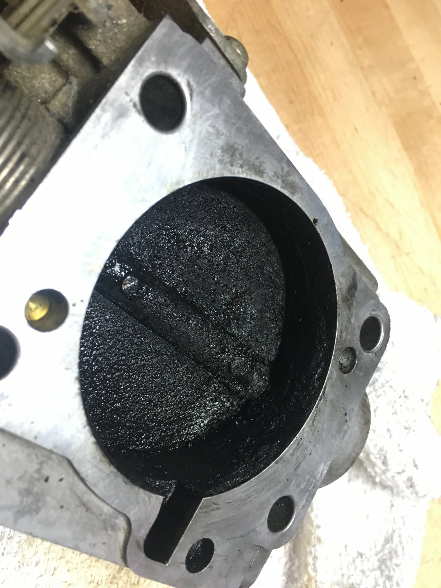

The plate is closing sharply with a nice clack onto the stop. If the tabs from the TB plate fit into the slots on the TPS, it would return it to closed. Seems like quite a few have tried to install it that way then seeked help based on my searches. I would have done the same thing if I hadn't searched it first. Seems logical they would fit like that.
wow, that would be a bummer, I suppose...
img_7936-jpg.1578912
I don't see the test feedback on the TPS, other than the initial...did you condemn it based upon the first test, and spring? Might be worth putting it back on the TB and running the other tests...making adjustments to set baselines, then doing the initial test again. I've seen more than a few threads where someone found or guessed that the TPS was bad and replaced it with a new one only to have further issues with the new one because it still needs to be adjusted to spec... Just making sure I convey my reasons for questioning so you understand why. I think there is a lot of initial misconceptions for newbies when it comes to the new sensors and what they are doing, when moving from carburetors to EFI, and that a lot of these TPSs get falsely blamed without full investigation. HTH
If the TPS isn't going to hug the throttle plate linkage during movement, it's no longer a TPS and all other checks can stop. A good one will snap back to closed when you turn it by hand.
I might have given you the wrong impression about my newbness...this is my first 3FE, not the first FI vehicle I've wrenched on:) My fault not yours.

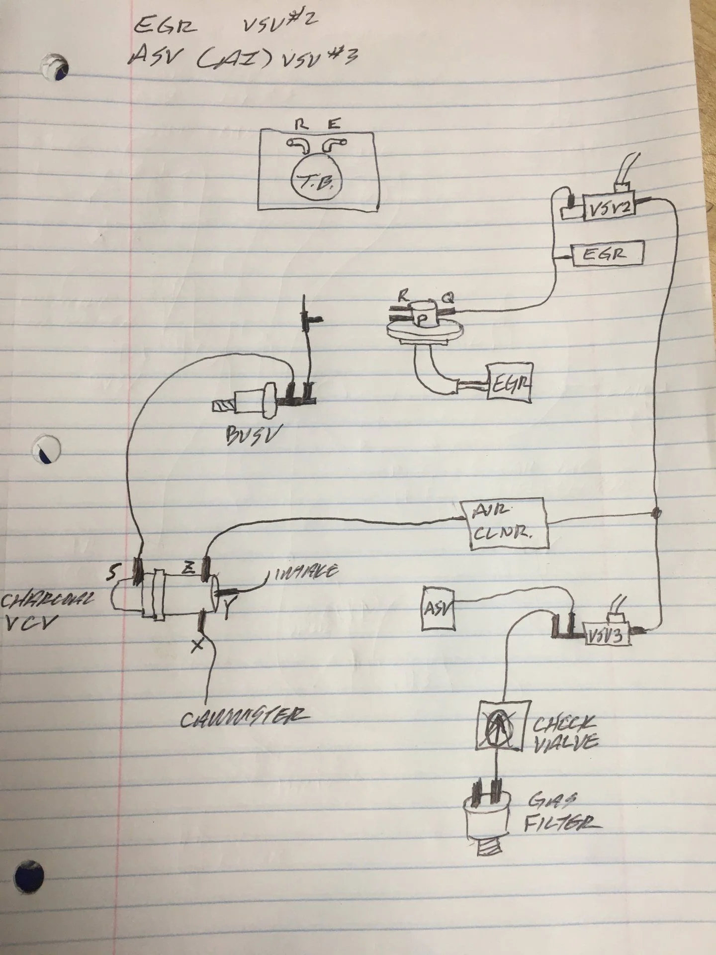

I need some help with this EGR vacuum routing please. It's a little different from the 2F operation.
1)This one, 'Q' is routed through the VSV and the VSV plumbs to the air cleaner?
2) 'R' and 'P' on modulator hook up at throttle body ports 'R' and 'E' with one of them teeing into the BVSV...which one routes into the BVSV and does that then go to 'R' or 'E' on the Throttle Body?
I'm using the '1988 New Features FSM'.

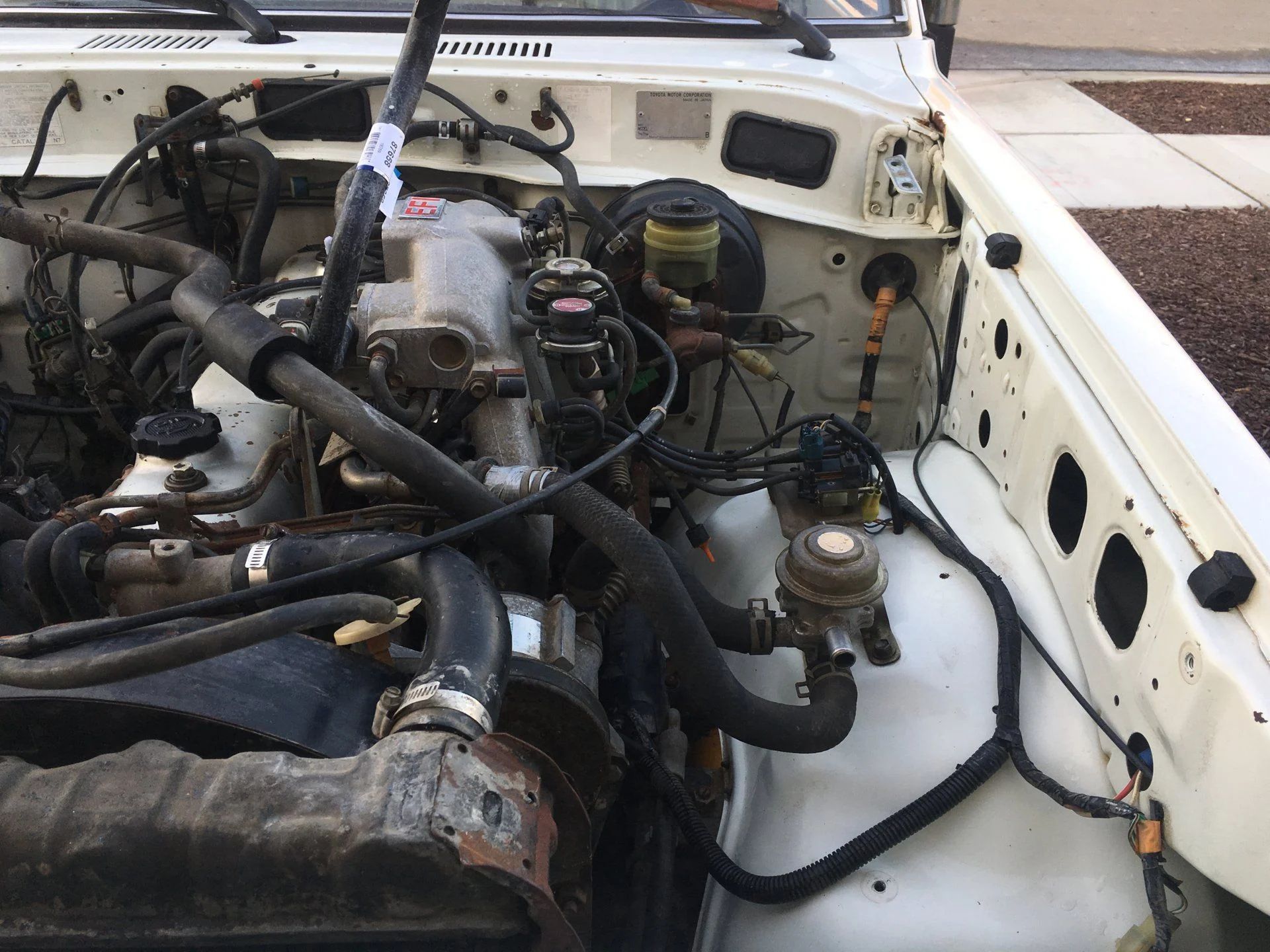

It was about 70 degrees here today so pushed it back into the driveway and scrubbed the engine bay. First parts order will go out Monday, vacuum tubing should be here tomorrow, hoping for a startup by next Saturday.
