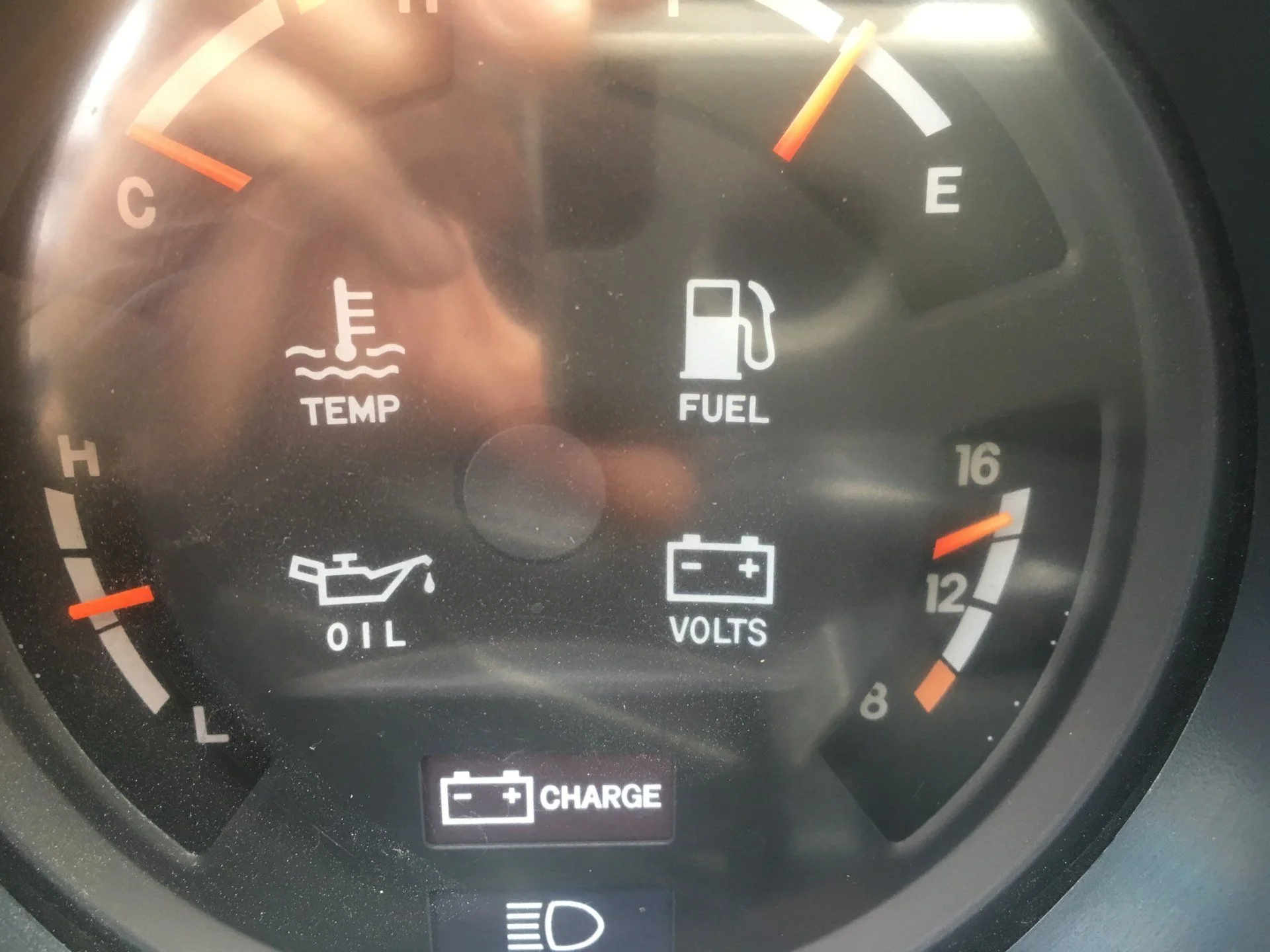

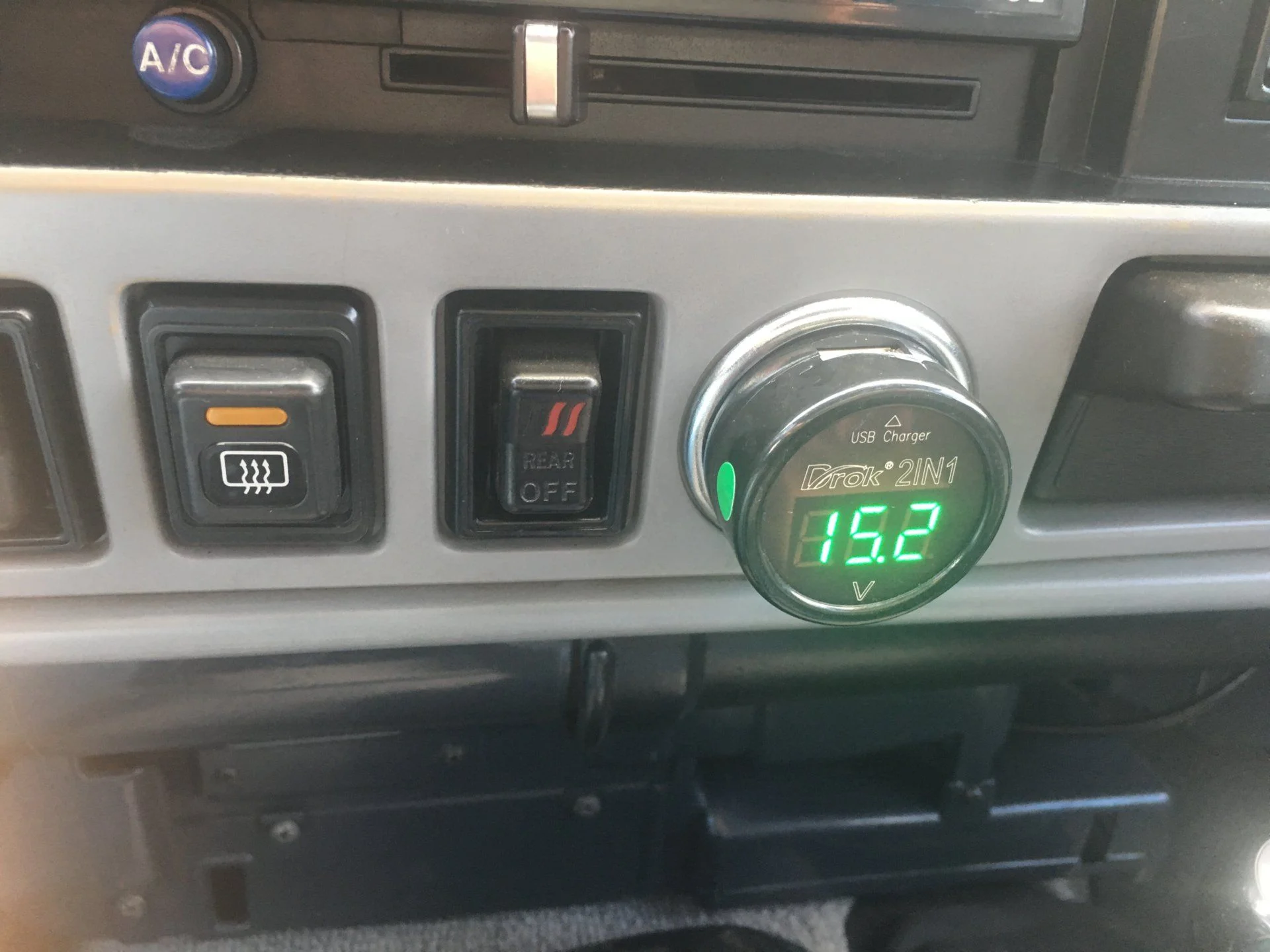

I think that your voltage is too high. Stock alternator and ic regulator should be putting out 14-(EDIT) 14.7
You’re right, It’s running a bit high at 15.2V. The gauge is to 16 with the hashmark being 14 so it’s reading pretty accurate. Thanks for looking out.
My bad, Marc I started that... I saw the gauge as 18 and told him. Musta been the angle of the dash on your video. My apologies for being an instigator @g-man and @mwebfj60.
Yeah, she told me this...
I have a very evident click click noise from my wipers. I’ll have to check all my contacts too. Wouldn’t it be fun to get the volts up to 18 like @mwebfj60’s 60?
and I had flash backs of a friend with a 66 t-bird who's voltage regulator went. His volts were right up there around 18v ...needless to say he went through a couple of batteries rather quickly (overcharging) before he figured it out.
Dude, I wish I had that kinda voltage capability...

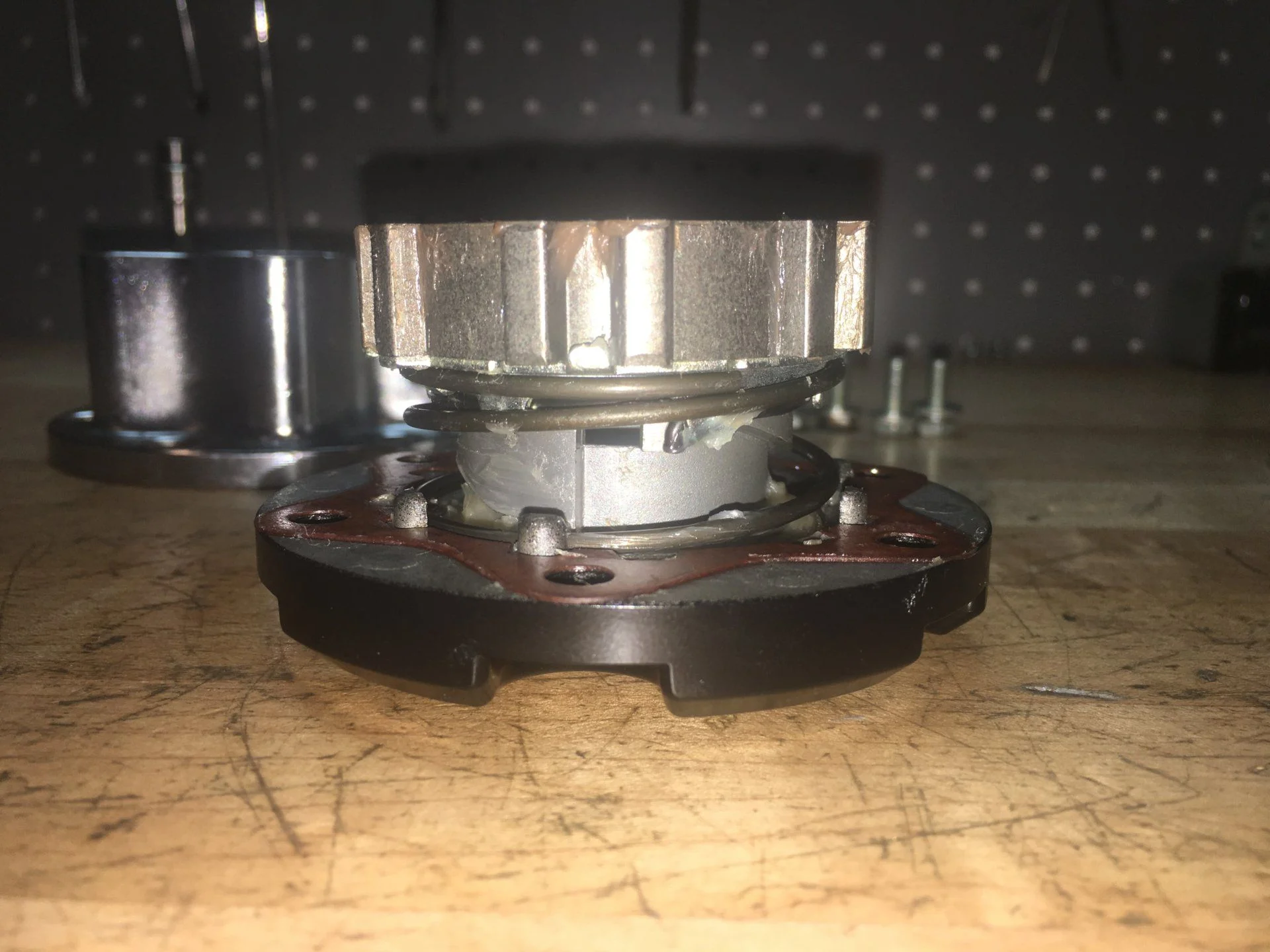

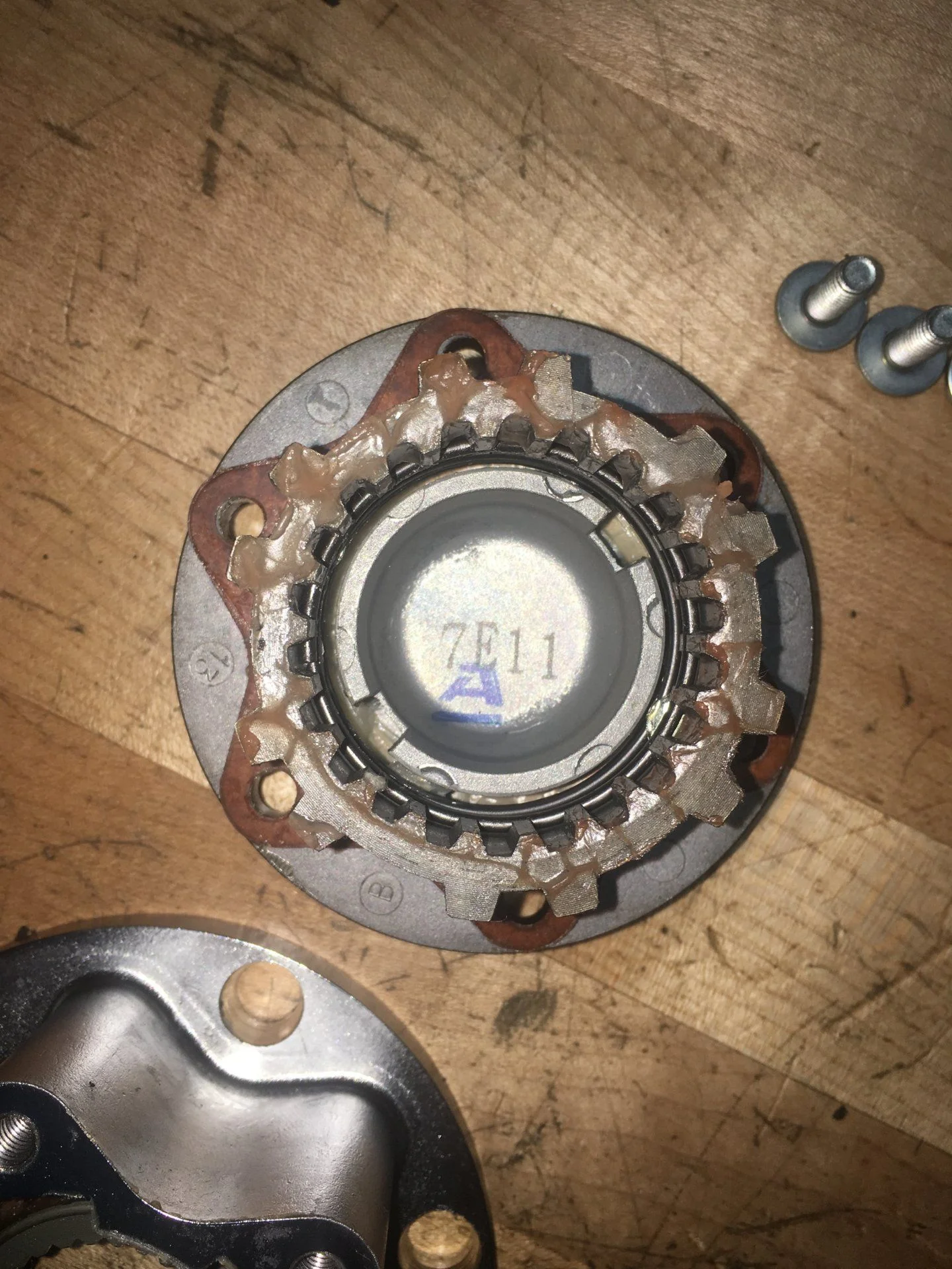

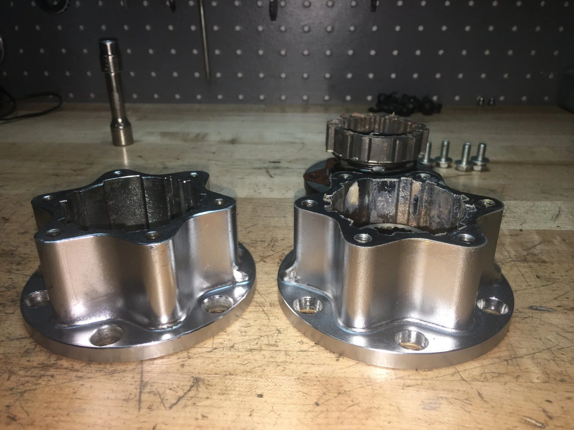

Got around to doing the thirds and putting the stock hubs back on the 60 and realized one of the covers was broken. Found these when searching for parts online and gave them a shot. The quality is very good. AISIN FHT-013.

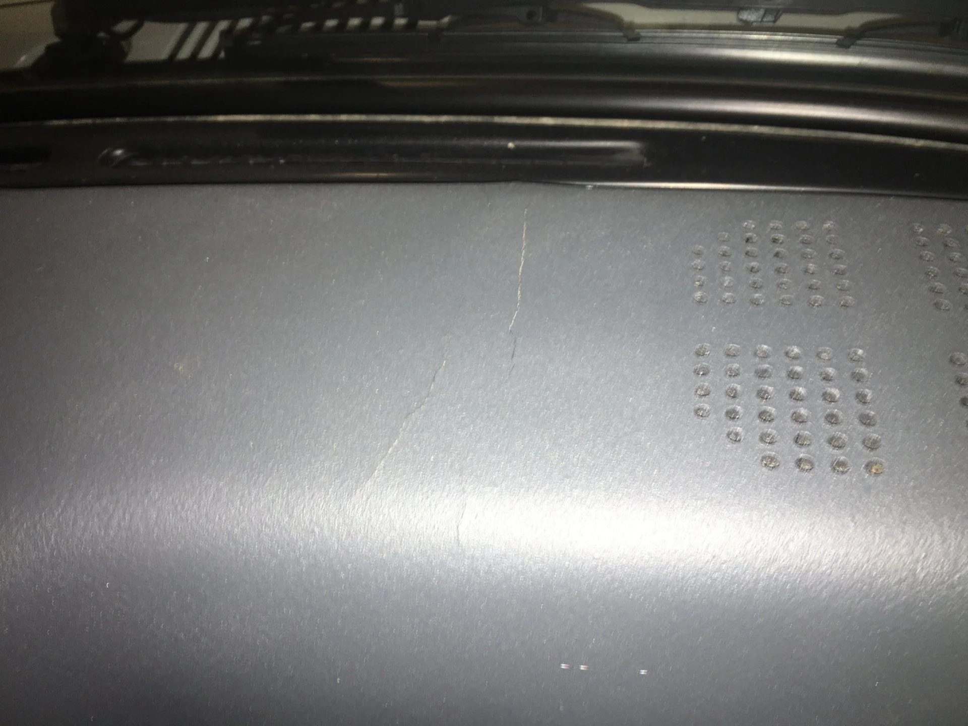

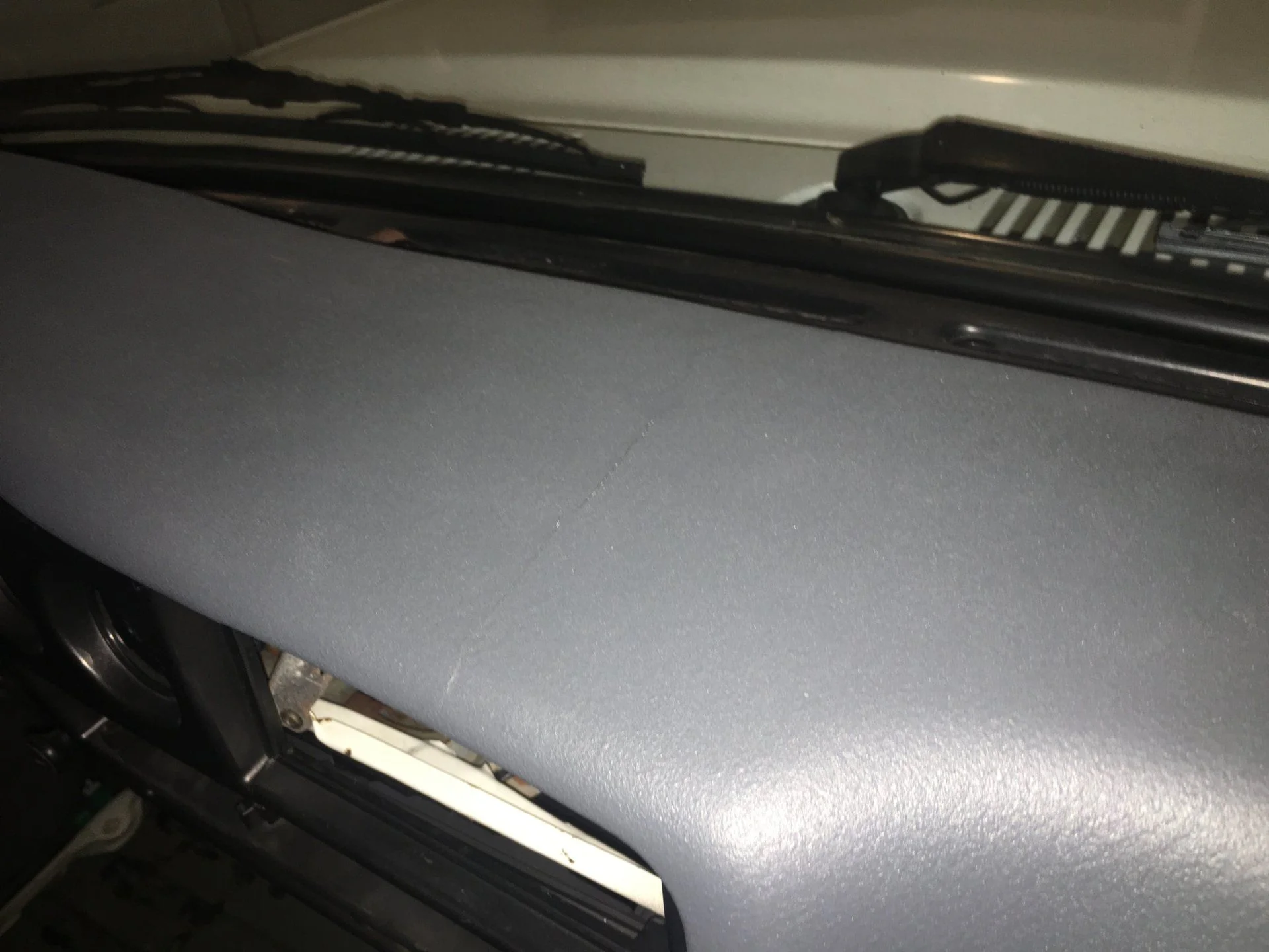

An update on the dash pad repair....it has started to crack so the repair didn’t hold up. I think it would on a dash that wasn’t so far gone.

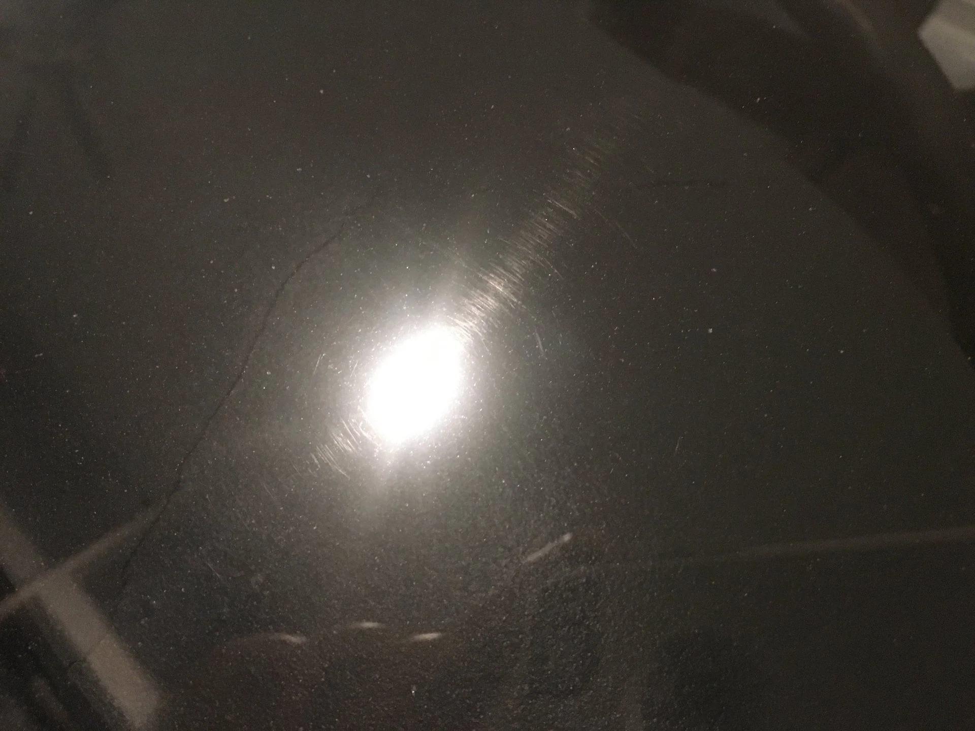

Pic through the windshield, hard to see but there’s a solid crack there. Bummer
They are available new. I will take your cracked one if you decide to replace it.
I may have to accept defeat and go that route. I’ll be by to see you one of these days.
Boo on the cracks man!!!! I am scared for mine once I pull the dash and start working on it as mine is pretty bad. Had originally planned on recovering with vinyl but after watching yours and then looking at how bad my dash is in comparison, I think I may just go with one of the SOR caps and call it good.
