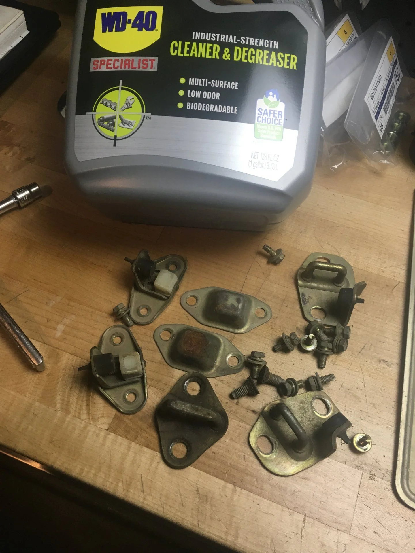

Nice... any more expensive than the Simple Green Pro HD (Purple)? Got my buzz box last night (6L version) and going to grab some stuff tonight for cleaning and throw my old carb in it.
Funny you mention the glass, I did a little test patch on the rear glass last night and was going to do the rest tonight. Good stuff.
The WD40 was $12 at Lowes. It says you can use it full strength but I diluted with 2 parts water. It's milder than the Zep. I haven't tried the Simple Green Purple, like mentioned by @davegonz earlier, be careful with soft metals and discoloring.
Ok, just looked online and apparently my local Lowe's has the smaller cans but not the larger. Grabbing the Simple Green Pro HD (purple) as according to the Simple Green website it (along with the Precision Aircraft cleaner) is supposed to be safe for metals like aluminum.

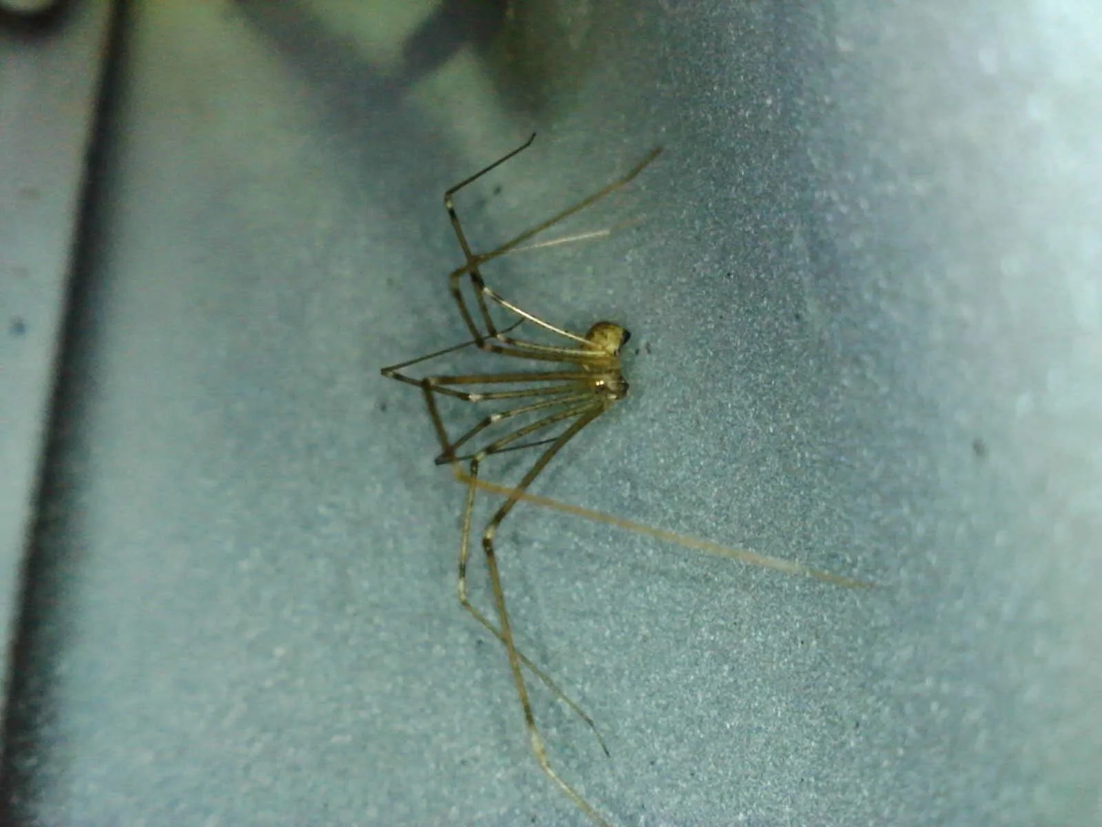

The spider saga...out here we have a lot of Daddy long Legs (cellar spiders) and black widows.
This is what I started with, pretty common cellar spider invasion

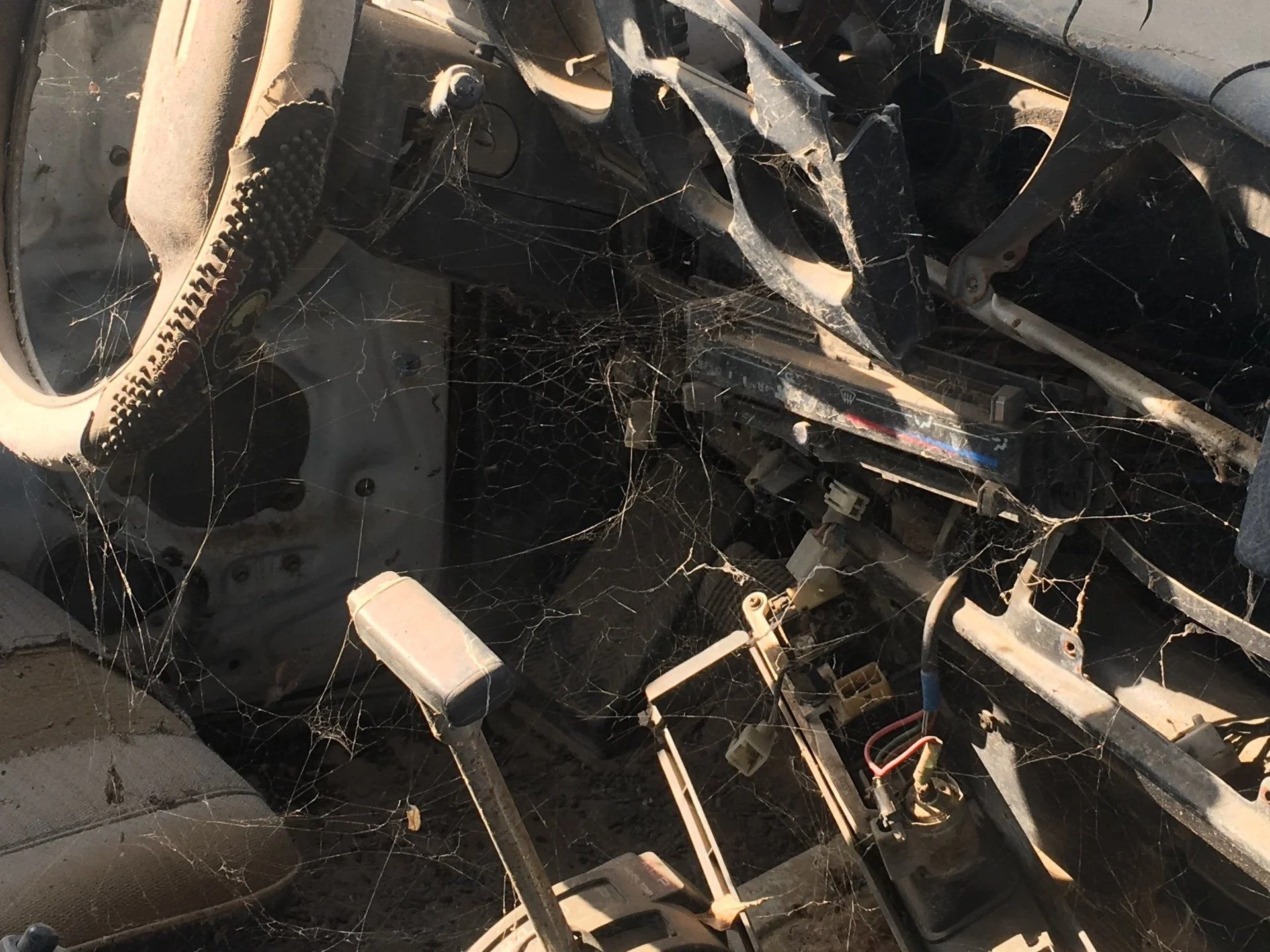

There were some thick webs back under the rear passenger quarter and after towing it home I found that black widow and killed it. About 2 weeks after all the power washing and scrubbing and spraying, I saw some new beginnings of a web on the P rear axle ...found that one.
Fast forward a couple weeks and during wire repair, found this guy with the endoscope while snooping the D pillar, then found another like it in the driver door recently.
Decided it was time to declare War, chemical warfare in the form of Raid fumigators. One underneath and one inside.
2 days ago the plan was executed.

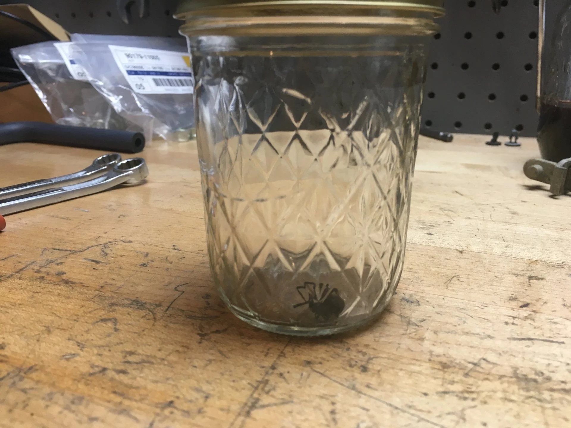

Tonight, laying under the transmission, reach back over to the socket set, laying back catch something out of the corner of my eye. It looked half dead ..here's what's left.
Decide to take a close look around, find some web up inside by fuel tank, drag a broom around and this guy falls to the floor half dead
So the bombs seemed to work, I want to see if this guy actually dies and doesn't happen to make it through so he has become my captive...and all work has stopped.
