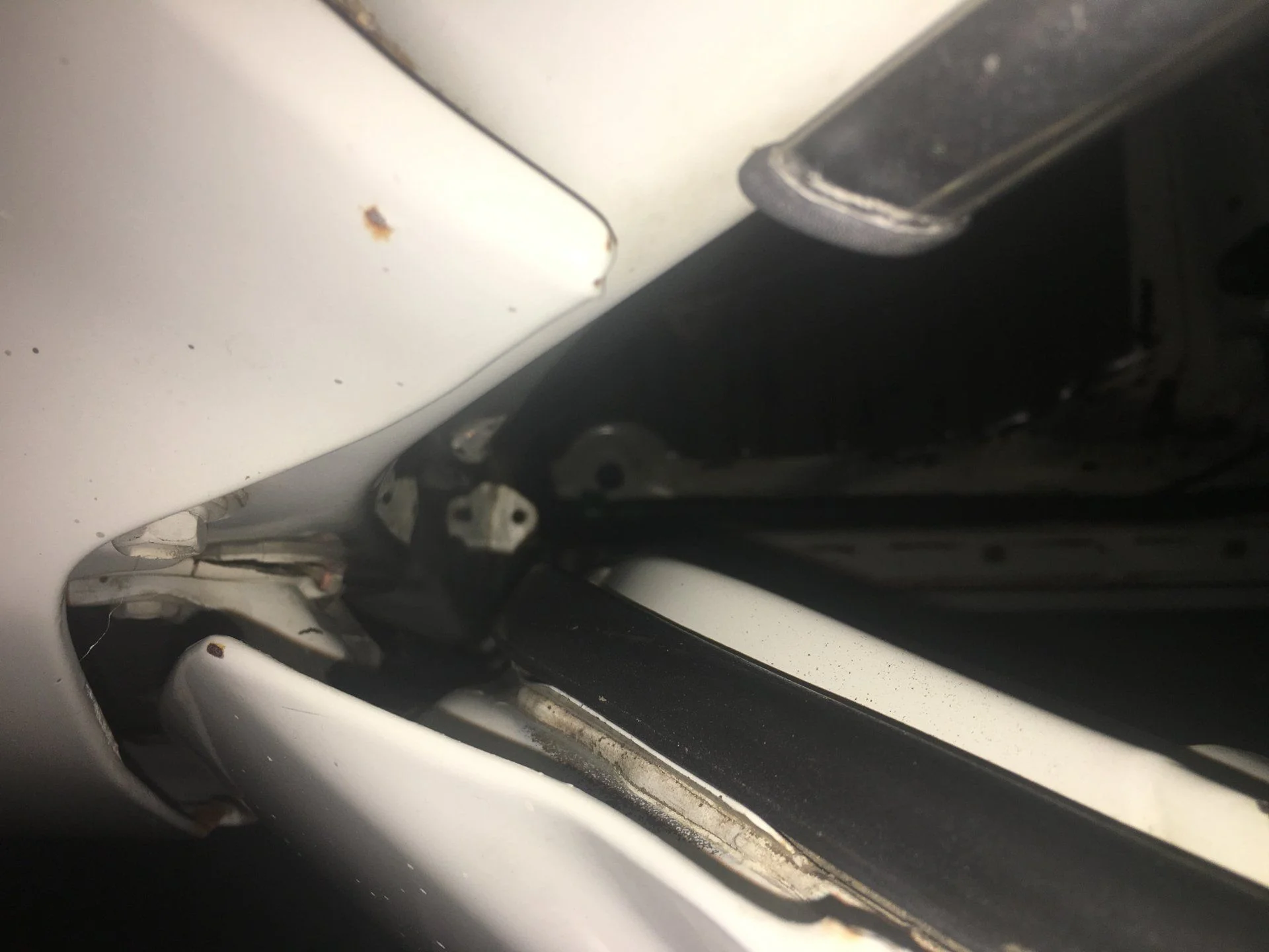

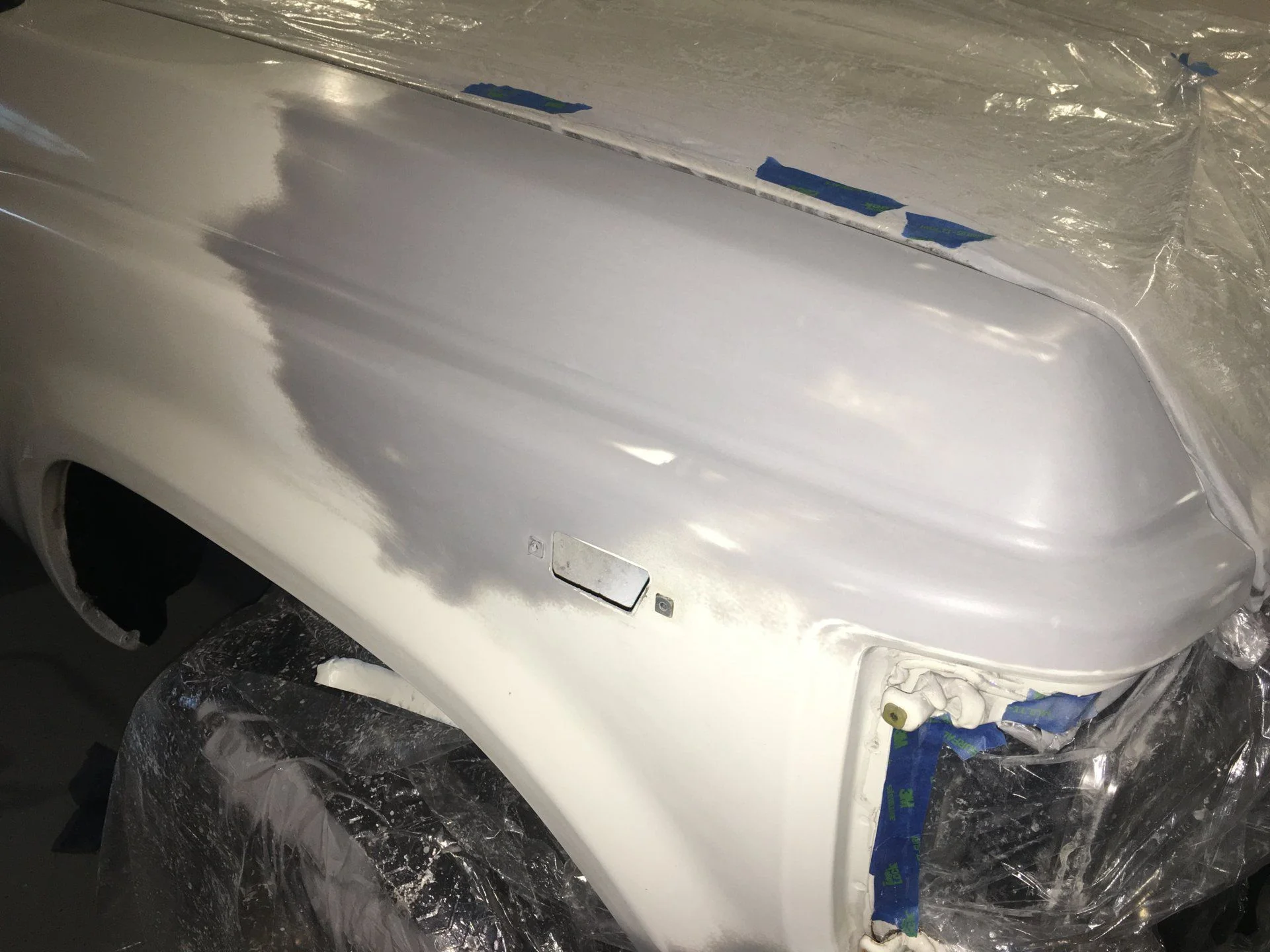

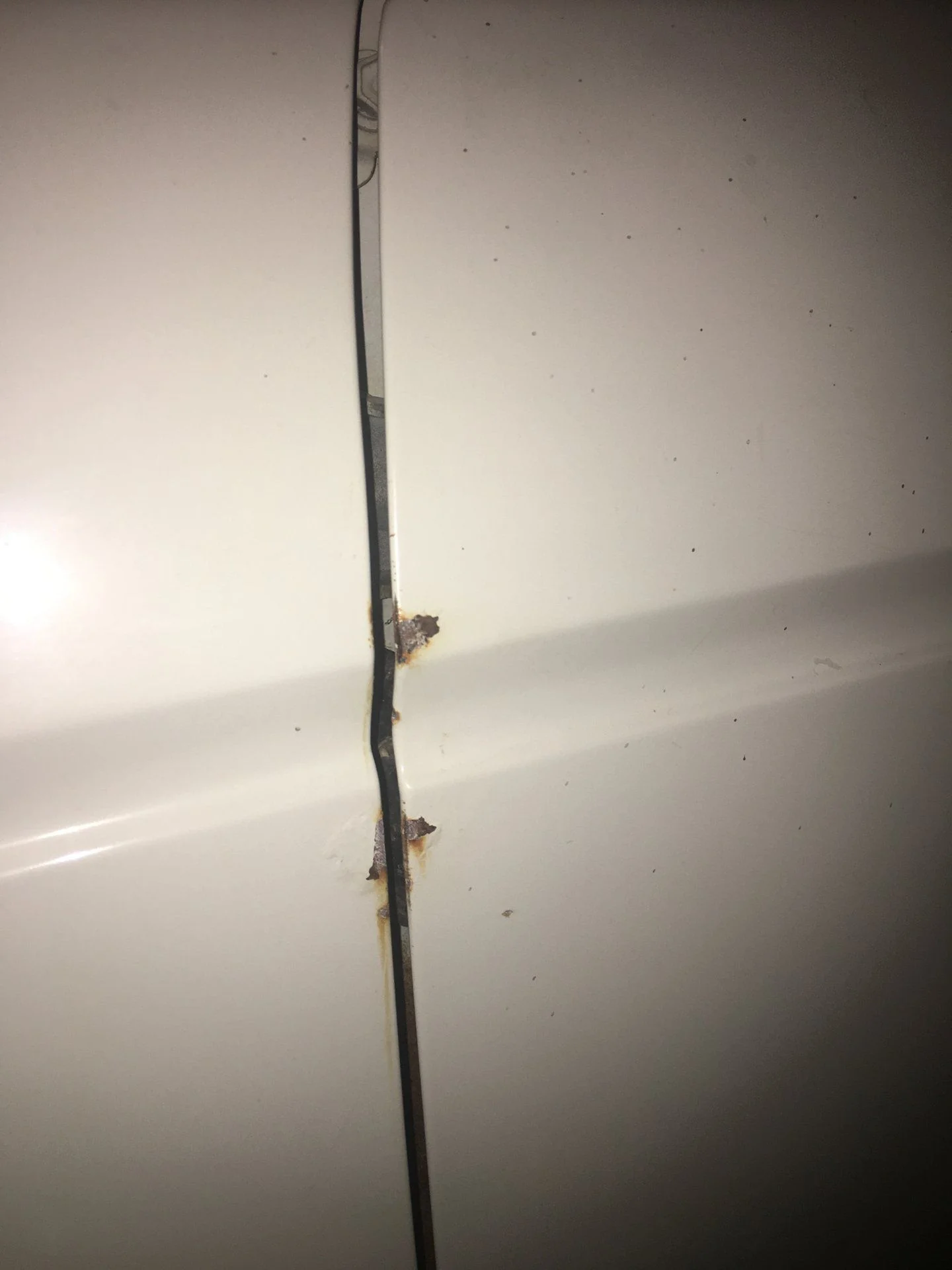

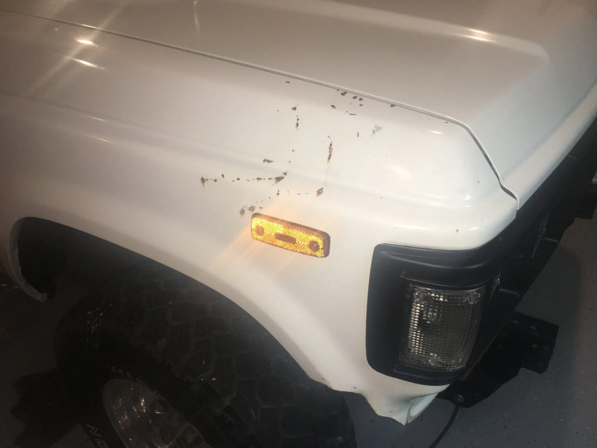

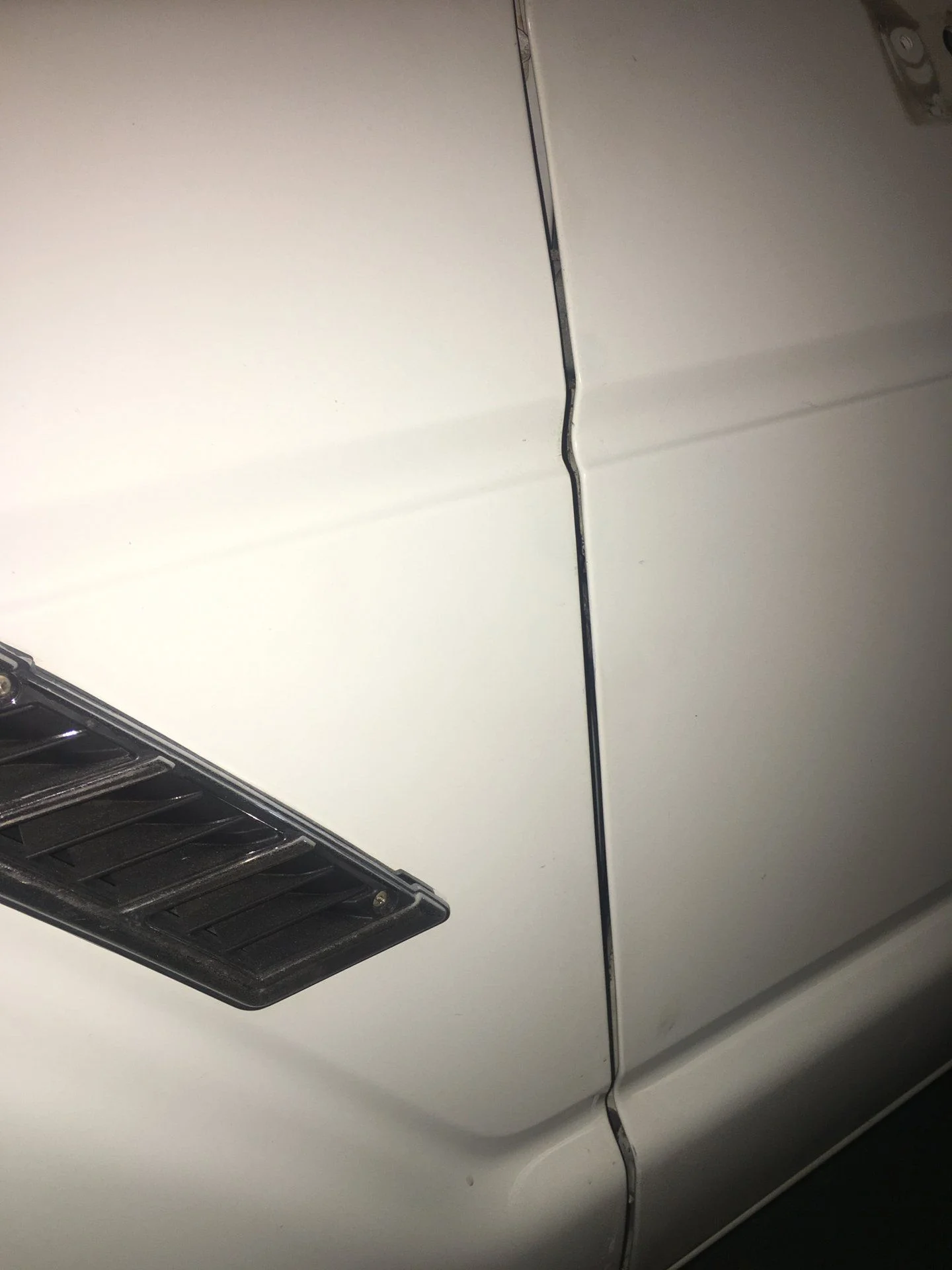

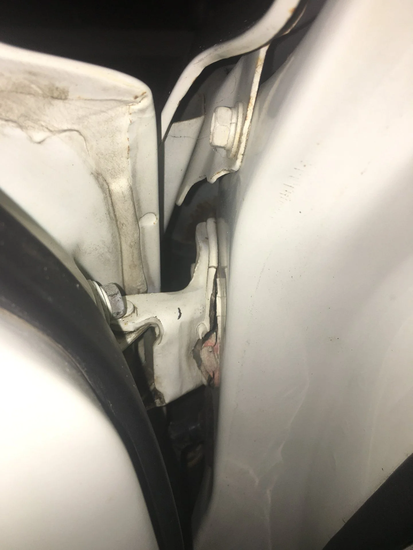

while waiting on parts to trickle in, I decided to tackle the driver door hinge and paint repair. The door stop was missing for quite a while it seems and the spots on the door and fender are where the door was flung open so many times, the hinge was bent out causing the gap to disappear and the door and fender were making contact. So much work for a cheap easily preventable problem.

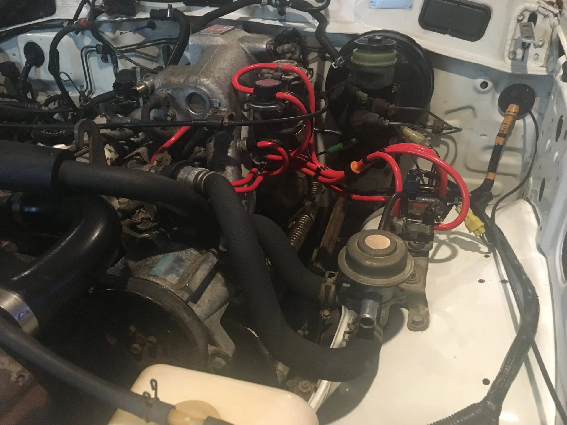

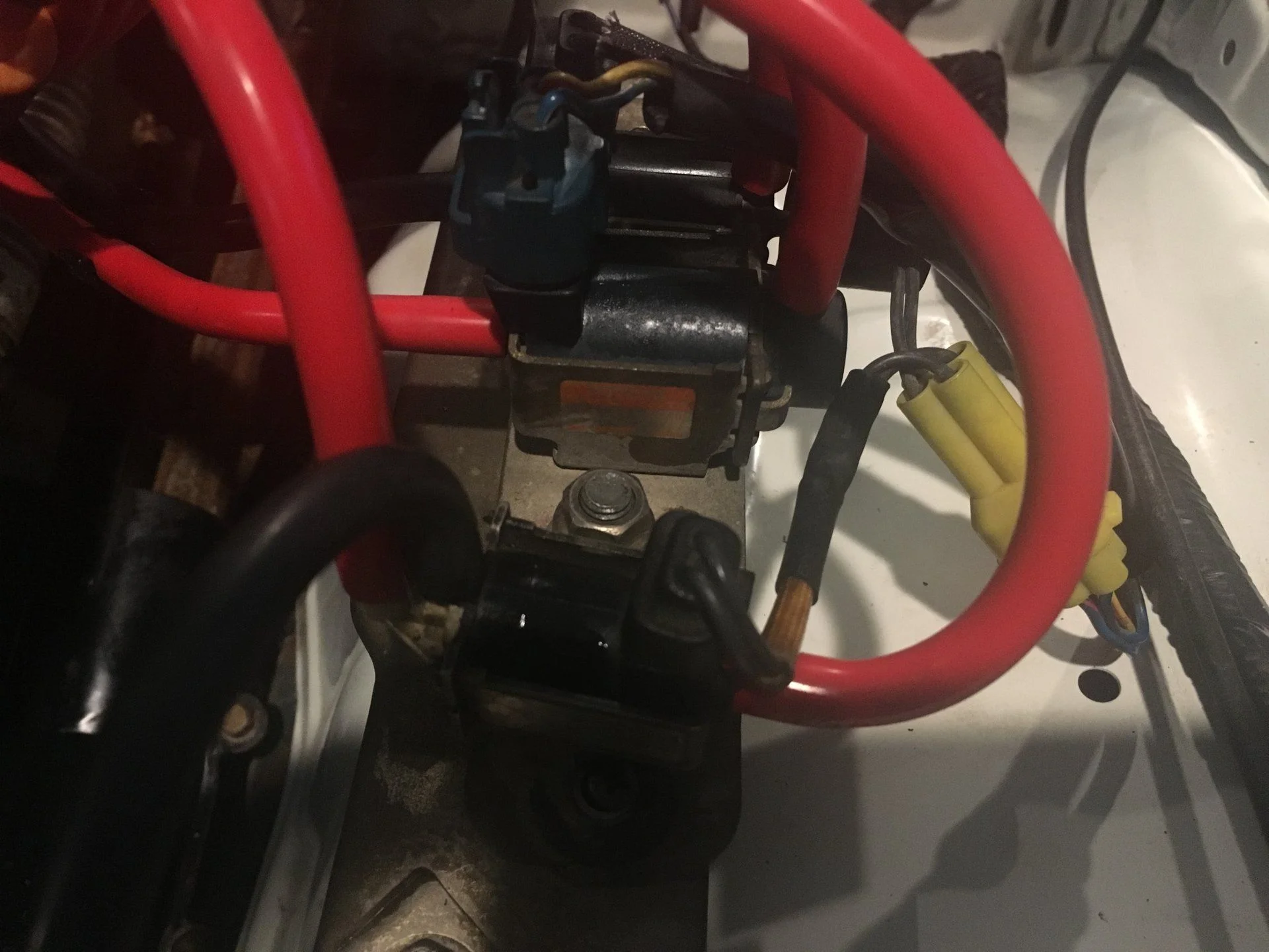

Driver's side vacuum tubing and VSV bank completed. Had to splice a new AI VSV in as someone had clipped the wires off for some reason.
Yes I do plan on being somewhat of a copycat because your work on this truck has all looked so nice. Would you mind revealing where and what dimensions you purchased for your vacuum hose update. It looks so nice in a different color. Thanks pal!
Never-mind! I read a few pages further and saw it! Thanks again for posting all the cool work and the processes you have used.

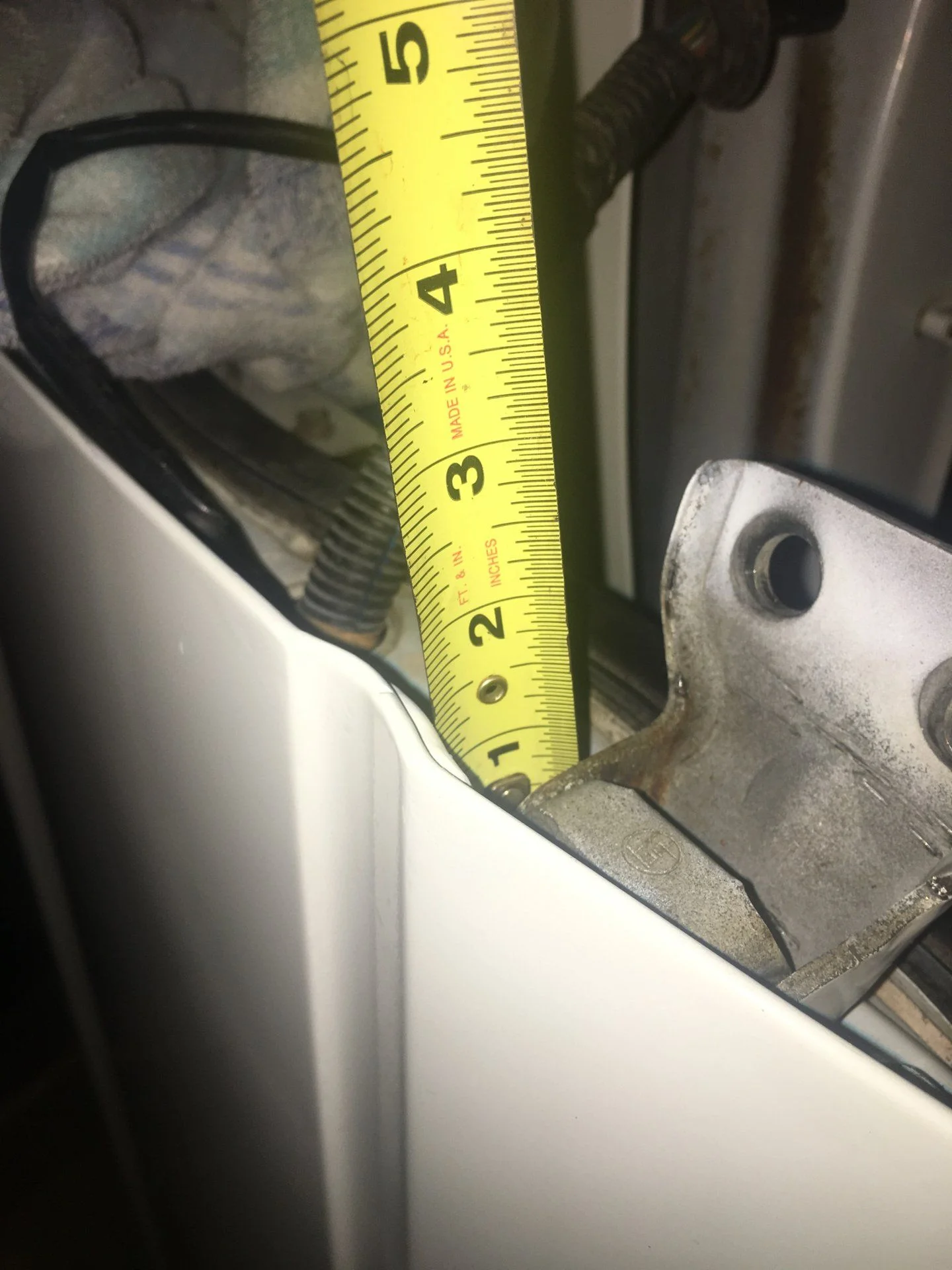

Rebending a door hinge and reinstalling with the fender on turns into a meticulous game of measurements. Came out pretty good, I didn't use any filler so there's a little indent where the door was hitting the hinge.

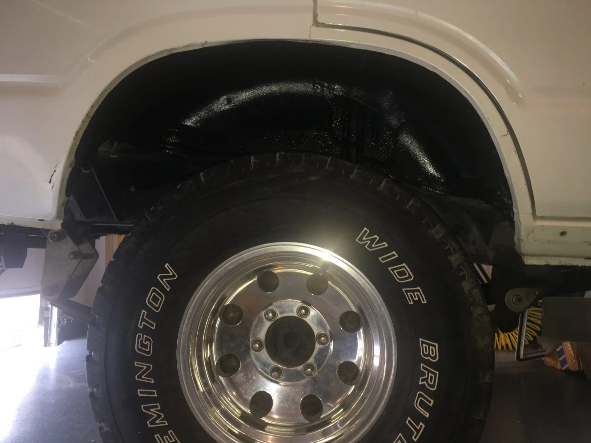

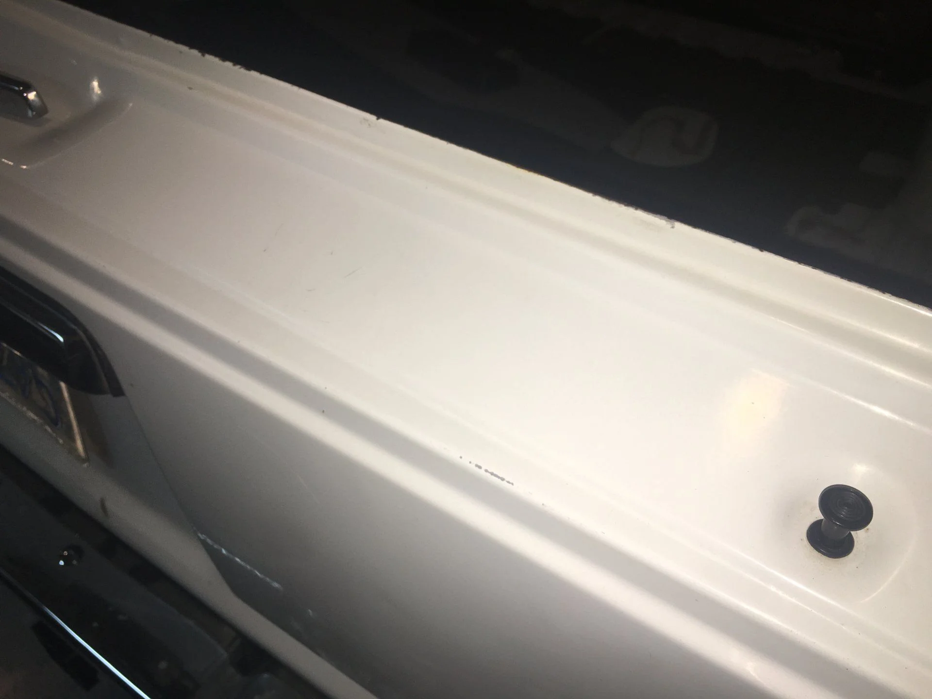

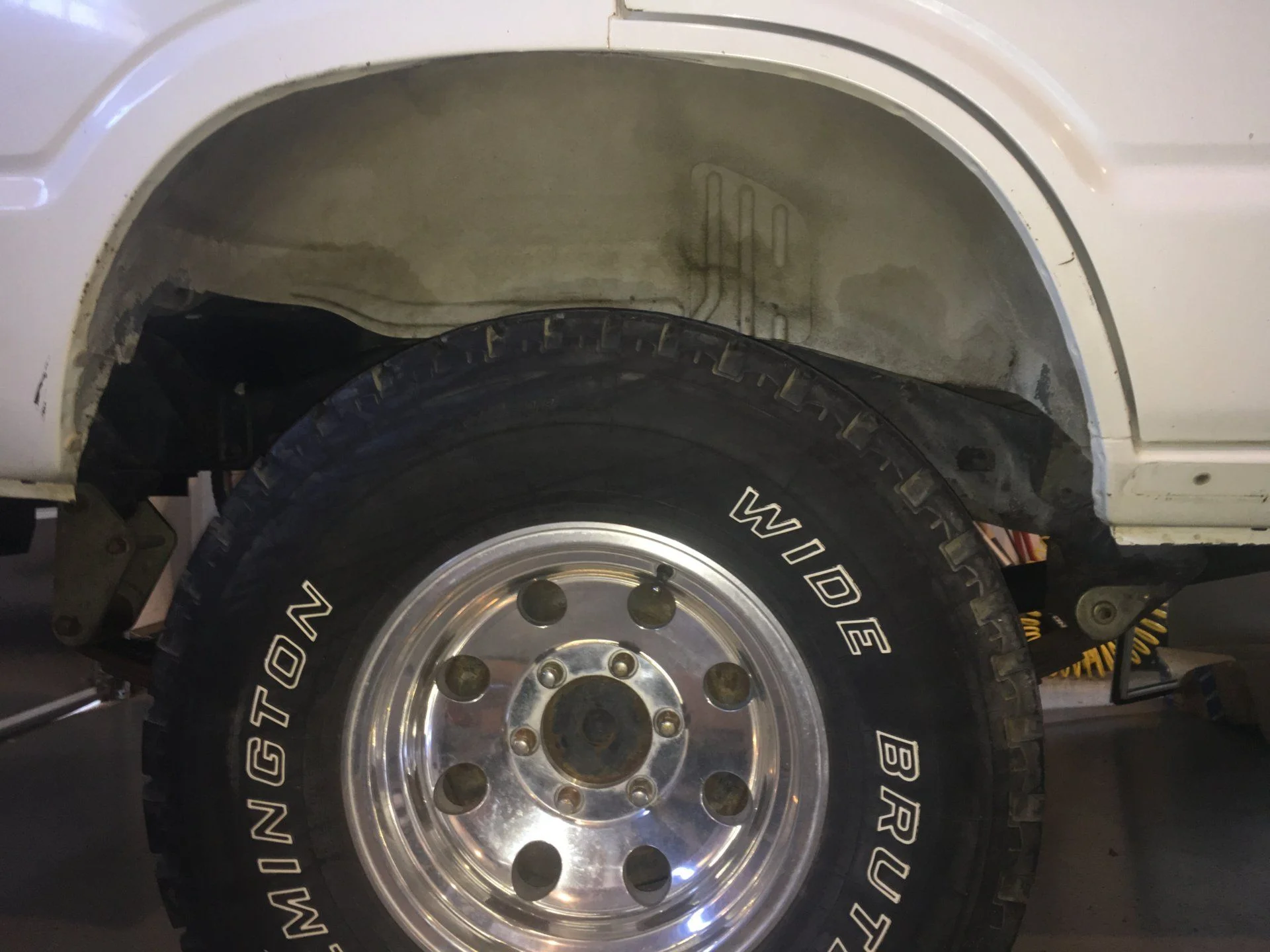

On the planning docket...

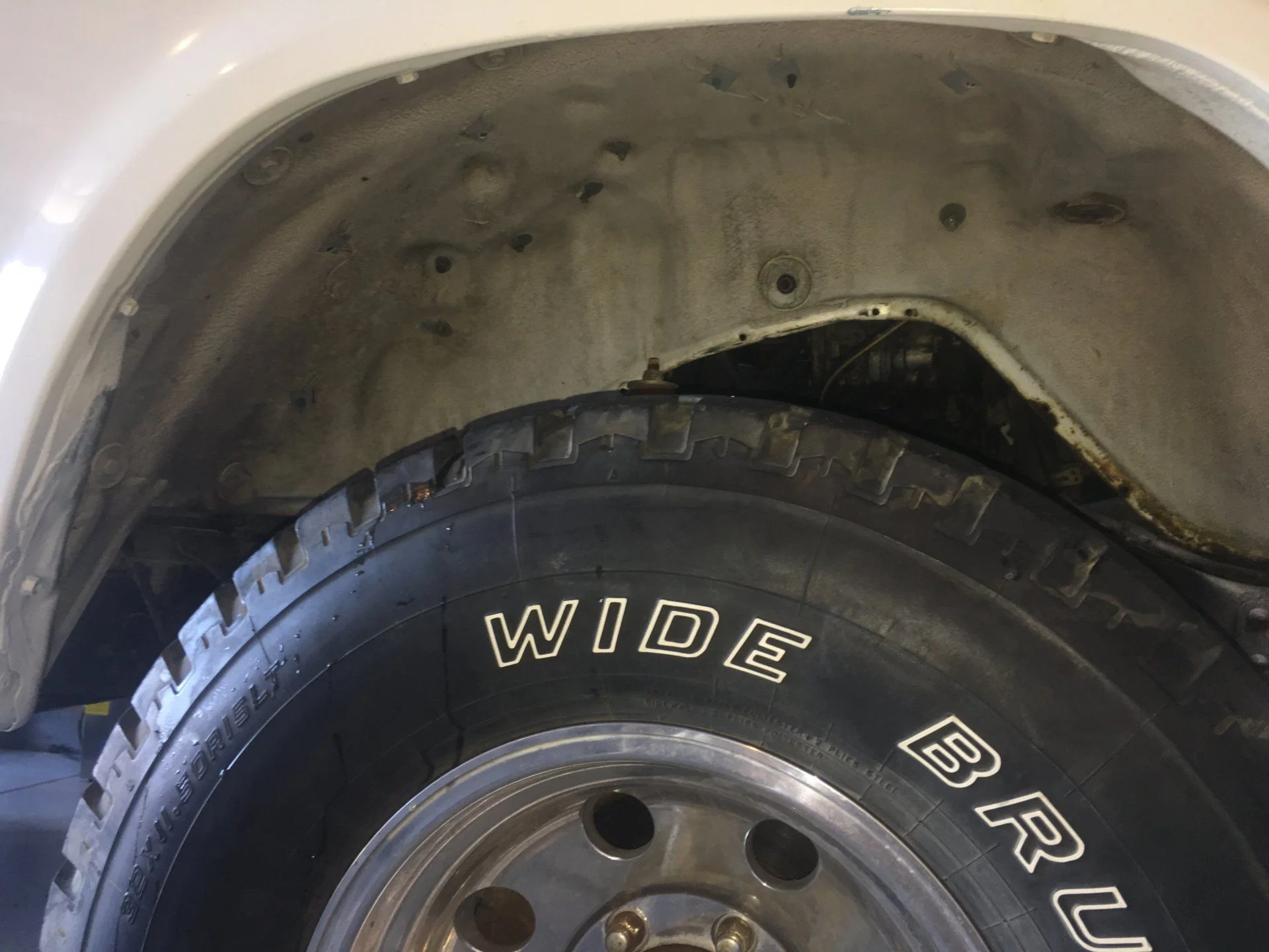

Black out driver's wells

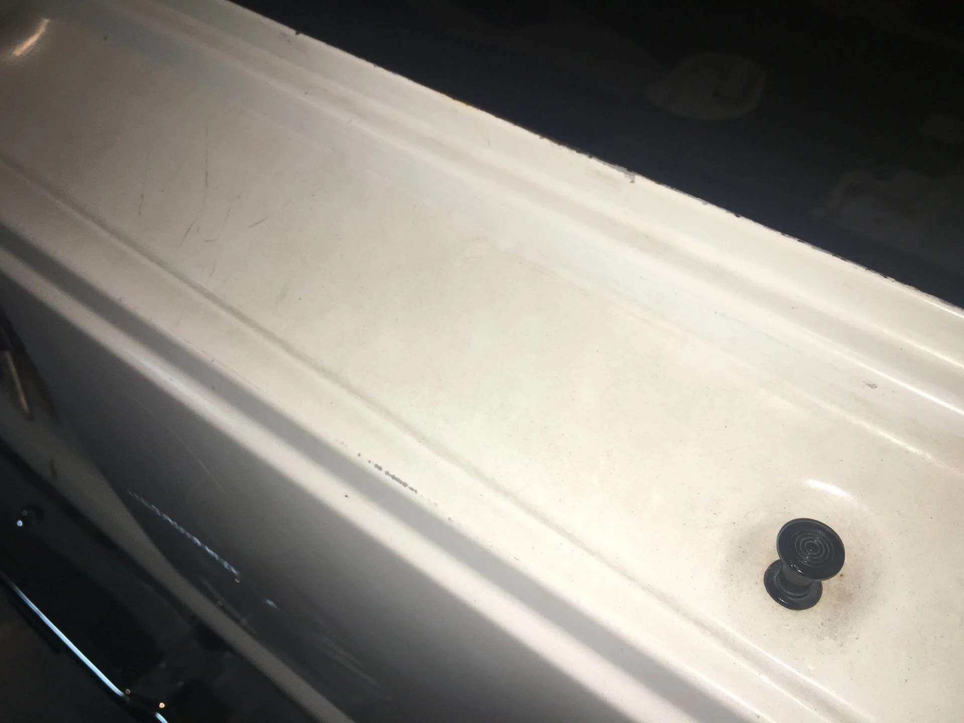

Touch ups on tailgate and hatch

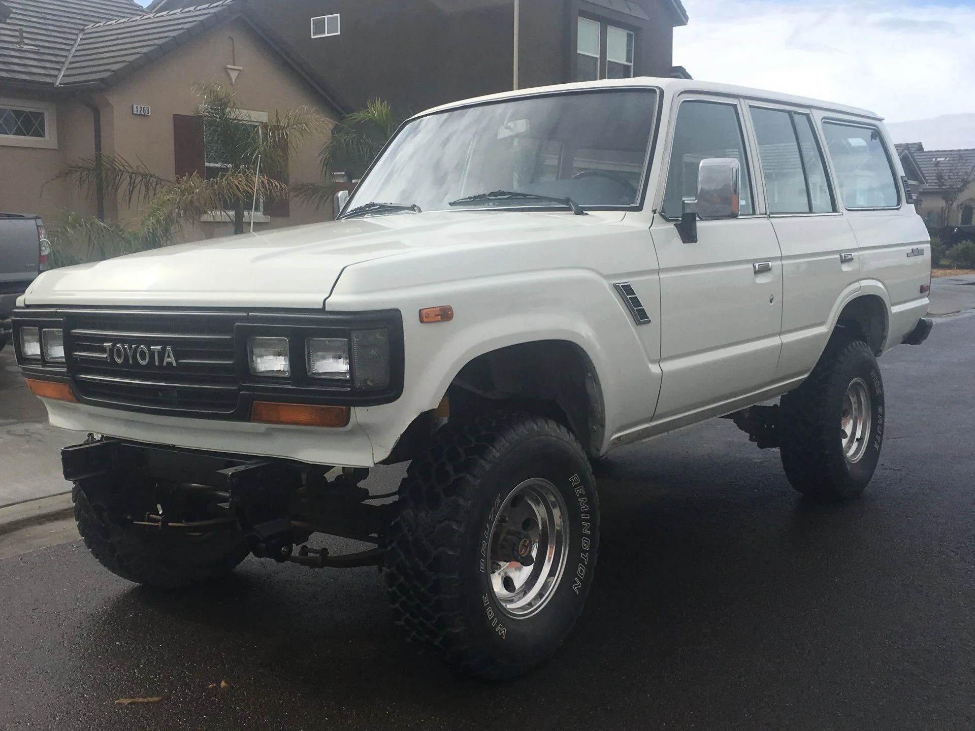

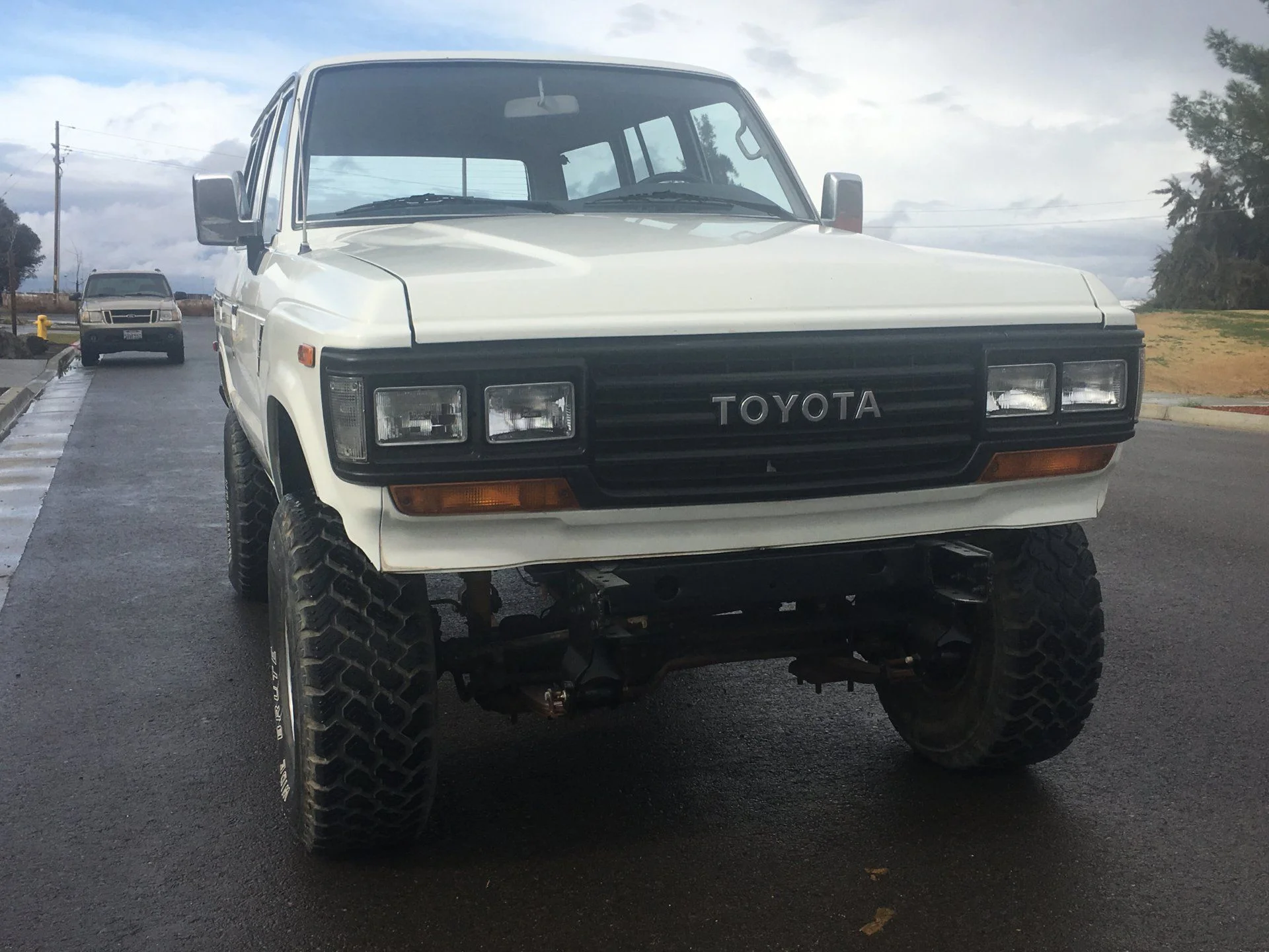

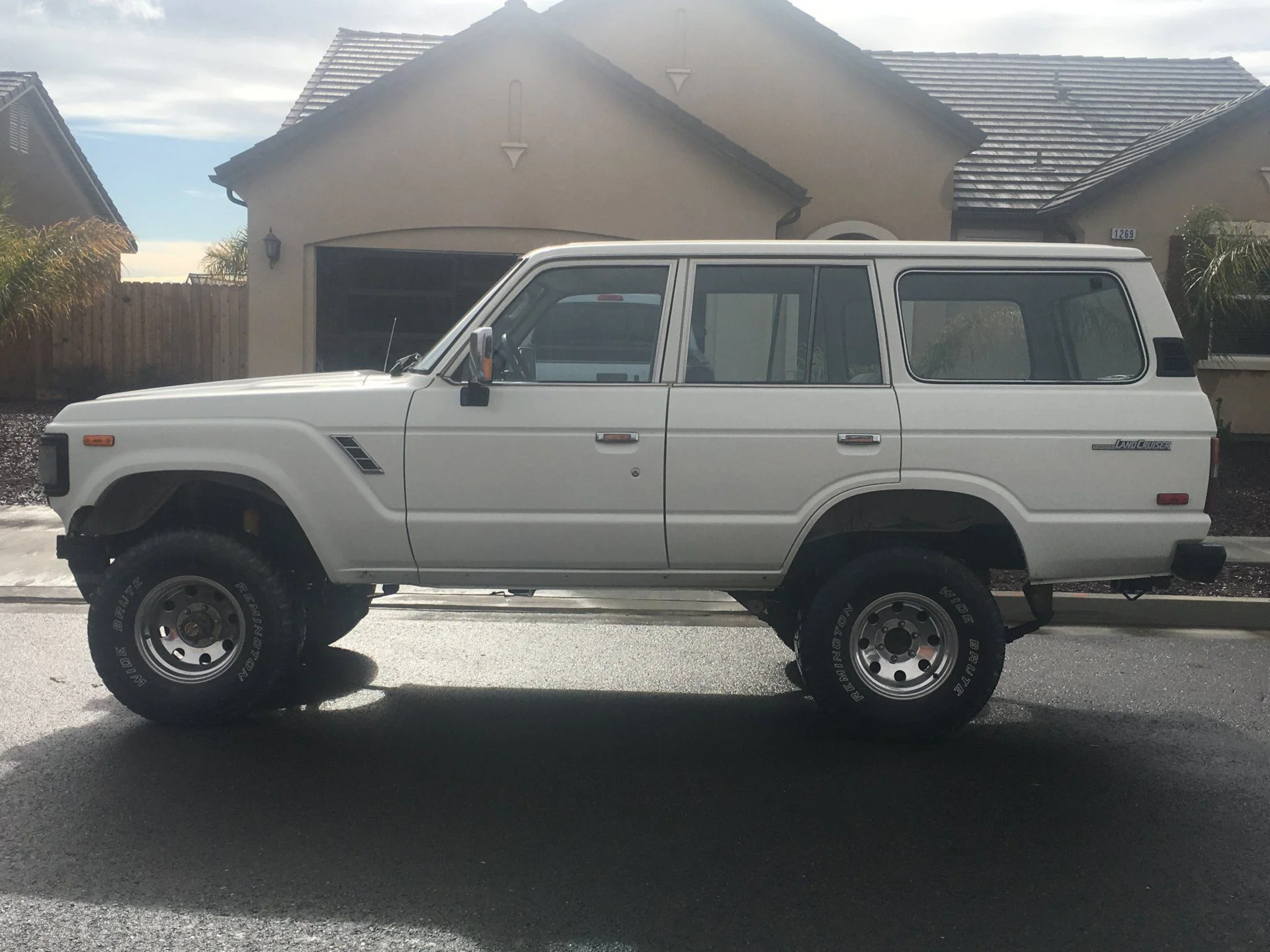

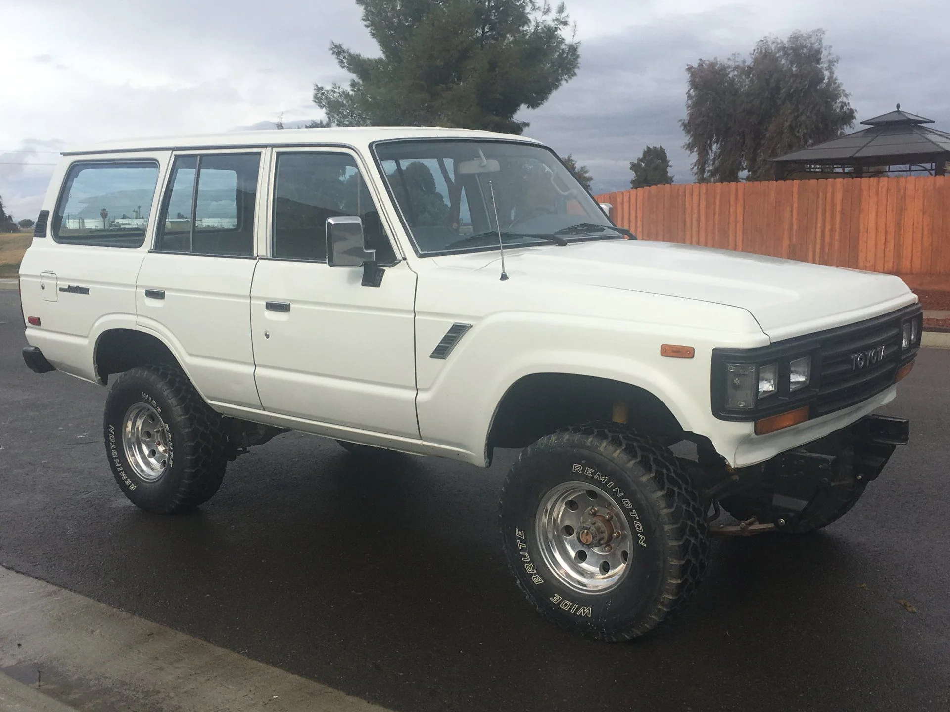

What size wheels and tires are on it now, if I may ask? It doesn’t look too shabby, and the Auto tranny and driver will feel differences with bigger meats on there.
