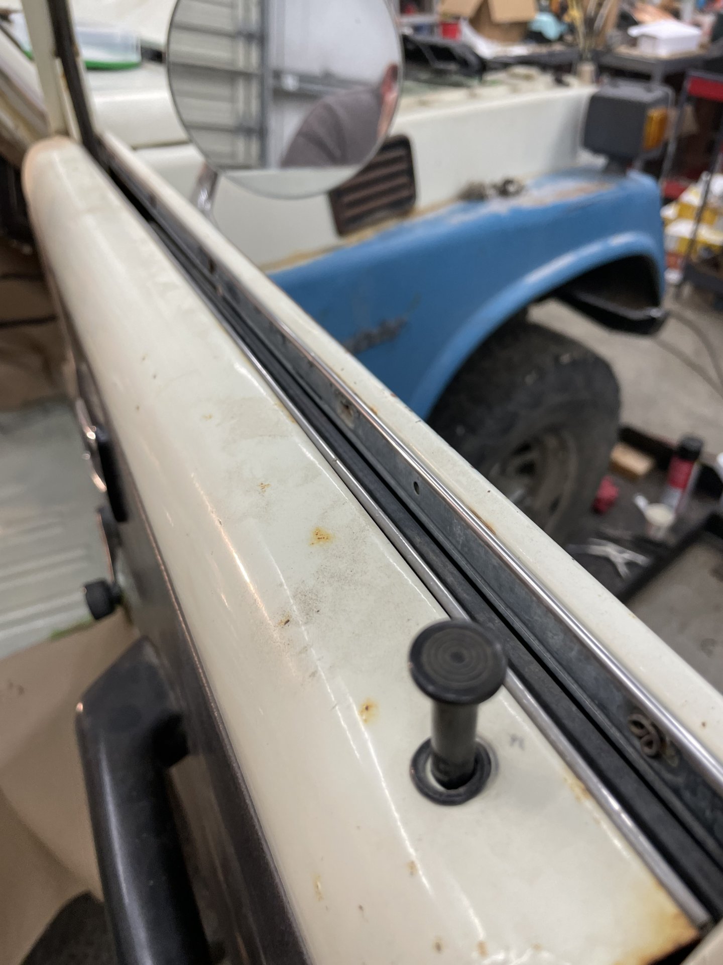

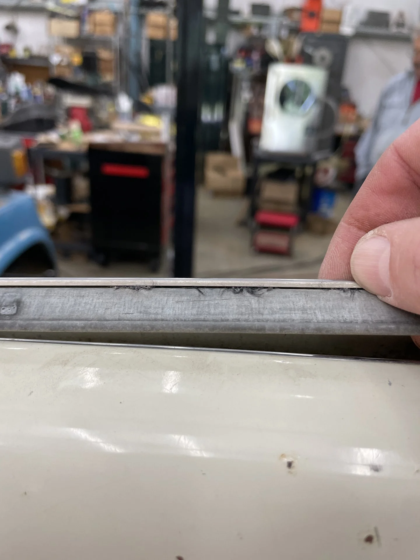

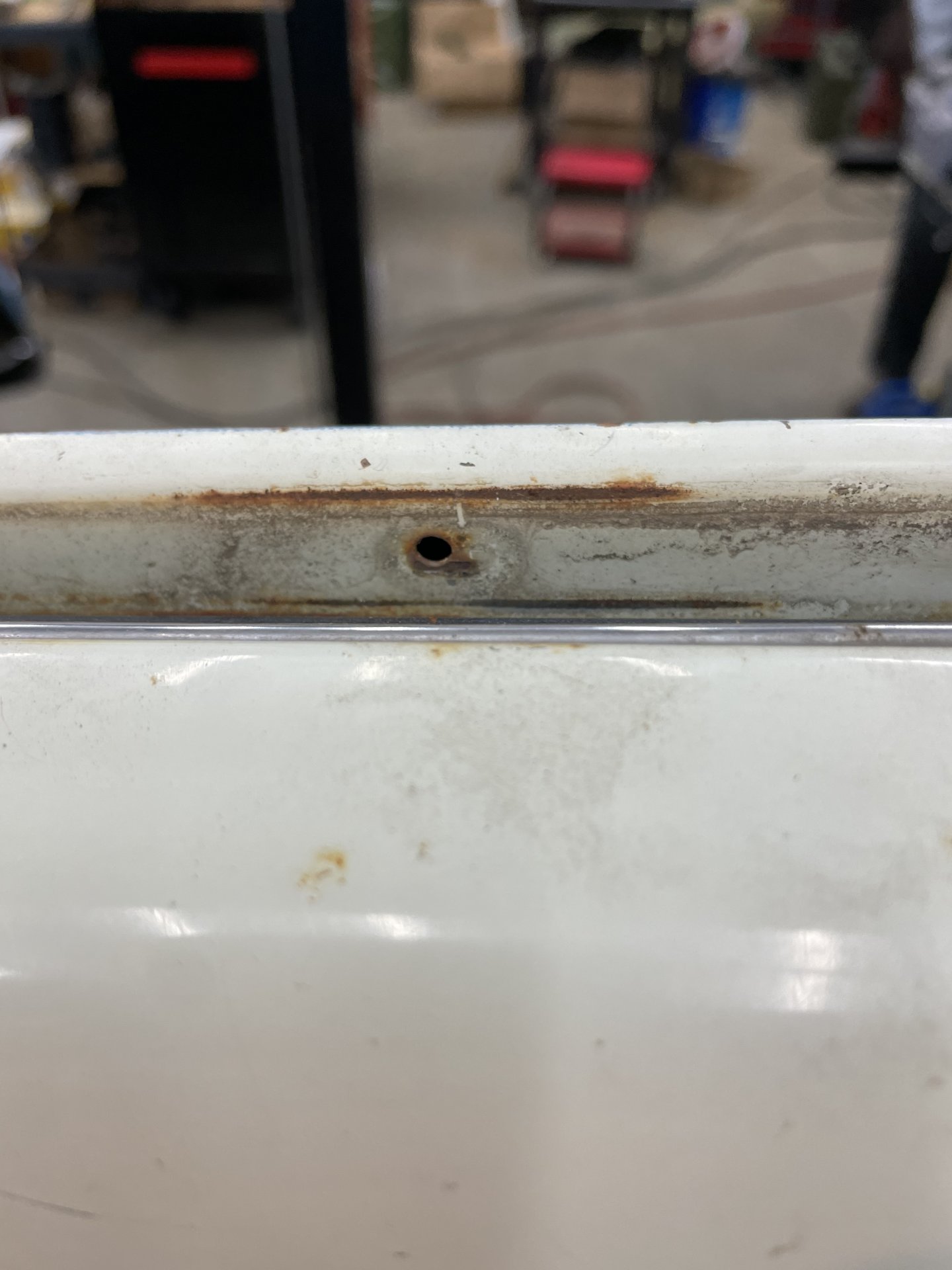

Took out the piece of metal in the door that used to have the window squeegee/felt attached to it. Gonna give Steele Rubber Products a call Monday and see if @NikP parts numbers are still good # 70-3804-61 Outer Beltline and 70-0961-60 Weatherstrip Beltline from Steele Rubber Products.
Nik if you are still around the sty can you comment on which part number you used for the outside? I’m assuming “outer” is for the outside and one the inside?
Also has anyone found replacements for the metal clips?
Getting closer to being able to turn the key and drive!View attachment 2976440View attachment 2976441View attachment 2976442
SOR has replacement clips. I just got product that you cut to length and glue in place. No clips. My inner was felt whiskers, my outer has a rubber squeegee to keep water out...

My guess is that trying to drill the holes in the right place for the clips will be a PITA. I think I had to drill holes for the tailgate inner or outer (or both?). Not impossible, but requires some precision...

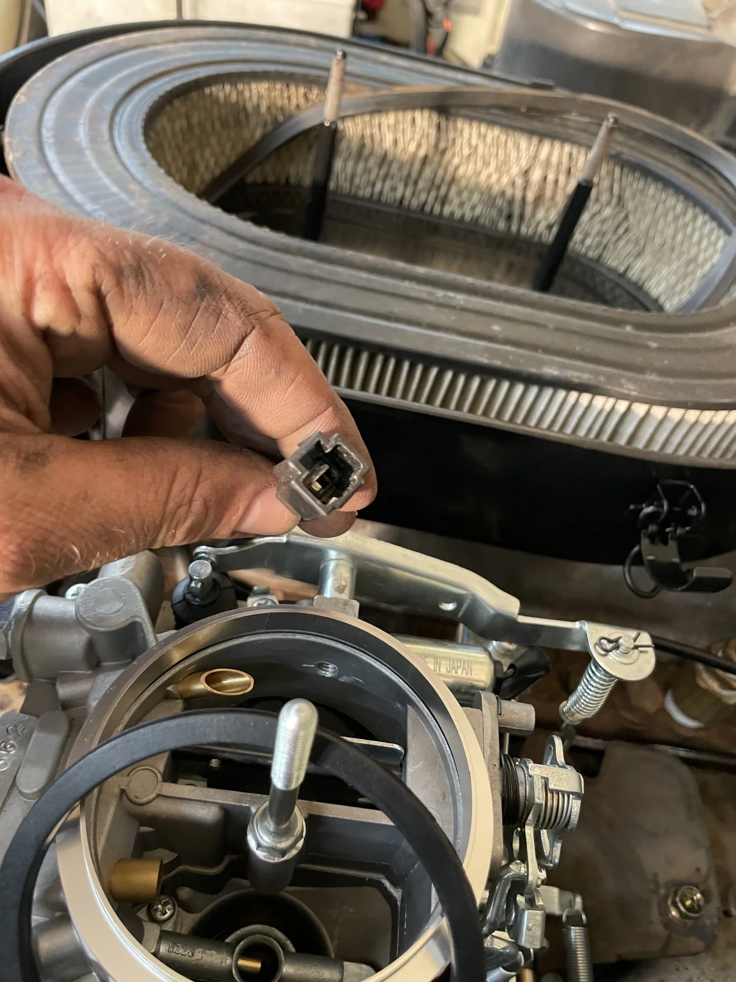

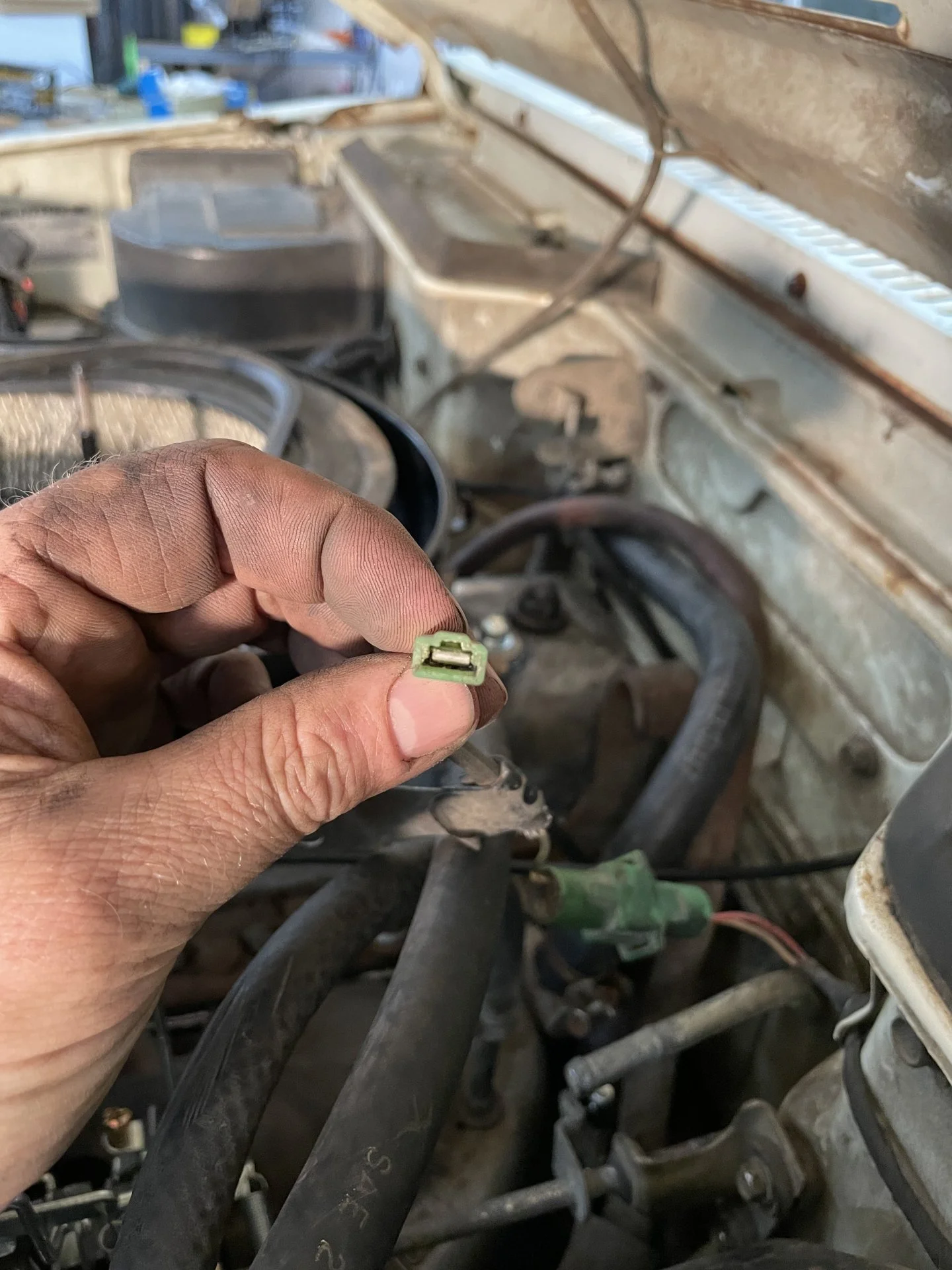

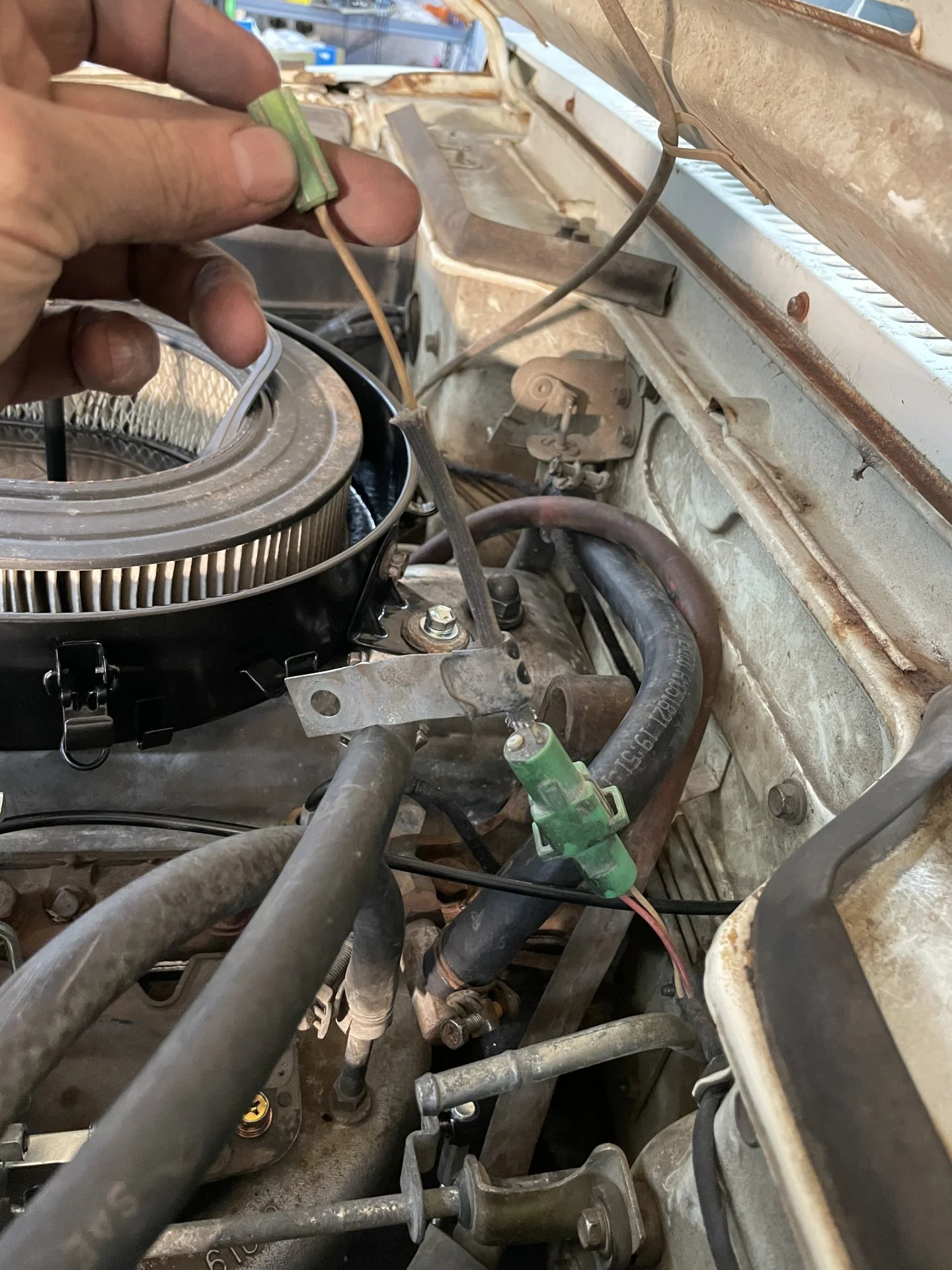

I believe it is directly related to my fuel cut solenoid on the city racer carb not being hooked up appropriately/at all. I found a couple threads in the 40 section that mimic the exact issues I’m having.
Can someone out there that has a stock 77’/78’ set up trace the wire from the fire wall to the carb for me? I believe I’m looking for a black wire or black wire with yellow stripe. Please correct me if I’m wrong.
I’ve attached a picture of the only wire in the engine bay that is remotely close to being able to stretch to the carb. It looks to me as if one of the wires coming outa the connector has been cut and the end terminal has had the clip broken off of it that holds it in the carb side FCS connection.

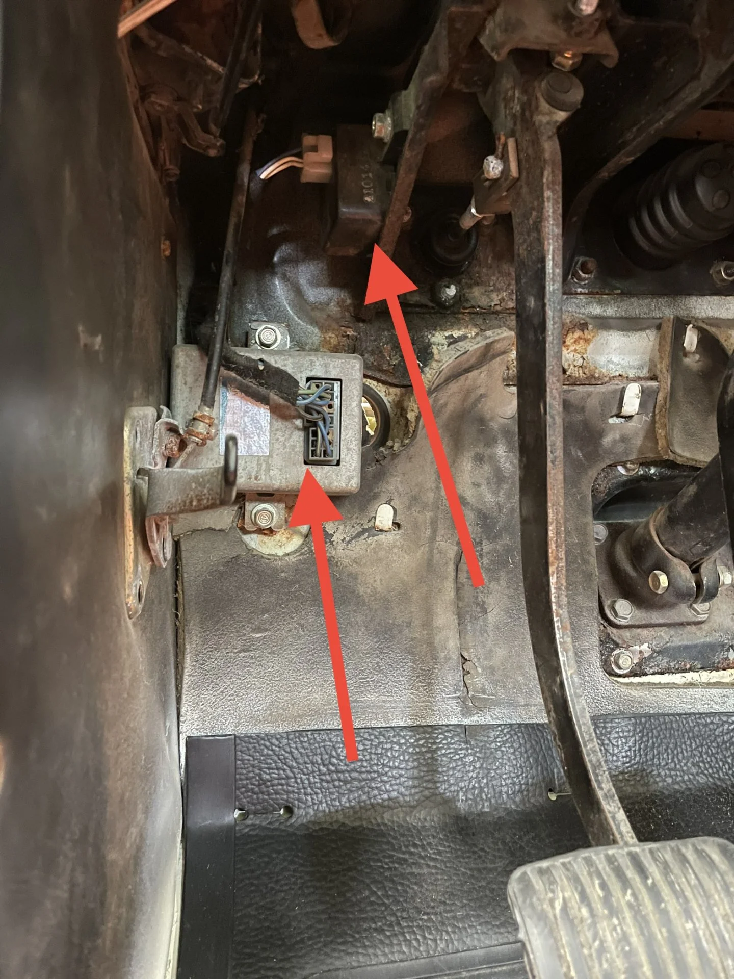

I’ve also attached a picture of the 2 modules under the dash closest to the driver door. Can someone confirm the FCS wire comes out of either of them? Please let me know if more info/more pictures would help. I have a ton of them.
Looks like it! Little story with this!! On my 78 FJ40 that fusible link to the Carb for the fuel cut-off switch stalled my 40 and left me on side of road! Never ever happened to me in a Toyota before!! Next day came to pick it up, pushed down on that link, she fired right up 😘.
