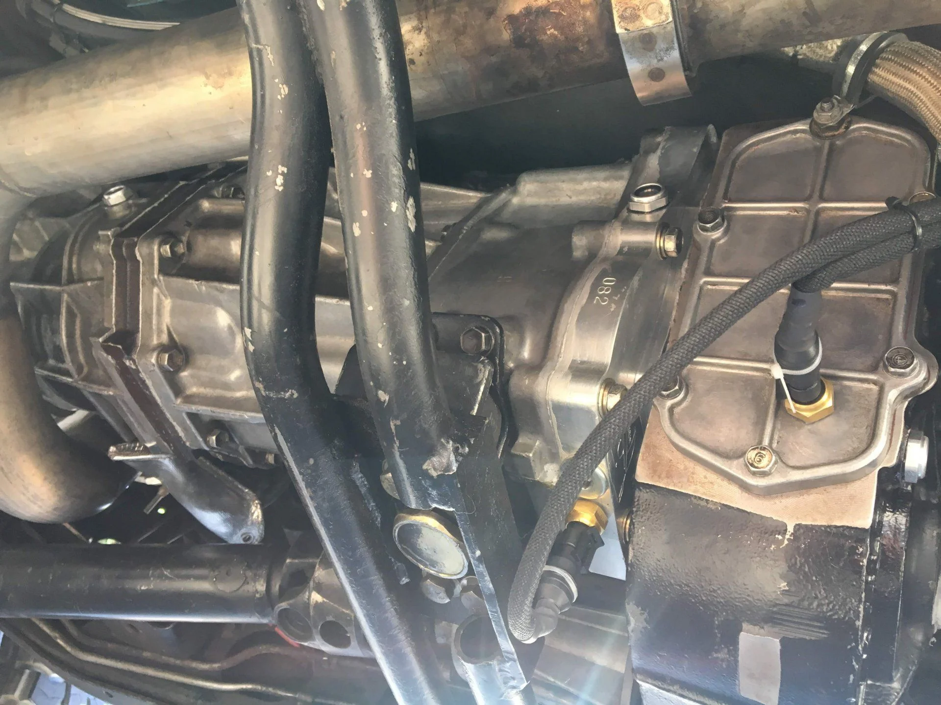

Got the new case yesterday from NorthWestFab. Looks pretty nice. I do like that it is one piece. One less gasket to leak. Now to get it installed and put a pump and cooler on it... Kris up at NWF has been pretty cool. Sent new gaskets and everything. No charge. I am glad they are helping out. Still bummed that I have to have a pump and cooler to run on the road long distance... It is what it is..
VpnUv1K5bGqQu18orz-gTNkvMr3dgnsimoNhwSk9nl4wXF9WwSApHpsyKRAT0HA3Py1UBfCuKR2xiTd-HYdyp5Y4nuDYKc_qtNcNHgexitnN3YFbv2oEiC1DT-vnOrJ-pyytSY3XTWoeY5EB1fIP1EsYrKxbp0GFaIcZXEpClZdUKiHm4Z_gkUrcAMdy-U2iJXs6y3VjlmRV7OJXHhY_1n-oaoy3nfrXphIpXV1hfeDtiLGYU7MXlDIji2R97sG6rpN9oyod1bx7hNJpoezyetDRX3wPCY74gTCHks-LHIMqmAiGsstfK8bdL0x3iyL9lbRVr2jFBEN6wMO2nfJYzKqqiHrY9apQdVdb7yO_XUwOtpRDtf6HqOwfjp-UgXAubgepjMS5dg3psyINCV2ytIzO_D2H7FWCsxFhUJT8xxD6ez4GNx6XRsfpkWouwaL-0MVo2Esg_lkeIkQ_SWShyGzN4_MfdRXPo7afG5rAAX7xSx5lHPXUzLWIwgGuRHeNK9MRMIF3ECeU6GX7QIr97EIsEpFKJNBE-670GOQNGkIbKDibGGa0DizjXOiMFL99J-TqJavPCM-elVTIkTe8MK0MvNP_jvB-zIkIjQeLsMCmCSezi7Rvu1I9yOEsAfzSfHQiuOTp4U_OQcOj0yToT3qRmJ_W_7nOQkvPjflrOUmtpASaQEt1ChxOF_in=w684-h912-no
@White Stripe yes sir, I agree, it is almost mandatory at this point... The idea is not etched in stone yet. As I am sure it will change as I put it together... But, right now I am planning on using this DD fan controller to control the pump for the cooler. Electronic Fan Controller 70 Amp with Bluetooth Control It does have a digital read out for temp while in setup mode. You can't read the temp anytime. But I could check it a few times and see where it's running. Or at least that's how I think it will work. Lol. Before I install the new case I am going to drill and tap another port for the sensor. Which I haven't looked up yet...

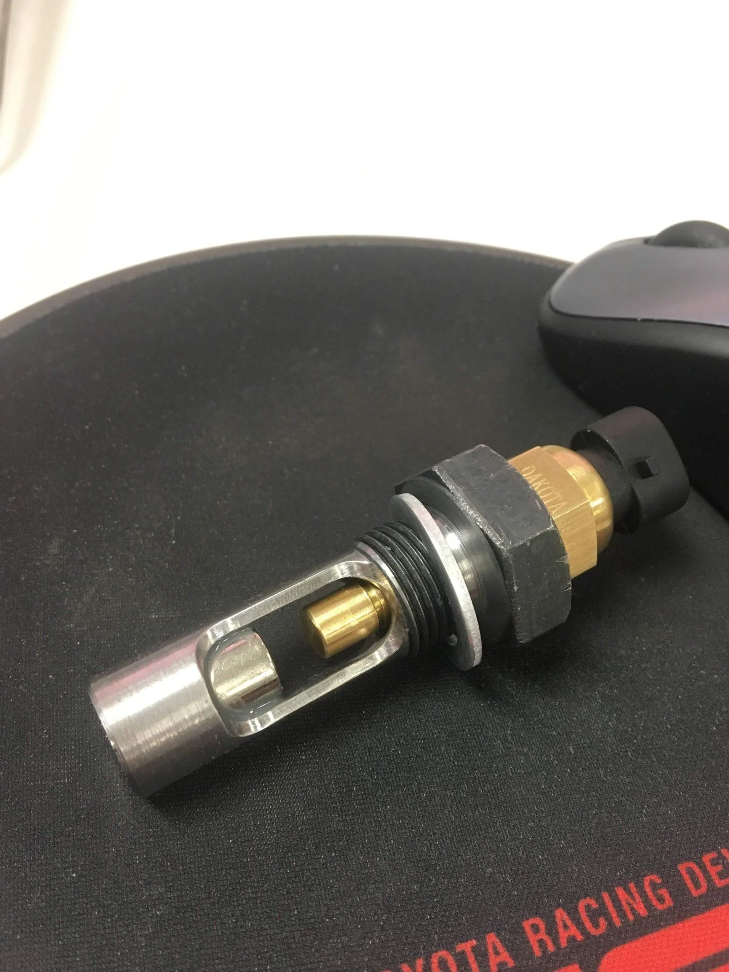

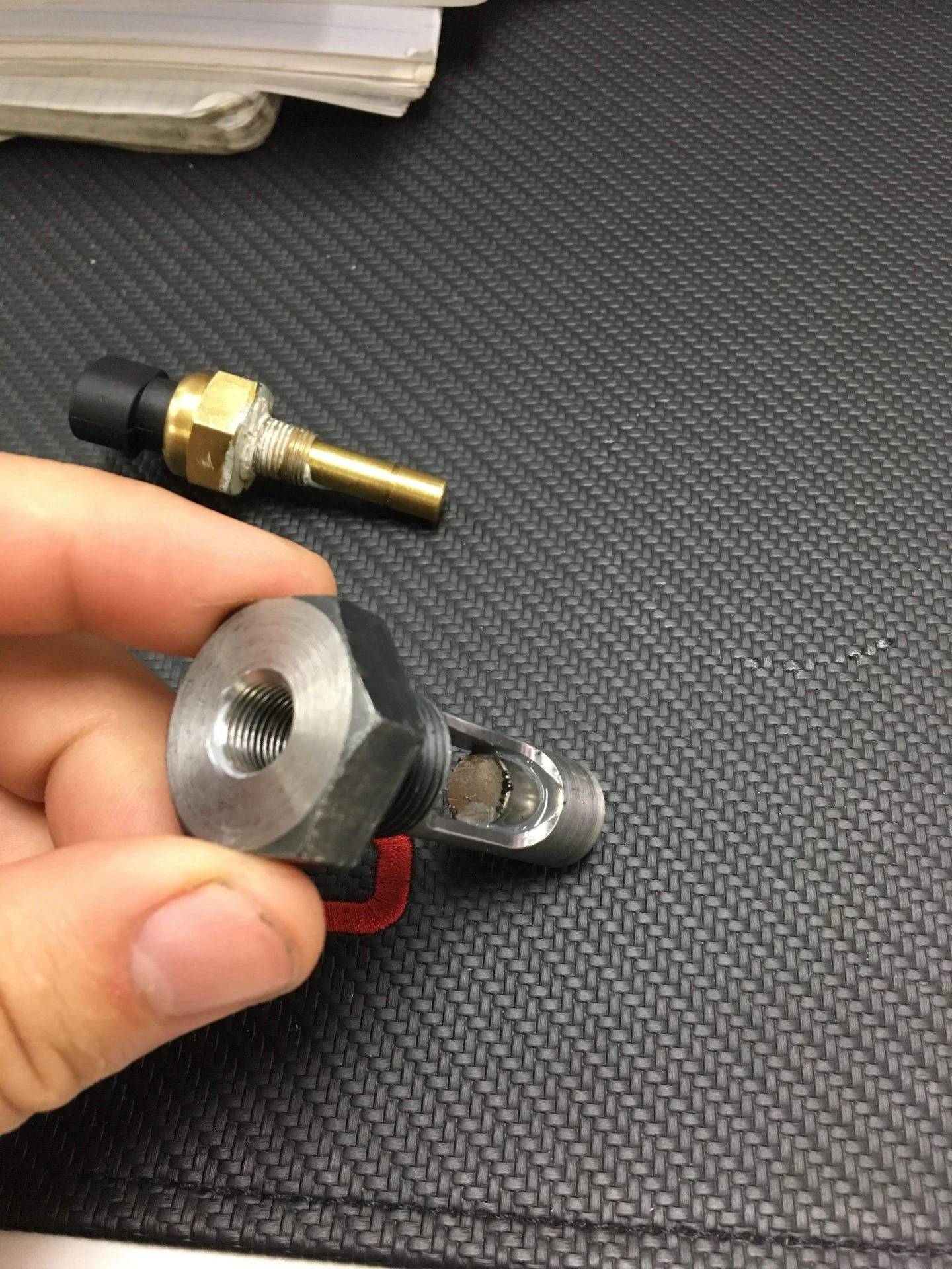

The DD sender is 1/8" NPT but its quite long. if you wanted maybe you could make a drain plug with a magnet and a port for the sender:
I'm not sure what your gearbox looks like.

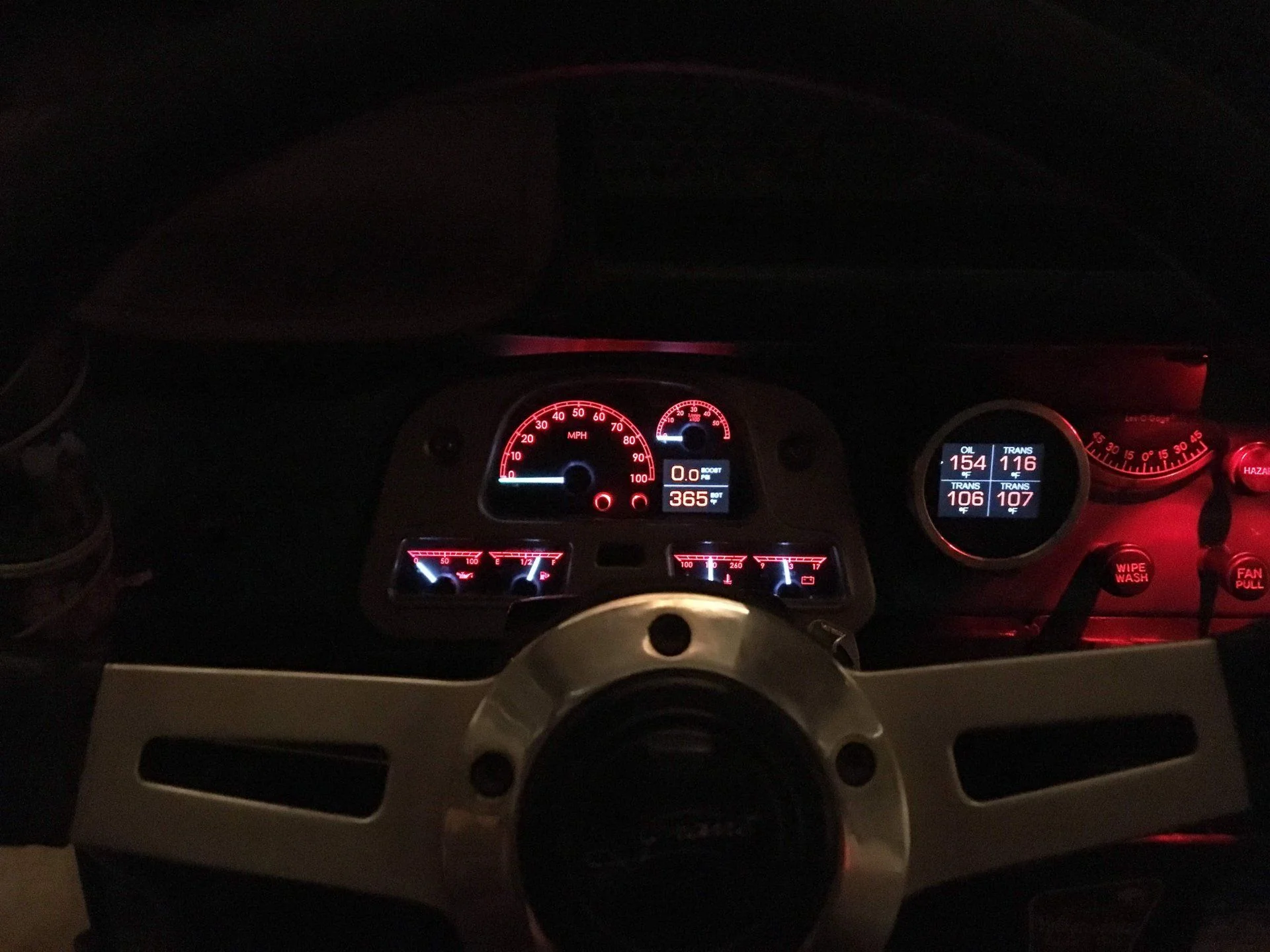

You could get the BIM modules from DD and plumb them into your cluster, or I worked with them make me an expansion display that I'm sure they could replicate:
They can use the same sender for the fan controller, and display the value.
I have alarms set to go off at certain temperatures for each box depending on the bearing ratings, so if you wanted you could leave it in the background and have an alarm set so it would display the value only once its gotten above the threshold.
It would be interesting to see your numbers! (for me :) )
