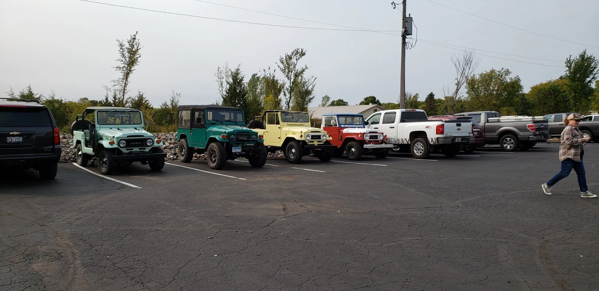

Thanks to @Hogan for lighting a fire under my rear with the invite!!

You're welcome can't wait to see it in person. I had a TDI until a year ago 325,000 on the clock.
@Hogan Thank you guys for having us along! It was a nice day for a cruise. beautiful scenery! We put almost 300 miles on, everything worked as it should. Even the hum of the diesel put the kids to sleep! :) Thanks again for the invite and motivation!
