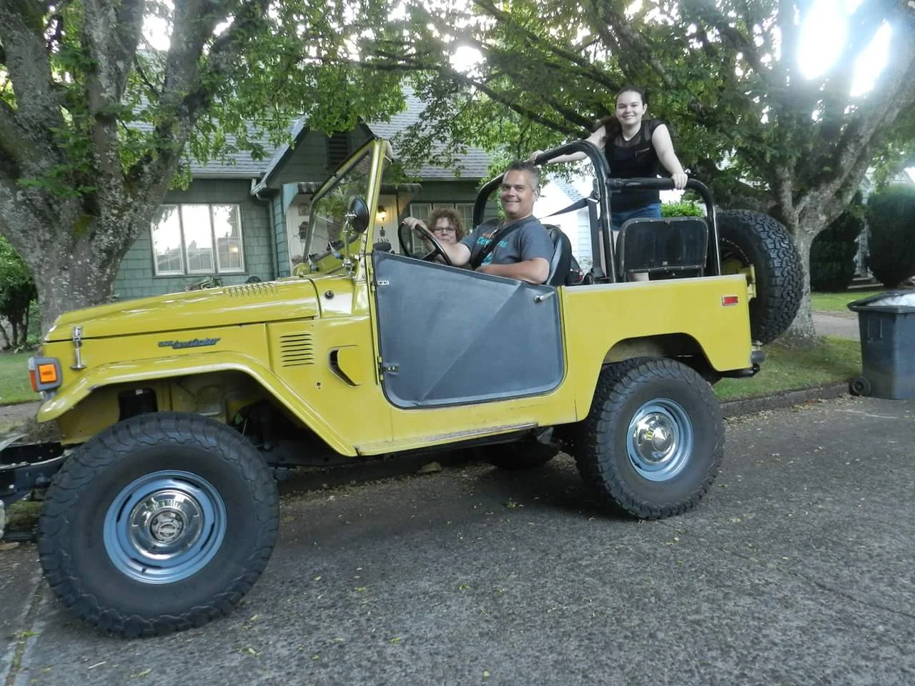

We stopped on the side of the road for a poser pic..
gdtehG85yvIOx8JkQG7l5z448FErxaOdrZeZfA0zehx-8VSLTOrA4hV1csT8DrwJBMb683GrdROofdYYEXs2nbgb45l9iu3NGbd1uBOLyior5Ck82ICGm8EuPatOioPARcTN3YWd0SWH-PZvl7JdZ3jfI4scv__3M2OMmYgm2pFEk2hhKaHL6a4u1Bl0dBbSQMbPYWuH8-k-PYR6PScX25qcCNznJQVs15DAfJ4gU33iS3gGwalv6F8qeS7fJORM_7J1fRPVTQKnJK6ZsRo3ug8hjbix5KEdnC6IhXqX1UJgo4mvcGYxVfw7V_vf2ShXJxbx2bAoKFf6a_9PurKwcVROn2O3SqMFTle1XqKqUwocdR334ZWQ9lxRJ61J2ZzDM6nKaWYBTBZx5FJpBEYXcgVSox33TBO7MNIZDpDAVSsfwt-6MXexD4tsGT9xD12eMSxnVWLs2GWDh4UT6nf5f5Od9uKGxDTa9FI4mc5x5KCvWue4yG9hJIR1J0vPaf7q_9MUGngezH3JGGQog-uYAU4ltYaQYGxNU0CC7R7Gl4ztsRObIAP9rv21NZIqZYeO1aX1fwARiuz6nqiTwLMhjGqrKpHAE9Eb9HjeQUoYx2uTIMACnsC6w1XPWpYjAPu_Bk9hXR-QSpyy3kn0YSrMflnItDjNJhC1gdwUVhysI8KHeV5bmCvBMww=w1175-h881-no
And another angle.
stX-dfATVcNHkfdl1lPeZBL1wDsYiIYkM2z89FJu5g_cpNnPdc0GomuYIzIgGkuTG-sYMH4wlZJ0oI1F1Mq69-_eA71VzJYMprhxPXyYKd7OriafjJRyU-K5AMzbJ6zNyE78YyBL1K8g0A43rgAMwXHsPfiZEkV1aAoQASBfSf9Q77cHyX_BCphblT1JwDaNhcWBrzCpbLCmRywixU_SdhFE3iclP4O6xR7joF42-pRQHcjLf7He-GFcqYSXGg6SJwT7aw9kS1_OhoarrcPS3-GmLcNivrMBNxpHM9cmG7BMXUe1IXf2zziMp4XFoklfNDHA3WhArCJ5UeMMu6XRe8vVOwe4ZEVQ5oEbZabfwtsd4W4CJP79JyJgzDWsNOkCm4358nlIyp0aTWb9QKjRlyMBwT6EEOIhtAFBbVEPrnBLOwpmAptJJ1oeQb2pS0H3hVp46EgQB-q3fz_dqv-otFD2xZgySqWHVJMHuC4XIaY7ZRXKVlvj9G-PKqx3v-Gy-nJbC1RNSZsUb_1JCtV4F54IczHiNZS5HnMge9xStyTWkSxFdQdRfQ59wamfeaPCVoDPBMQAN6OodPKXhNIpCljZVE-Hn_7W5KI5srnbOI7lQ2sr9QWF2mzdFqW9lVB5Y2Qm-jbR__Qf6VpLk-IjhyqLwUyXS-XOihSvnbJ4DprFOSB99TM2Iis=w661-h881-no
Ofcourse I had to get one of the big smiles on my wife and sons faces.
