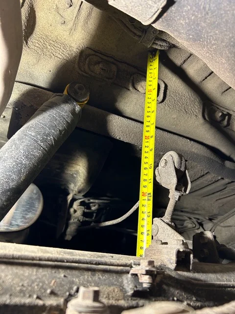

I'm glad you posted the picture of your LSPV arm. Here's a picture of my OEM set-up which sits so much lower relative to the LSPV. I have the 2" OME lift and 265/75 R16 Bridgestone tires. That places the arm at center of the shackle bushing 10-1/8" below the bottom of my cargo tub. Your shackle is so much higher that it got me to thinking about how the LSPV works. There isn't some magic pressure sensor inside the valve...the arm open or closes a valve connecting the front/rear brake hydraulics in response to downward movement of the front of the truck (a response that might be expected with relatively stronger front brakes). It's a mechanical valve that tries to keep the vehicle level when braking I guess.
The LSPV seems like a key part that will likely need some adjustment. Without it properly tuned either the front or rear aren't contributing their fair share. When you read the FSM the initial set-up requires specialty pressure valves to set the relative pressure of the front and back brakes. Well, that's probably not even something my Toyota dealer will do much less a local brake shop...never mind me and my own garage. I'm guessing that if I can just get close to the stock position of the LSPV bushing arm (relative to the valve) then I'm in the ball park for the OEM set up after OME lift and can adjust based on "feel".
So...for those that have OEM brakes that seem nicely balanced, how far is it from the center of the LSPV spring-arm shackle pin to the bottom of the tub (see photo)?

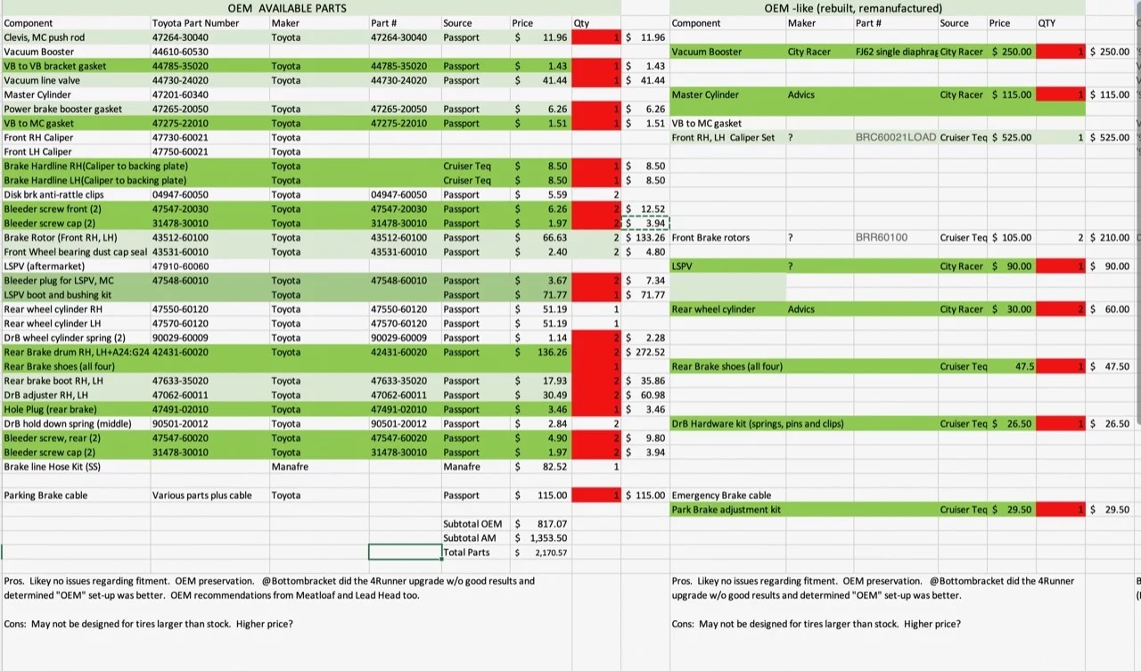

I decided to go the OEM route on a "as-needed" basis, but I've gone ahead and collected all the currently available Toyota parts. Most of the critical parts like the Booster, MC, front calipers and LSPV aren't available from Toyota, but it does appear there are quality OEM aftermarket equivalents. Minus hard lines, all the parts to complete the OEM rebuild (including parking brake cable) will cost about $2,200. I've posted the list below with parts numbers, source and costs.
I'm going to start by replacing the Booster, MC, LSPV (along with new bushings and boots). I replaced front pads and rear shoes only a couple of 1000 miles ago, so I'm going to leave those alone for the moment and see what these changes bring.

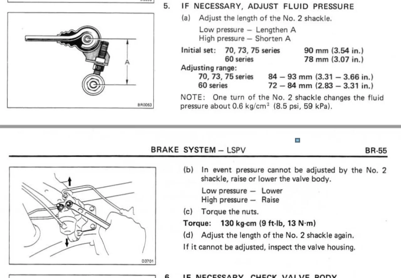

After reading the FSM and the comment above I'm confused about the effect of raising and lowering the LSPV spring arm. Here's the section from the FSM which indicates that if you raise the spring arm at the shackle (at the axle), then the pressure will drop. The FSM doesn't say so explicitly, but it seems they mean the "pressure going to the rear brake" cylinder.
Am I upside down on this?

I always think of it compared to the body of the vehicle. The closer it is to the body, it’s more like there’s a load in the back and increases the pressure to the rear brakes.
Thank you...I get it now. On the FSM is says "Low Pressure - Lengthen A"...meaning if you have "Low Pressure" to your rear brakes, then lengthening A (getting it closer to the body) will "Raise" the pressure. I misunderstood it to mean lengthening A would "LOWER" the pressure. That's why it's good to know people that are smarter than you.
