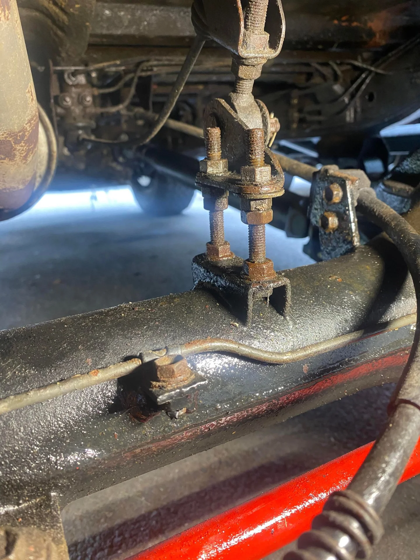

Driving around a bit I did realized my rear wheels were locking just ever so slightly before the fronts. I guess I never noticed before with all the vibrations and nonsense. So I made some adjustments to my LSPV arm mount. I'll take a photo of how I have that set up. I think it's pretty slick. Got tired of having to cut and modify the stand offs I had and made my mount adjustable so it's a breeze to get it dialed in now.

Anyways, as promised here's my stand off set up for my LSPV arm mount. Sorry it looks so crusty, lots of Fluid Film and PB Blaster Surface Shield sprayed under my FJ62 trying to fight off rust. But, basically I took some long grade 10 M8-1.25 bolts and cut the heads off and installed them into the factory holes with jam nuts. I'm able to raise and lower the arm by loosen the jam nuts and turning them in whatever direction and locking everything back down again. This beat my previous set up which was some stainless steel pipes with bolts through them. I would have to trim the pipes or replace them while making adjustments trying to get things dialed in.
