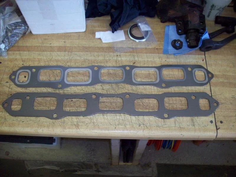

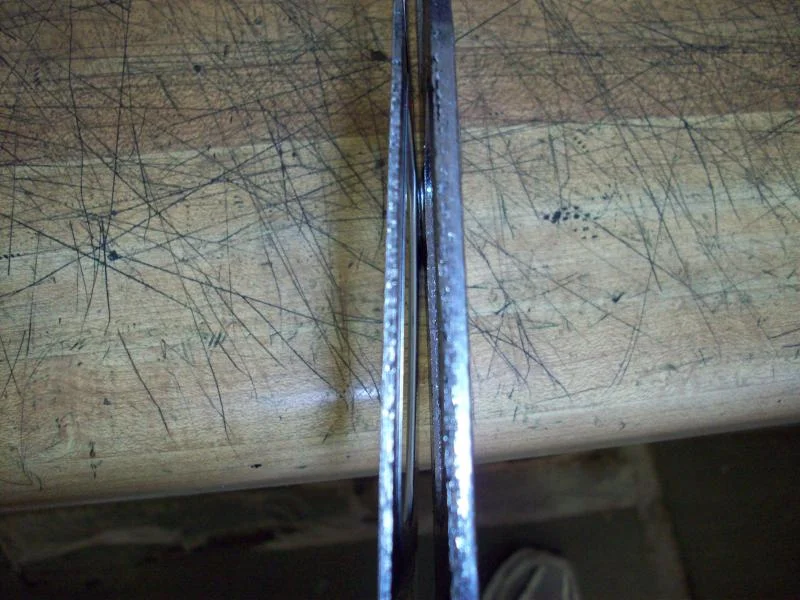

Heard a lot about the remflex gaskets, so even though I already had a new toyota gasket, I ordered a remflex to compare before putting it back together. According to remfles, their gasket is designed to compress and absorb bigger gaps. From the looks of these, it definitely will. Here's a couple pics of the differences. The remflex is on the bottom in the first and on the right in the second. Remflex is easily twice as thick as toyota. I bought mine from amazon and I forget the exact price, but it was comparable to toyota. Plus it came with the gaskets for bolting the intake and exhaust manifolds together. Put it in today, so I have no long term results to share.
I have also used the Remflex gaskets. They do crush and fill large gaps. The instructions say to torque to factory specs. Worked very well on a one piece header with a bit of a wave in it.
Actually the Remflex gasket should be torqued per their instructions which is a lower torque level than factory specs. Instructions state 20-25 ft lbs, install dry and re-tightening in not required. Just saying.
