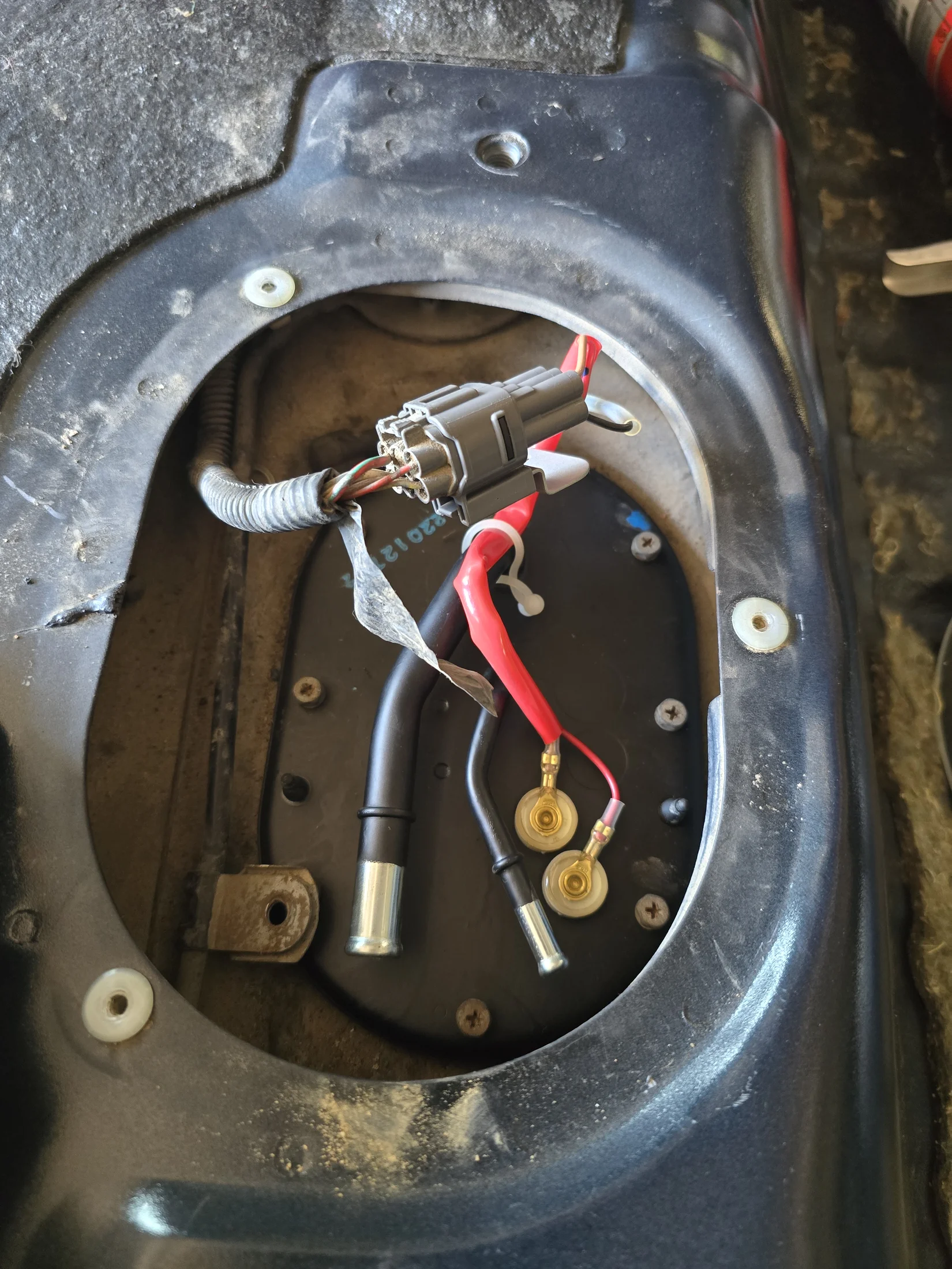

Decided to quit being a lazy fat ass today and get in the garage and check some more off the list.

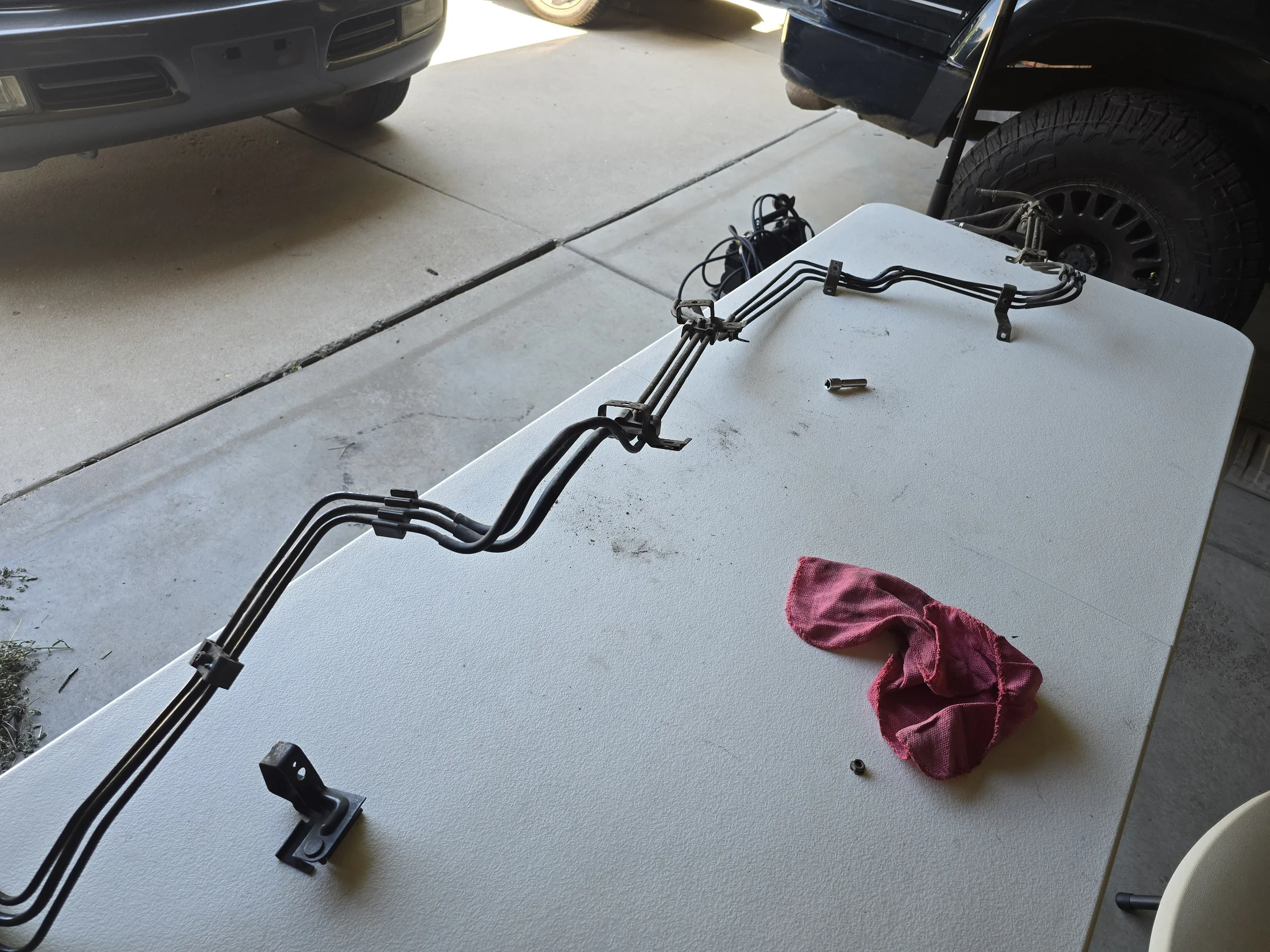

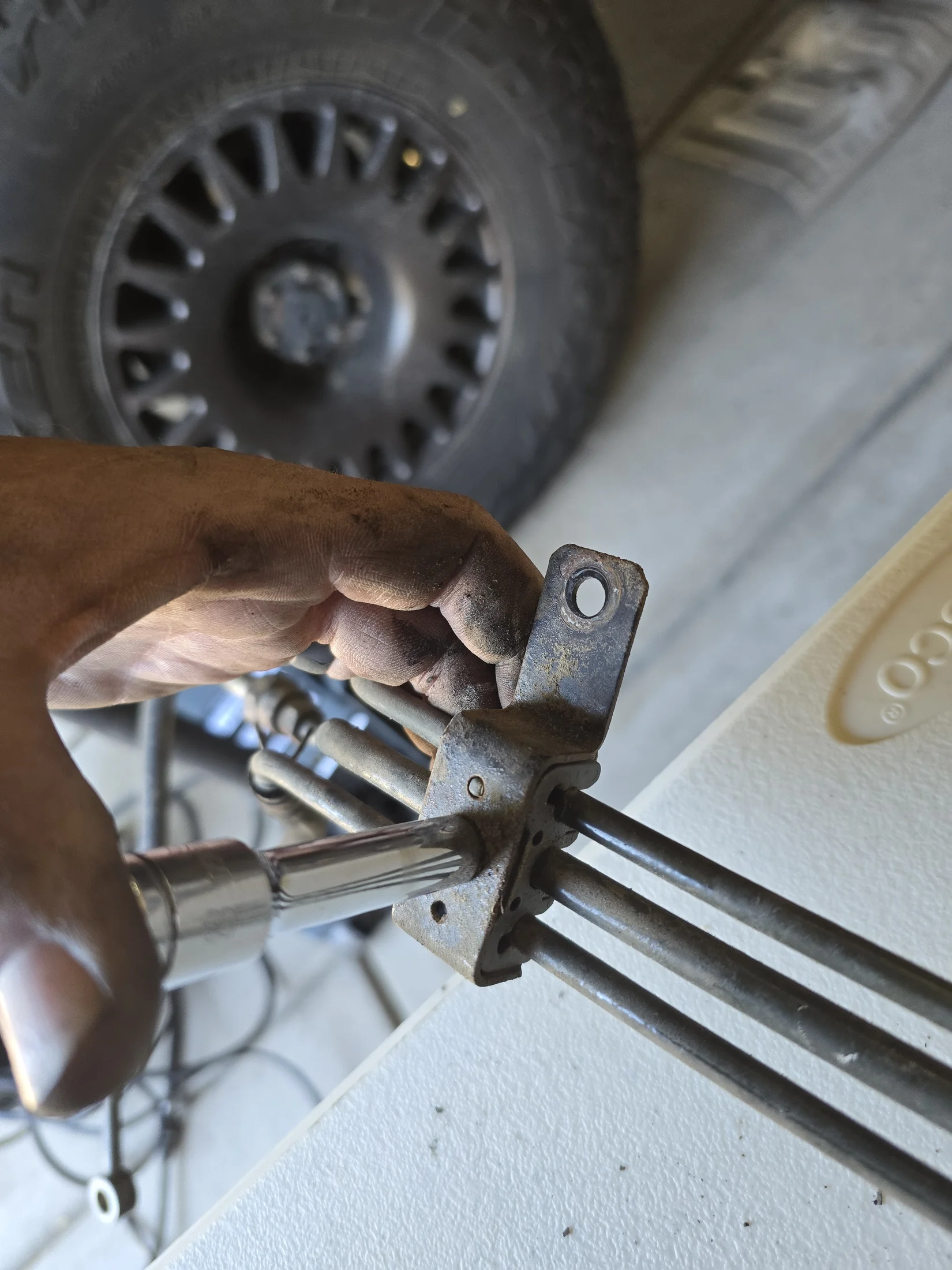

Got the main fuel assembly out, you have disconnect the emergency brake cable, and take off the exhaust heat shield. Not to big of a deal, going to get the feed line setup as a return line for the fte tomorrow I think.
As a backup plan im trying to source the late model 1997 1hdft main fuel line assembly. I believe that will be the 12mm feed and 8mm return, shipping may be absolutely killer on that though. We'll see.
Drained the gasoline out of the 80 tank, I should've drove it around more before I starter tearing it apart. Oh well lol.
Made sure the diesel tank tube assembly fit and bolted in, it did with no problems.
Next ill try and get the fuel filler tube off so can knock out the insert so I can get the diesel spouts to fit.
The gasoline fumes have also reduced my remaining braincells from 3 to 2.

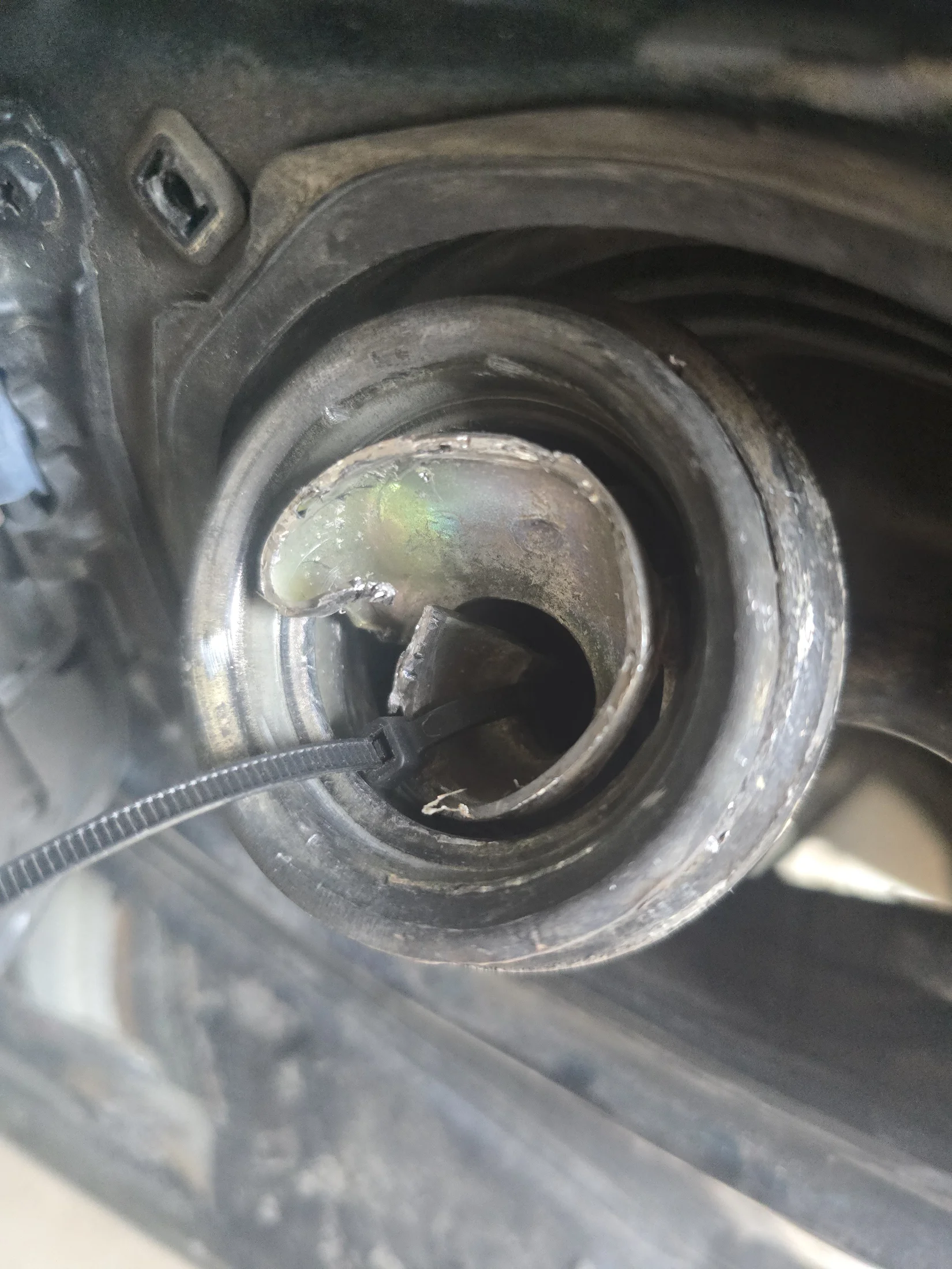

I title this, sketchy s*** no one should do! Filler tube is done, im lazy and didnt feel like lifting the body to pull the tube, disconnected it at the tank, which has already been drained, stuffed a rag in the tube tank side, used a dremel with a cut off wheel, and some metal shears, kept cutting pieces out and folding it in on itself, ziptie to make me feel better because i wasnt sure what the flapper looked like. I also used wet paper towels to catch debris and to keep things nice and cool as I was cutting.
Boom, shes out. Now to flush the tube 25 times and then hit it with air, ill flush it with diesel before first start up as well just in case.

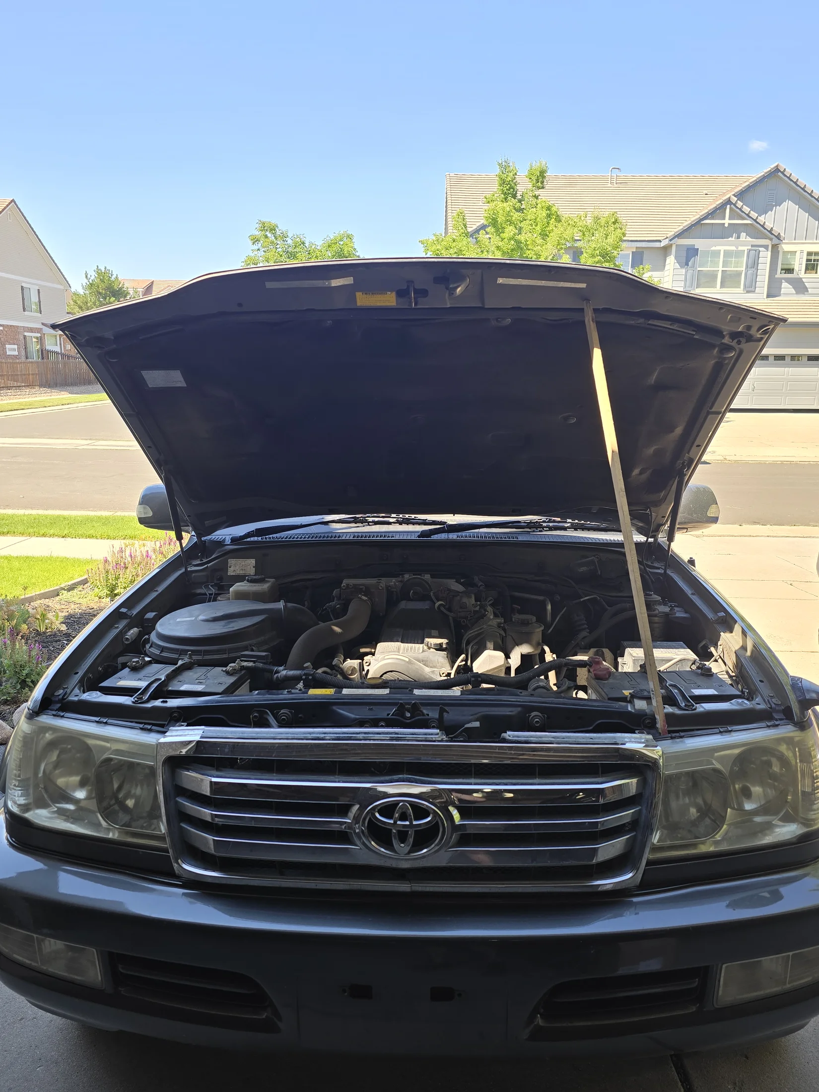

Removed the 1fz-fe gas pedal, and throttle cable. With that, i think im done taking parts off the lexus.
Debating on what to do with the 1fz engine and trans , might keep it around for a 60s series project in the future.

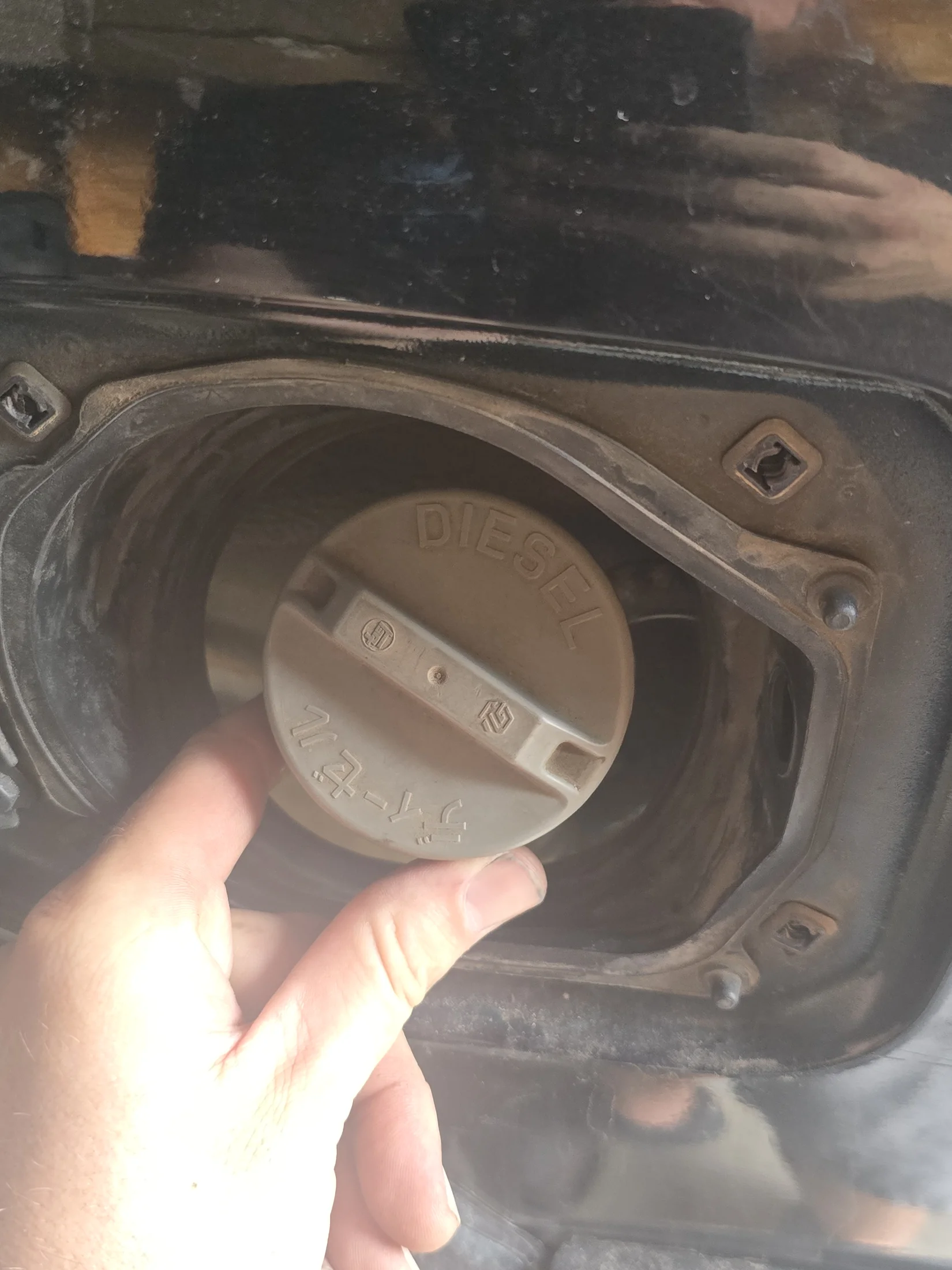

So I've been curious about this step - the idea here is to hawg out the assembly at the top of the filler neck so a larger dia diesel fuel pump spout will fit?
Classy move with the diesel specific fuel cap by the way - still taking notes.

Yeah, that's pretty much it, I bought a dremel off amazon for 100 bucks for this specifically, it comes with 3 metal cutting wheels, you just cut around the circumference of the metal insert that holds the spring and the little flapper? Shutter? That the gasoline spout goes into.
Once it was fully cut all the way around, I took a screwdriver and was able to bend the insert towards the inside of itself, then cut with metal shears, repeat those steps a few times until you're able to pull it from the tube.
I did flush the tube first with about 2 gallons of water to make sure any residual gasoline was out first.

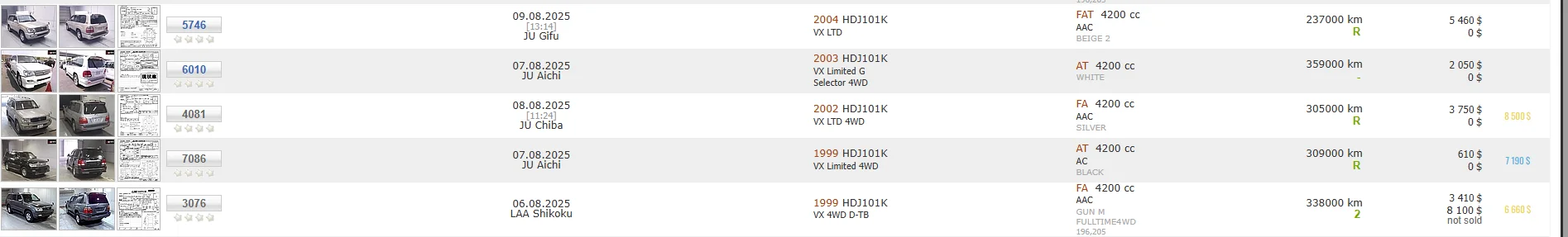

Got a few options, the R's are rough, but 4081, and 3076 show potential.
