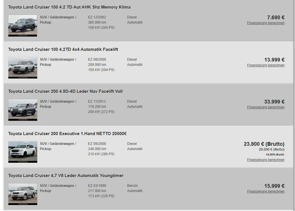

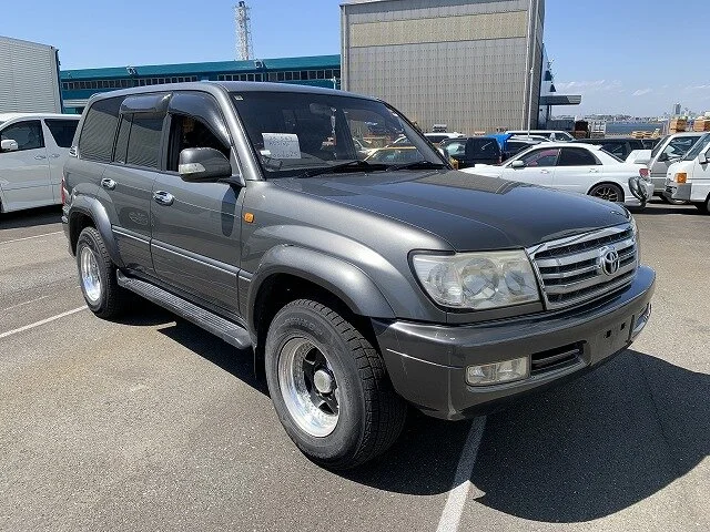

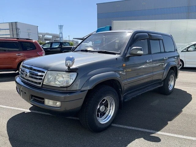

Here is one of them ... dealing HDJ100 from Danmark. He is always getting a bunch of these frequently
https://home.mobile.de/JKRAUSEAUTOMOBILE#contact

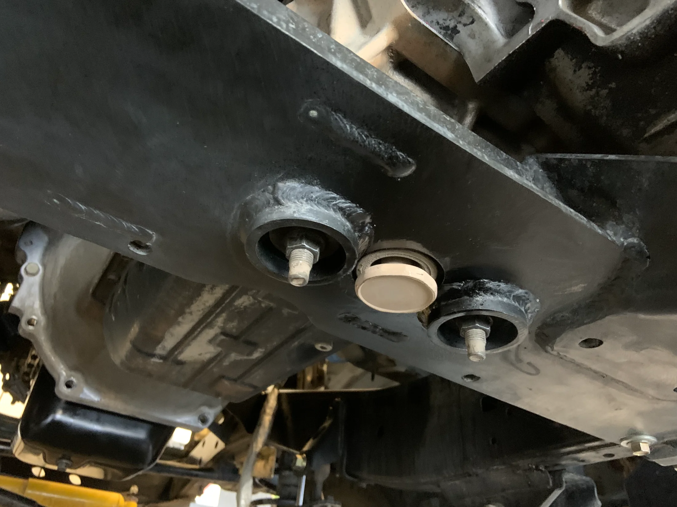

I'm going to take a moment and make a comment for the benefit of anyone experiencing a similar issue.
Ok, I've had a transmission-related vibration pretty much since I finished the conversion. The symptoms were a very noticeable vibration when sitting at idle in Drive or Reverse. Several friends and I explored several theories; over/underfilled transmission fluid?; failing line pressure solenoid?; contact between the shifter and tunnel?; loose engine mount?; ECM related errors?; bad torque converter?; loose flex plate?; etc. Despite hours of troubleshooting, nothing seem to be directly linked to this vibration.

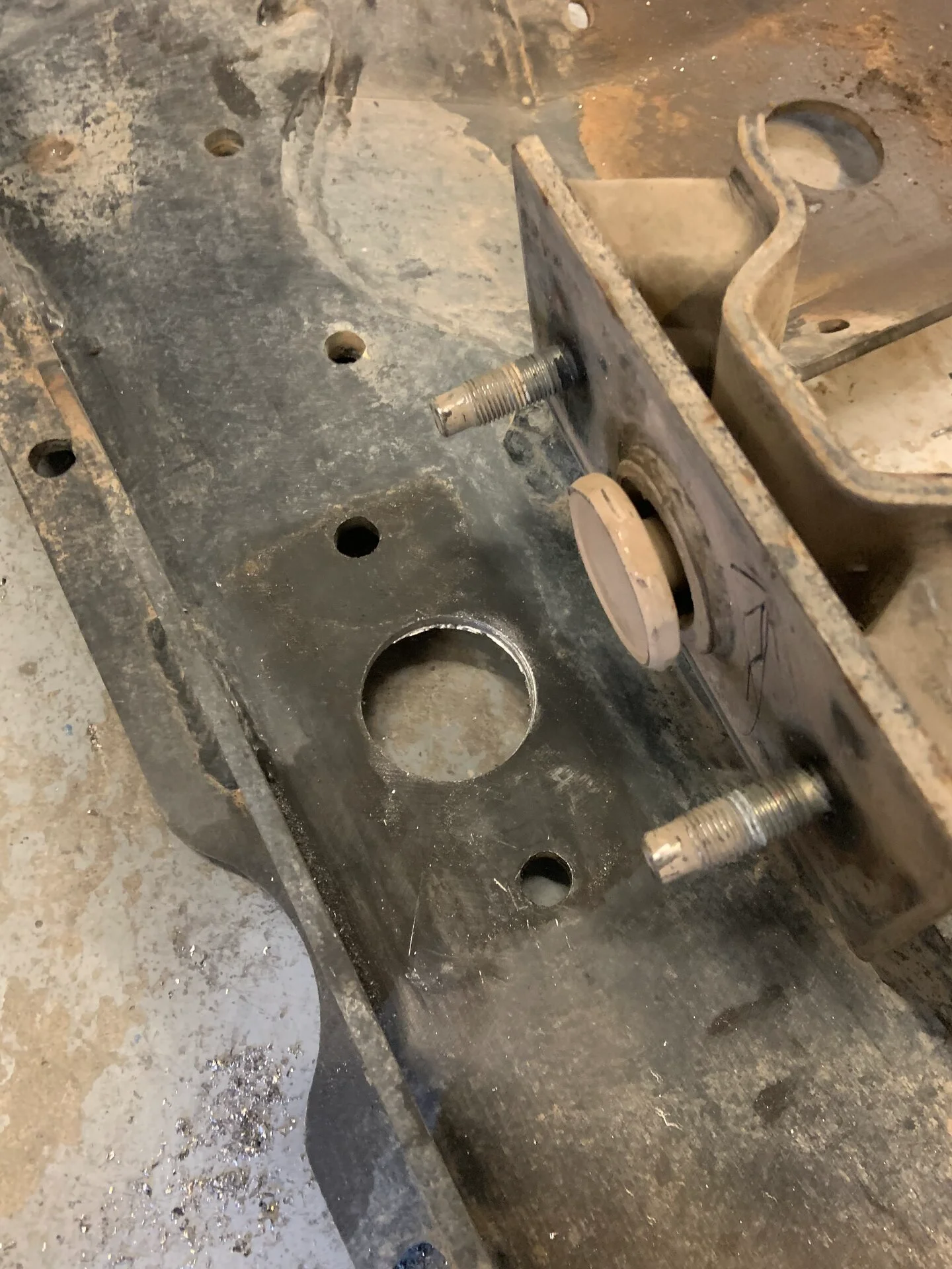

Recently, while using a buddies lift to do some maintenance, we noticed the transmission isolator mount bolt head showed signs of rubbing the transmission crossmember mount. WTF? Rut-row. Ah HA!
When I did the conversion, I used a hole saw to clearance the transmission crossmember. Although this hole looked large enough to pass the nut head through, apparently the drivetrain moves enough on the rubber isolators to allow contact under certain conditions. As soon as we radiused it to provide more clearance all weird and intermittent driveline vibration issues are now gone. Frickin' wow.
I can't believe it took me two years to solve this one. So for anyone using a 100-Series transmission isolator with that big-ass nut in the middle, make sure you drill a hole large enough to provide a clearance margin due to drivetrain movement.
