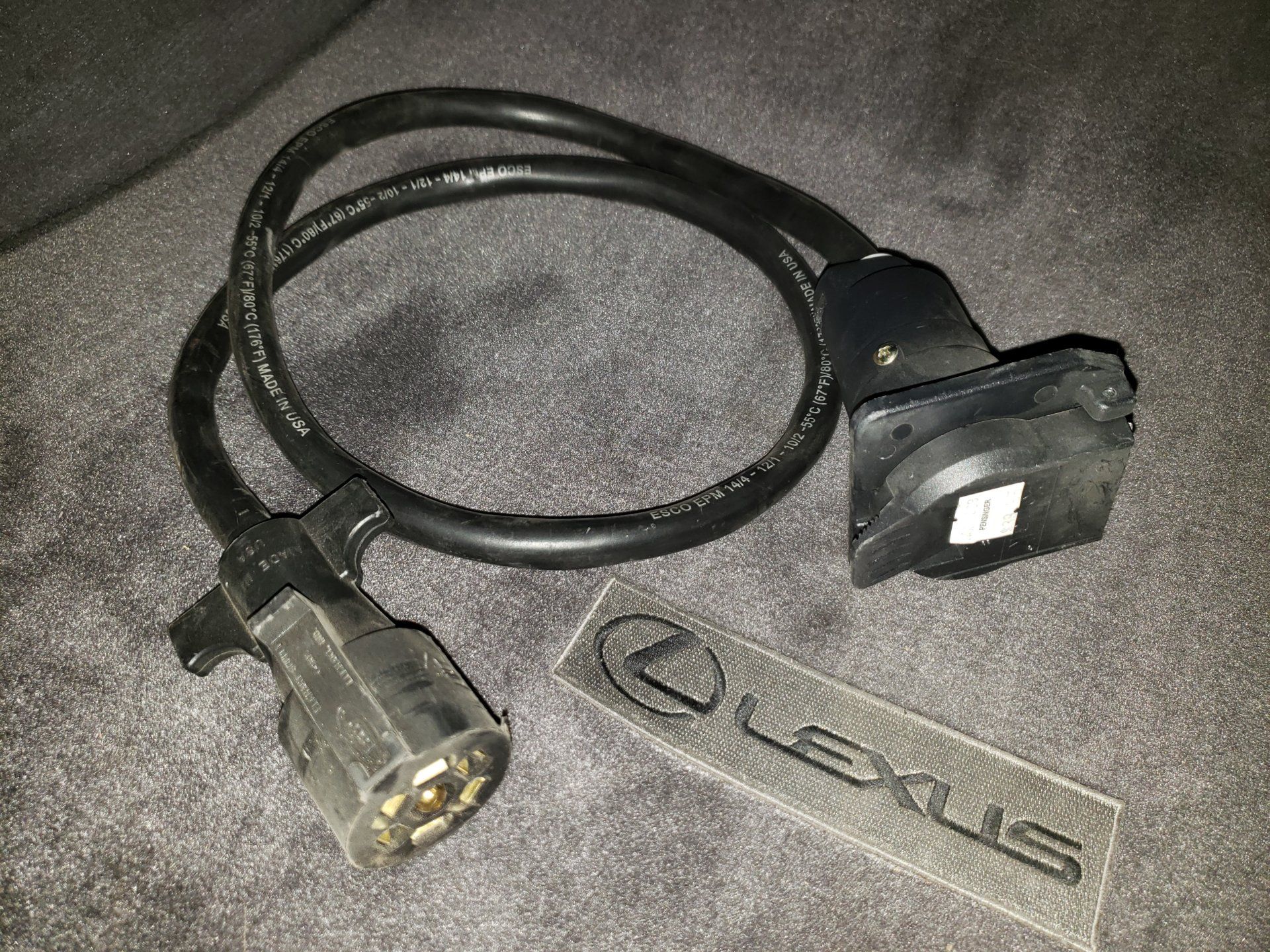

So this is actually an off the shelf item at my local RV supply store. You may not be able to read the price tag but it cost me about $40 which is about twice what it would have cost if I would have planned more in advance and just gotten it on Amazon. It's about 48 inches long which is way more than I need, but that's just how they sell it. It's the real wiring though, with 10 AWG for the 12V+ and ground, 12 AWG for the brake control wire and 14 AWG for the 4 lighting wires and a quality plug and socket.

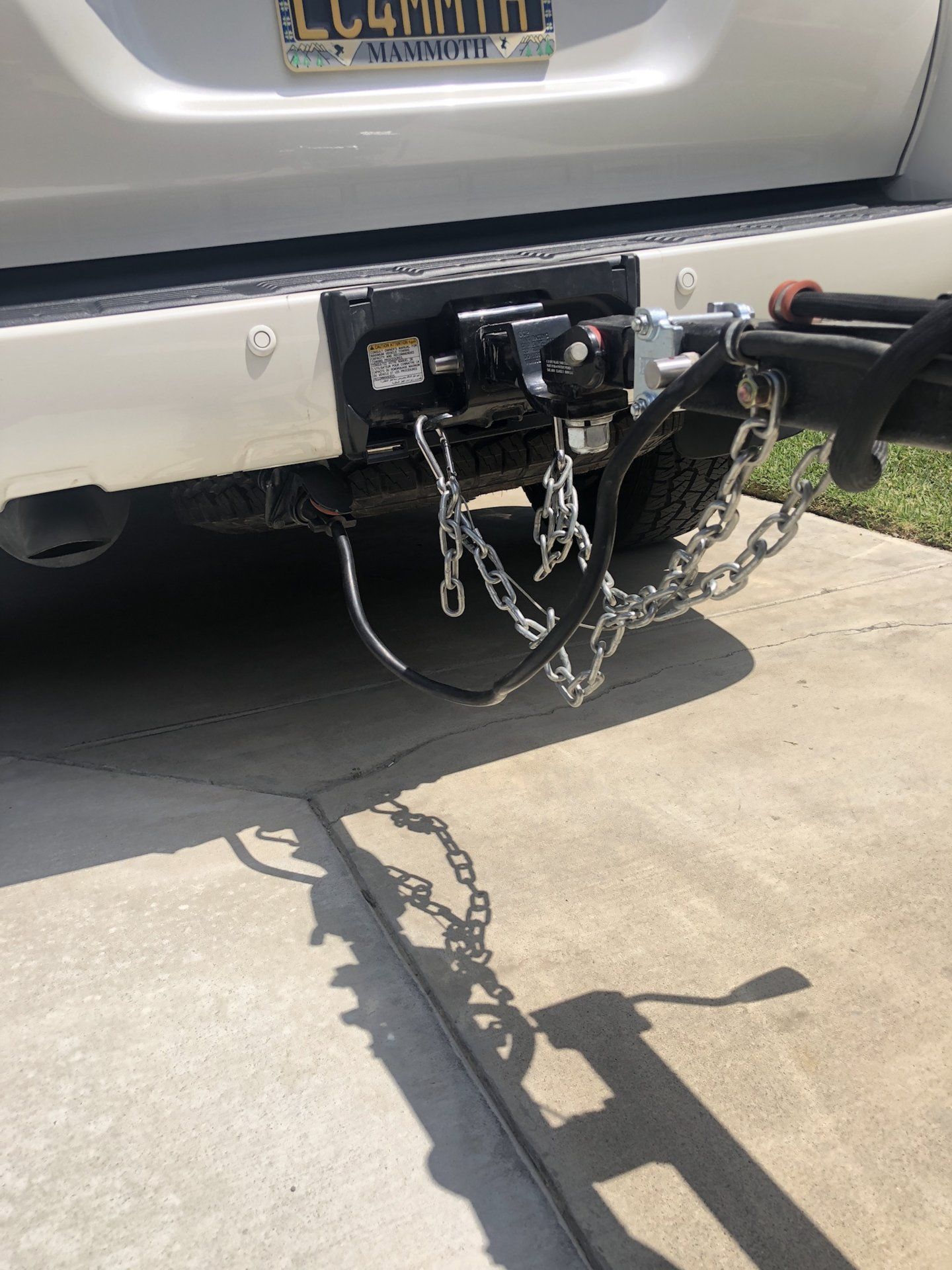

2019 22' Sport Bambi. Today I had 2" cut off the bottom of the extended shank and had the brake controller installed. Ready to roll.
I likewise use an Equalizer hitch. It's a good standard among WD hitch users with probably more in use than any other hitch.
What weight bars did they set you up with?
Weight bars are 1,000/10,000. The replacement shank I found is a Curt brand 12" long x 8 3/4" drop with a 13" rise. With the 2" or so cut off from the bottom of the shank, it is flush with the bottom of the assembled hitch. It's still lower than I would like, however much better than it was. The trailer sits level. Haven't taken it out to test drive yet. Now to a scale to check out the weight.

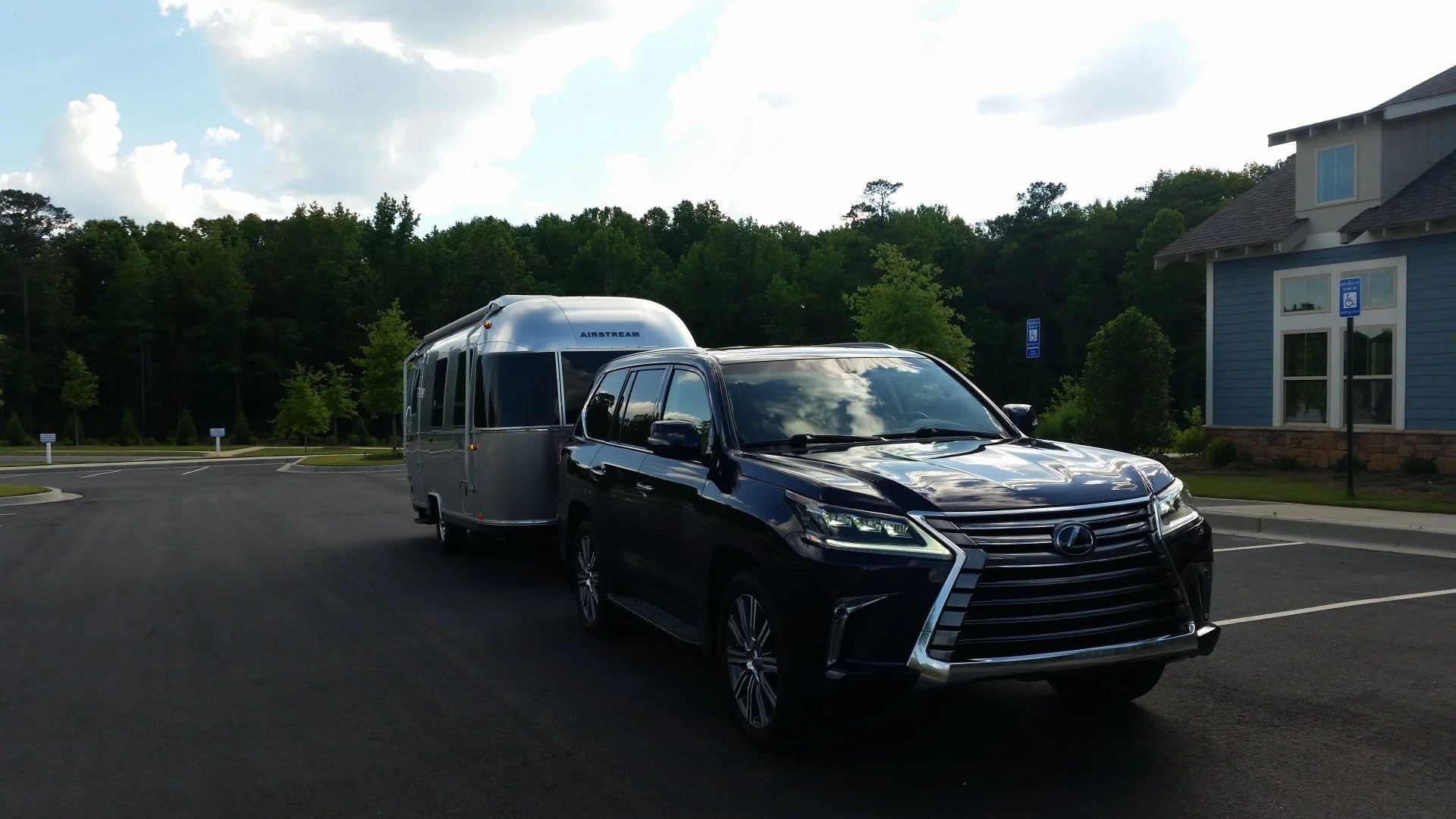

Last evening I took the LX/Airstream combo to a CAT scale. If you would, help me think through the result. The front of the LX weighed in at 3280 lbs., the rear LX axle AND trailer (on same scale) came in at 7,520 lbs. combined. I went through a 2nd time and weighed just the trailer - it came in at 3,580 lbs. with just 200 lbs added to the trailer (20 gallons of fresh water and 2 full propane tanks) - no other gear that we usually take. It's hard to see in the photo, but the back of the trailer frame is about 2" lower than the front (measured on the tongue). My thought it will sit down some more, in spite of the AHC, with more weight in the LX cargo area and 200 lbs. of assorted supplies under the trailer bed (located front center). I drove it on the interstate as well as 4 lane city streets & 2 lane winding roads (mild hills). Semis passing me on the interstate did not bother the LX whatsoever. Thoughts or suggestions?
Based upon the two sets of measurements, here's what I'm distilling for your setup
Front: 3280 lbs
Rear: 3940 lbs
Net vehicle: 7220 lbs
Trailer: 3580 lbs
Total Rig: 10,800 lbs

By all measures, you're sitting pretty. Your WD tension seems to be properly setup and well adjusted, returning good front axle restoration weight (FALR). Best test as you've confirmed is driving stability. If it feels good, you are good to go.
The LX will not squat with more weight in the boot. AHC is pretty robust and will maintain constant height with the weights you're at.
Ideally, your trailer would sit level front to back. 2" rake is not bad unless you really want to dial it in. Or you find yourself dragging the rear of your trailer, which is not uncommon for Airstreams as they sit lower, and you want that clearance back. Easy button IMO is to upsize the tire or wheel as mentioned earlier. Another somewhat easy button is to do an .5" AHC sensor lift to the front of the LX. By leveling the LX ride heights front to rear, it'll bring down the hitch ball a tad.

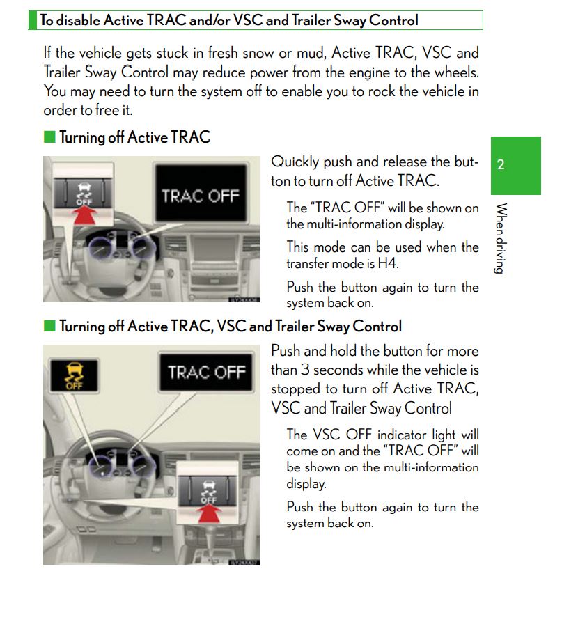

General consensus to turn OFF trailer sway control when using a WD anti sway hitch? See that is recommended a few other places. I picked up the redarc tow pro, but don't have an extra spot to install it! May have to go with another system or get creative.
Not sure I understand the question? What do you mean by turning off trailer sway control? Is that turning off stability control of the tow vehicle?
Yes, I believe it would be deactivated by holding it down for three seconds when not moving. After researching a bit more, sounds like general consensus is to leave on as it shouldn't ever actually activate with proper set up. My neighbor recommended it off, which seemed counterintuitive so started researching. There was a manufacture that recommended shutting it off, but I have no idea the dynamics behind why.
was reading some posts here: F150 sway control setting ON or OFF - Jayco RV Owners Forum - https://www.jaycoowners.com/forums/f37/f150-sway-control-setting-on-or-off-70994.html
Leave it on. If you're driving in heavy rain and start to hydroplane (or slip on snow or ice), it will evenly apply the brakes to keep you from spinning out of control. On dry pavement it does nothing.
