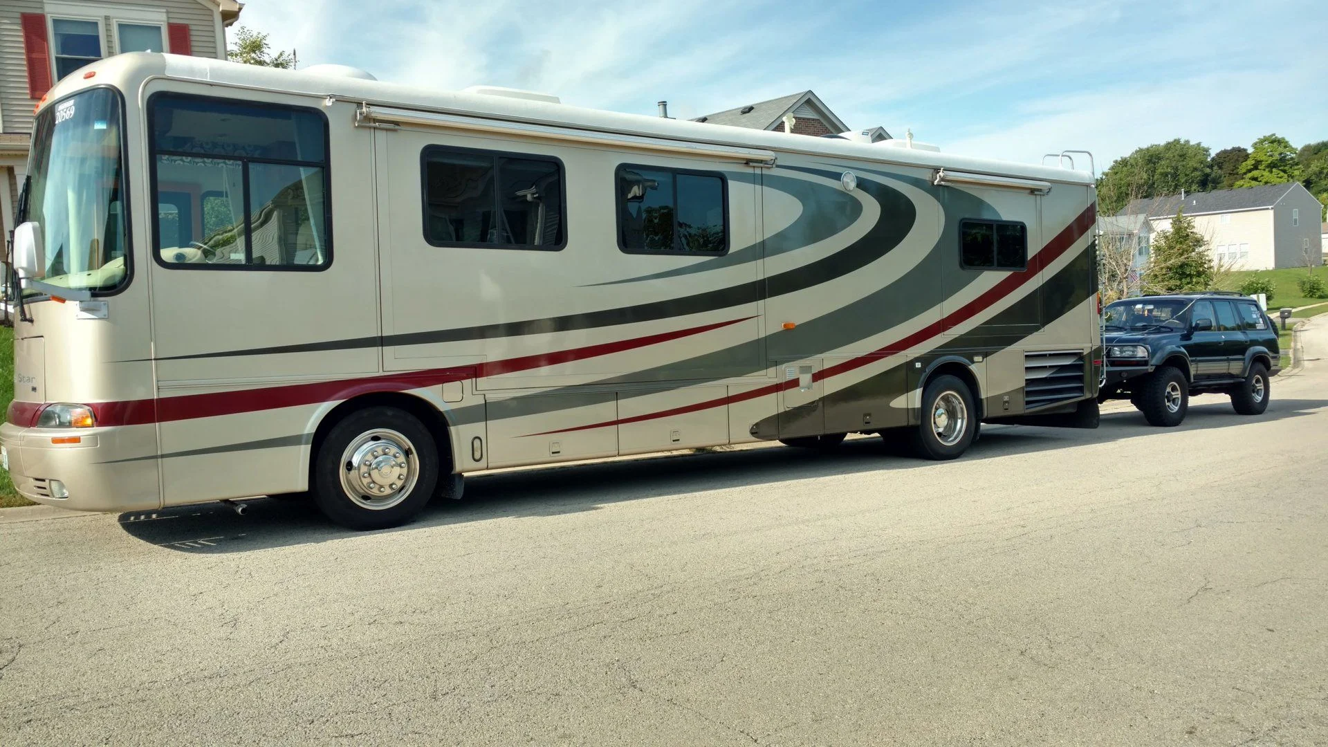

Starting to wonder if this is the only way my 200 will join on our long term family camp adventures... Currently rocking a Diesel Pusher and begging for someone to pioneer the ability to flat tow the 200 without driveshaft disconnects. (IE a transfer case swap or mod with a true neutral like my 80 and the 100 have) Currently flat tow my 80 and it's been great so far but considering eliminating it from my fleet as this is the only time it's really been used the last 2 years. Good to know the 200 will tow a sizeable trailer safely and enjoyably if that's the direction we end up going. Thanks a ton for sharing everyone! Pic of our current setup just for grins :)

Nice Newmar! If I could flattow I'd snag one of those. Looks like the only option is unbolting drive shafts. Or getting a dolly so you only have one driveshaft to disconnect? Either way, yeah, kinda sucks.

Thanks! And yea... I will keep the 80 or tow the wifes JK (ugh) before messing around with driveshafts or dollys. I have towed in an enclosed and that isn't so bad for long trips with a single destination and has the added benefit of additional storage. But for the kind of trips we usually take, which are more expo :eek: LOL as expo as you can be in one of these things... With lots of stops, boondocking and small rv parks where we spend a couple days and use the truck for exploring the local area it's just too much of a hassle with the trailer.

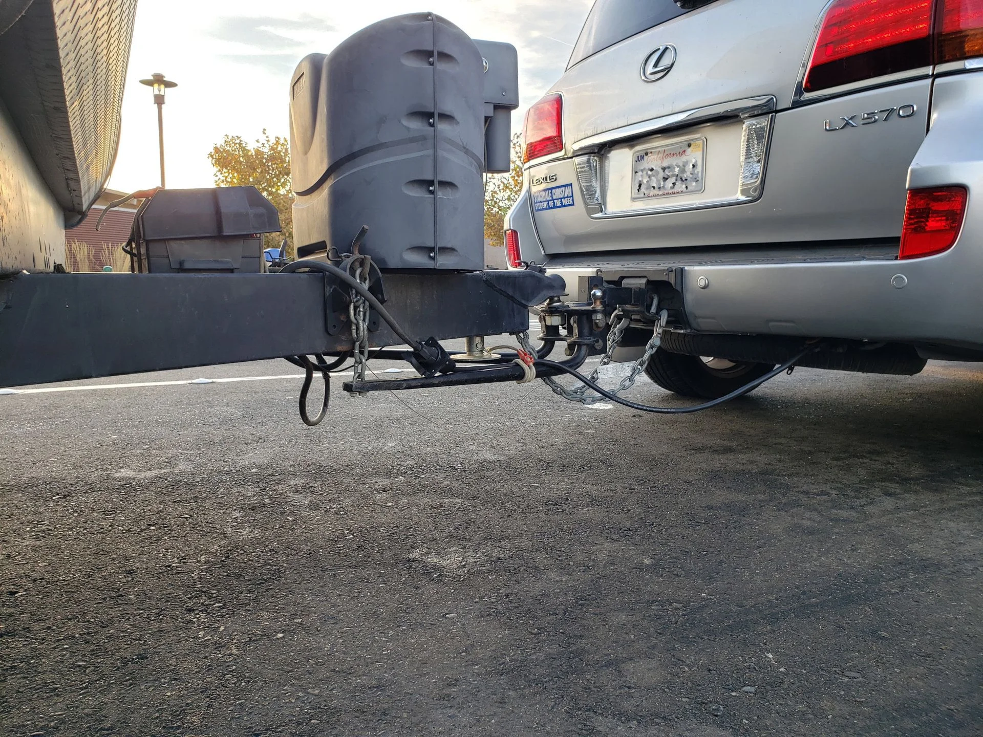

I tried my hand at some towing this weekend and I really appreciated the load leveling.
Weight distribution bars helped, but I appreciated when I lowered the tongue that the AHC picked it right back up again. Side note, has anyone else found that the 7-pin receptacle is so far up and to the side that a normal length harness is too short to reach? I had to get one of those adapters that 5th wheel guys get for the bed of their truck.
It's a 29' with a dry weight of about 5800 lbs. and it sat just like this the whole trip. About 140 miles each way is unfortunately about all I was able to get out of a tank of fuel, but she had no trouble pulling even up hills. Plus the addition of a Tekonsha P3 brake controller with the plug and play harness made for easy stopping as well.

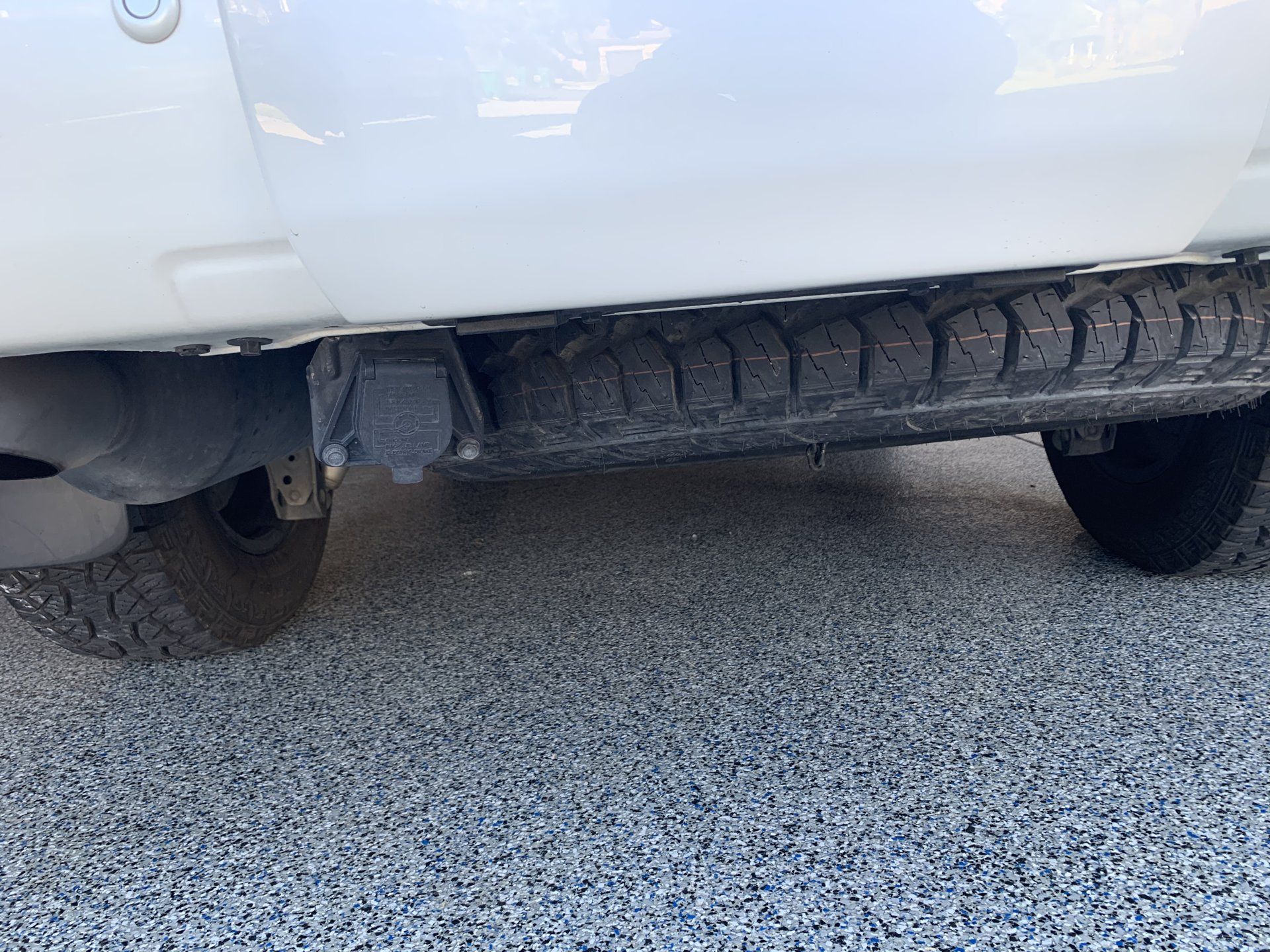

I relocated mine.
After 450 km's of gravel road I have to support my cable because the plug has "loosened up". I was losing contact with the trailer occasionally and attaching it to the Rock Guards (or whatever the mudflats on the hitch are called) was the easiest solution. The downside is that I know that I am going to drive away one day after forgetting to unhook the cable/mudflap connection.
Just curious but in this location, do you ever scrape it when off road or is it protected by the spare? I could see myself scraping it off on some of the trails here in Idaho.
Scraping has been a concern but it has not been an issue due to the tire sitting lower and I have not had a steep departure to drag the rear end.”12.5 aux fuel tank / tire sits a tad lower.” The only issue with a bumper install is room behind the bumper near the center.
