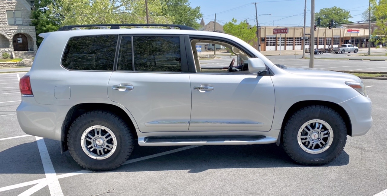

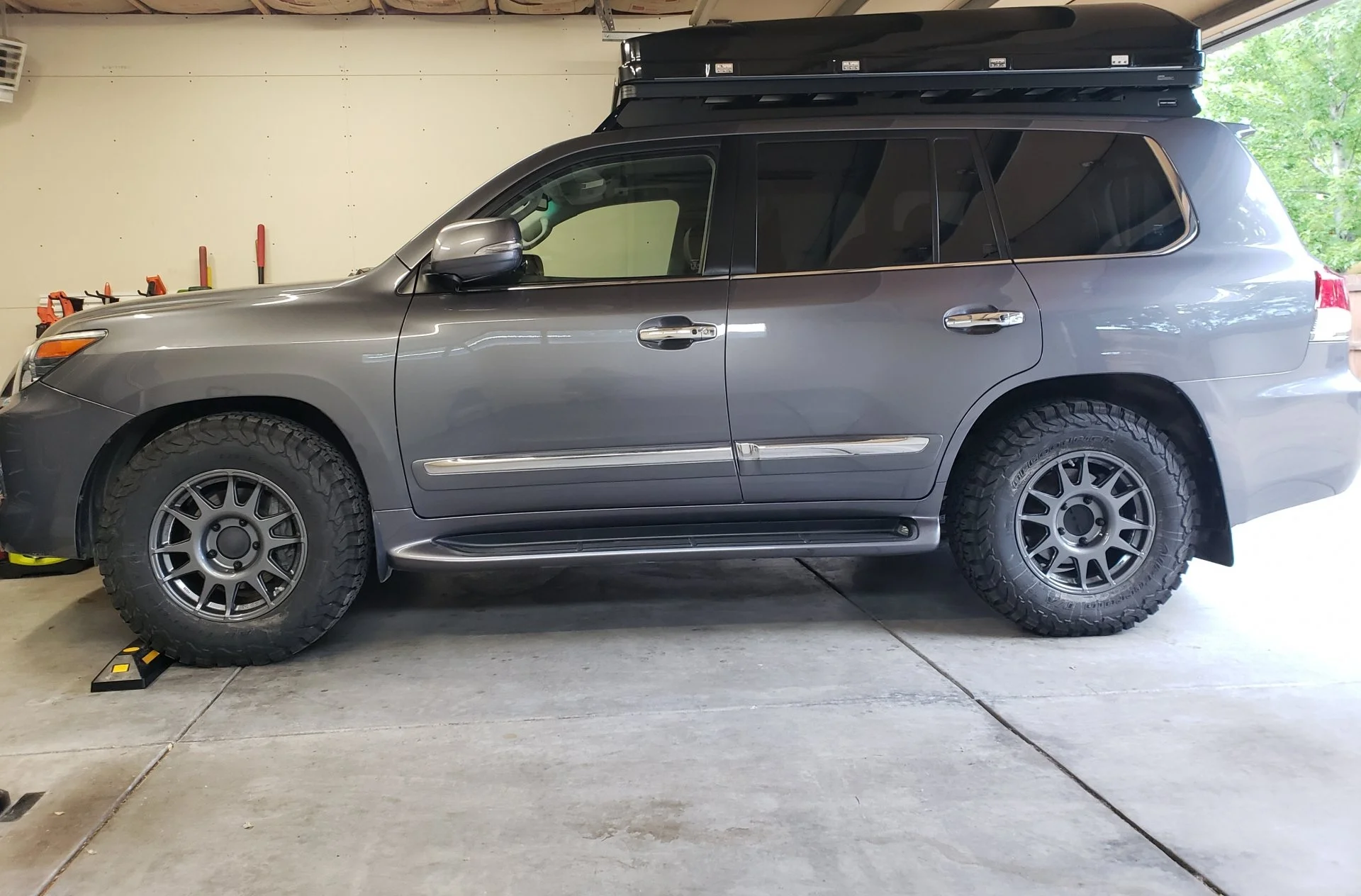

Sounds like you're looking for something more aftermarket looking than OEM wheels? Its going to be subjective, but from a functional and technical standpoint, I would put OZ Rally Raids pretty high up on my list.
OG quality wheels that have withstood the test of time rather than many of these style first wheels. From a technical standpoint, they also come in the perfect offset for the 200-series (+30mm) that reduces some of the offset compromises of other wheels.
Pic borrowed from @tpatt88 here

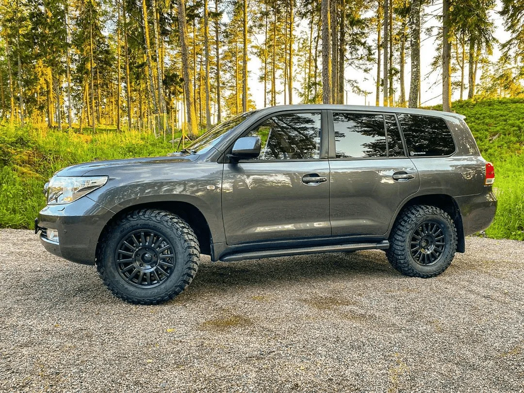

and here

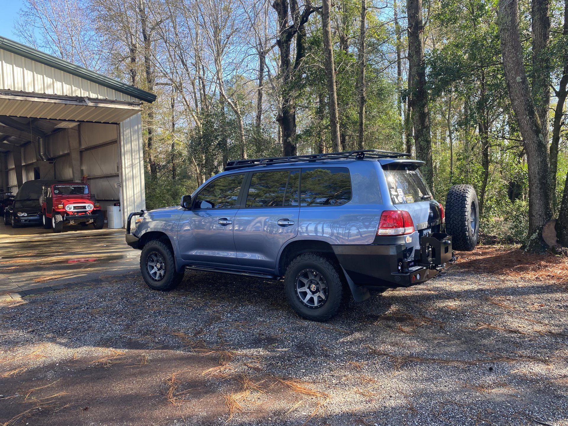

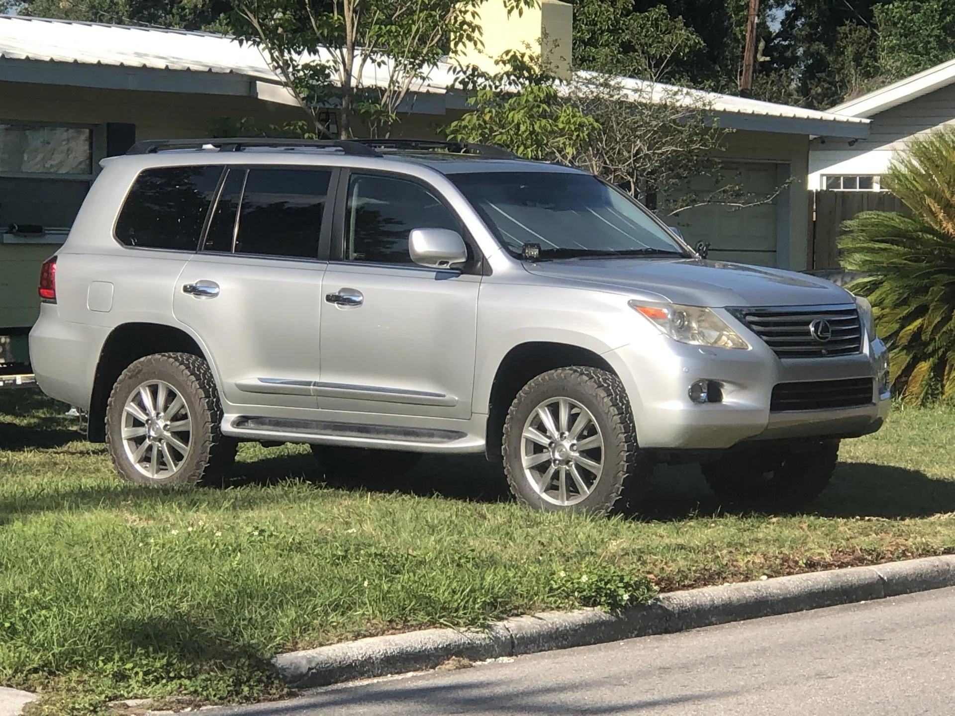

275 70 r18’s on evo corse’s are the best looking non oem rims and tires that’s I’ve seen for a daily driver type build.
Are these the correct ones for the lx?
I believe so. Not my rig…just a photo I came across. If my rims get damaged or start looking rough, I plan on moving to that wheel and tire setup.

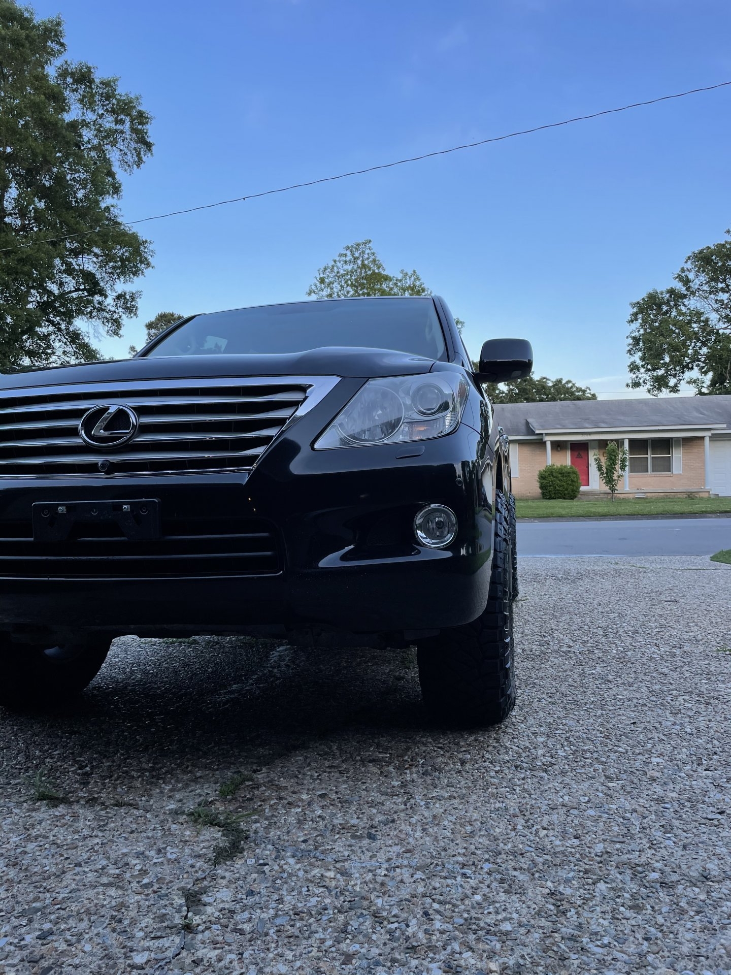

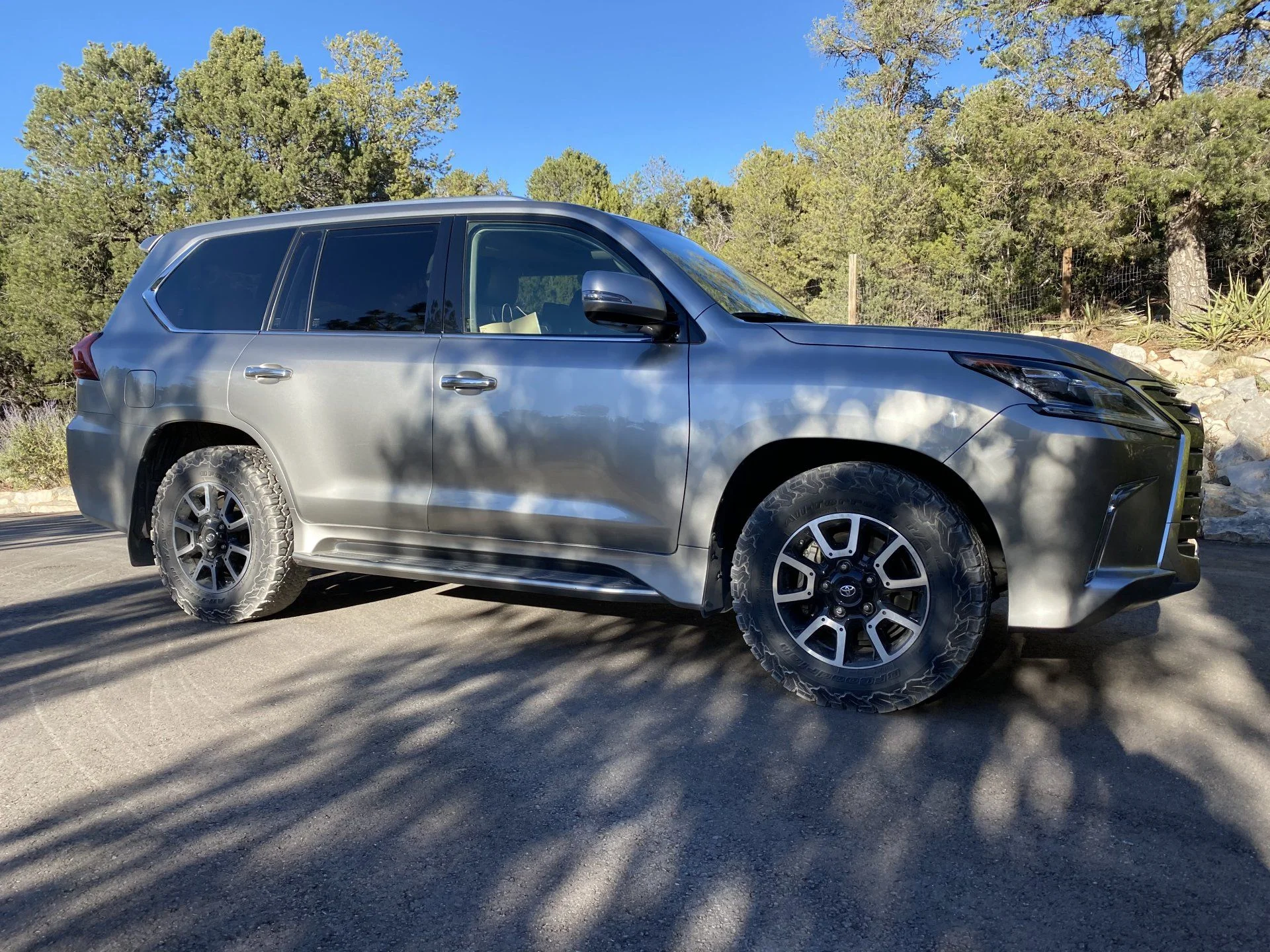

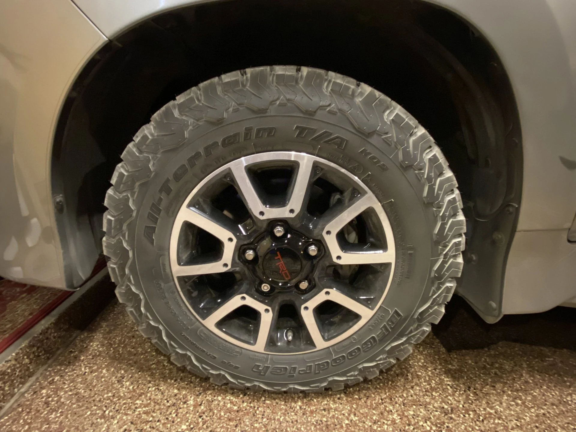

Currently I have stock rims and 275 60 r20 k02’s. The tires are only $250 a piece and they ALMOST approximate the 285 70 r17’s that Toyota recommends as an alternate size for the 200. They’re just a tad narrower and a tad taller. Photos of Mine are attached.

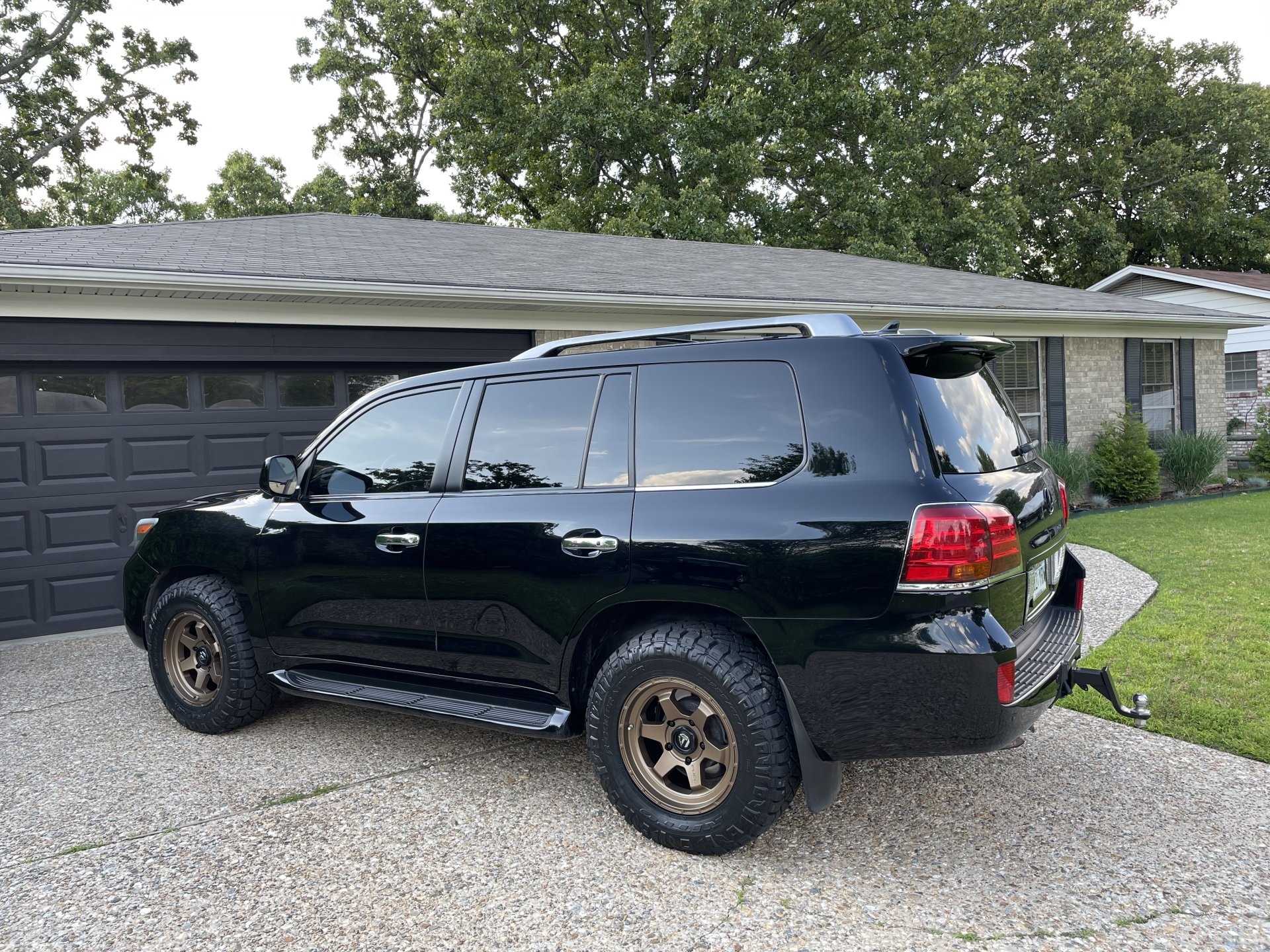

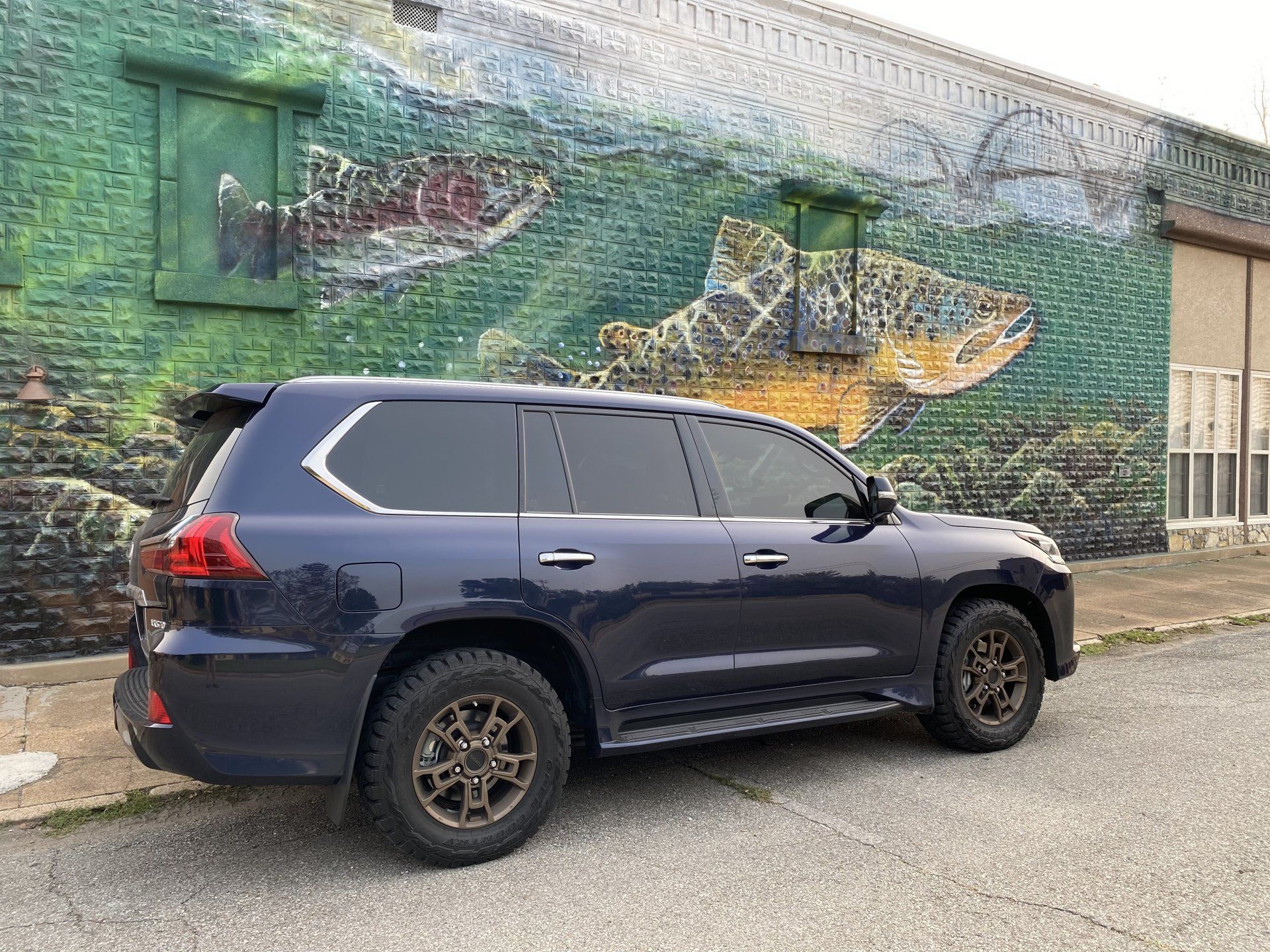

I’m on the eternal search for rock warriors... I’m about to give up since I’m due for summer tires soon. I’ll probably put method 703 on my ‘13 LX. 17” - 35 offset.
If you aren’t buying cheap tundra wheels, I’d suggest considering 17” wheels. Just as many, if not more tire options, and generally about 20% cheaper across the board. Plus 34s on 17s look beefy, they look beefy on 18s too, but 17s is what I went with.
