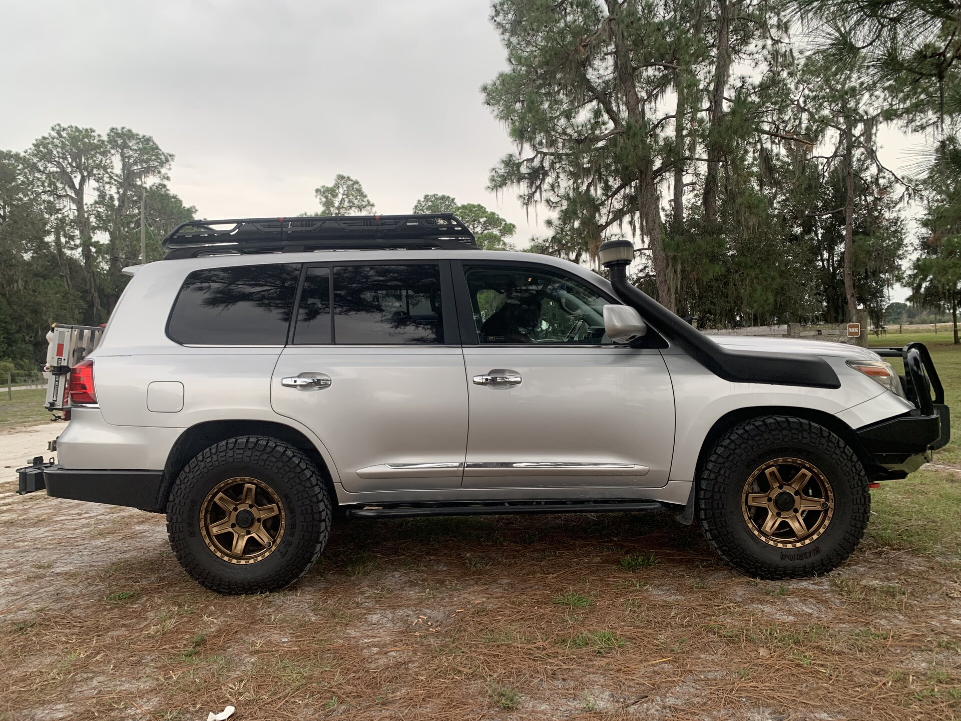

I know this thread has been idle for a minute, but I ran across it in my search for similar answers to the OPs question. I've got a stock 2019 LX 570 and I wanted to upgrade the tire and wheels. I also have the 21"s and have put an order in for a set of Evo Corse Dakarzero in 18x8.5. Offset on these wheels is +45. Was wanting to know if I could run a 275/70r18 or even a 285/70r18. I've not done the sensor lift nor do I really want to remove the front mud flaps. I'm in south Ga so it's mainly swamp and mud here - no rock climbing or any major technical crawling. Any help would be appreciated!
For the 275/70-18 you will likely have to minimally “adjust” the section of the front mud flaps that extend up into the wheel well with a heat gun, drill, and zip ties. For the 285 you will for sure have to at least make adjustments and could have to remove the front flaps

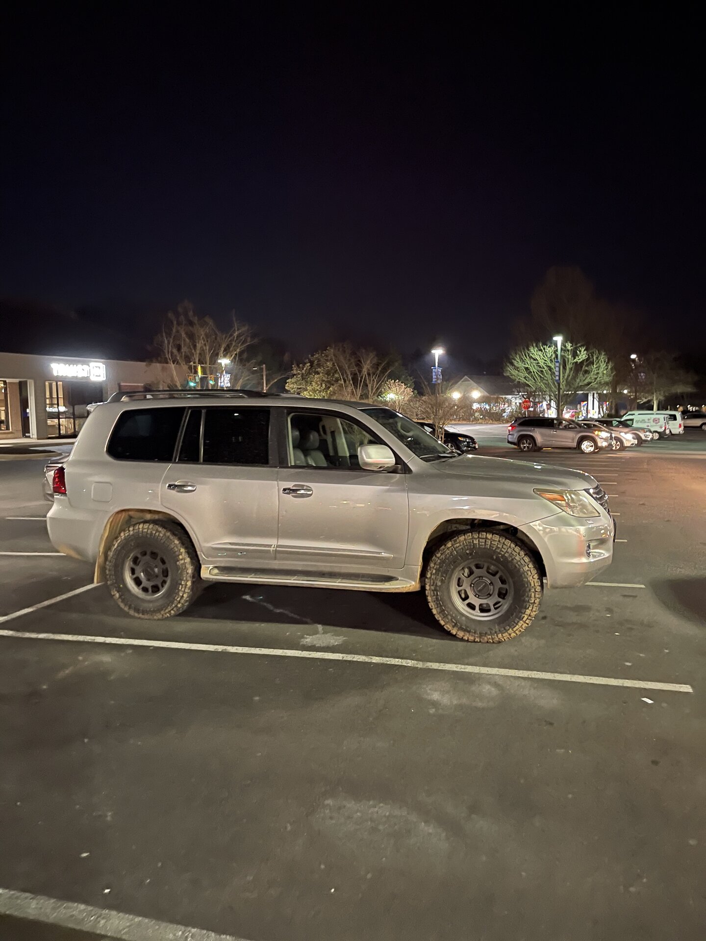

Of course, hope I can help! I didn’t trim anything, no BMC, no spacers. Sensor bolts moved all the way up in the front, and all the way down in the rear. Moved the front fender liner forward and took off the mud flaps in the front. Method 705 with 25 offset and 35x17x10.5 Kenda Klever RT.
Some more pictures that hopefully give you a good idea of fitment with the offset. Second picture I think is in Hi mode.

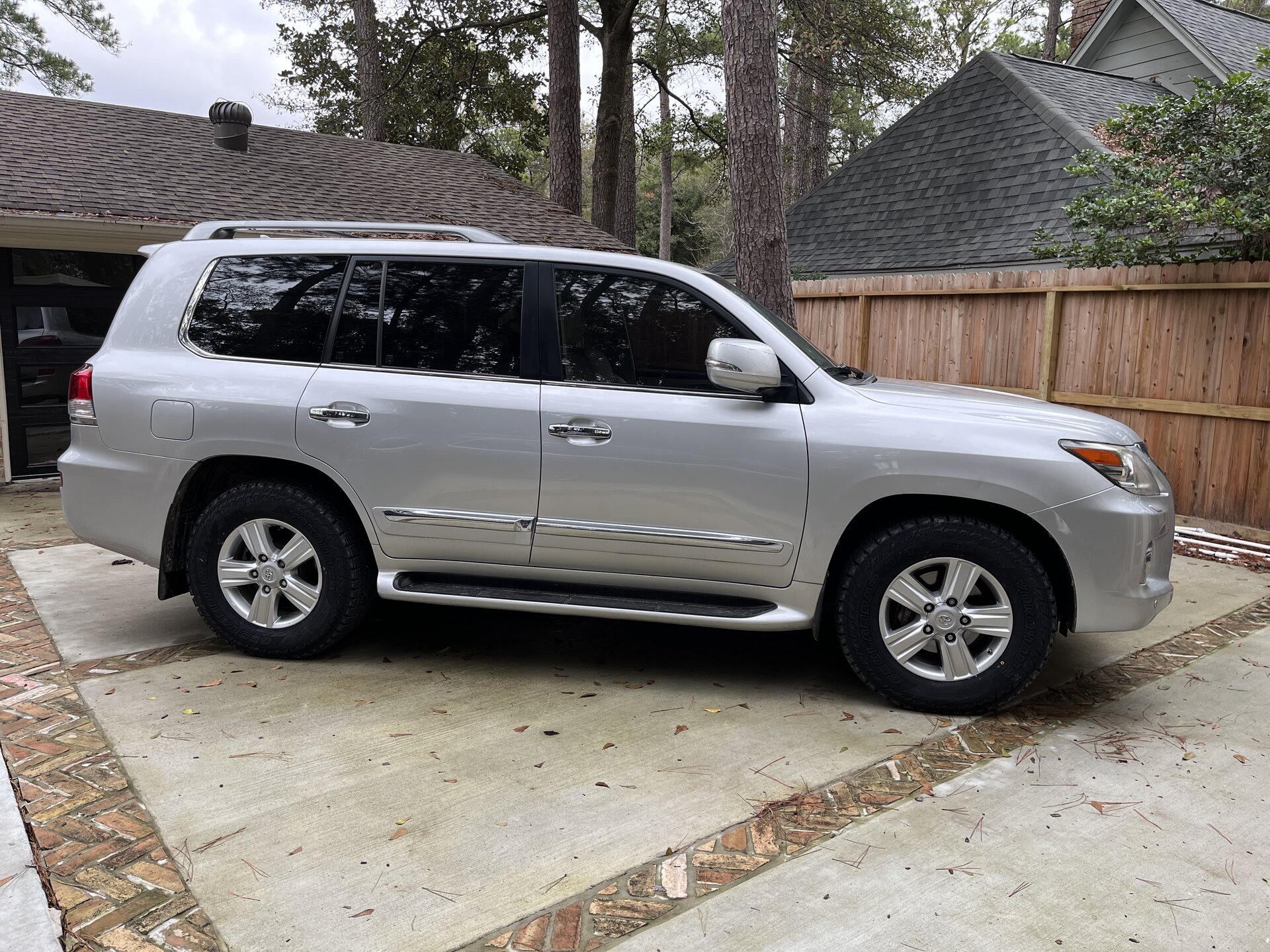

Anyone have pictures of a silver 2016+ LX570 with the gold Heritage Edition wheels?
I'm trying to see what that combo looks like and would rather the gold versus the black Tundra wheels.

Here’s a “wish” version-gold on silver

I have no problems taking closer wheel well pictures if you like. Check this out and you’ll see no rubbing and complete tuck with lots of wheel turning. Second you can see clearance and tuck in the rear a bit. In the YouTube video on the profile you can see full rear tuck too.

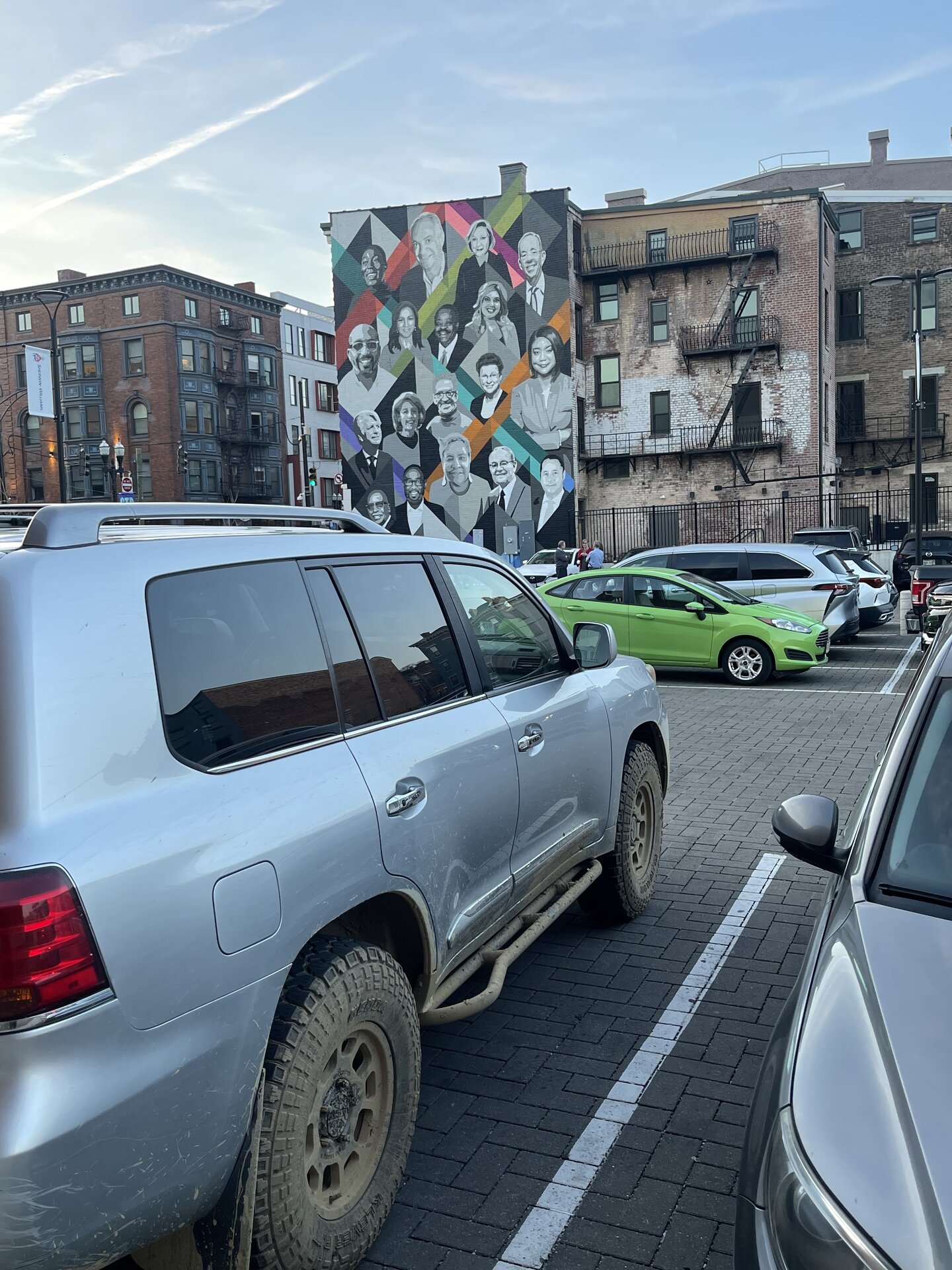

If you aren’t buying cheap tundra wheels, I’d suggest considering 17” wheels. Just as many, if not more tire options, and generally about 20% cheaper across the board. Plus 34s on 17s look beefy, they look beefy on 18s too, but 17s is what I went with.
I've been reviewing info on this amazing site for 6 months. Your wheels/tires look great. Could you provide tire size, offset, and the tire/wheel manufacturer details? I'd like to see if this would work for a 2017 LX570 I bought 6 months ago. Thanks!
Looks like 285 75 17 on a 17” wheel w 50 offset…likely with a 1-1.25” spacer.
Yes and yes and no spacer.
It’s the LT285/75R17 Load E Toyo OC AT 3 on ET 50s. The wheels are forged Toyota TRDs that were optional on earlier 200 series Land Cruisers. Also came on all Tundra Rock Warrior packaged trucks. No spacers. Didnt hit any metal, but you’ve got to move plenty of plastic for it to fit.
