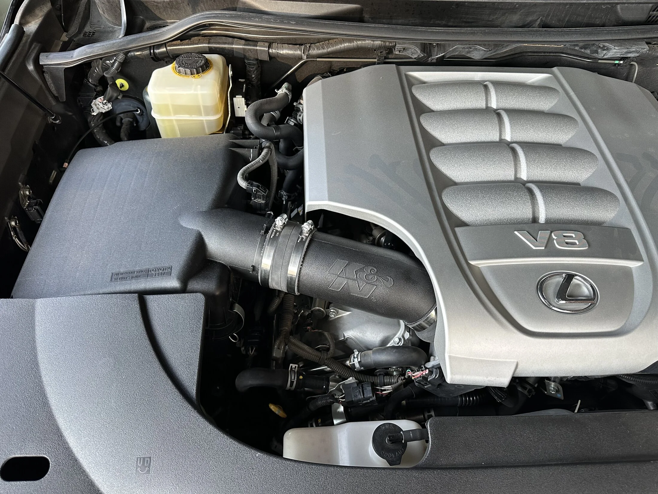

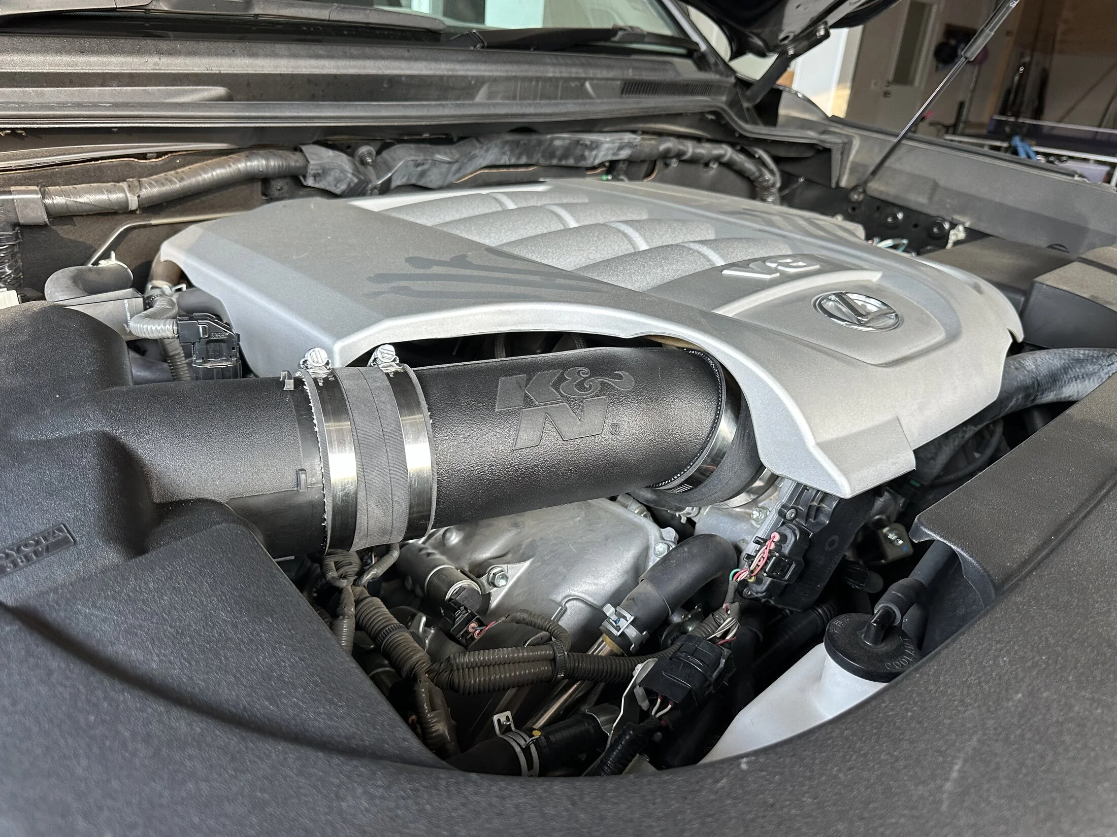

Can confirm this has been installed, a few notes:
- There is a little bit more growl, not OTT at all, very subtle from the 2m drive I had.
- The pipe is pretty tight fitting, had to adjust the clamp positions a few times to get it right.
Overall, pretty happy so far, and will report back after some more driving. I would say this has scratched the itch i had for an exhaust, as its much more subtle, and only sounds different under medium / hard acceleration. But again, its very subtle.

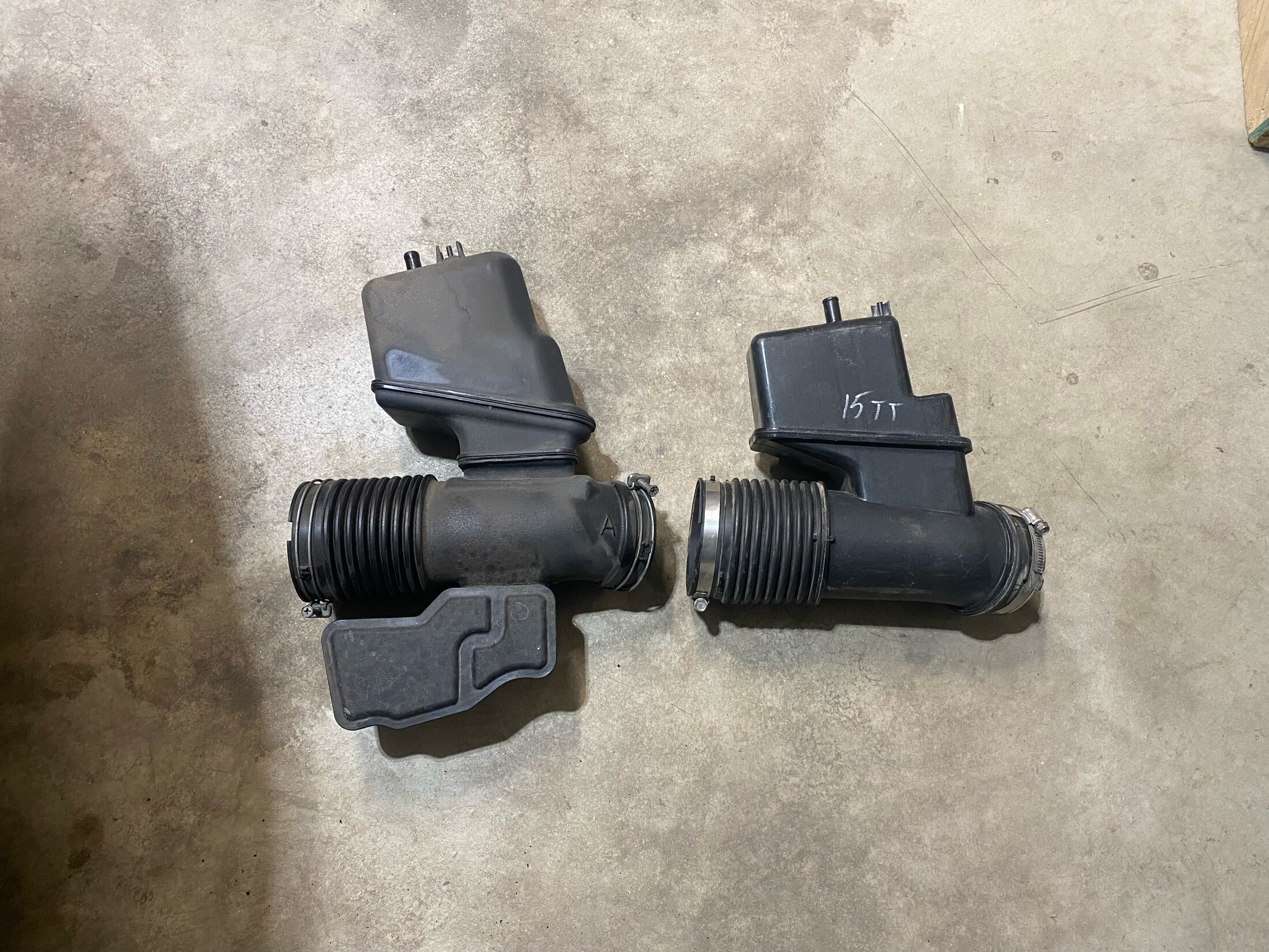

The intake tube from 2nd Gen Tundra is another option here. It has one resonator and a smooth transition through the tube. The 200 Series tube interior is not smooth where the resonators connect. @TeCKis300 the resonator will have an easier and cleaner removal if you choose that route.

Here are some photos. Looks clean and stock:

This inspired me to try a tundra intake tube. Found one for only $45 on ebay so figured why not. I was initially planning on cutting off the resonator but decided to try it as is first. 100% bolt on including the hoses. Very subtle but noticeable sound change. Where the LX would "wheeze" before being revved it now has a slightly growlier/throatier sound. I like it and I'd like a little more of it haha

Awesome! Now I gotta try. I believe part# 17880-0S010 .
Do it, very worth it! (especially at the price point I found it for) And yes that's the part # I got. It was advertised as the intake tube for the 4.6L tundras which may have been why it was so cheap. The others were around $100 or so. But the part number was the same.
No regrets on my highway commute this morning either, most of which is uphill.
Yes. Looks like the same part number for all Tundra 4.6L/5.7L and Sequoias. These can be had new for $100 on discount for Yota. I found one for $55, but looks like there's examples over $100 used, so for the next guy, don't overpay.
