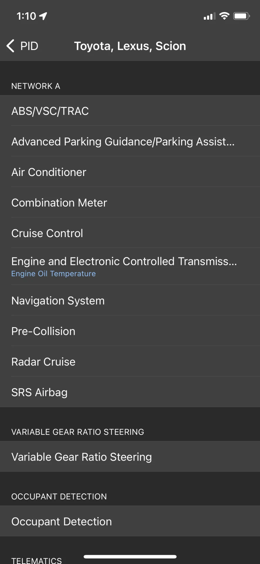

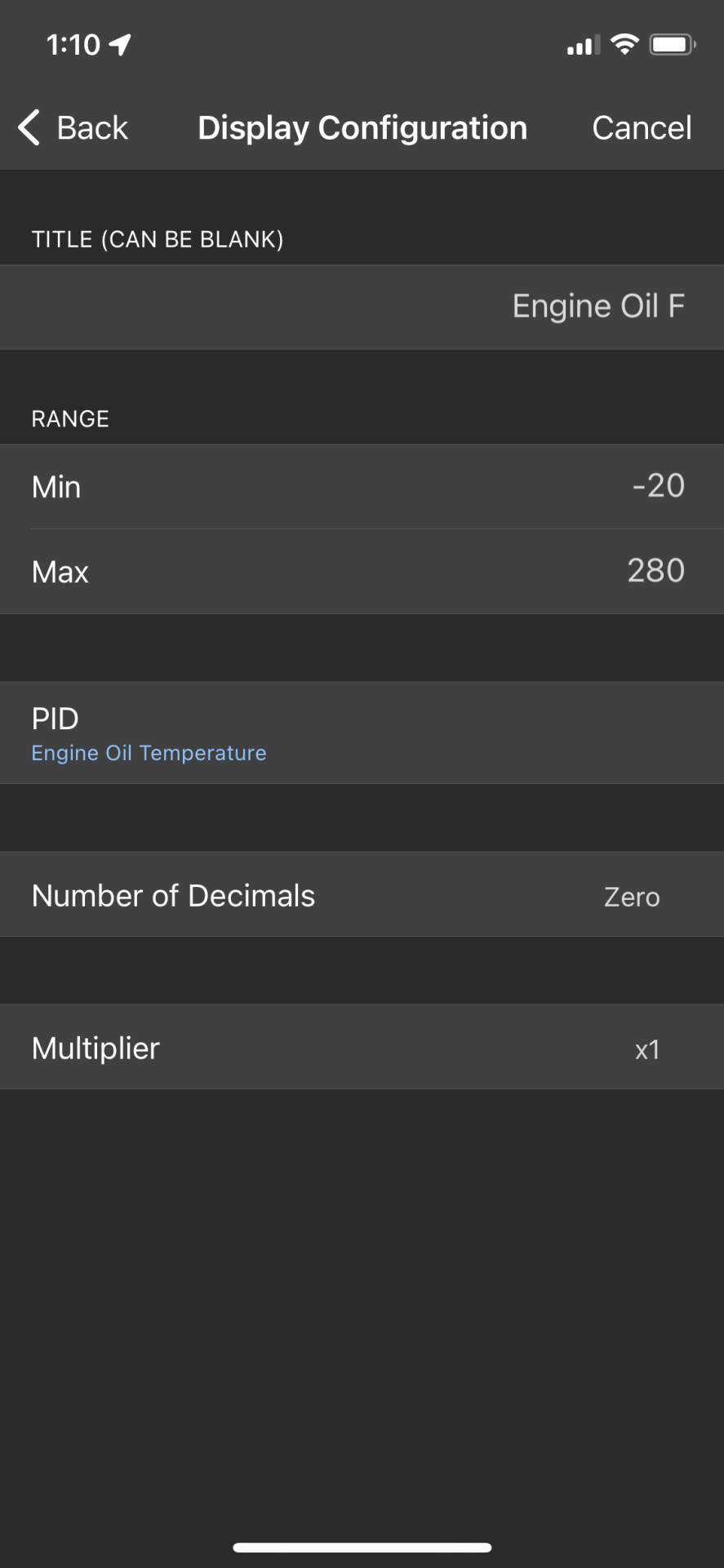

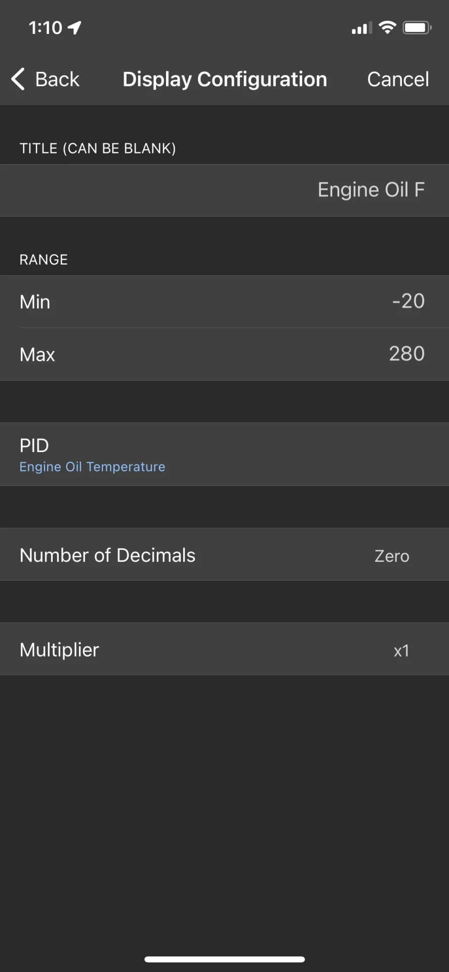

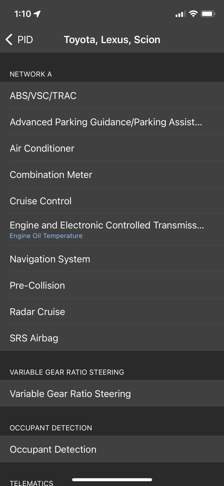

I did this and couldn’t locate one. I checked all sections under the Toyota advanced pack.
If you bought the Toyota PID pack for $10 it should be there. This is where mine is. You may need to rescan all of the PIDs while in Park if it’s not showing up… it’s possible it’s hidden as OBD Fusion might not think it applies by default or that PID might have been added later
I’ll try rescanning.
I haven't figured out how to rescan a module yet, other than maybe dumping the app and deleting all data then reinstalling. But I definitely was able to add the oil temp pid when I was first building that dashboard, it just didn't work. Now I can’t seem to get the app to even show the PID again.

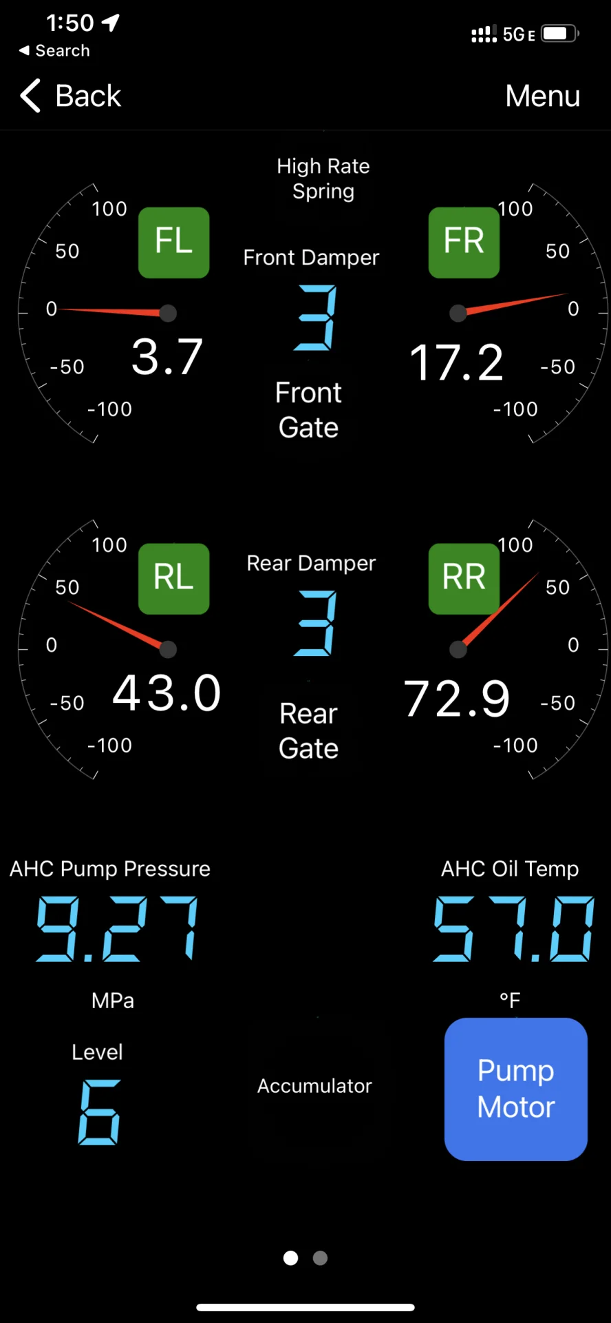

So I spent some more time on this for my fellow LX AHC brothers out there. Also took this opportunity to test out building an (on/off) type light that @grinchy was requesting.
Here’s a new dashboard for monitoring AHC activity. It shows the following:
Height at each corner
Status of front and rear gate valves (open/closed)
Status of each corner height control valve (open/closed)
AHC Pump Pressure
AHC Oil Temp
Height Control Level
Status of 5th Accumulator valve (open/close)
Status of pump motor (on/off)
Status of front high rate spring (engaged/disengaged)
Status of variable damping control (1-16 steps)
To use this dashboard you must have the advanced Toyota pack and in “settings->Vehicle Editor->Advanced Network” you must select “Network E”. You can also set this value to “prompt” at connection if you think you will use it a lot, then when you connect to vehicle, it will ask if you want Generic OBD or Network E.
Since you have to connect to the different network, you won’t be able to use the standard dashboards at same time. You will have to disconnect from dongle and reconnect on different module to go back to the other dashboard. The biggest downside to this is it scans a bunch of modules at load up each time, so it’s not as fast at connecting as it is for Generic OBD.
Here's a screenshot. The green boxes are the identifiers that the height control valves are open. This is a snap from going from N to H, so you can see all valves are open while it raising. You can see pump pressure and that the pump motor is on. The "level" box is a numeric representation of which height mode the truck is in. I haven't figured them all out yet. 0 = Normal, 6 = High, 4 = Normal 2 (>62mph). I'll work on figuring out the rest.

The trick I used for this was to use a "digital gauge". Then I hide the "value" by setting the font scale and position to lowest values possible. Then use the "background" colors to set one side of your on off color (in my case, i set the off to black (or whatever matches your dashboard background), but it could be red/green. Then I used the "warning" feature and set this to "when = 1" set color to whatever you want the opposing color to be.
While staring at the dashboard on my computer monitor i realized how i could make the height control valve monitors more eye appealing... I didn't like just floating a box above the labels for the corner height sensors. It finally occurred to me to use the valve monitor as the label and remove it from the height sensor display. I updated the new dashboard and replaced the link above.

IIRC it's Settings -> Vehicle Editor, go down to the Enhanced Network section and select the network and then rescan it

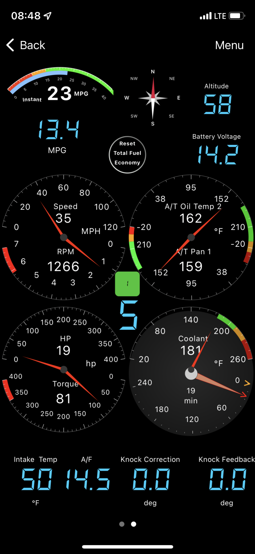

I got T/C Lockup in 5th and 6th today around 35mph. With my gears that is only 1266 rpm in 5th. Even less in 6th.
Using the ‘warning ‘ function to do lockup color.
