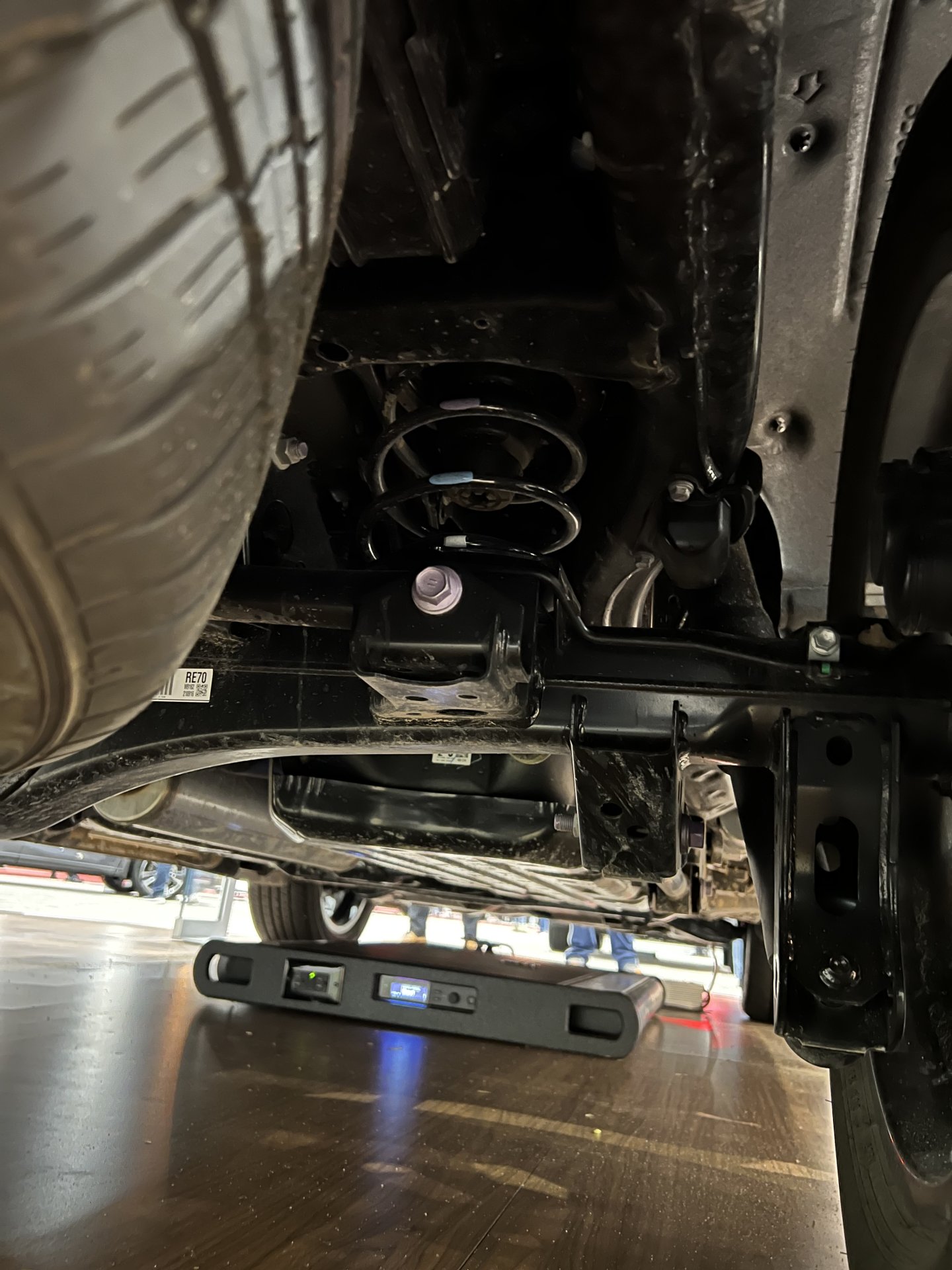

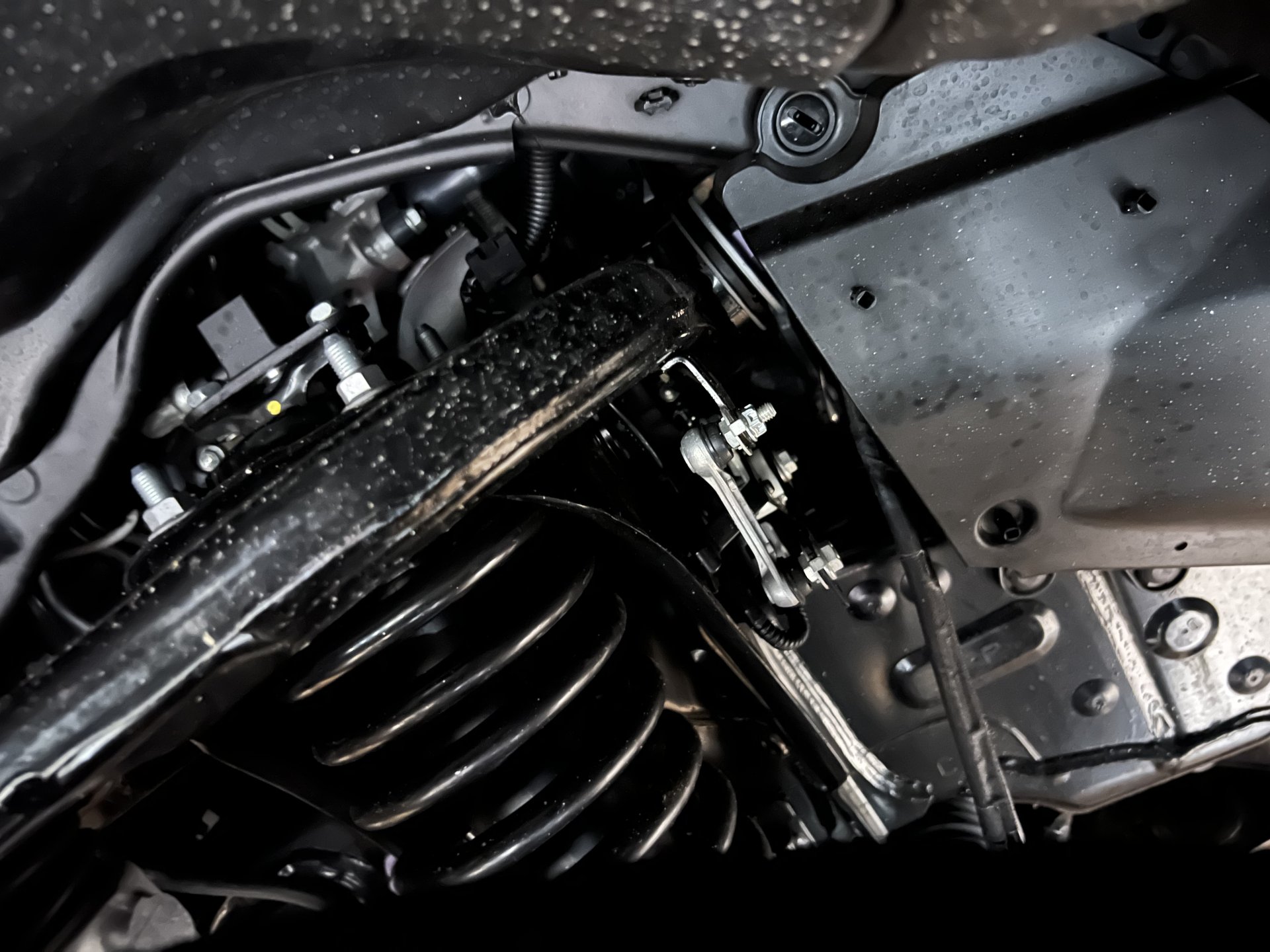

Anyone have any pics of a 16-21 with the sensor lift? Everything I’ve seen so far and read have been pre 15. Curious if there’s anything different to do on my 17 and what it’ll look like
Thanks
Thanks
It’s all the same. I snagged these pics of the 600 and it has the same sensors 😂
