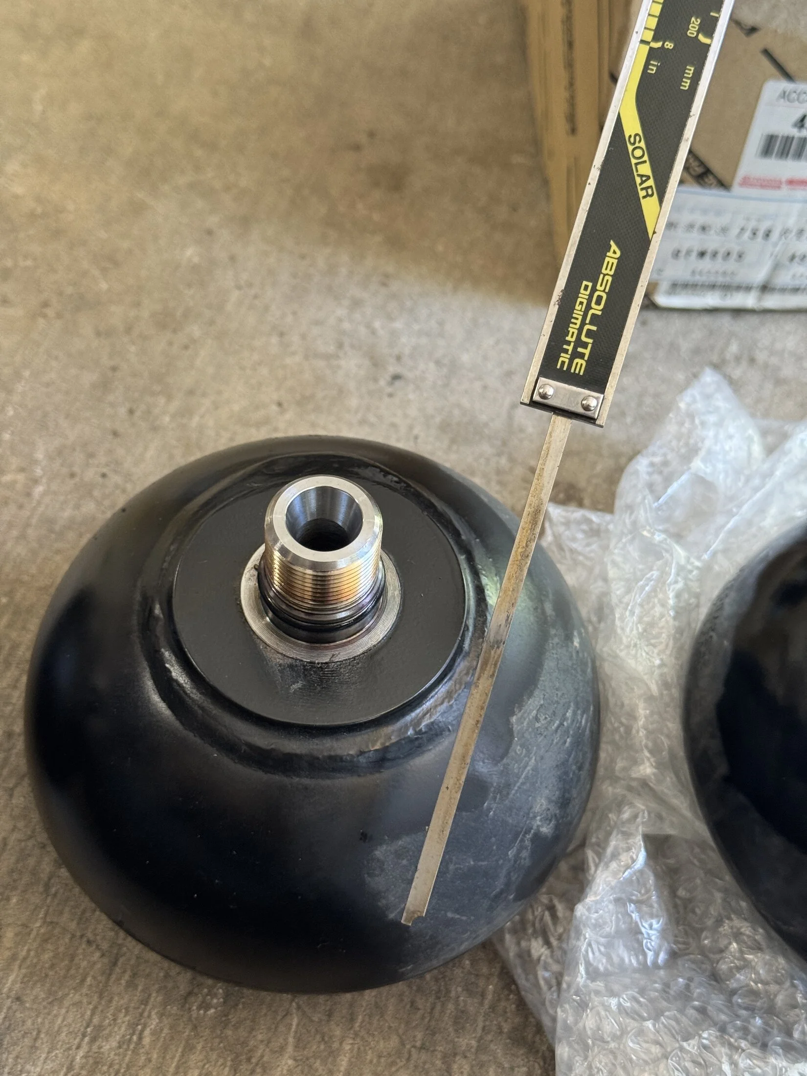

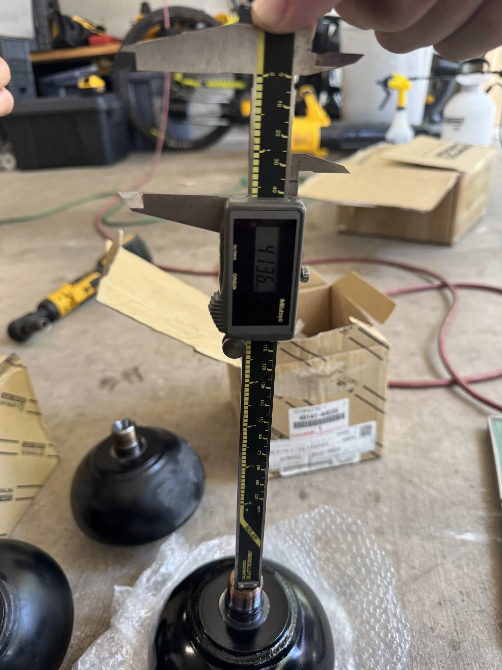

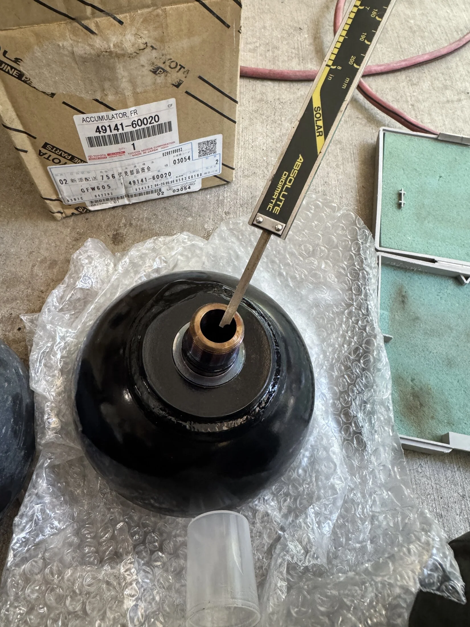

I finally got a chance to do this job, helping a friend with his 2013. Approx 140k miles. Globes had been on their radar for some time but I rode in their rig for the first time in a while and immediately noticed.. something wasn't right. So they ordered the globes and fluid and we did the job a couple days ago.

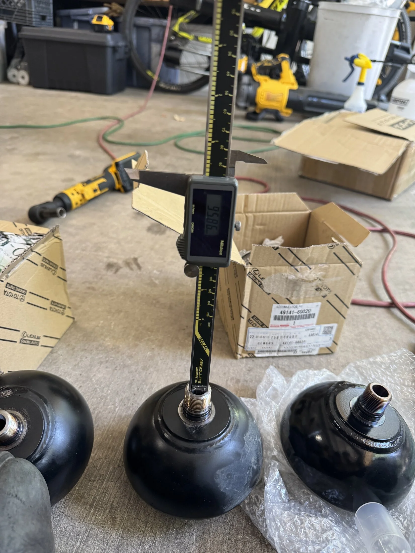

I see a lot of people initially posting an improvement of maybe 15-20%.. in this case.. 200%. I read earlier in the thread there shouldn't be much fluid in them when pressure is bled, and my understanding of how all this worked makes sense. Then we pulled the first unit, and a lot of fluid came out. Like nearly the entire outside volume dumped into the fluid pan. Hrm.. So I look inside and there is a metal support washer inside, that appears to be clear across the globe, against the raised hex. I grab one of the new ones and the same washer is just below the inlet hole.
Here are the numbers.
New globe
Original globes.. the diaphragm is a full 2" further down than new
Now them losing some nitrogen makes sense, but this seemed excessive. The rig hasn't been abused.. was a DFW soccermom-mobile for about 110k miles, then my friend got it, we did a fluid exchange, and they haven't been hard on it at all. So I'm wondering.. mechanical failure?

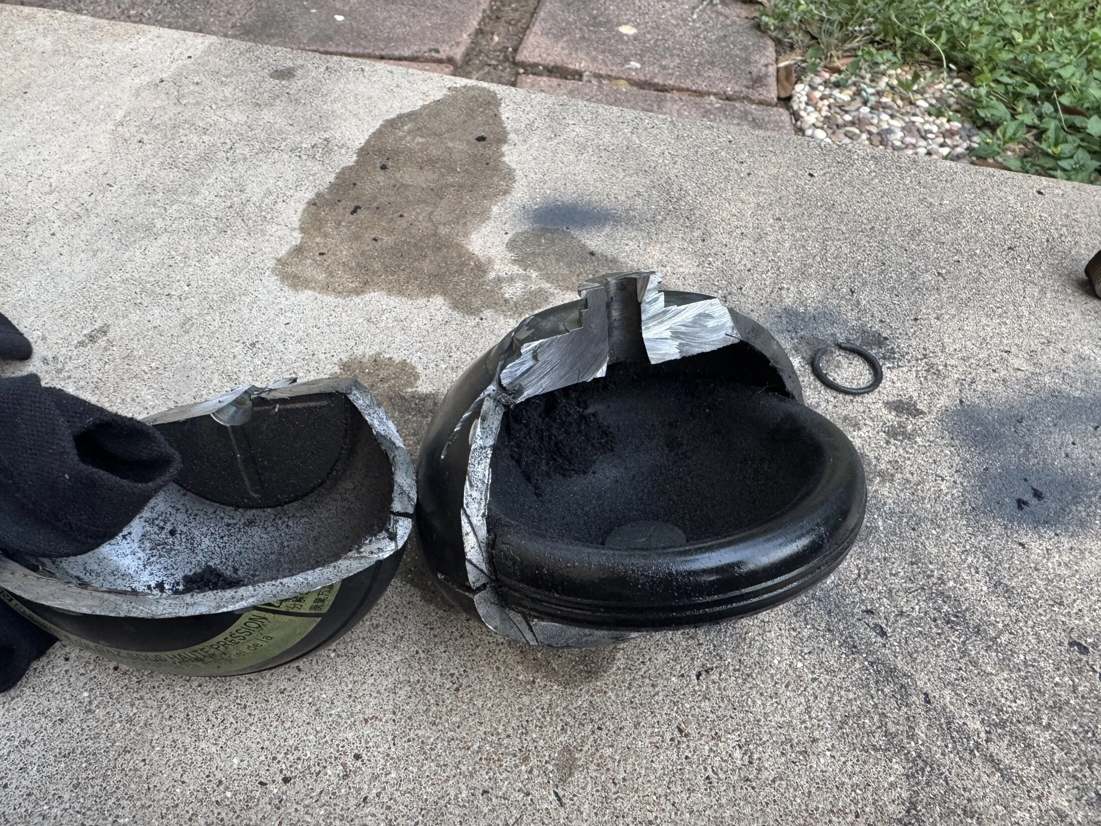

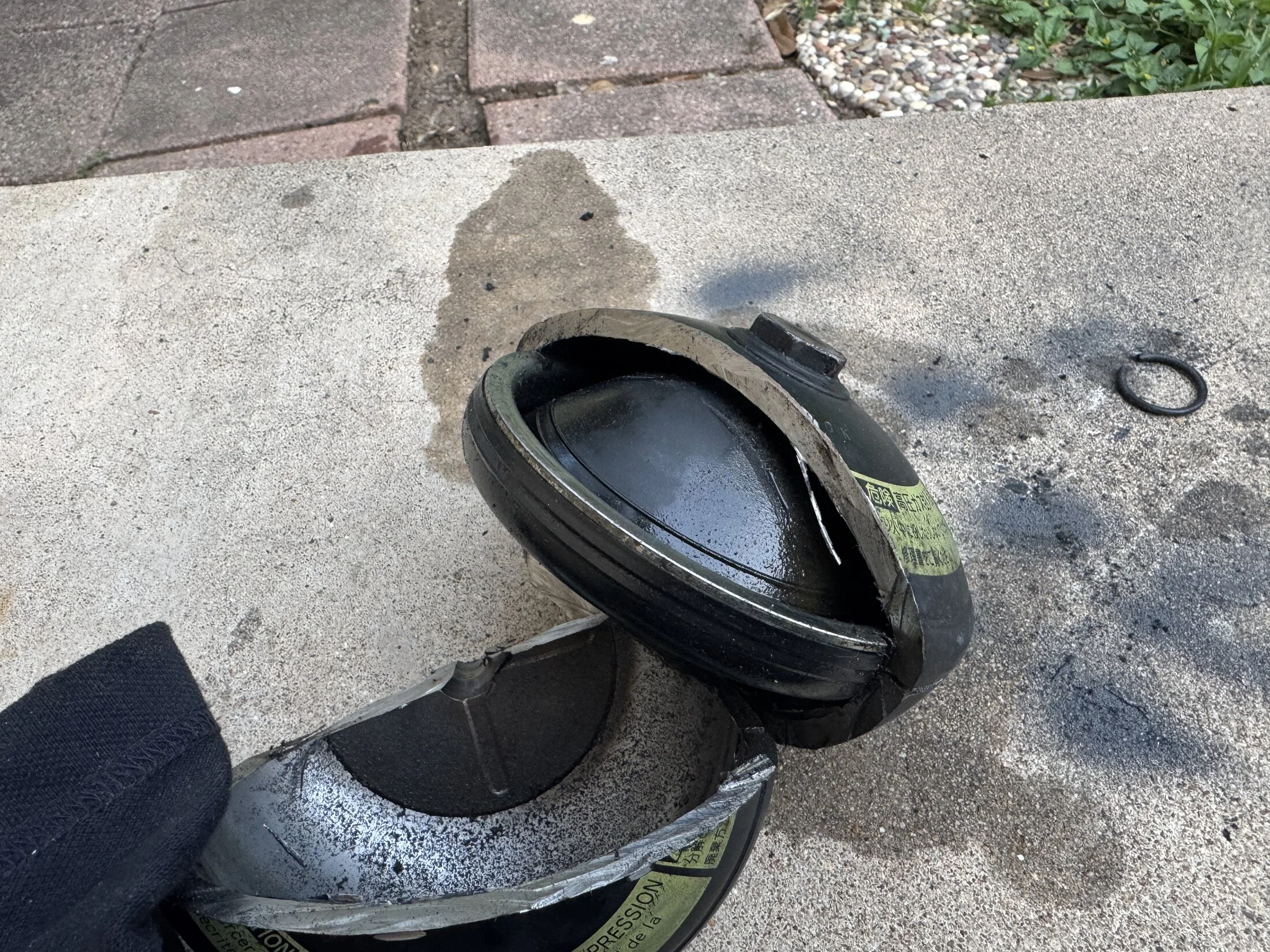

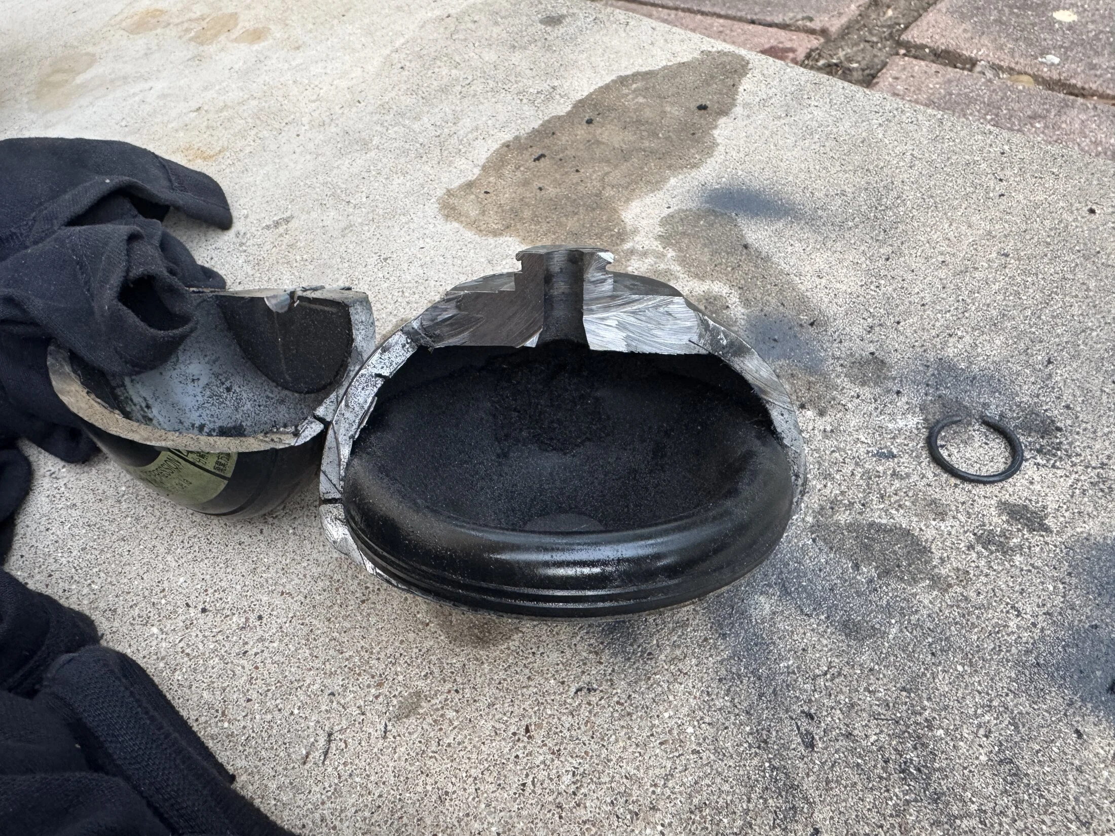

So I cut one of them up...
The black powdery stuff is from the cutting wheel. Otherwise it just looks like an intact diaphragm that was designed to rest downward, which I'm sure it wasn't. If I push the rubber back up to position it retracts down again. I guess sitting with the weight of a LX on it without enough nitrogen below is a hard life.
I plan to finish cutting the retaining ring and pull the diaphragm to check for cracks or other mechanical issues.
I also have two more to investigate.. I'll drill holes in the base of each to see whether there is any stored nitrogen. And I'll probably cut up the good one too to see if it was on its way out.
Will post what I find.

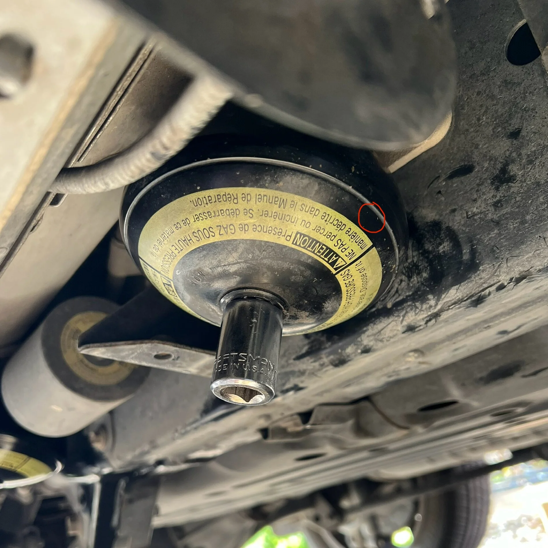

Another option is to put a 3/8-1/2” hole in the red circle and use a flat end punch and hammer in a counterclockwise direction to knock it loose. This is what I had to do to remove the accumulator stuck onto the KDSS valve I dissected that was riddled with cancer.
This thread and suggestion was a life saver, thank you. Thank you. Thank you.
You're welcome. If you know of other tricks post them.. all of this stuff eventually helps someone somewhere.
New globe

Yeah I could best describe this as riding on the bump stops of opposite-corner suspension. It wasn't just hitting the bumps.. it was pitching around as a result.
With some of the globes so collapsed that's pretty much what was happening at the end of the day.
