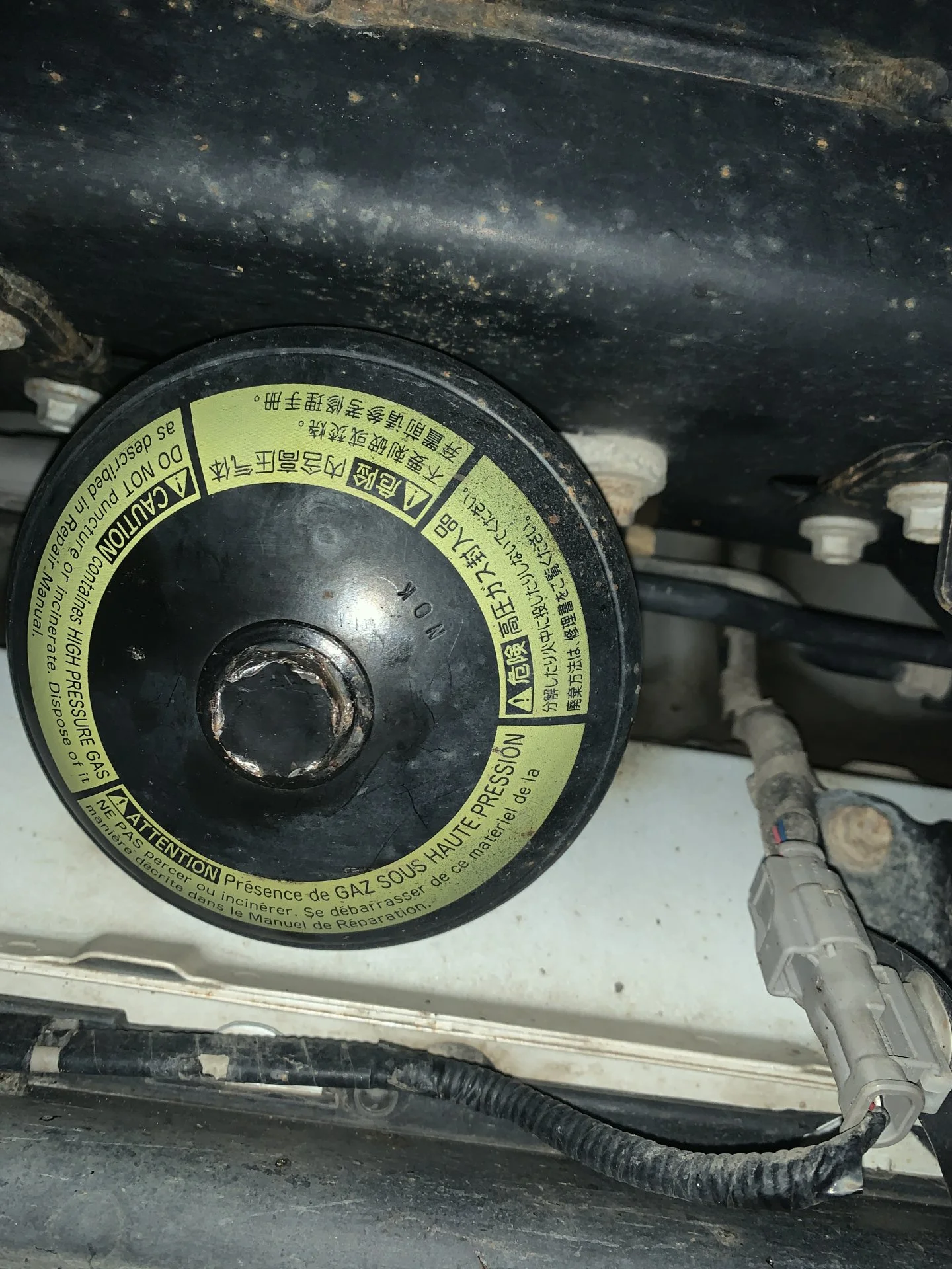

Well I'm in a bit of a pickle...
Started the accumulator replacement project on my LX, and have been unable to remove the DF accumulator. The bolt keeps wanting to round out (pic attached). I've tried just about everything - breaker bar, impact gun, torque wrench, vise grips. Each time the bolt seems to want to give way, but no movement from the accumulator. I've ordered a bolt extractor socket, and am waiting for that to come in. Has anyone else had this much trouble? I tried locating a socket with non-tapered corners but had no luck.
On a side note, is there any issue in attempting to move on to the other globes before getting the DF off? Obviously from a bleeding standpoint, you want to go DF, DR, PF, PR.
View attachment 3074048View attachment 3074049
This happened to me and I eventually ended up drilling a hole in the shell and jamming a pry bar in. You’ll be puncturing the nitrogen membrane so drill slowly.
I'm glad you mentioned this. I have one globe that the bolt head broke clean off the globe. I've been hesitant to drill it because I wasn't sure with the nitrogen if something would go "boom" or what would happen. 🤷‍♂️ !
No boom in my case but it did hiss for a surprisingly long time.

Well I was able to get that first one off with a bolt extractor. The next two were easy with a standard breaker bar. But on the 4th one (PR), i managed to round it out again. The bolt extractor was unsuccessful on this one for some reason. No luck yet.
I might have someone weld. a new bolt on to the end and give it another go.
I don't believe there is enough room for a strap wrench. That accumulator is tucked up high enough that its hard to get ahold of the sides with anything more than your hand.
If you have an impact tool that really helps.
You use run of the mill sockets? Not to be a tool elitist, but sometimes a good socket makes all the difference
Yeah, I like impact or 6 points for this. NOT 12 points. I rounded one and had to move to the impact socket.

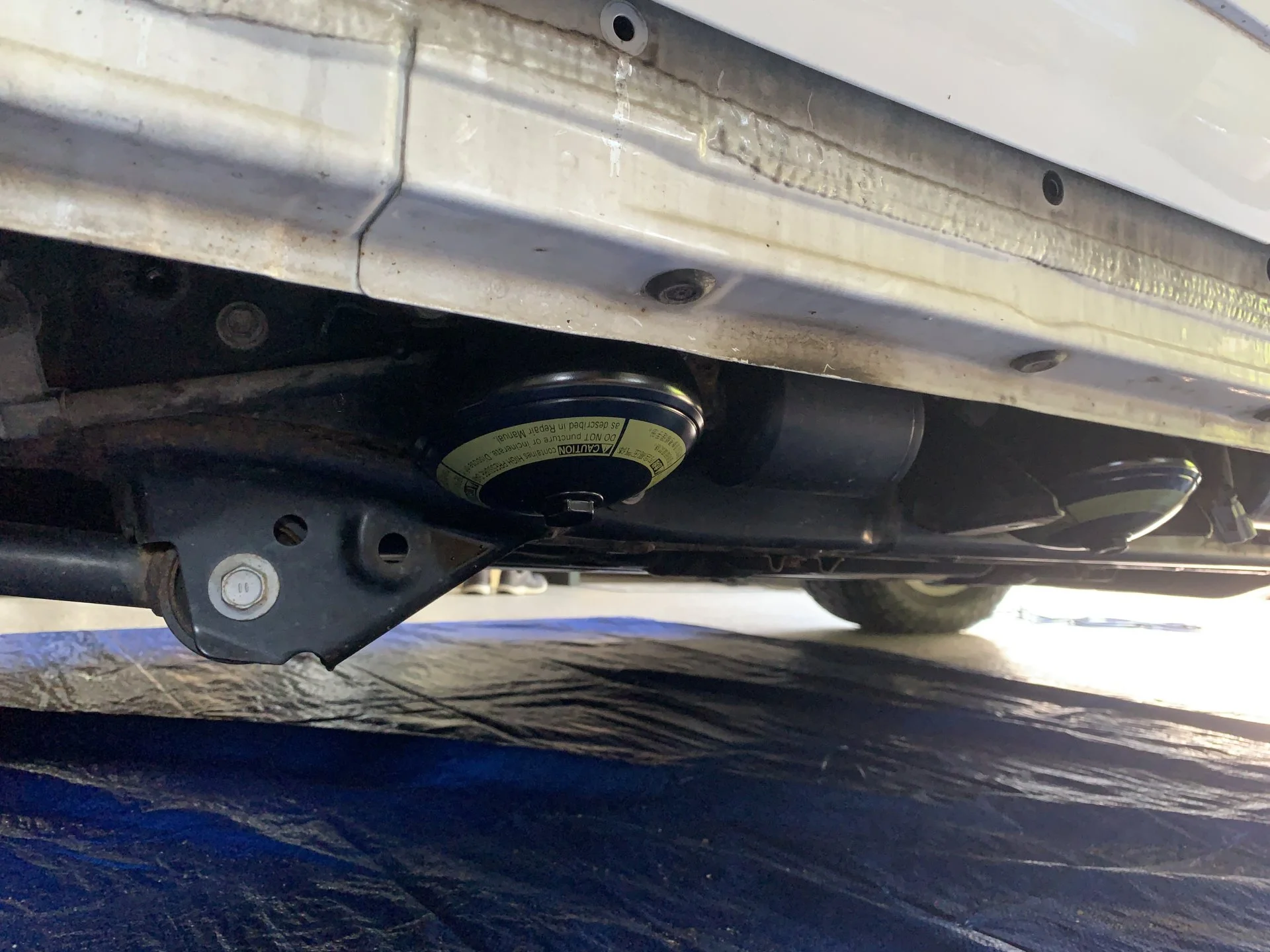

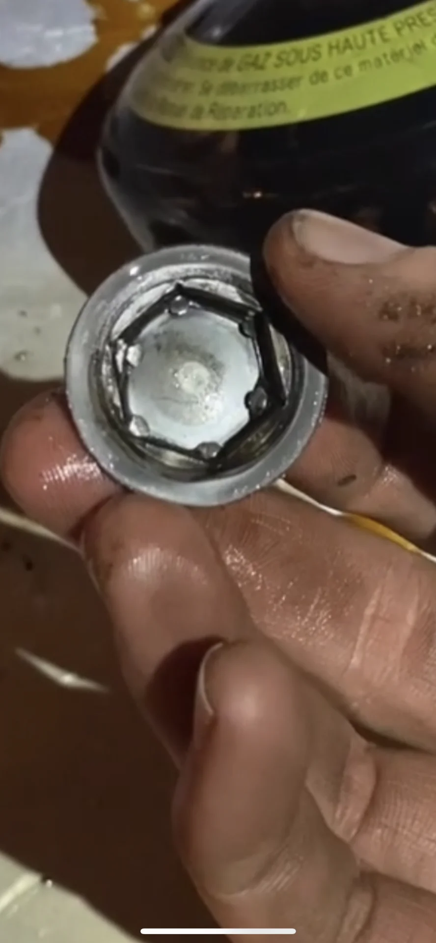

The toughest part of this project on my LX was removing 2 of the accumulators from the vehicle (Driver Front and Passenger Rear). I believe the issue with the Driver Front was me not accounting for the slight angle in which the accumulators are mounted. I went straight on and rounded the bolt using a 6 point socket and breaker bar. I ended up buying an extractor bolt (21mm) which was able to break that sucker loose.
The next two (Driver Rear and Passenger Front) were super easy to remove. Then on the last one (Passenger Rear), I again had issues removing it. This time I believe the accumulator was either torqued too tight or there may have been some rust holding it in. Whatever the case was, I couldn't get it to budge. Tried everything including a breaker bar, the extractor socket, and an impact gun. Eventually, I broke the bolt clean off of the accumulator. Talk about a moment of panic.
I called a mechanic friend and we ended up having to use a strap wrench on it which finally did the job. However, it was not possible to do this without removing the running board. There simply wasn't enough room to get any leverage or to get the strap around the fattest part of the accumulator. Removing the running board gave us the space needed, and also made it so much easier to bleed that side of the vehicle.
