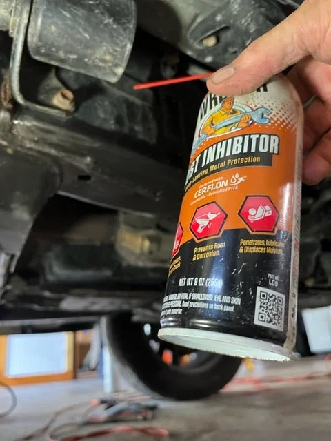

Looking to keep rust out I found after pulling off the skid guards the bolt holes go through the frame. I sprayed a can of rust inhibitor inside both sides of the frame. Besides that I sanded and repainted everything I could that had rust.

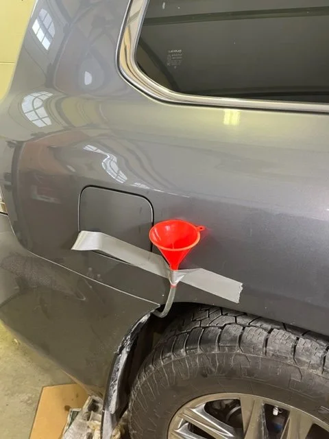

I grabbed a funnel and duct taped to the side with a clear hose to help me add the fluid to the pump reservoir. Still got some fluid on the floor :rolleyes:

I hung my funnel from the gas cap with zip times. Same idea. I am really not a fan of where Lexus elected to put the reservoir this time....

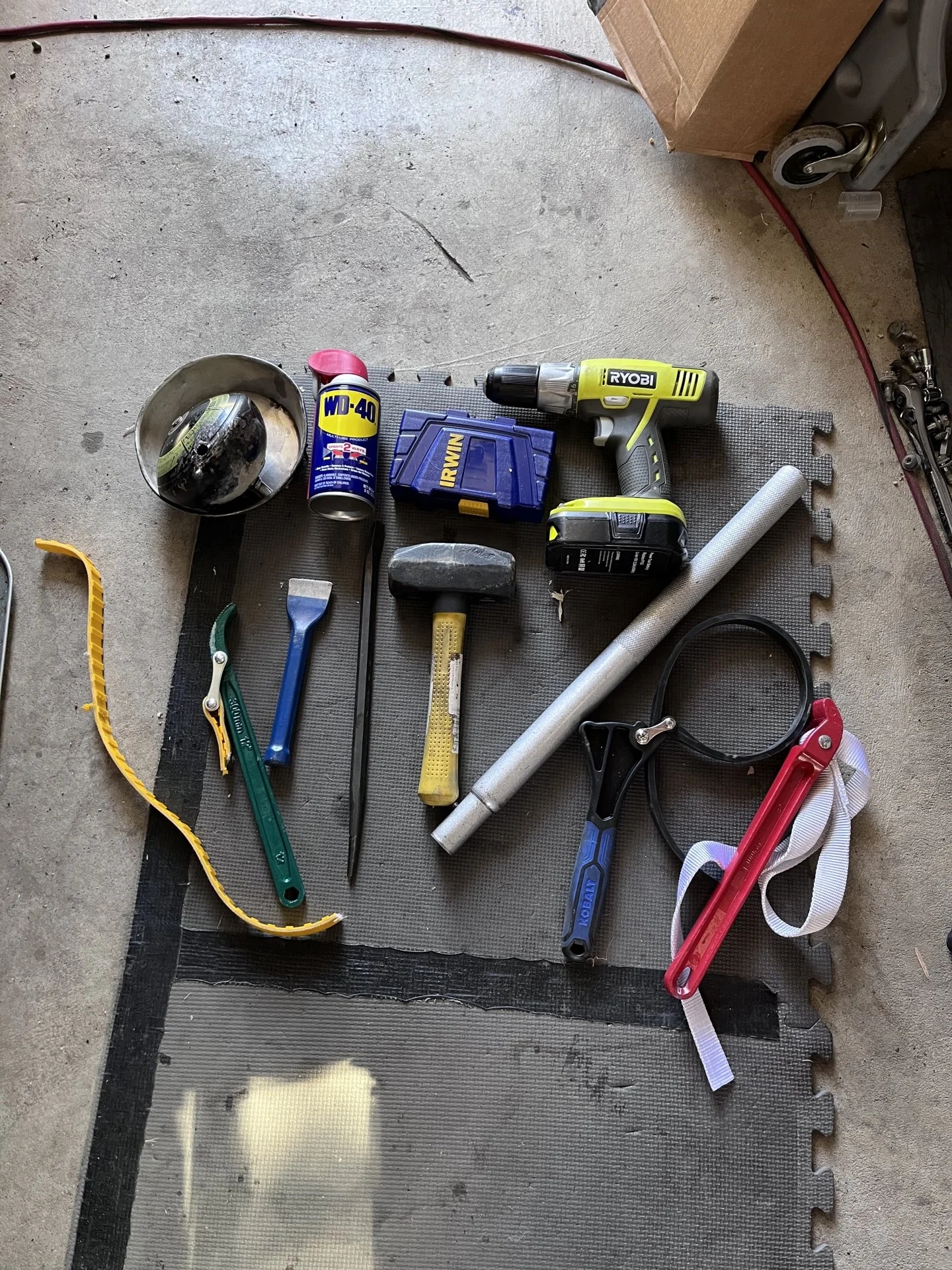

This happened to me and I eventually ended up drilling a hole in the shell and jamming a pry bar in. You’ll be puncturing the nitrogen membrane so drill slowly.

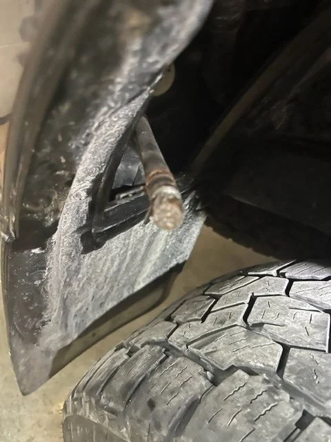

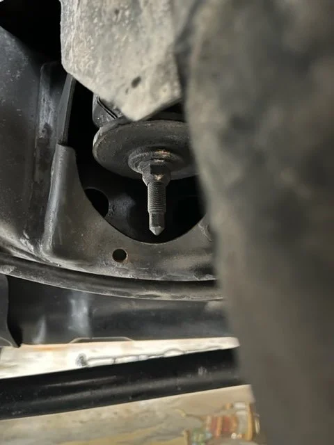

@tbisaacs i broke a head off an accumulator. FML. I tried a strap wrench but that hasn’t worked so far. When you drilled it, about how big of a drill bit did you use? Any other tips on this alternate procedure?
That sucks! I don’t remember exactly but it was big enough to get a tapered pry bar into it. I was so stressed out from trying other methods that I went full scorched earth on that sucker.
is there possibly still pressure in that accumulator ? Did you bleed it enough so it is sitting on the bumpstops? or is it just rusted?
No I was an idiot and started off by over tightening it. Forgot righty-tighty is the opposite way when the bolt is upside down. A breaker bar and too much omph caused it to break off. 🤦🏽
Well if you accidentally over tighten the accumulator and snap the bolt head off, you may need to drill it and jam a pry bar into it. I tried a variety of strap wrenches, cold chisel and hammer and eventually resorted to drilling a hole, jamming a tapered pry bar into it and that worked. Got the accumulator swapped out.
