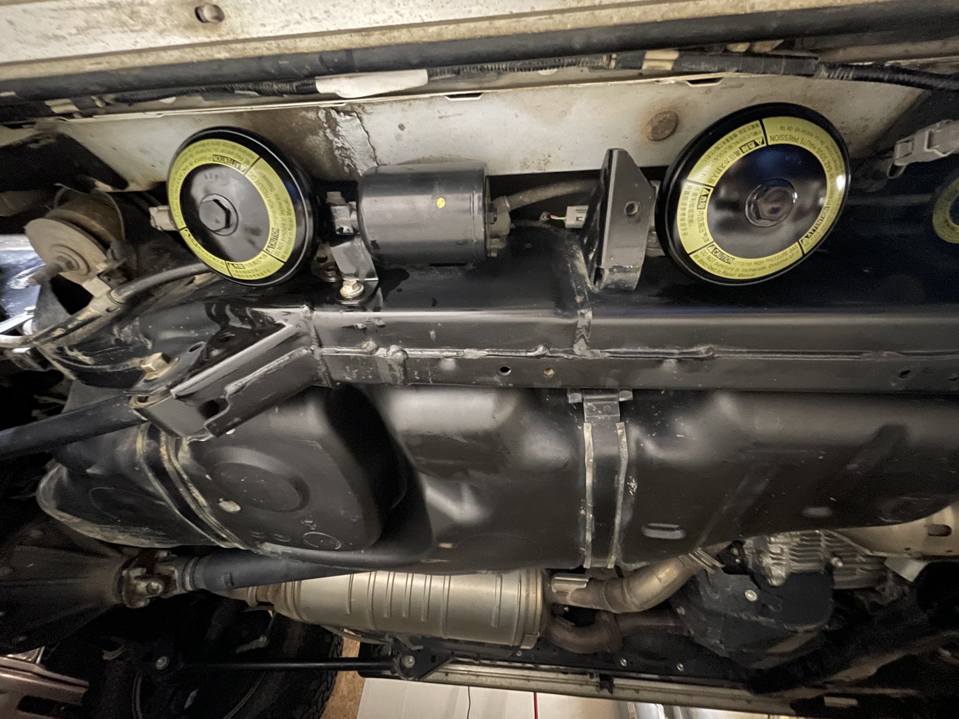

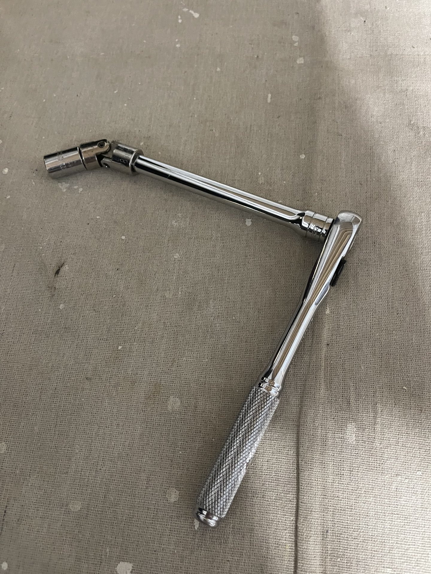

The rear guard bolt from hell
As others have mentioned, the rear bolt on the AHC guard is a royal pain. Use this wrench combo and it's pretty easy. If you brace your extension on the step mount and wrap a couple fingers over the socket from the rear it will give you the support you need to get these out easily. When it comes time to re-install, I suggest a small a mount of wd-40 on the threads so you can spin them back in w/o much resistance. Any resistance can bind the extension because of the odd angle. I realize these instructions will only make sense if you get under there and try it yourself.

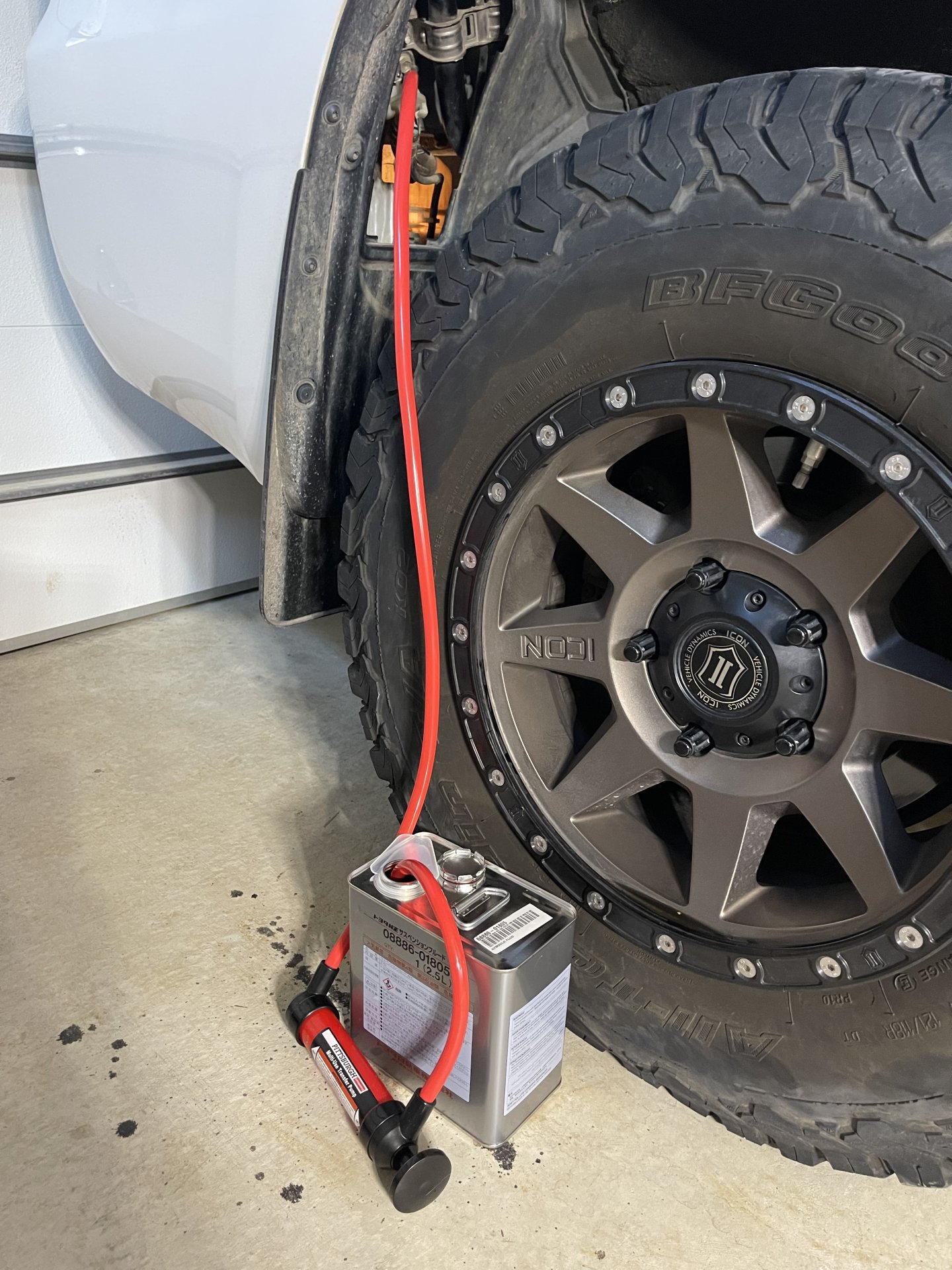

Buy the fluid transfer pump (Thanks @tbisaacs!)
While I was still able to make a pretty spectacular mess with the AHC fluid, it was nothing like the last time I bled the system. I will never do this job again without the $8 fluid transfer pump from harbor freight. Not to mention, it includes tubes sizes that work great for the AHC bleeding...bonus!

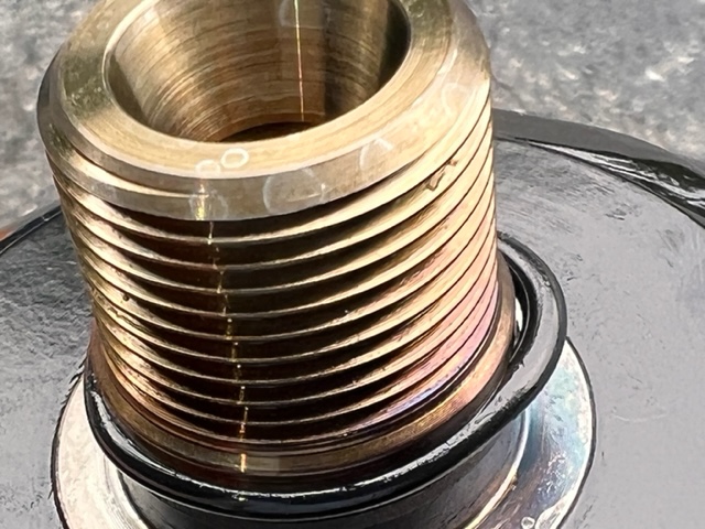

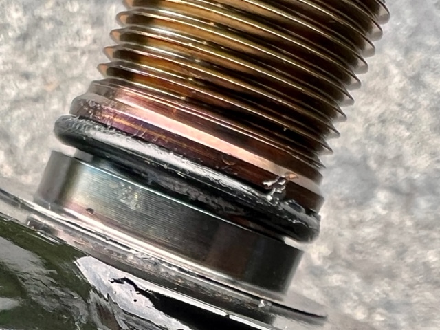

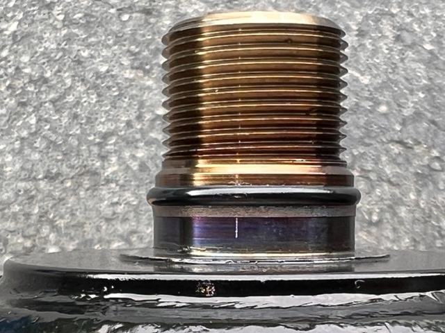

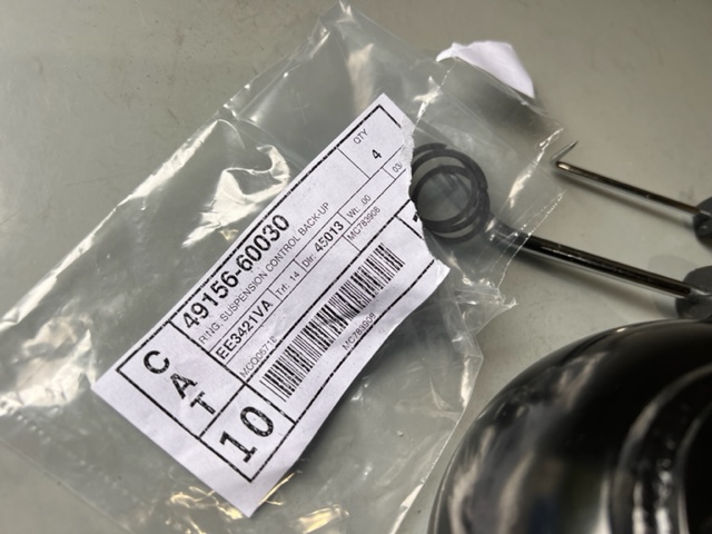

Just wanted to add something.
When replacing globes, please purchase a set of bottom washer and install them accordingly.
Without the bottom washer (see the gap below the rubber gasket)
With Toyota gasket - the rubber ring is now filmily seated and doesn't move around or shows any visible gap.
Part# is shown on the pic:
Also, after installation of bottom split gasket, please please seat it correctly and not like shown on the pic.
All you have to do is move around your fingers until it is fully seated.... very important.
Don't just assume it's installed correctly and move on.
Check and check again before installing your globe.

This detail may have been buried. It's not clear that a backup washer is necessary any longer with more recently manufactured globes. This was my finding:
- Backup washer not needed. My original 2009 globes had them. Difference is that the rubber o-ring seat/channel on the original globes were much wider - hence the need for a backup "spacer" washer. The new globes have narrower o-ring channels. Old globes 4.5mm channel, with 1.4mm backup "spacer" washer. New globes 3.2mm channel.

Yes, I read mixed review from both sides.
It seems like no one experienced any leakage because of missing split bottom washer or addition of that same washer.
It feels like the washer made the o ring more tightly seated but who knows the actual benefit. 🙄
While adding fresh AHC fluid, I used the clear funnel w/ built in strainer to filter out any possible contamination of AHC fluid.
Worked great but that harbor freight pump was even easier to use.
