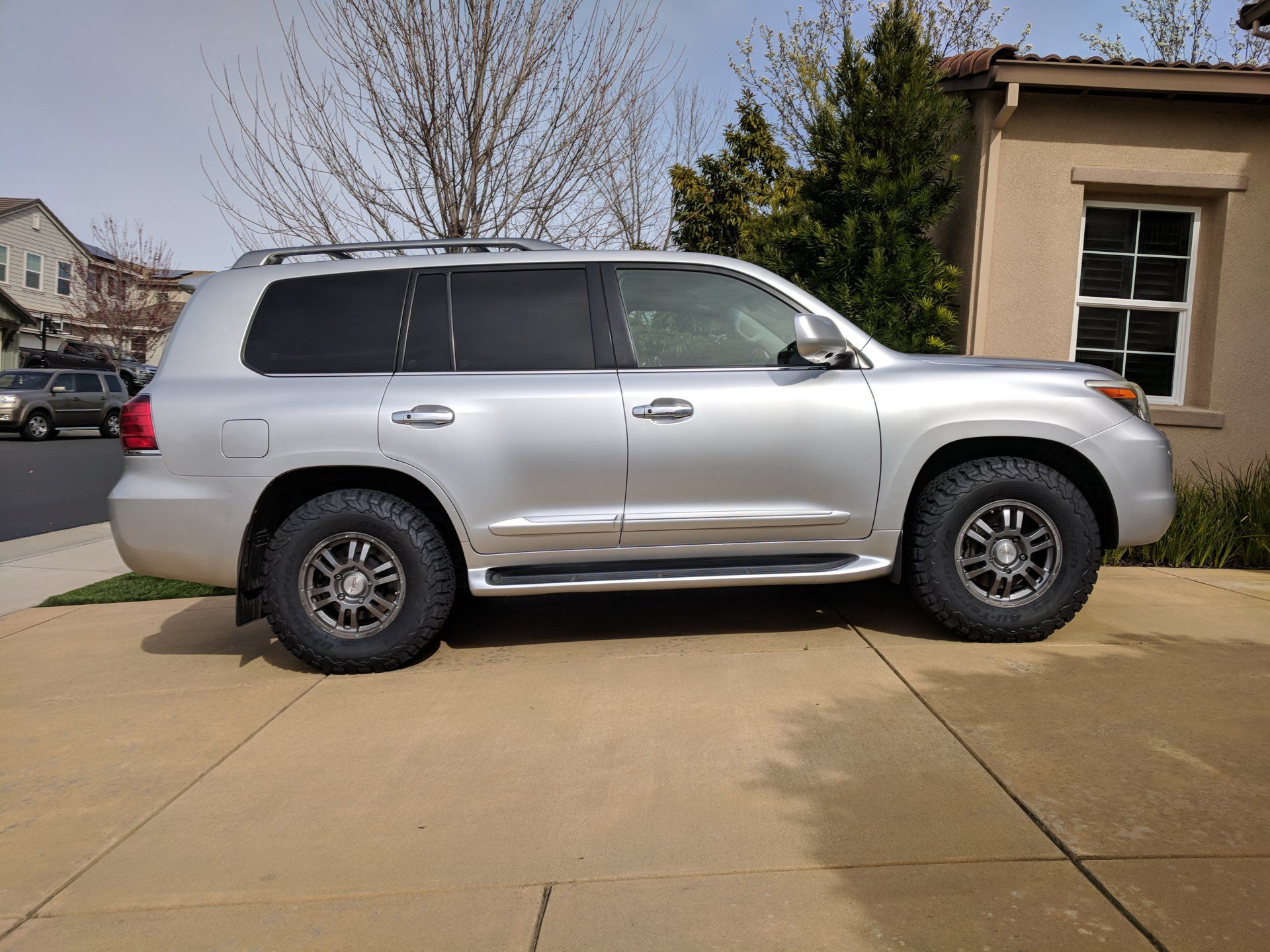

Adjusted the front sensors this weekend while replacing the rotors and pads. Followed the instructions listed out by @DeckerT4R and @tbisaacs. Put the vehicle in high, turned off the AHC, turned off the vehicle, 10mm wrench, moved the sensor to the bottom of the bracket on each side, turned the vehicle back on, turned AHC on, checked all the heights. Everything worked perfectly and the process couldn't have been easier.
Measurements before (middle of hub to fender):
Front Driver: 19.5
Front Passenger: 19.5
Rear D: 20.5
Rear P: 20.5
After:
FD: 20.5
FP: 20.5
RD: 20.5
RP: 20.5
Might adjust the rear sensors in the future but as of now I'm ecstatic with the way it looks and drives. Alignment upcoming to see if the lift put it out of spec.

Looks great! I need to do this to mine. Is the static neutral height now the same as it was before in high mode? Does it drive any differently?
High mode is still is a couple inches higher. I'll grab the measurements and post them for reference. Haven't noticed any change in the way it drives.
Measurements in high (center of hub to fender)
Front: ~22.5 inches
Rear: ~23.5 inches
High mode still lifts the vehicle 2-3 inches
