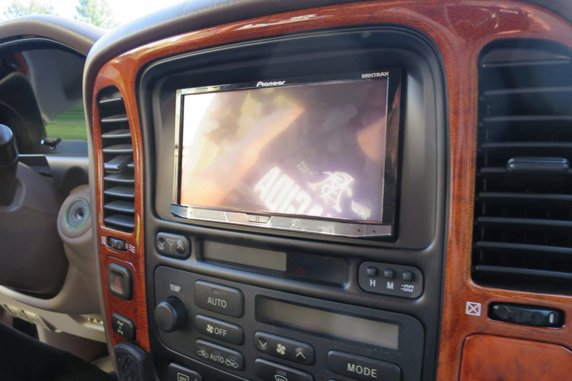

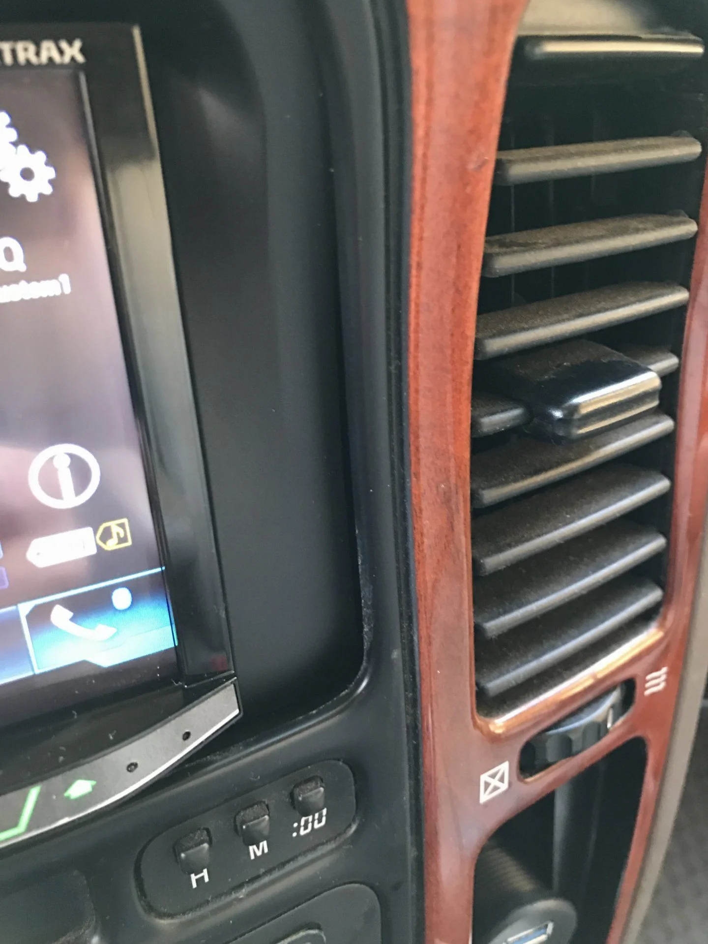

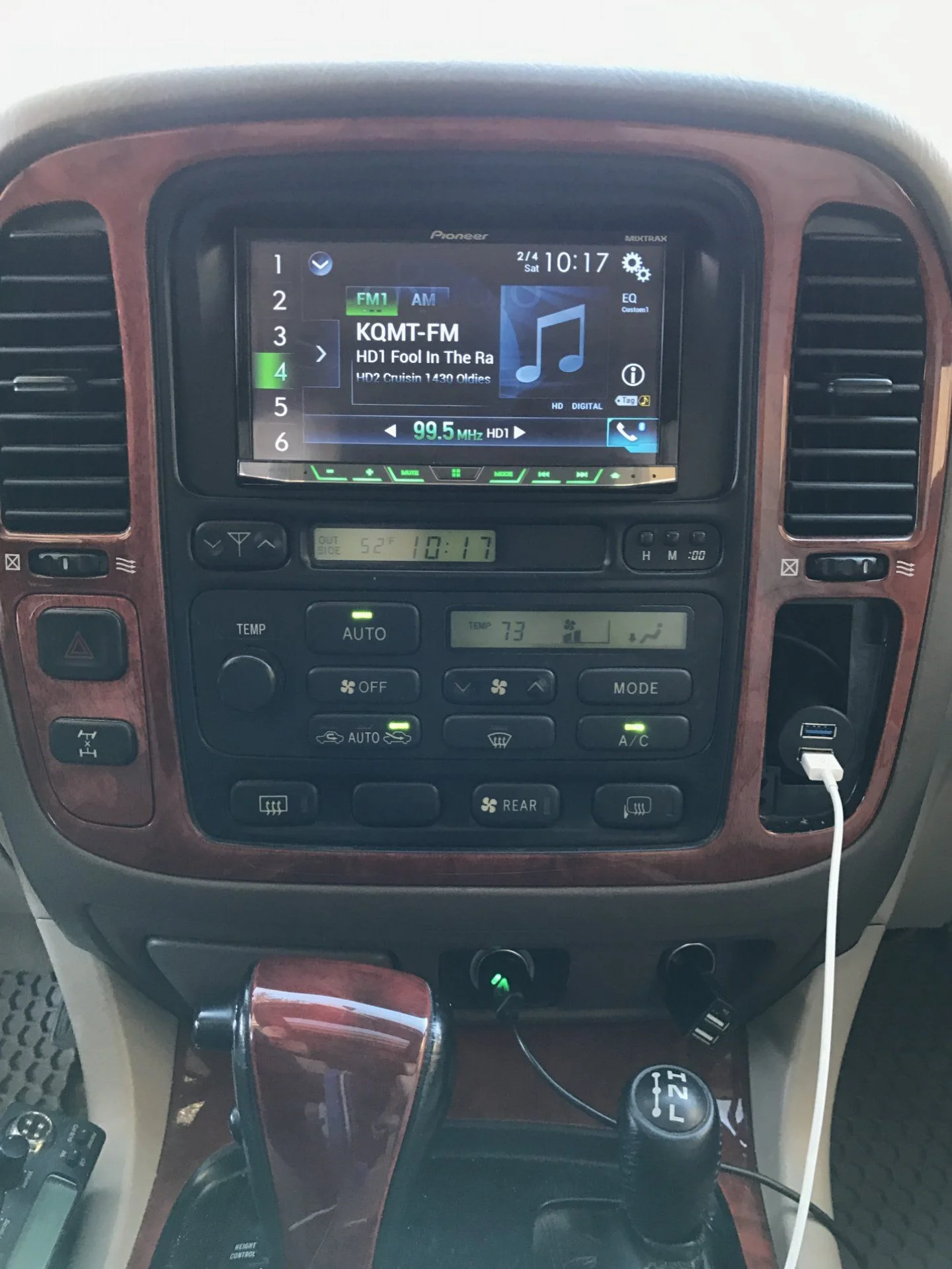

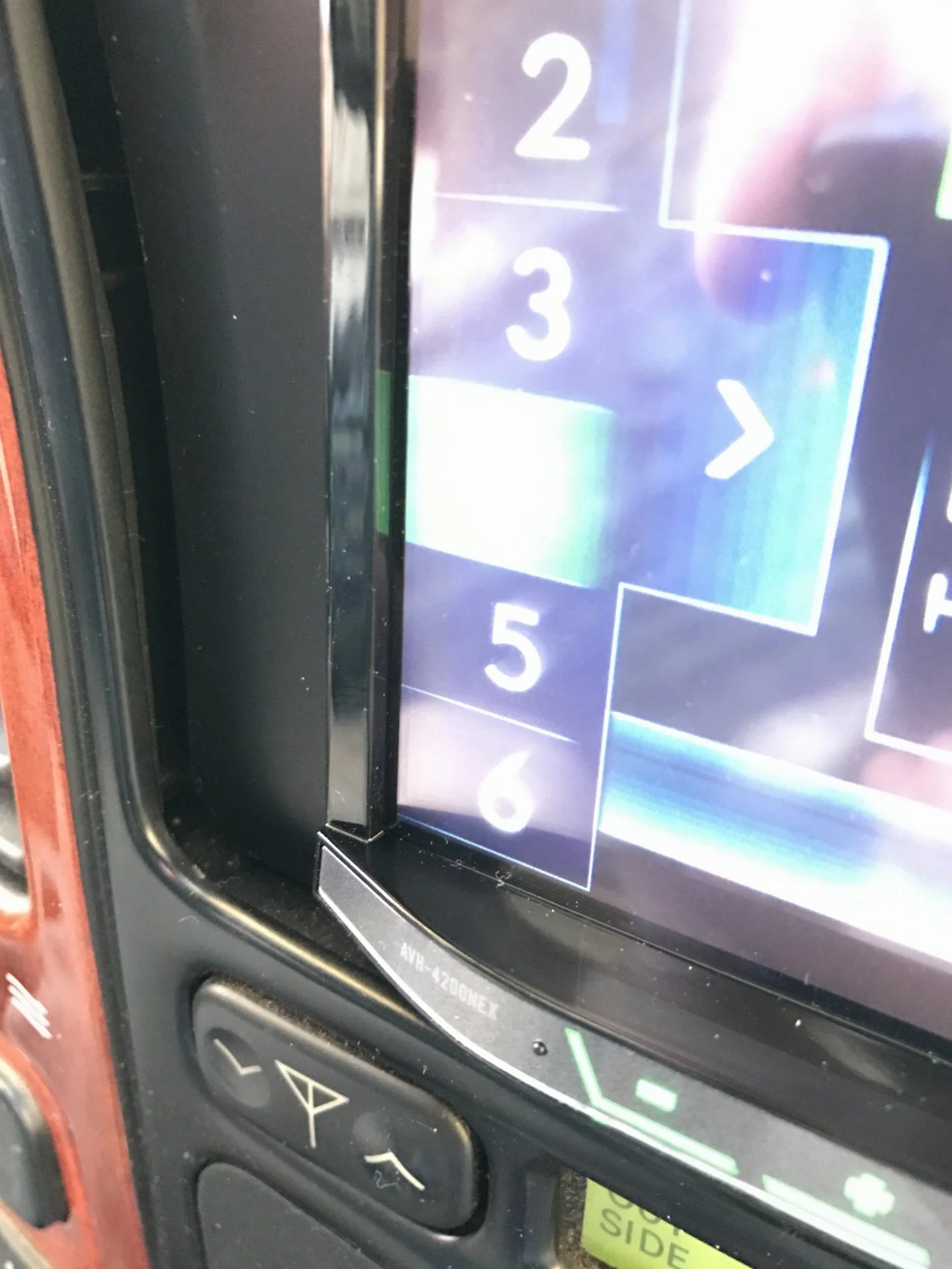

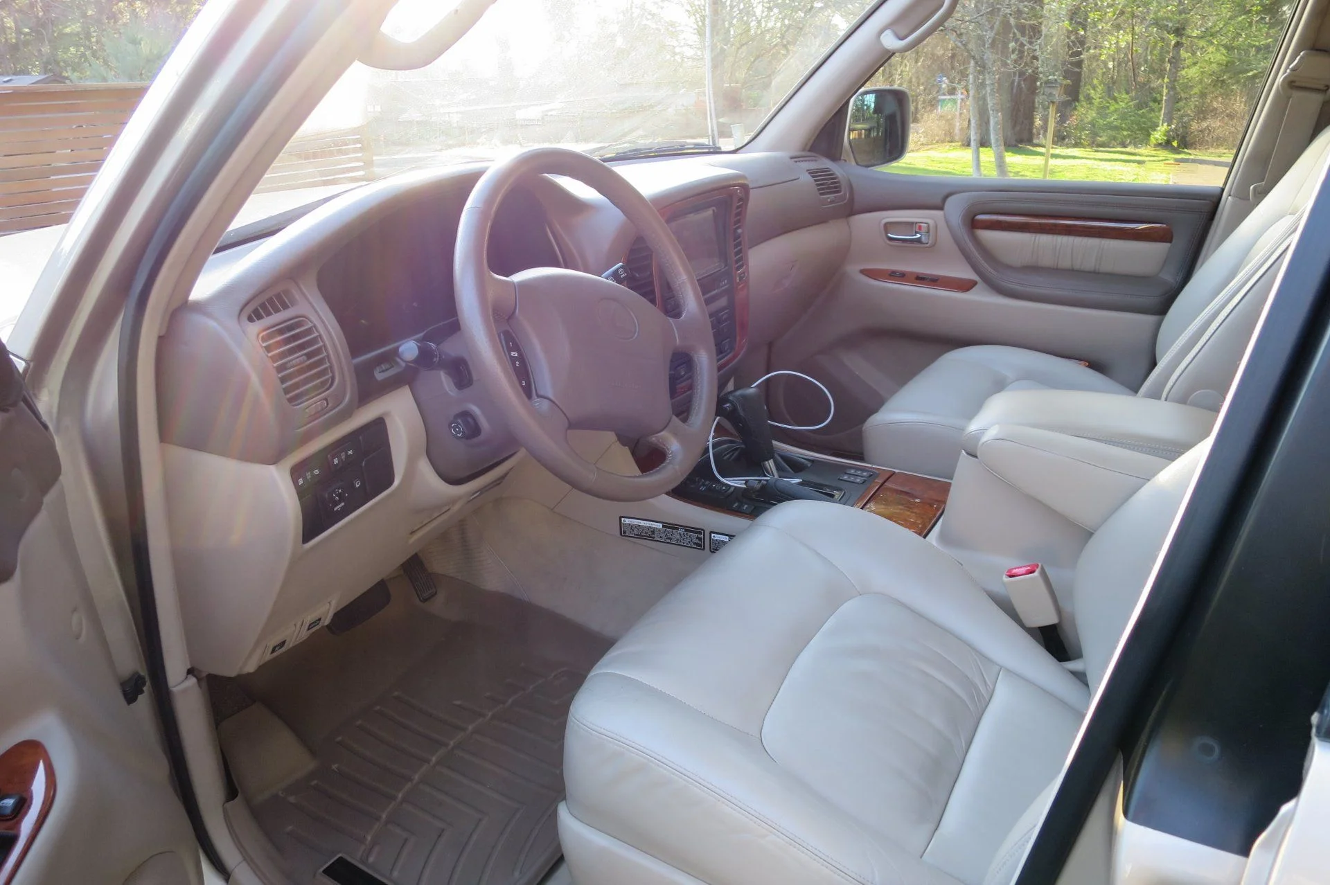

Here are some daytime pics. The trim kit is from Amazon. You can see the loose fit, as I said earlier I will correct this once I have everything buttoned up.
I need to figure out my illumination problem and connect cameras.
Trim plate
Amazon.com: DKMUS Double Din Radio DVD Stereo Frame for Lexus Lx-470 2002-2008 Toyota Lc-100 1998-2003 Dash Trim Kit Fascia Inner Size 173*98mm Black: Car Electronics

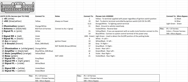

I have a 2000 LX470.
1) I don't see in the TLC FAQ what the #1 +B (white) wire on the harness is for. Anyone have an idea?
2) I also have a #12 (brown/white) wire that the TLC FAQ indicated was blank. Their are comments there stating that others also had this wire, but no reply as to what it was or what to do with it.
3) Anyone see a problem with connecting the #5 Antenna to the #10 Acc? The MicroBypass (MB) instructions advise against connecting the MB to the power antenna wire and suggest connecting it to the #10 Acc wire.
4) Also noted in the comments of the TLC FAQ was a problem with connecting the two illumination wires #4 and #13 to the same radio illumination wire (Pioneer orange/white). Console lights were ON when car lights were OFF, and then OFF when car lights were ON. Anyone else have this problem or were you OK with connecting both #4 and #13 to the same radio wire?

Great write up Sk8salomon, I just installed a pioneer x4800bt in my 99 470 along with my cobra CB, everything works great. I have seen a few questions on here about the factory connections, I kept all my stock speakers/amp and subs and it sounds really good (way better than stock) so I figure I will outline the connections as I made/understand them. I will not list speaker wires for brevity but for speakers I only had to connect the eight wires (left/right/front/back/+/-) and did nothing funny (bypass etc.) with amp or sub. I had the 22 pin connector so no available harness, soldering in the car wasn't too bad.....when you get buddies to do it, or lacking that crimp the heck out of it.
Lexus -> aftermarket deck
1) +b (constant power) -> 12v constant
2) +b2 (constant power) -> tape off/leave in plug
4) illumination -> leave in plug (my deck did not have illumination wire, some do)
5) antenna -> power antenna
10) acc + (accessory power) AND 14) amplifier -> 12v ignition power
11) ground -> ground (or actually ground it)
14) amplifier - see 10
15) mute -> leave in plug
16) beep -> leave in plug

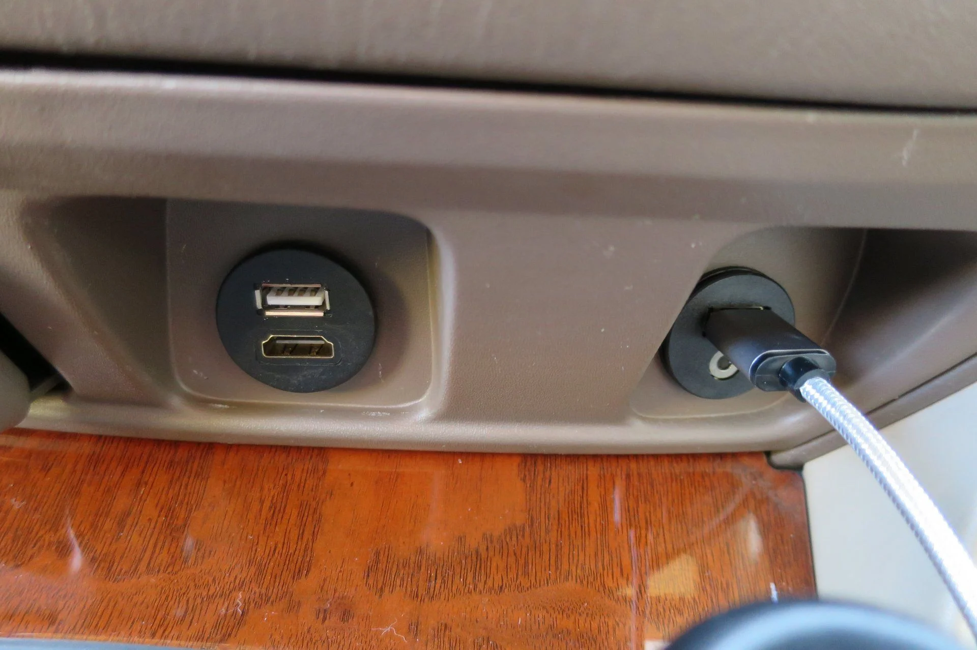

Hello, how did you remove the stock cigarette light to install the USB/HDMI ? Thanks
you have to take apart the back of those cig ports, then push the metal sleeve through from the back, then the black plastic plug itself will release from the front.
