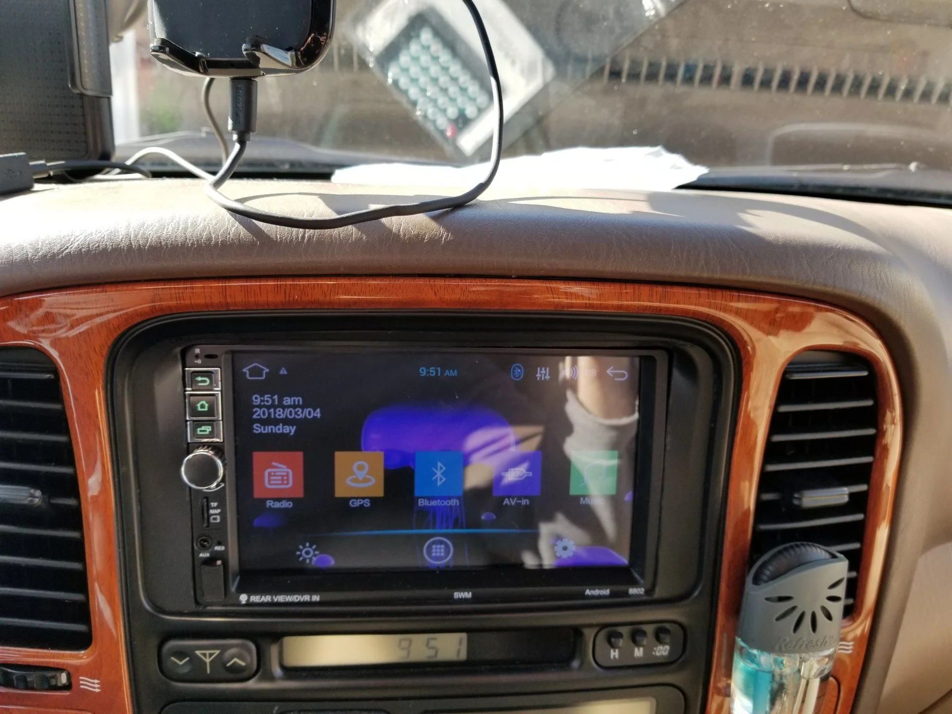

hey guys, just want to do my contribution to this thread.
I finished up my Android stereo installation this weekend.

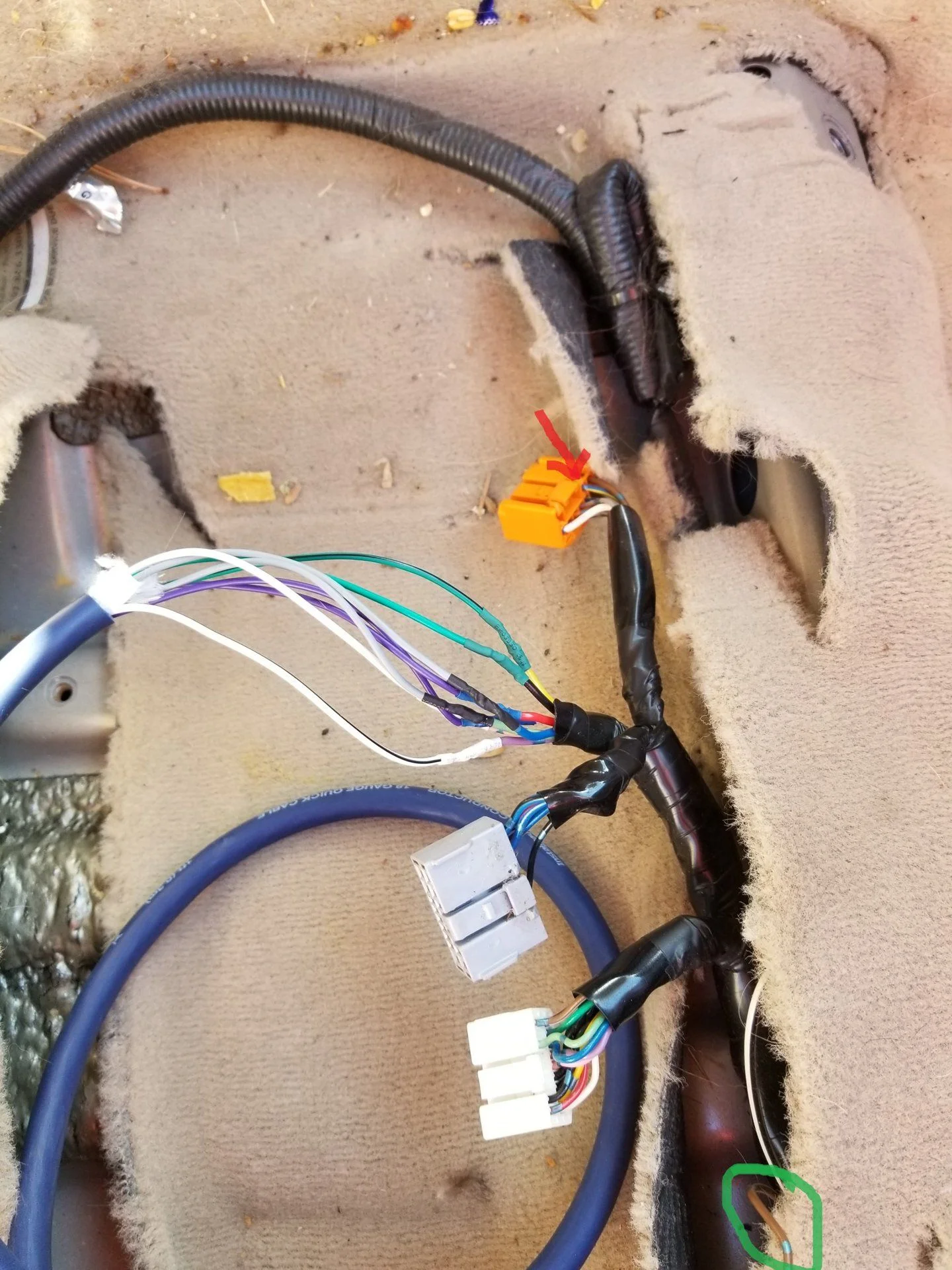

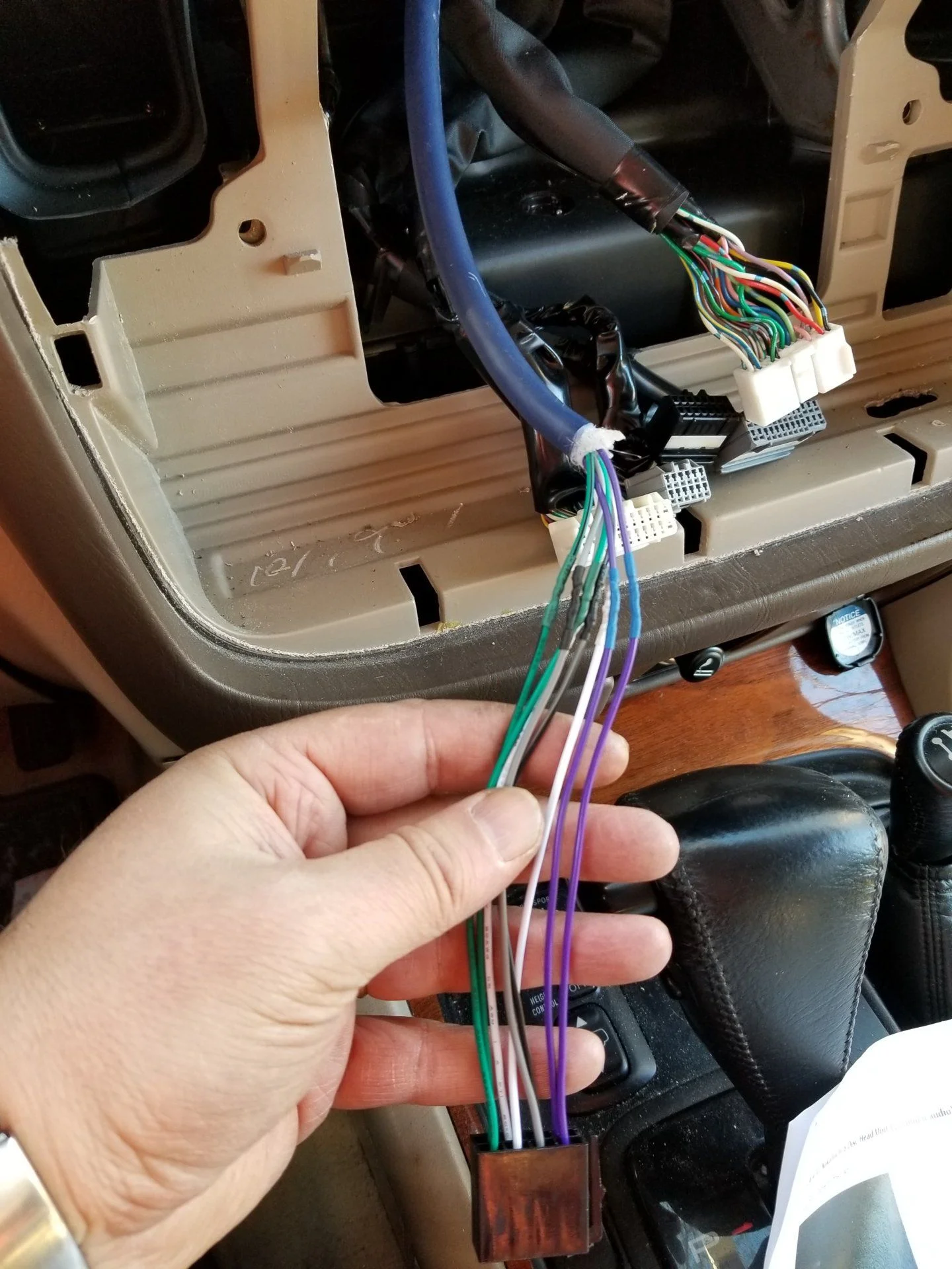

Since my new head unit doesn't have pre-amp rca connections I bypassed the factory amp, I bought the Metra 9 conduits cable bundle and soldered the new connector. easy as pie
The problem came when took the factory amp out and found that didn't have 2 connectors as my instructions said, it had 4, so pulled my multimeter started the idintifying process. Went pretty well and was able to identify all the necessary connections. Red arrow shows +B2 connector (constant +12V) the green circle is Ground (screwed to the body)

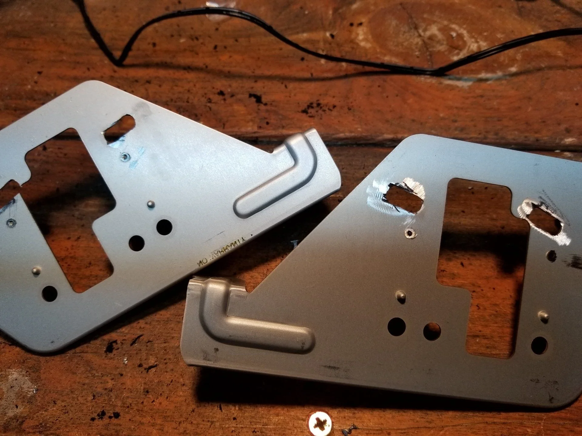

The biggest issue was the fitment. The new head unit didn't came with many positioning options, only 2 holes per side, so had to be inventive and drilled some channels in the factory brackets to get it positioned properly. Took some time and several attempts, but it's there and looks good. Much better than I initially thought when saw the initial gap when I put it in.
If you buy a HU that is meant for EU market, the double dyn size is different, so you have to trim the fascia.
