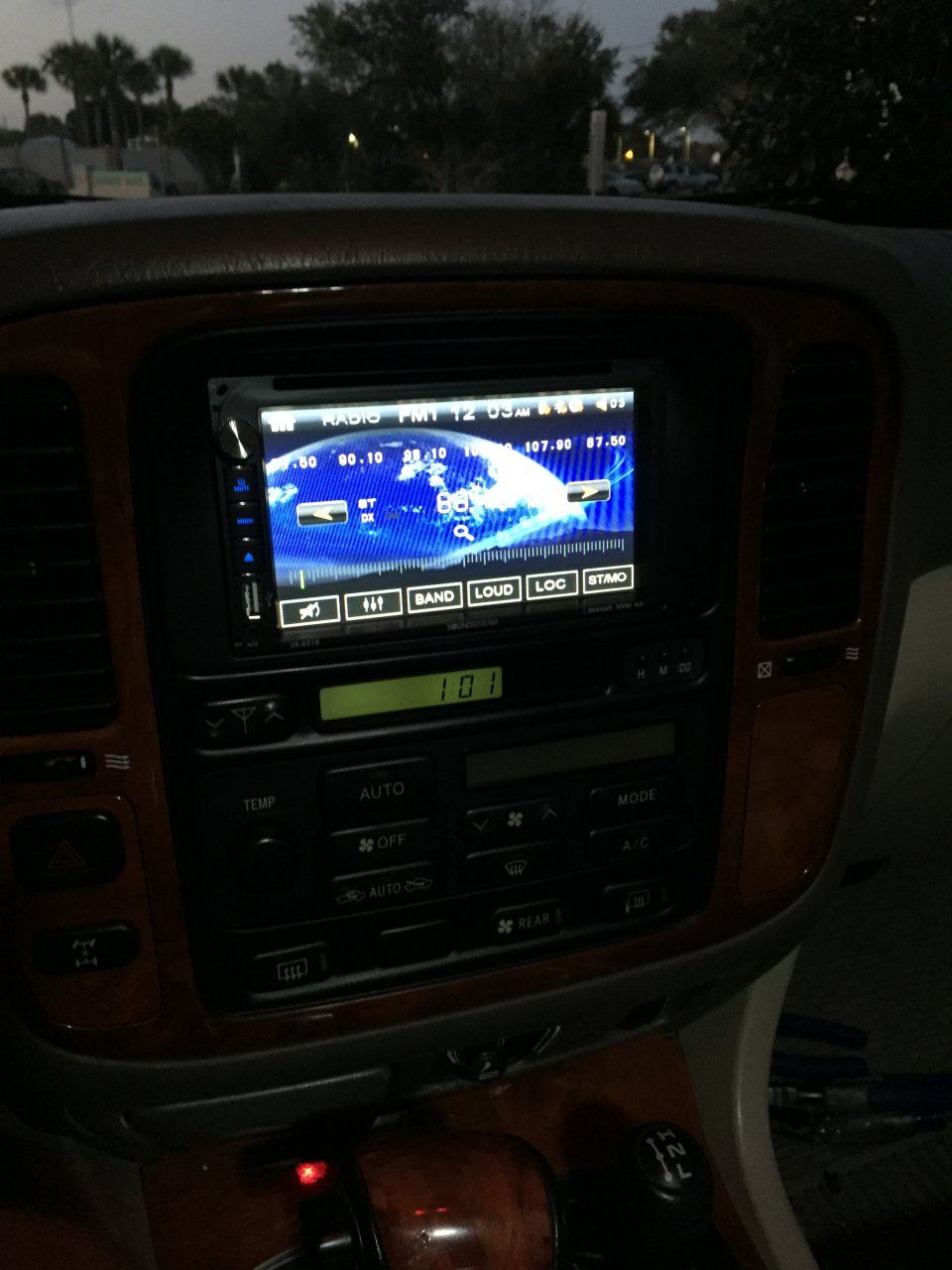

Finished product. Overall, I'm extremely happy so far. I read that some may experience interference so I bought the recommended ground loop isolator from Radio Shack for $15. Didn't hear any interference so i'm returning it :)
The Pioneer deck is amazing. As soon as I hooked up the USB cable and iPhone, i only had to recognize the phone via one button push. Calls are made easily via the Phone button on the deck. Also, the deck keeps your phone contacts so making calls is super easy. One button push and you can select missed calls, recent calls, etc. This deck has about 8 different color schemes too so you can personalize the buttons vs outer surround or make all one color. Pandora works great and overall sound quality is much better than the Nakamichi. I used the external mic cable and mounted just near the console.
Only one real thing is was disappointed with was the trim panel. It includes 2 super thin pcs of adhesive for sticking to the inside of the dash panel. The adhesive strips were junk IMO, didn't hold up so first attempt at installation the panel fell thru the back of the radio...DOH. I used a few small spots of super glue on the inside to hold to the inner flange of the dash and this fixed. You can't see it so not a big deal.
