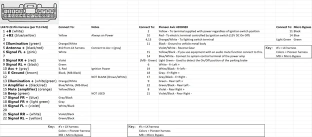

1) I don't see in the TLC FAQ what the #1 +B (white) wire on the harness is for. Anyone have an idea?
2) I also have a #12 (brown/white) wire that the TLC FAQ indicated was blank. Their are comments there stating that others also had this wire, but no reply as to what it was or what to do with it.
3) Anyone see a problem with connecting the #5 Antenna to the #10 Acc? The MicroBypass (MB) instructions advise against connecting the MB to the power antenna wire and suggest connecting it to the #10 Acc wire.
4) Also noted in the comments of the TLC FAQ was a problem with connecting the two illumination wires #4 and #13 to the same radio illumination wire (Pioneer orange/white). Console lights were ON when car lights were OFF, and then OFF when car lights were ON. Anyone else have this problem or were you OK with connecting both #4 and #13 to the same radio wire?

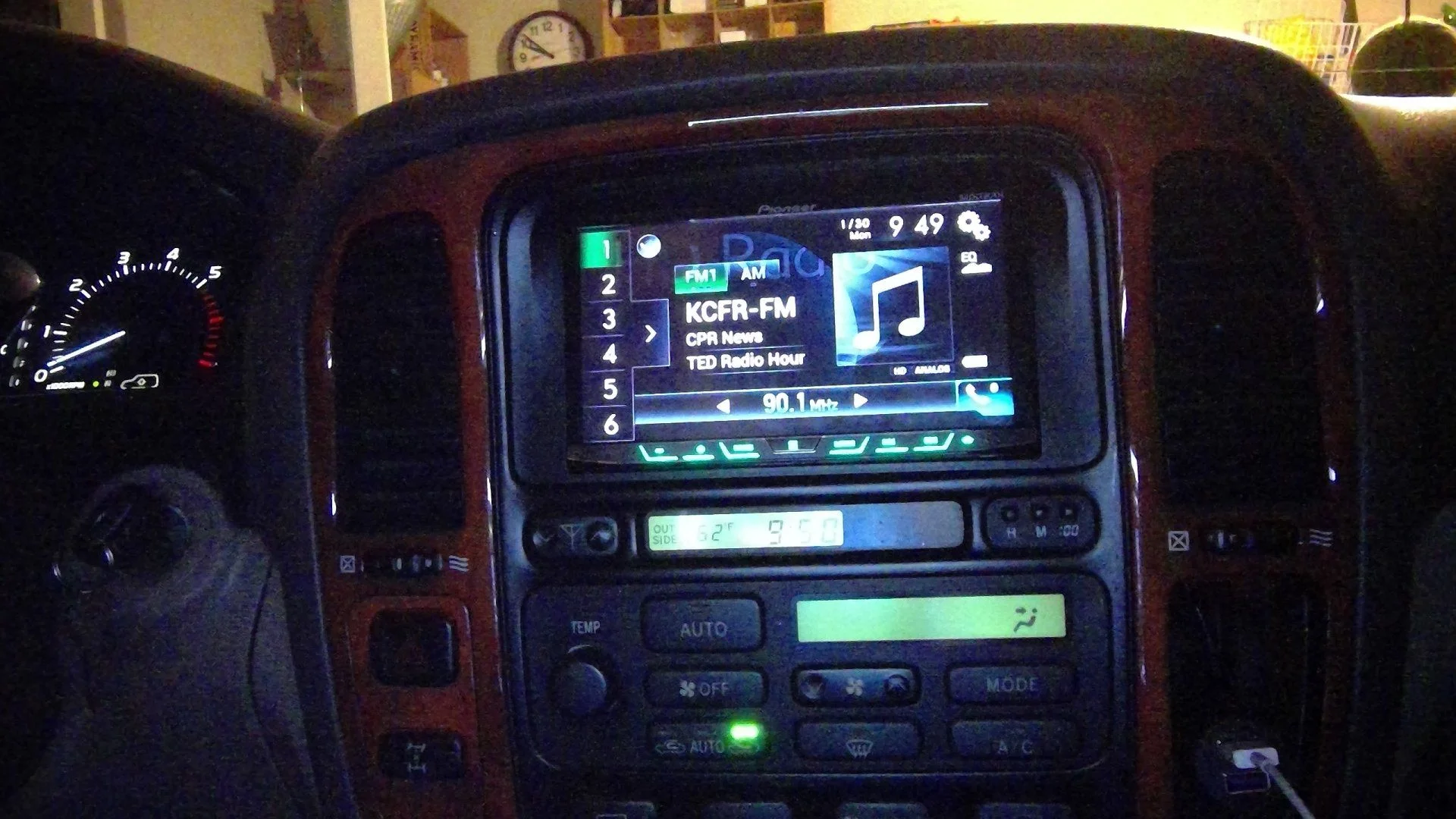

Thanks for your help. I just finished my install.
I ran the ebay double din knock off version from the ebay seller "spiral installations" it was 40$. The fitment was ok and sounds a lot like you described with the beatsonic needing a touch of superglue. After that was done it looked very clean. Well worth its cost.

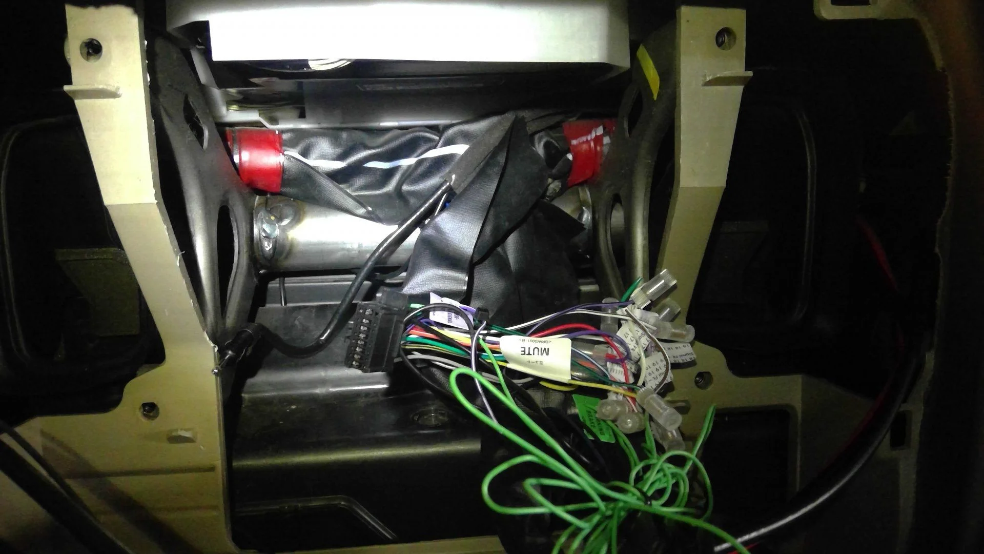

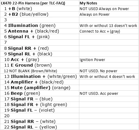

I have the RCA to speaker connections ready to go but have been held up trying to understand why the day/night dimmer wont function. Minor annoyance I am going to put aside and I am going to move on to the RCA connections after this post.
The #4 Illumination measures .02 volts with the lights off and .03 with the lights on.
The #13 Illumination measures .03 volts with the lights off and .05 with the lights on.
Any ideas?

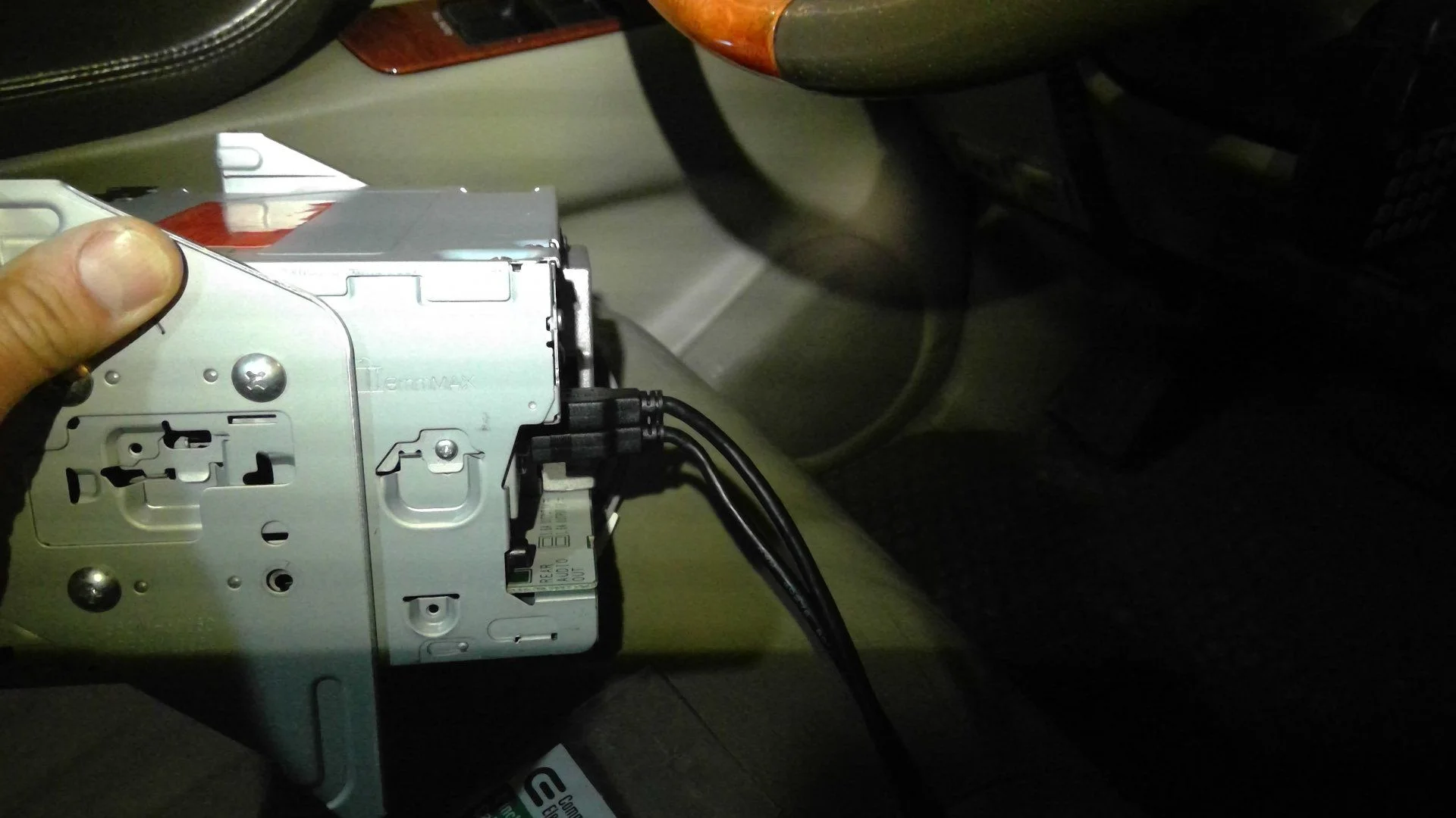

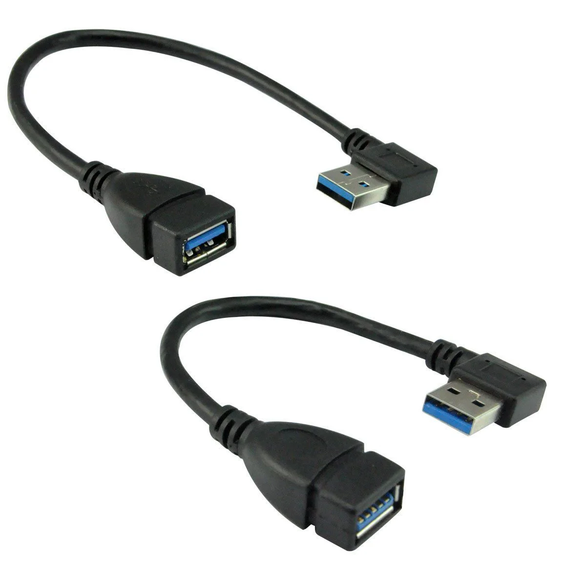

I am using the $20 version. Its a loose fit, slides forward and back. I will correct with some adhesive. The limiter for me has been the space behind the HU. I am connecting two USB's to my 4200NEX for Apple and Google car play. They extend out the back creating a tight fit when screwing the deck to the dash.

At the headunit end I only used the #4 (illumination) and #10 (Accessory) wires. Ran common ground and power wiring to amp and headunit. Ran all channels via RCAs from the headunit to RCAs at the amp. Also ran a dedicated blue wire from the headunit to the amp for a remote turn on -- probably could have reused the #14 Amplifier + (black/red) wire - but I wanted the wiring scheme to be as clean as I could easily make it. At the amp I tied the Clarion amp speaker outputs to the wires that went from the OEM amp to the speakers.
I currently run a Kenwood headunit so a parking brake bypass is as simple as running that wire to the same common ground as the headunit and amp. I have the Tundra fixed antenna mod so the antenna wiring doesn't matter to me but I note Kenwood units have a dedicated antenna wire.
Amazon.com: UCEC SHORT SuperSpeed USB 3.0 Male to Female Extension Cable, Left and Right Angle - Black (Pack of 2): Cell Phones & Accessories

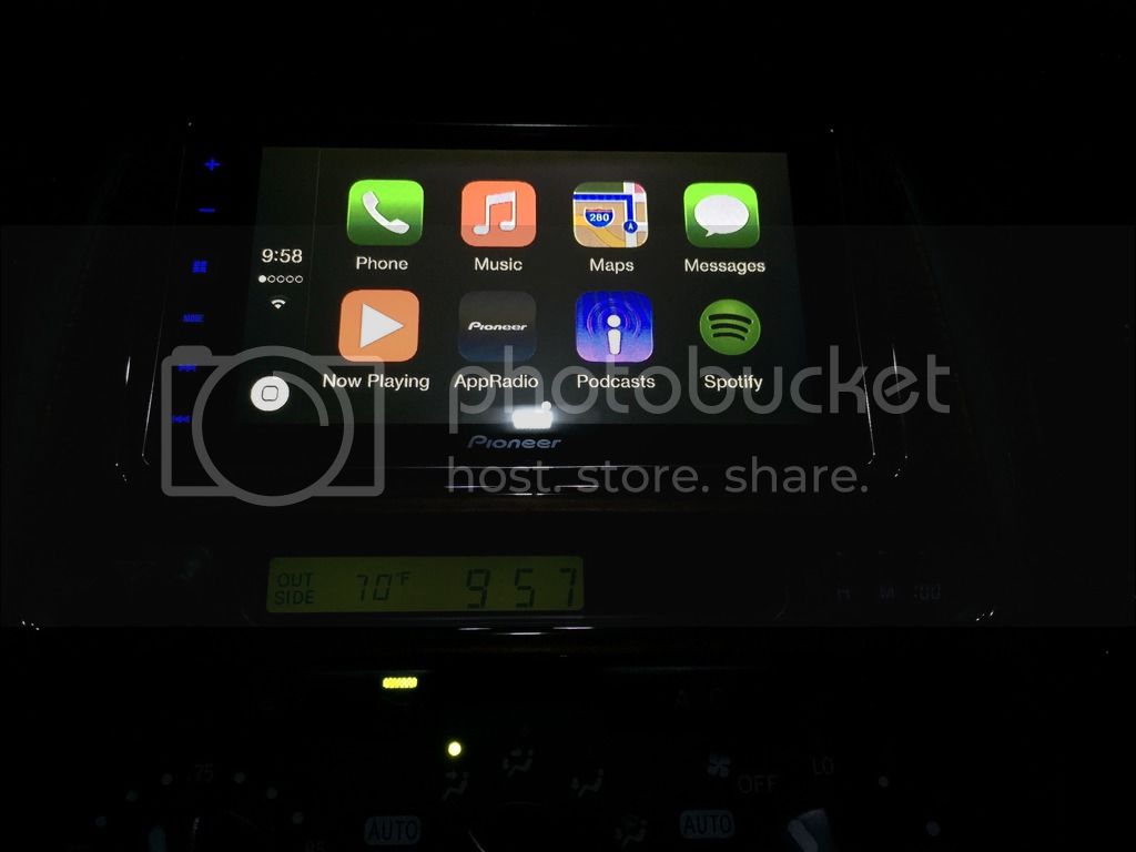

Finished changing over from the HU speaker wire to the RCA's. Much better sound and no hiss.
Still can't get the illumination to work, will look at fuses next.
I bought the Panasonic mic for setting sound level and really like the sound after it does its magic.
Labeling all the wires beforehand really helped.

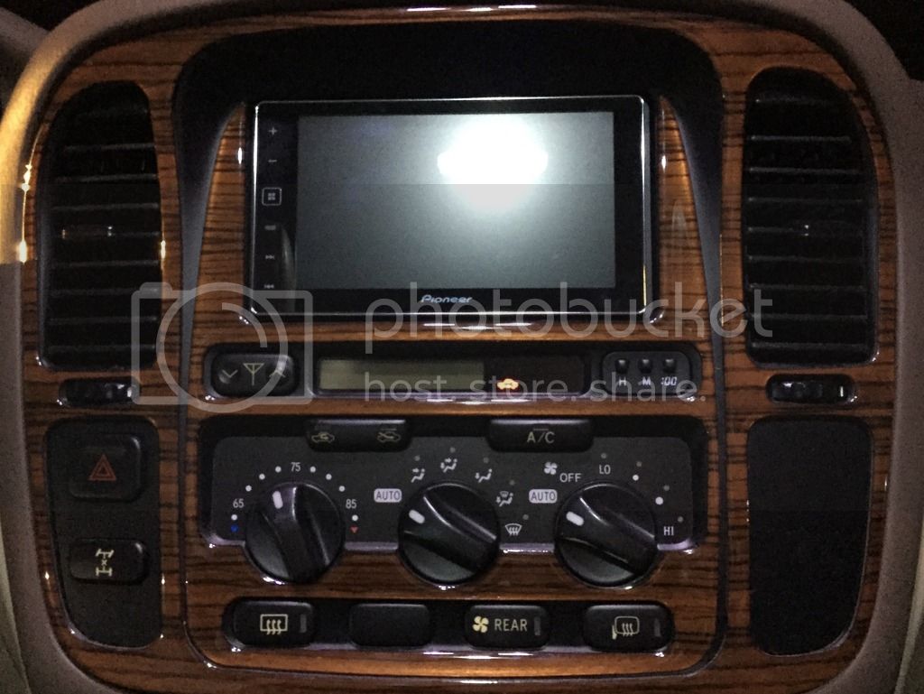

looks great. Possible to post some day light picts looking straight at the HU? Is that the ebay trim kit and any link?
Thanks

Sorry about the messed up post. I was just trying to avoid posting redundant photos.
