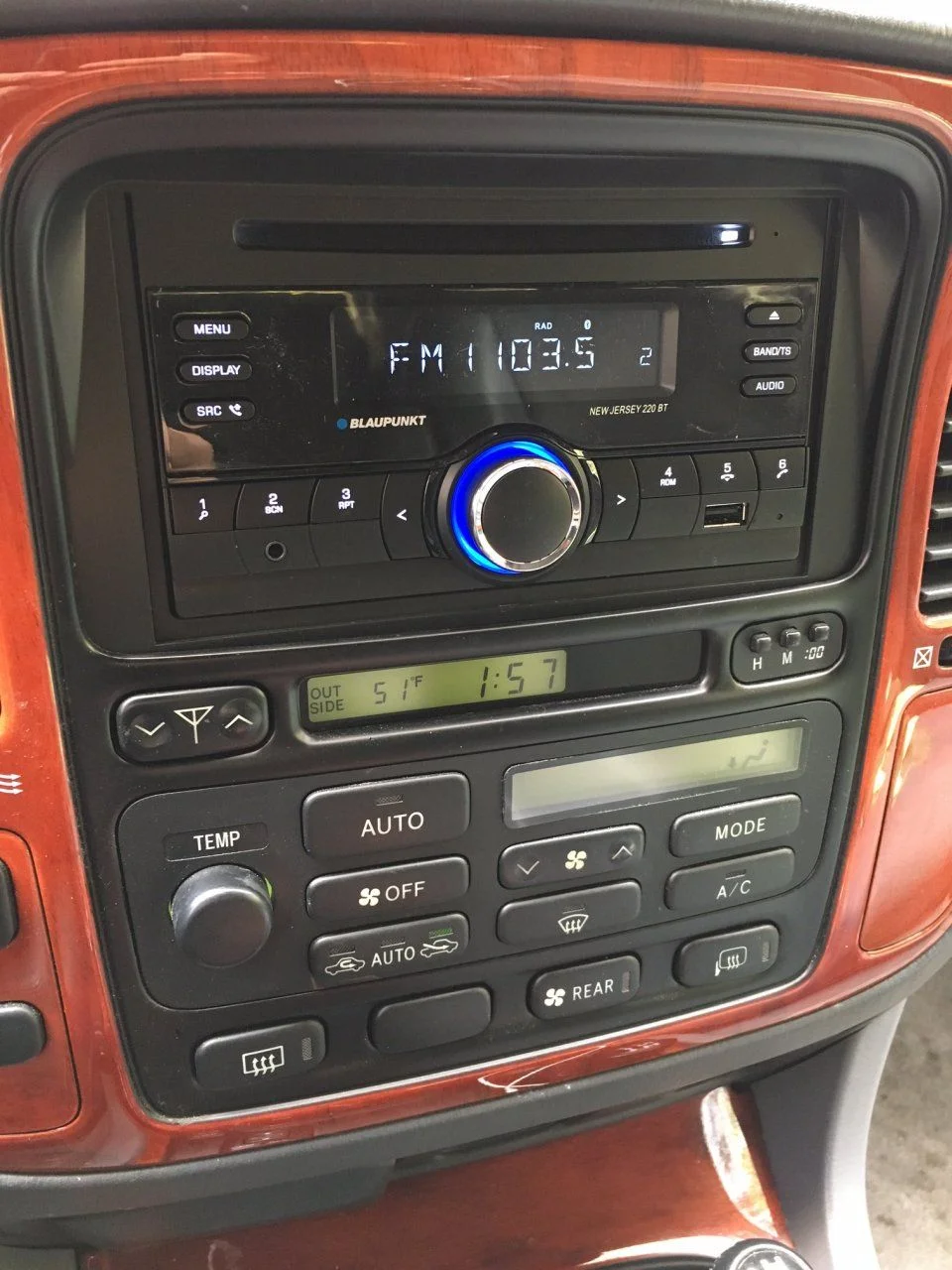

After years of hating the Nakamichi head unit in my 200 LX470, I've installed a new head unit, a Blaupunkt New Jersey. Nothing too fancy, but now I have a CD Player, Aux and USB input with an Iphone reader, and Bluetooth with a built in speaker. I didn't want GPS, a remote microphone, or remote aux or USB inputs, mainly because they complicate the install, and I don't need GPS. The Blaupunkt was great, and it also doesn't have flashing lights and a trillion buttons, keeps the clean classy look. Used one of the plastic surrounds off the 'bay, doesn't fit exactly, but no one except me will ever notice.
After reading this thread and the links, one of the best pieces of advice was to get a new head unit with RCA-outs, then use an RCA-to-speaker-wire splitter (available from install shops and others). Not all head units have RCA-outs, but if you want to reuse the factory amp, you'll need these to make sure your head unit isn't amplifying the signal to the stock amplifier.
Install went well, lots of little wires to deal with, and note that your factory wiring on the Nakamichi has two colored wires for different functions (if I recall white and green). When your first cutting wires, pay attention to the location on the stock Nakamichi plug, label them as you cut them. I didn't and had to guess at which wires were which.
End of the day, system sounds great, and I'm looking forward to listening to the ipod and cds.

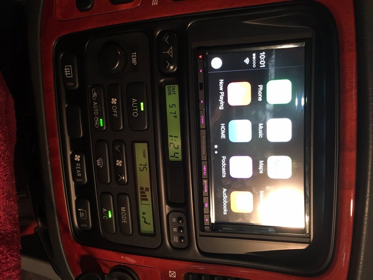

Okay, so after having the Blaupunkt New Jersey for almost a month, I wasn't happy with the sound, or the tiny little buttons. I swapped it out for a Kenwood touchscreen with Carplay. So much better. I installed the USB and HDMI inlet just to the right of the AC controls (just off picture). Really like the Carplay functions. I went with Kenwood because they have the separate antenna power wire,
