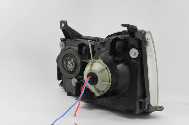

Can you try and take a photo of the ballast? Should be mounted on the bottom of the headlight. I want to see which ballast Toyota used.

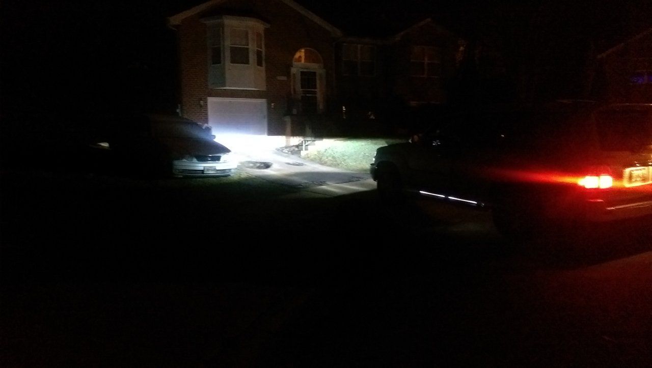

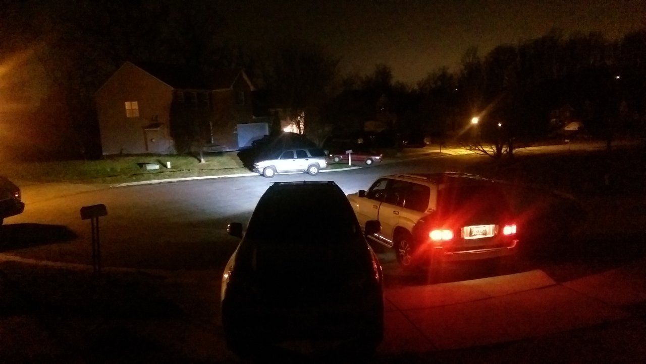

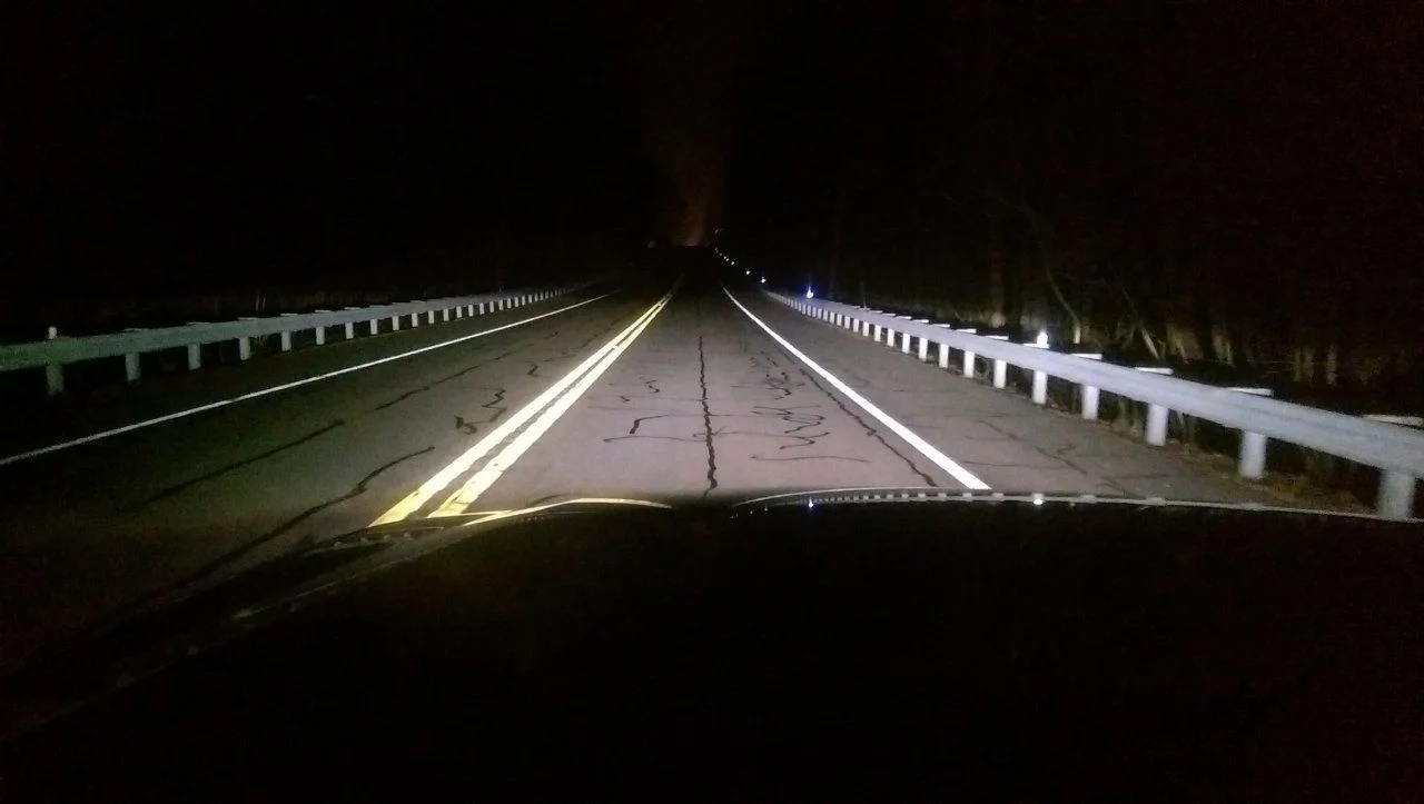

More pics. Razor sharp cutoff line, easily spreads across 7-8 lanes, CBI bulbs are pure white with a hint of blue 5500k temp. Bonus you can still see your beam of light in the rain. Anything that have a reflector on it, when my light hits it, it turns blue. Safety vehicle, trucks, construction zones

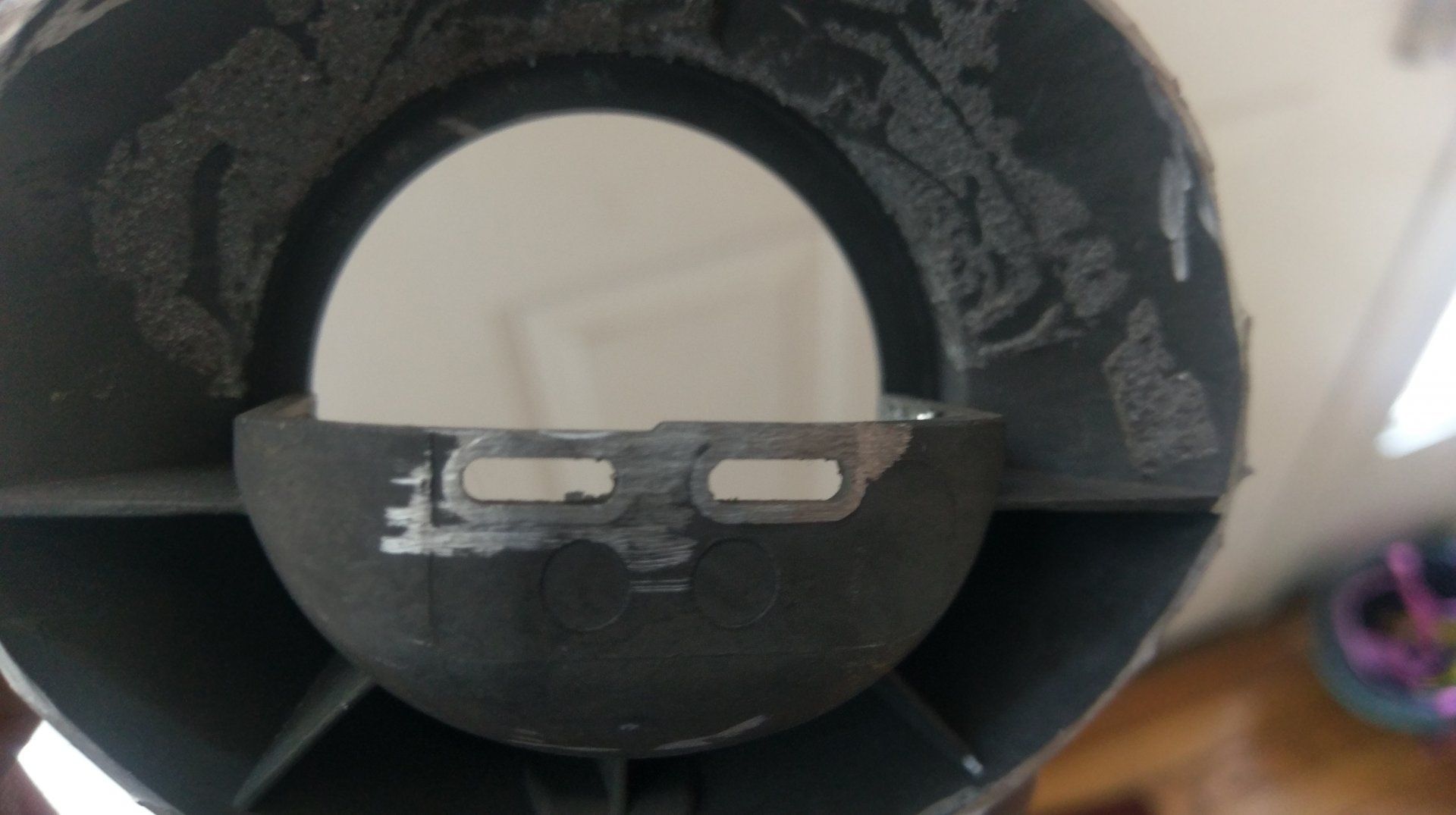

Your gonna need a dremel & get the metal grinding pad. After you open your headlight & remove the lens & bezel. It's 2 screws that holds the bracket that holds the projector in place. Remove it and the lens will pop out. Also it's a plastic spacer that can break easily. Be careful removing. There are 2 holes that needs grinded flush because the hid bulb is longer than the standard bulb. & it leaves 2 circles over the cutoff line. Pic 1 is the view you see once you remove the lens and bed. Pic 2 is what you have to grind off

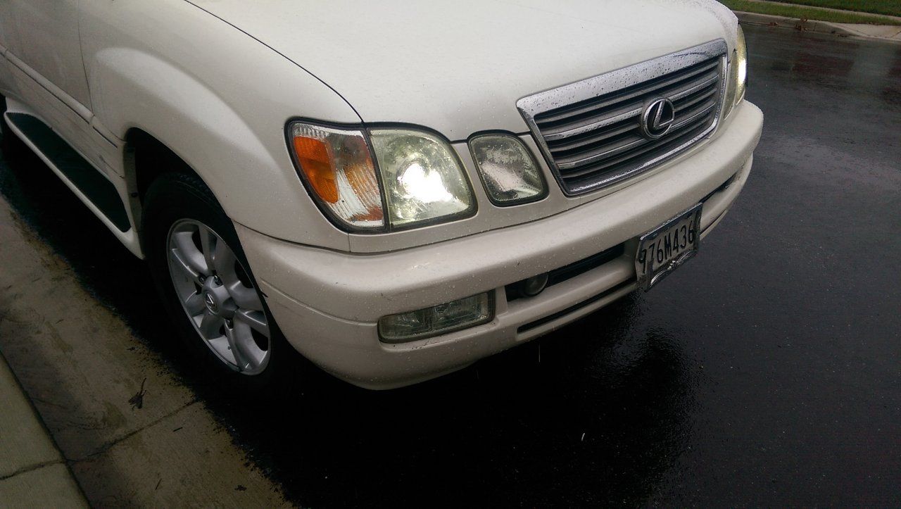

So, I started on my TSX-R swap last night!
Unfortunately on of the lenses showed up cracked across the center of it. :/ I still mocked it up and tested it, and we're looking pretty good!!
I reached out to TRS so I'm hoping they can rush one out to me so I'm not stuck with the car open for the next few days.
But we're looking good so far! Stay tuned!
For some reason, though, the bulb has to be "finetuned" as 2000UZJ describes at the top of this page in order to get the cutoff just right... you'll see what that means when you attempt your own retrofit!
