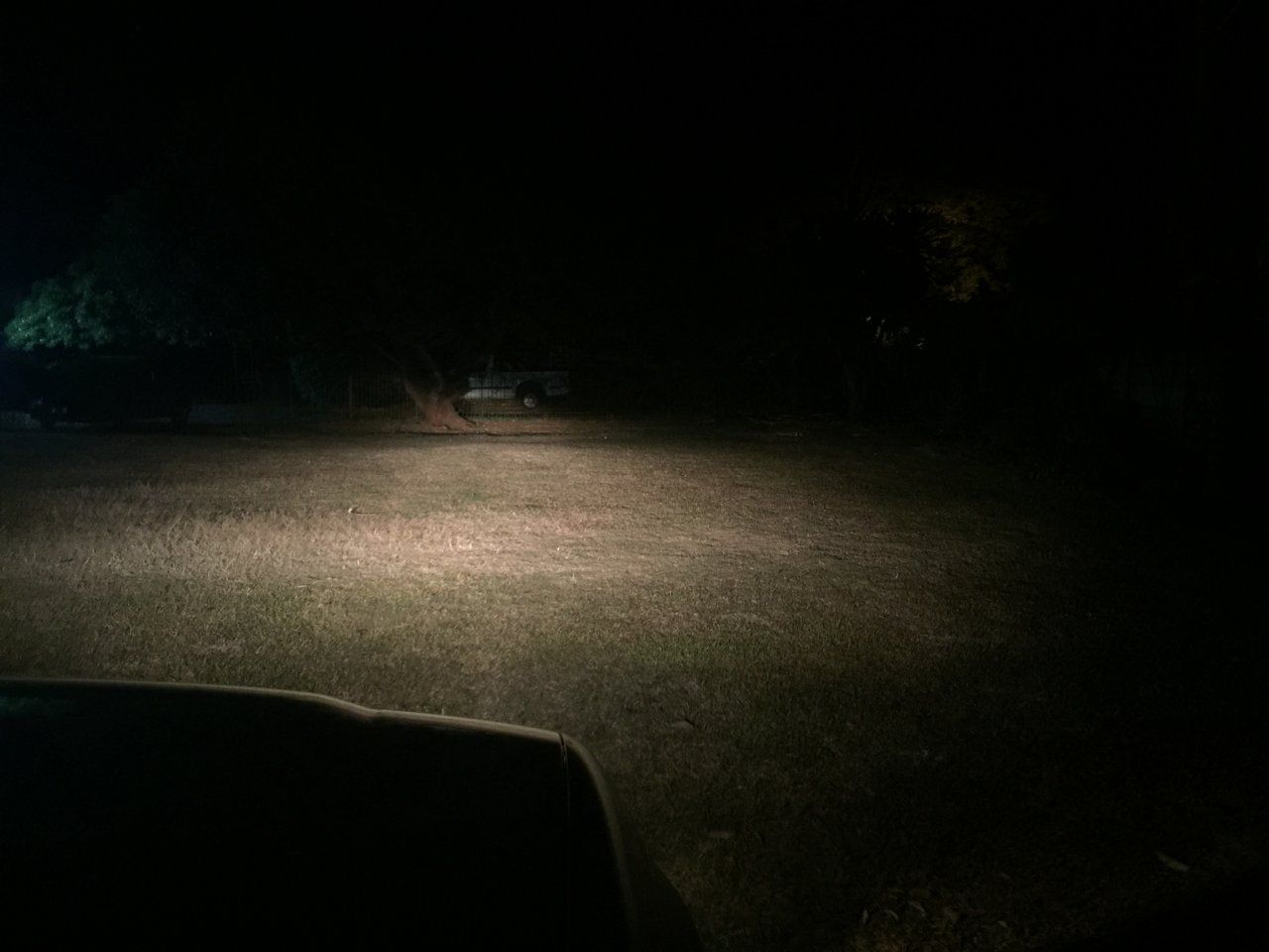

Guys the only way to get the best light output from the LX is to do a complete retrofit. I've tried the h1 kits. & it's OK, better than oem but output sucks in the rain. So I did a complete retrofit. So I Purchase some SC430 projectors & CBI 5500k bulbs from a guy on hidplanet.com. here's a few pics of my results. FYI: no problem, I mean absolutely no problem driving thru rain, fog or snow. Excellent visibility, very bright and white with a lil dash of blue tint. Same color as factory led. razor sharp cutoff line to keep from blinding oncoming traffic. Here are my results
Check sites like: hidplanet, club Lexus, or another blog site. You'll find them. YOU can use Honda S2000 projectors. Another upgrade to the LX projectors is using tsx-r clear lens.

I baked my headlights as well. Wasn't no custom wiring. I just went to a salvage yard and cut some headlight connectors off another Lexus so I can use the denso ballast. Put it all together & aimed my headlights & boom
S2K projectors are easier to find than the SC430 projectors. They are equally match with a clear lens install. Yes I have that too
More pics. Razor sharp cutoff line, easily spreads across 7-8 lanes, CBI bulbs are pure white with a hint of blue 5500k temp. Bonus you can still see your beam of light in the rain. Anything that have a reflector on it, when my light hits it, it turns blue. Safety vehicle, trucks, construction zones
