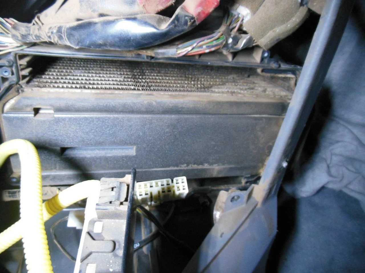

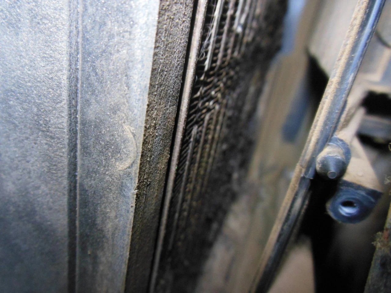

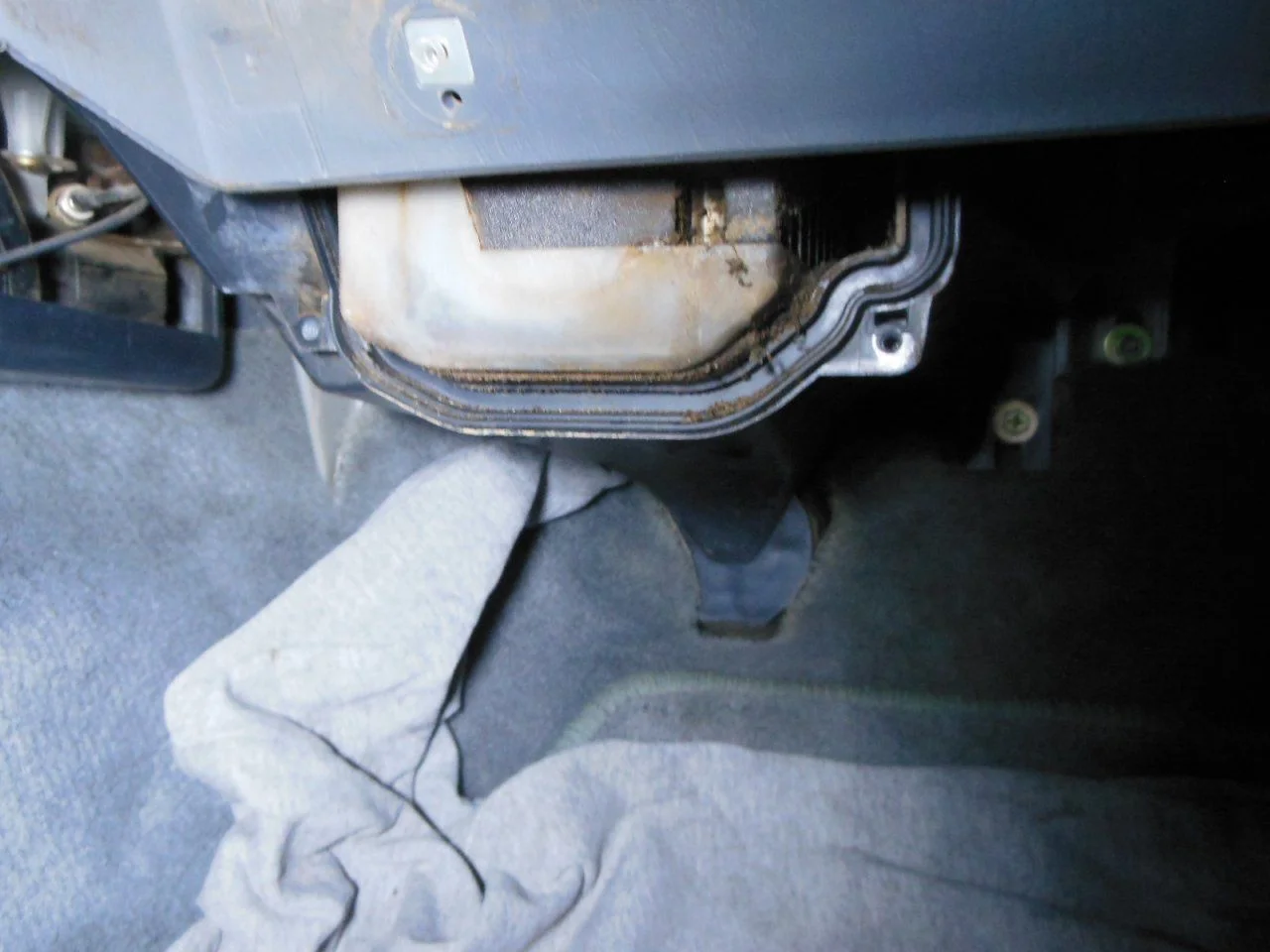

I found my 2000 has the cabin air filter door! Yey... then went ahead to inspect the filter to my surprize someone took off the filters but didn't replace it with new. The AC evaporator is covered with dirt etc.,

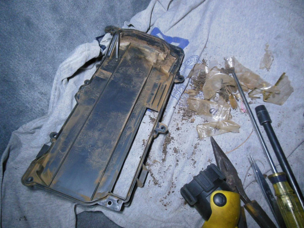

I took off the cover plate so I can clean the evaporator.

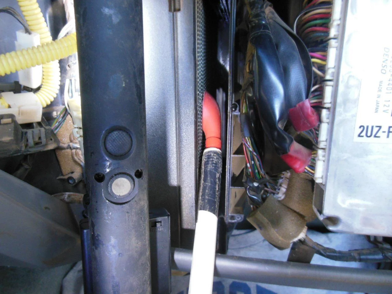

Made a set of tools to clean the evaporator.
I used kids plastic golf stick and cut it to make a nice 90 degree to use as an attachment for the vacuum cleaner to suck up dirt stuck in the evaporator.
@nissanh nice job with the custom tools! That's one of the dirtier filter boxes we've seen in this thread. I would bet it never had the filters, and that's not uncommon unfortunately.

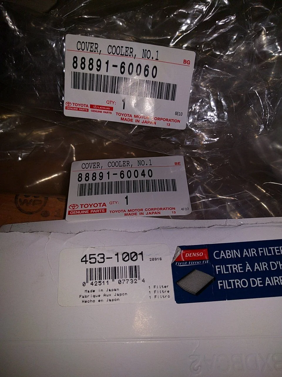

correct parts for a 2006.
I got them from cruiserparts.net
1 x A/C Cooler Cover No. 2 UZJ100 98-03 (88891-60060) = $16.97
1 x A/C Cooler Cover No. 1 UZJ100 98-03 (88891-60040) = $25.03
denso filters from amazon DENSO 453-1001 $22.

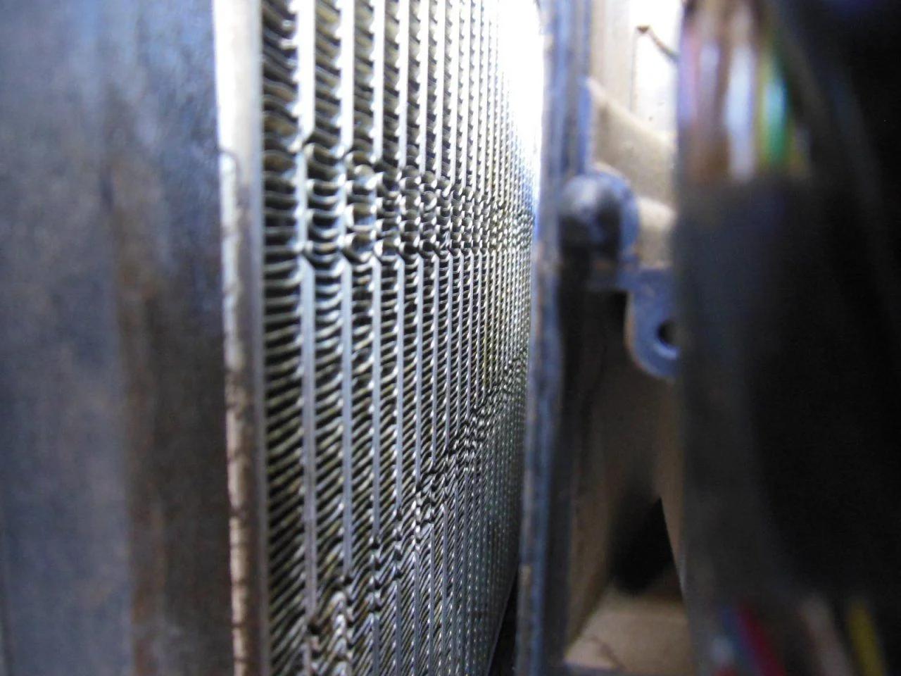

The home made golf stick tool was amazing! It did it's job better than I expected. Notice the thin form layer at the end of the golf-stick handle. this makes a good seat with the vacuum hose.
1) Using the brush, brushed the surface/fins and sucked all the loose stuff into the vacuum.
2) Using a spray bottle, I wet the area with warm water (IMPORTANT: cover the ECU and wires with a plastic bag)
then brushed the surface and vacuumed: Also noticed the drain line started dropping dirty water
3) Sprayed again and vacuumed once more.

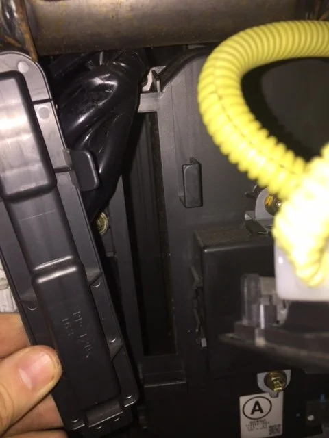

If anyone wants the filters and don't have the door, you can get the plastic panel (shown in one of my previous post) and install it by simply removing the 8 Phillips bolts.
