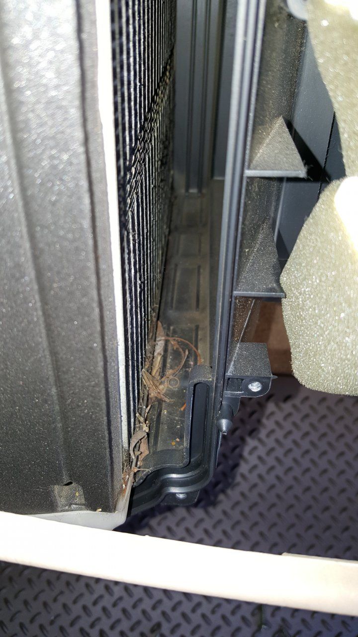

Has anyone had issues with water dripping from the cooler cover? Is there some kind of gasket that is also supposed to be installed in order to prevent water dripping onto the passenger floor?
I have this issue and although it is not a lot of water it is annoying.
There is. Mine was in pretty bad shape but left it in anyway after the mod. Drips soon followed so disassembled and grabbed the OEM gasket/seal (can't find the part #) replaced and drip gone. Pretty sure you could make your own for a lot less.

Not sure but there's always a good amount of water underneath the LC after a long drive with the AC on. It wasn't dripping before the retrofit though.
I had the drip as well. I ended up replacing the gasket material.
Real easy install, just remove glove box, then the cover screws.
Toyota P/N 88578-47040. It was < $10 from the dealer.
No more drip!

Just got back from a 1000 mile trip and I'm happy to report the small little gasket mentioned above fixed the issue. No more drips!

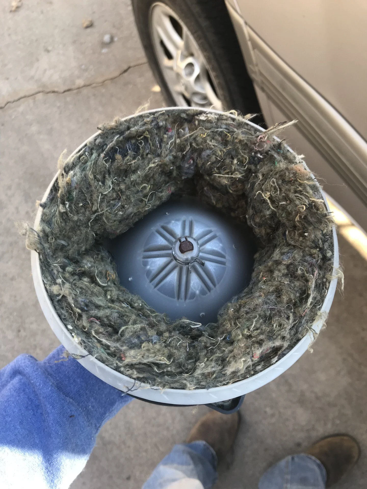

Make sure you check the blower motor...mine was filled with a little rats nest. Car smells about a million times better now and the vents actually work too
