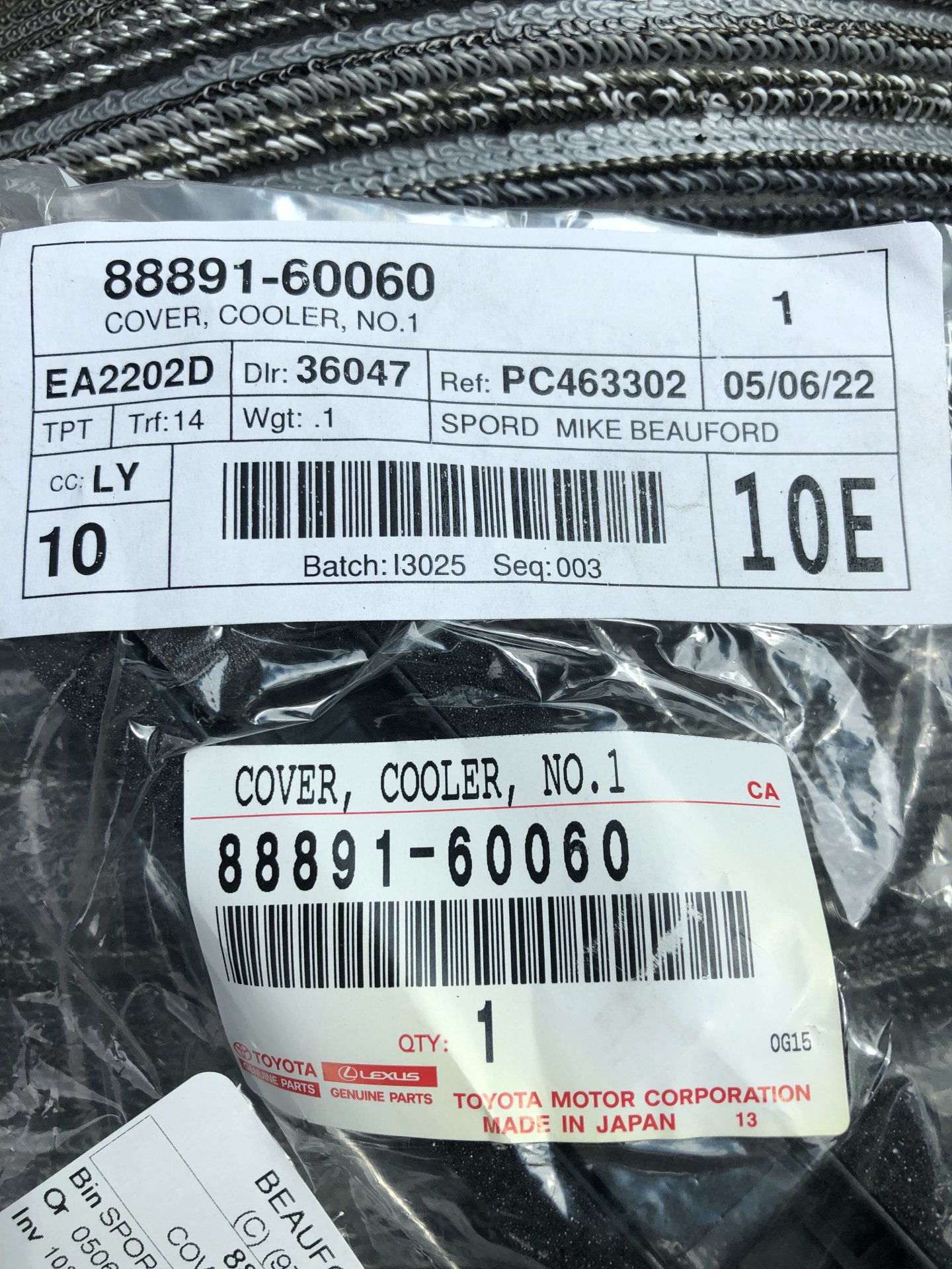

Correction needed to 30680. Bad part number. Did not fit when received. I had to go to dealer and order correct door cover. Will post updated PN when available. Do NOT order 30680 pn.

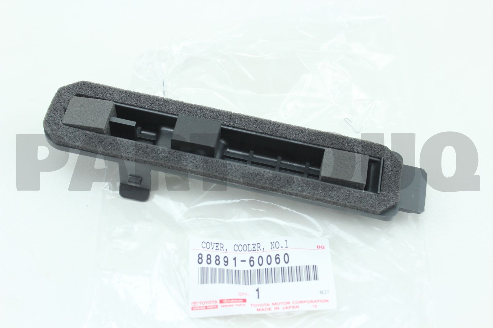

Only 2x is the filter which you can source from Denso in a 2 pack. Make sure you check the qty. i am seeing the Denso part number is 453-1001 comes with 2 filters for $18 from Amazon. This is much better than paying 2x $34 for Toyota PN 88568-60010. The qty 1 cover ($31 oem pn 88861-60040) has a place for qty 1 door ($21 oem pn 88891-60060). The door is only big enough for 1 filter to drop in at a time. The filters are identical and one stacks on top of the other. The gasket is the Packing Cooler PN 88578-47040 $14. Looks like a skinny black rubber worm.

2 filters, one of each of 3 parts to convert. Confusion may be in cover plate & it's door (cover), one of each. One gasket is 3rd part.
