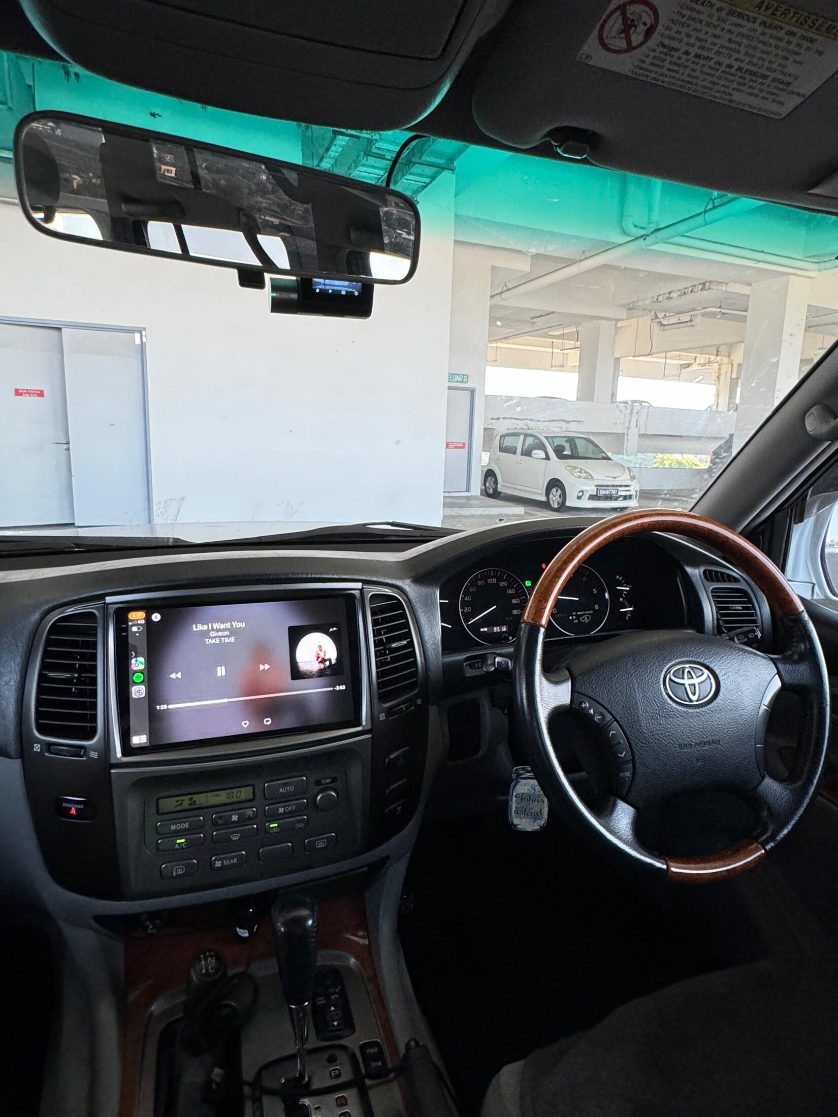

It's hardly the same type of solution (continues to use old LX screen, audio system, etc), but a Grom VLINE VL2 works super well. I've had mine for a couple of years now and I'd buy another if it died. It does at least deliver a modern interface in CarPlay or AA, etc.
Agree. I couldn’t recommend the Grom unit enough. The screen definitely feels clunky at times but not enough to really bother me AND I’m using wireless CarPlay in an ‘04 car… and it still looks original.
