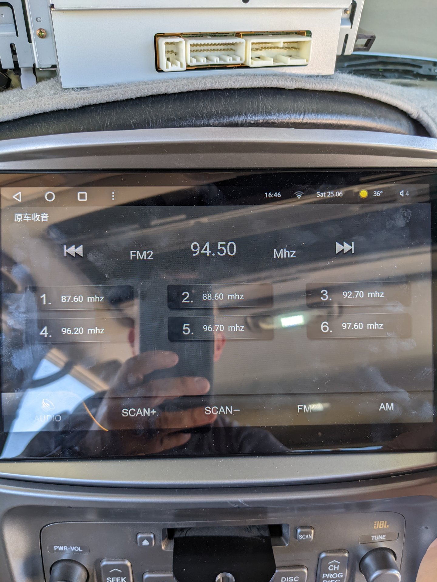

There is a slight hiss from the speakers. Goes away when you turn the tuning knob. It appears there are two radio apps on this unit. I think the hidden one (see pic) is causing the hiss. It can't be tuned.
