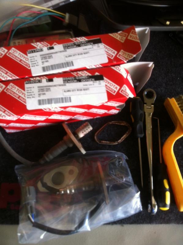

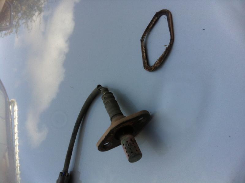

O2 Sensors
Changed out the O2 sensors today. I wasn't having any issues. No codes. I was just trying to get everything in the system ready for when I add a turbo. Well I was pretty shocked to see the front O2 sensor wasn't throwing codes.
They both came out no problem no penetrating spray, no rust issues.
Front O2 had 2 stacked gaskets, I guess the Toyota dealer the PO took it to didn't believe in taking the time to get the other one off and clean the surface. Both gaskets were completely blown out. Nothing left.
Rear was in good shape, gasket was whole.

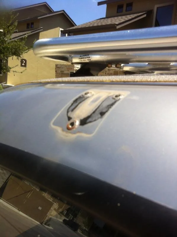

Rear wing
Also pulled the rear wing off since it was showing indication of water sitting under the feet. I wish I would have pulled this and sealed the holes when I did the line-x but oh well.
Even here in Southern Texas where it is 100+ degrees and we haven't seen rain for at least 4-5 days, I had water sitting under the feet soaked into the foam adhesive. If you are in a wet climate this is going to be a bad source of rust just like the roof rack.
I have a coule of ideas to fix it, but I am not sure which direction I will take.

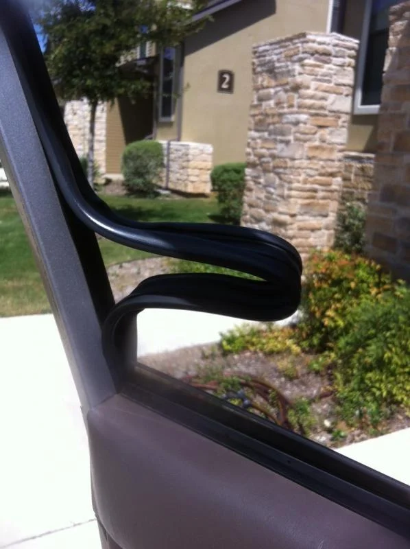

Window Channels
Bought new window channels probably going to do the door weatherstripping as well.
Thought I would give it a shot since I had heard it was simple, but I will tell you this was very frustrating. I don't know if it is the 100+ degree temps that are making the rubber so soft and pliable and unable to be pushed down the channel, but I fought this for an hour, rolling the window up a little, shaking the glass back and forth, holding the window away from the side I was working you name it. Using rubber glide thinking it might help it slide down the channel and against the window. I am going to let it cool off before I try any further. I got the short side but the long side has about 3" to go.
If anyone has any advice lets hear it. lol
