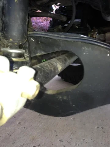

Here's my set up.
Yes running stock steering box. Ram is from Surplus Center 1.5x10 part # 9-7258-10. I got all fittings and hoses from them as well. Mount for the axle is a Dana 60 hydro assist mount 6.25 length I believe. Got that off ebay. No steering cooler. Going to add a bigger reservoir.

Is the RAM mount attached to the 3rd or the axle housing? I can't tell from the pic.
To the axle housing. Here's another pic.
