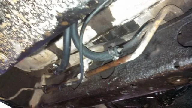

I want to add a cooler. How do I do this? Do I just replace the "paper clip" thing with a real cooler?
Could you post pics?
You really can't see much, but here's what I did.
Hmmm....I just notice that you have a 91. I have a 96 and your pic doesn't look anything like mine.
