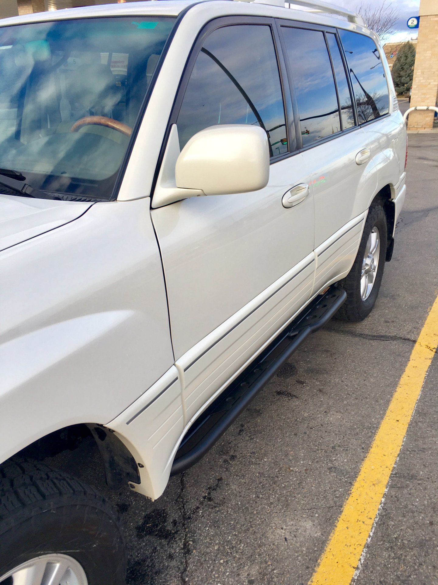

I just sent you an email about getting a set for my LX since I took off the stock running boards and installed OPOR rock sliders.

I bought a set and the quality and craftsmanship are great! What I failed to consider is that I spray my undercarriage with fluid film annually at the least. I don't think the self adhesive backing is going to work out for me very long. I don't want to thread jack but I'd like offer up the set I bought for sale. Un-installed, still in envelope. Interested, PM me.
I too bought a set and trying to install it this weekend realized that my contacts on the vehicle have corroded completely as they were left open for a few years.
So decided I will not use these now. If somebody is looking for a pair, PM me and we can work something out..
