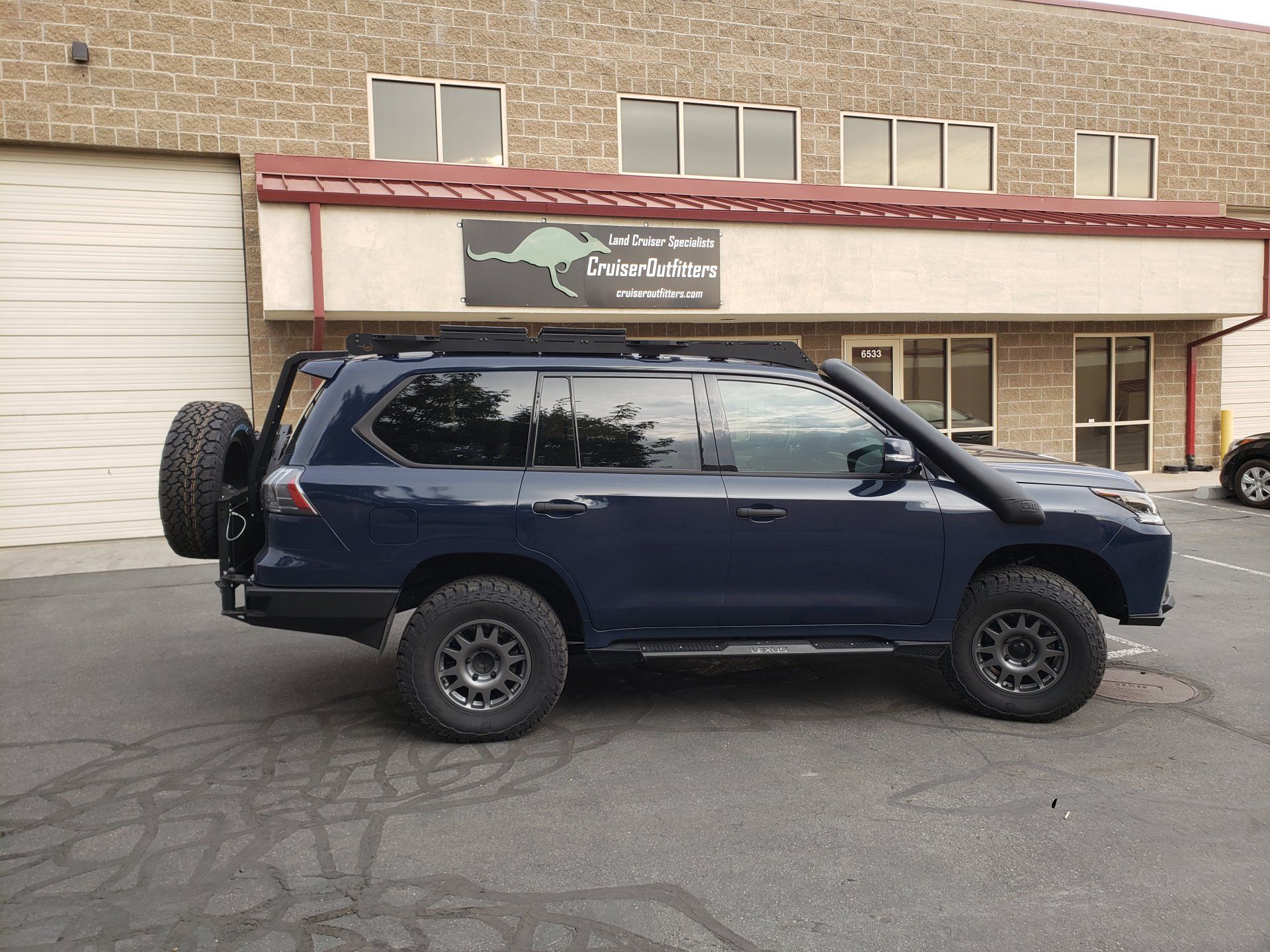

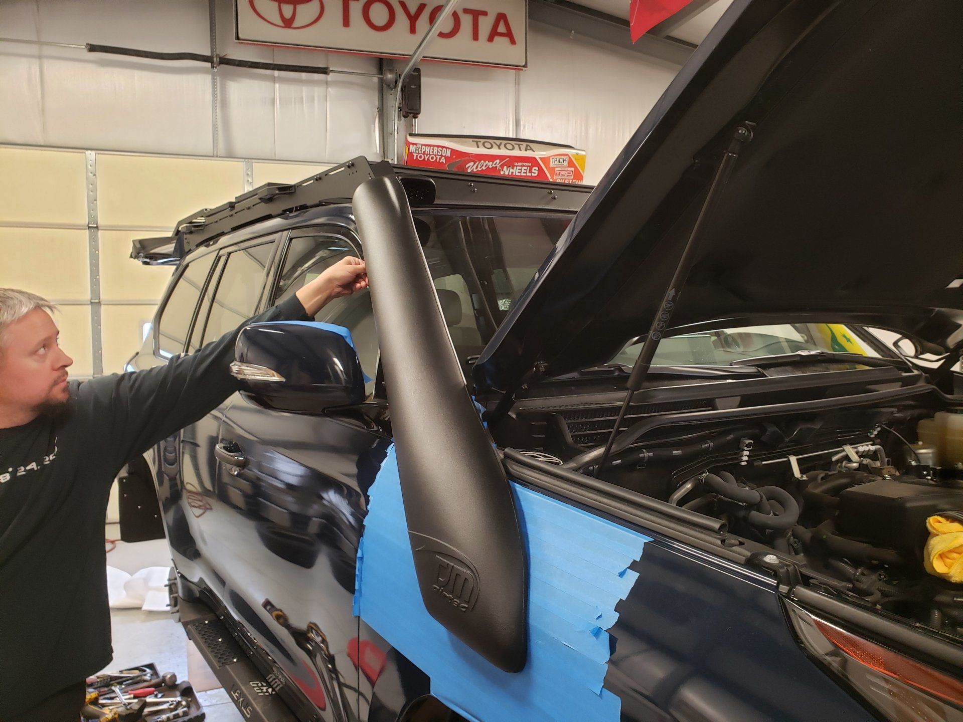

We used the Airtec (TJM) on this particular build. Mostly because it has a noticably stealthier upper body that attracted our Lexus team members. It also took a great deal of mods to the snorkel body, SAIS system, intake tube, etc to fit BUT not something I wouldn't do again. @bryson and I installed this one and were both quite tickled with the results overall. It fits as good as many Safari, Airtec, OEM snorkel applications. A close eye when at the vehicle will reveal the tweeking we had to do on the snorkel body but again, it turned out great imo.
@cruiseroutfit Curt, thanks for the reply. I’ll call the shop and get an Airtec ordered!
